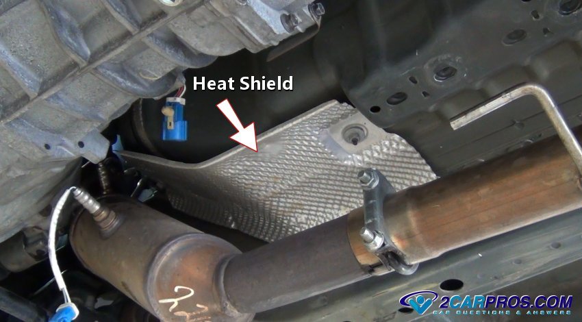

3. Loose Exhaust Heat Shield
The exhaust system in the car uses heat shields over the manifolds, catalytic converters and exhaust tubing to keep heat from penetrating the floor of the car and causing damage. These shields are made of thin metal and when they come loose or break they can make a rattling sound while the engine is running. Some of these shields are accessible from the engine compartment while other times you will need to jack up the car and get under it to check out the shields.

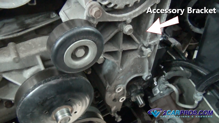

6. Cracked Engine Accessory Bracket
A mounting bracket is used to support the various accessories such as the power steering pump, air conditioner compressor and alternator. If the bolt becomes loose or the bracket breaks it can cause a rattling noise. These brackets can be both cast or stamped steel. Inspect the brackets to make sure they have all of their mounting bolts installed and look for cracks somewhere on bracket. On steel brackets the crack will be accompanied by a rust colored dust at the crack to make it easier to see. If a failure is observed the bracket must be replaced or welded.

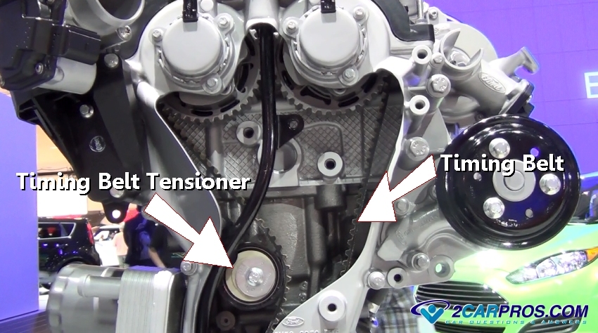

7. Worn Timing Belt
A timing belt or chain tensioner is used to rotate the camshaft(s) that control intake and exhaust valve operation. If this belt, chain or tensioner becomes loose or is failing it can cause a rattle noise that follows the engine RPM's. To check for this condition remove the timing belt or chain cover and use a flashlight to check for excess play or parts of the timing belt that have come off.

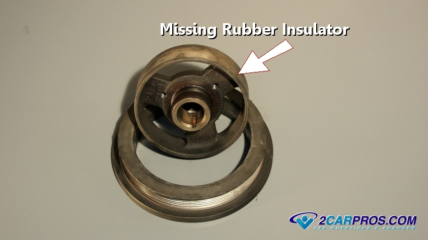

8. Broken Harmonic Balancer
A harmonic balancer is used to help silence engine vibration by utilizing a counter balancing weight supported by a rubber ring which is located at the front of the crankshaft. This ring can become dislodged because the rubber insulator has failed. This will allow the outer ring to bounce and jump on the rotating hub which can produce a rattling noise that changes with engine speed. To check for this condition remove the serpentine belt and inspect the harmonic balancer.
broken balancer
If the balancer has come apart it must be replaced. You can get the job done by watching the video below.

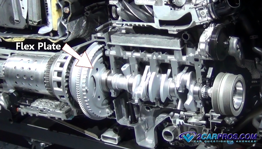

11. Cracked Flex Plate
On vehicles equipped with an automatic transmission a flex plate is used to couple the transmission with the engine. This plate also supplies the starter with a ring gear which is used to start the engine. If this flex plate is cracked or is loose it can produce a rattling noise. The transmission will need to be removed to check the flex plate in most cases. Look for rust colored powder either at the crankshaft bolts or the torque converter mounting bolts. Also look for obvious cracks and missing or loose bolts.
