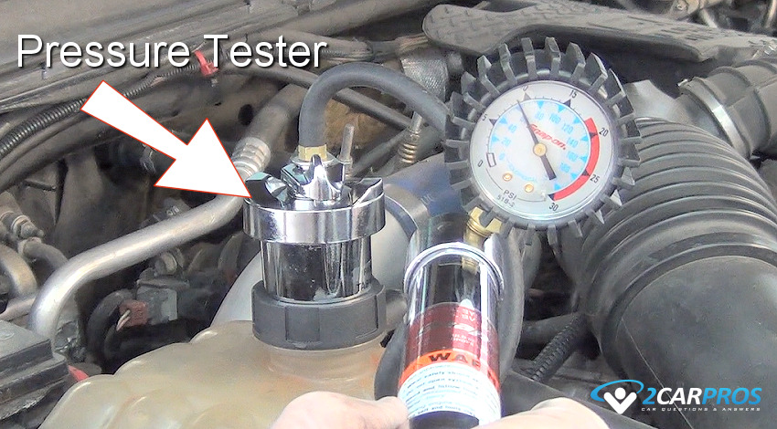

2. Attach the Pressure Tester
The pressure tester will connect directly to the coolant reservoir or radiator while using an adapter which will be supplied inside the pressure tester kit. The pressure tester connector will be spring loaded so push downward before you start twisting the connector and locking it clockwise. You should feel a click as the tester secures itself.

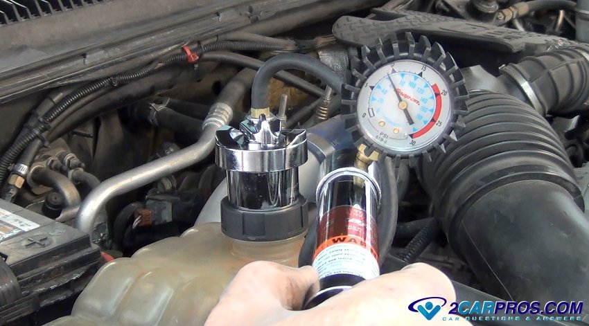

3. Pressurize the Cooling System
Pump the pressure tester plunger rapidly to build pressure inside the system, much like you are pumping air into a tire. You will notice the needle on the pressure tester gauge starting to move upwards as it measures the pressure inside the system, common pressure ratings range from 13 to 16 psi. (Avoid pressure above 18 pounds). At this point you may see coolant leaking from the water pump, radiator or heater hose.
automotive engine radiator cooling system pressure tester
  • This test is also good for checking a blown head gasket, once all of the spark plugs have been removed, coolant will pour from the spark plug holes indicating the failure.
  • If you cannot get the system to hold pressure chances are coolant is pouring out of a leak somewhere, or the pressure tester is not attached properly, recheck the tester connection.
