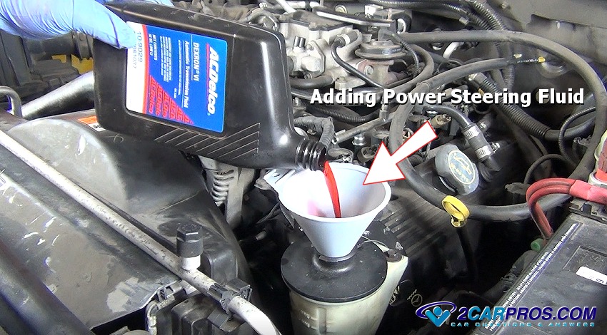

When steering your vehicle, if there is a low grinding or gurgling sound the first inspection is to check the power steering fluid level, if the fluid is low the pump will be weak and make noise as it scavenges for fluid. Check the power steering fluid level by locating the power steering fluid reservoir and removing the cap (twist counter clockwise). Some systems have a fluid level dipstick mounted inside the cap while others are present on the side of the fluid reservoir, if the fluid level is down or empty the system has a leak. Using a flashlight the system should be inspected for leaks.
adding power steering fluid

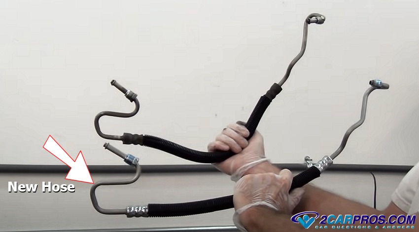

A popular failure for power steering system leaks and non operation is the high side power steering hose, use a flashlight to inspect the hose, the failure will be obvious, if leaking or blown the steering hose will need to be replaced.
new steering hose

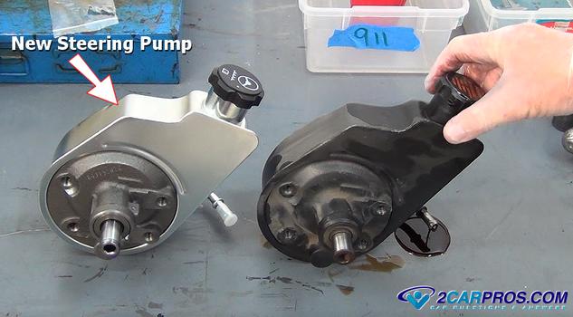

If the the system is full and the belt is on the pump but it still has no power steering chances are there is no pressure being produced and the power steering pump needs to be replaced.
new power steering pump

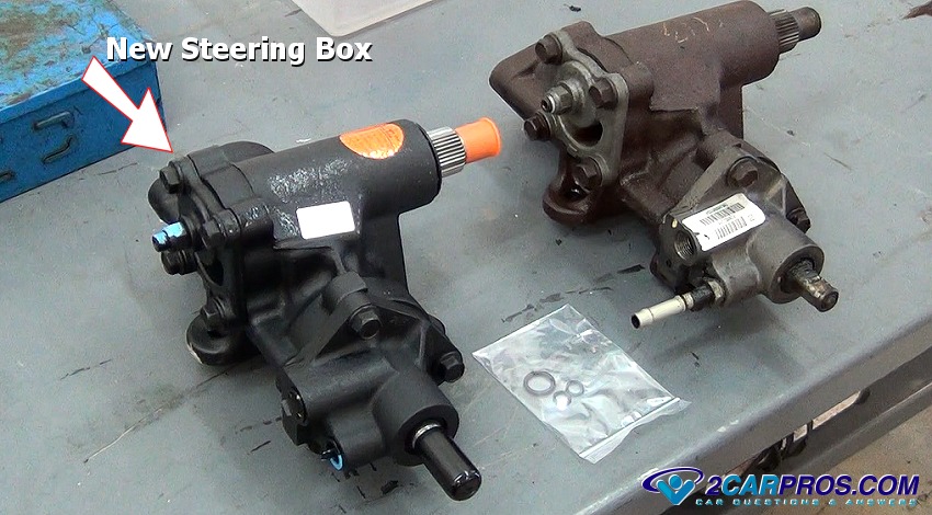

If your car has power steering in one direction but not the other this means the power steering rack and pinion, or steering box needs to be replaced.
new power steering box

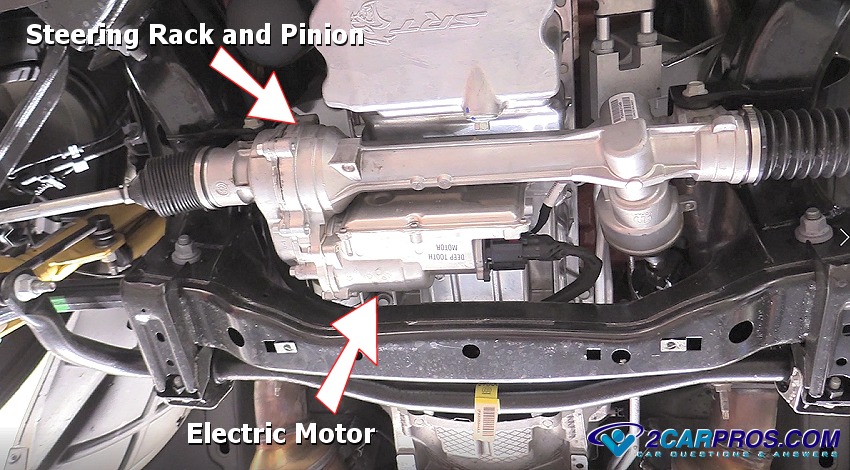

EV's and some conventional gasoline vehicles are equipped with an electronic steering system which can be assisted with an electrical motor or completely electrical (no shaft connecting the steering wheel to the rack). In either case, the system can malfunction due to a blown fuse, sensor or main controller failure, or electrical motor can wear or short out completely. If a failure occurs and the fuses are okay, a regular code scan will be needed. If no codes are present a more in-depth CAN scan (controller area network) to identify the problem. Below is an example of what an electric steering rack looks like.
electric rack and pinion
