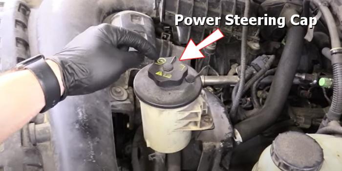

Start with the engine off, and the vehicle on level ground. Use protective gloves, clothing and eye-wear to guard against accidental spillage. Locate the power steering reservoir and remove the cap and add a funnel.
power steering pump cap

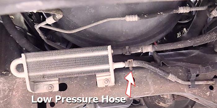

There will be two hoses, one coming and the other going from the steering pump to the steering box or rack and pinion. Locate the low side or return hose by discovering which hose is held on by hose clamps. The high pressure hose is always bolted together with fittings so you can't mix them up. In this case there is a fluid cooler attached to the low pressure side, most low pressure hoses go to the rear of the pump or fluid reservoir.
low pressure power steering hose

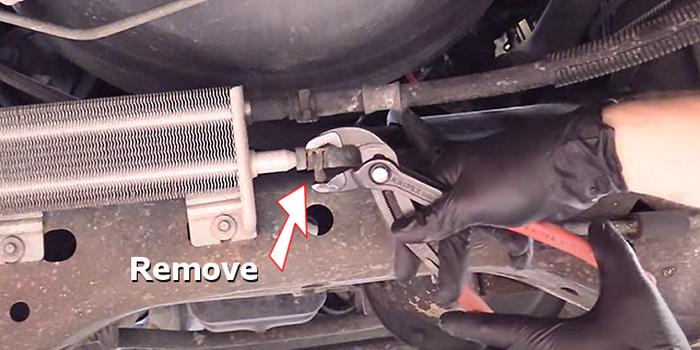

Using a hose clamp removal tool or pliers remove the hose from the fitting, fluid will start to leak out draining the power steering fluid reservoir, this is normal.
remove low side power steering hose

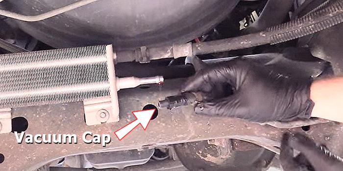

You will need to plug the low side line leading to the reservoir, this is so when you refill the reservoir to perform the flush it doesn't leak out without going through the pump. Here we used a vacuum cap but you can use anything that will stop the fluid flow.

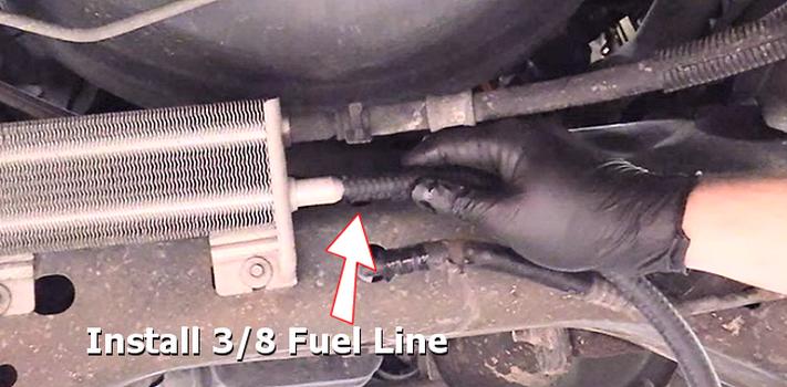

Connect a piece of 3/8 fuel line to the low pressure side return line, while the other end is sitting inside a fluid catch basin or bucket. Here we use the power steering fluid cooler but you can use the return line from the rack or steering box.
install fuel line power steering

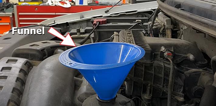

Install a funnel into the fluid reservoir, this will help pour the fluid into the system without spillage once the flush begins.
fluid funnel

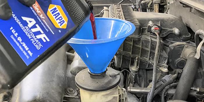

Fill the reservoir almost to the top with power steering fluid, in this case we can use transmission fluid which is basically the same thing.

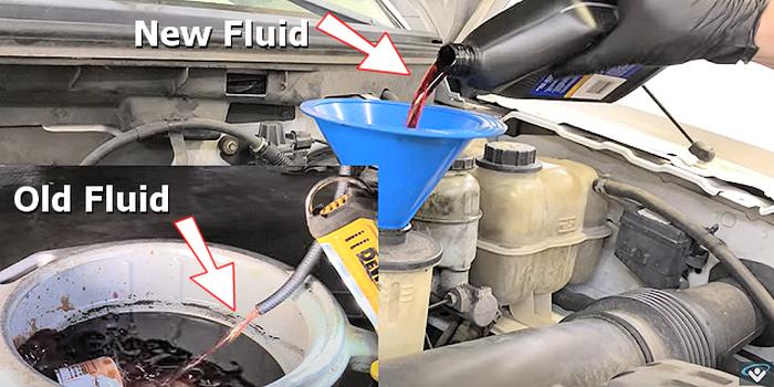

It is best to have the front of the vehicle lifted (jacked up) so there is no weight on the front tires. Have a helper start the engine and turn the steering wheel in both directions (one time) while you are adding fluid into the power steering fluid reservoir, do so until the fluid coming out of the hose is clean and clear then shut the engine off.
power steering fluid flush

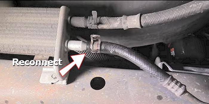

Reconnect the low side hose and position the hose clamp squarely to avoid leakage.
reeconnect power steering hose

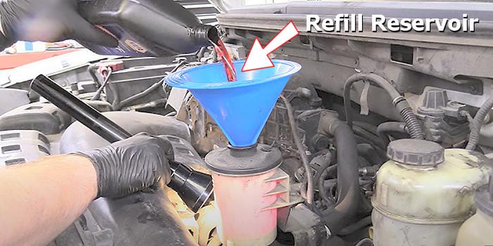

Refill the fluid reservoir with new power steering fluid and reinstall the cap, start the engine and while the front wheels are still off the ground turn the steering wheel side to side a couple of times, shut the engine off. Recheck the fluid level and add if needed. The system may make a little noise as the remainder of the air is dissipated which can take a day or two, also recheck the fluid level and check for leaks and you are all set.
refill reservoir
