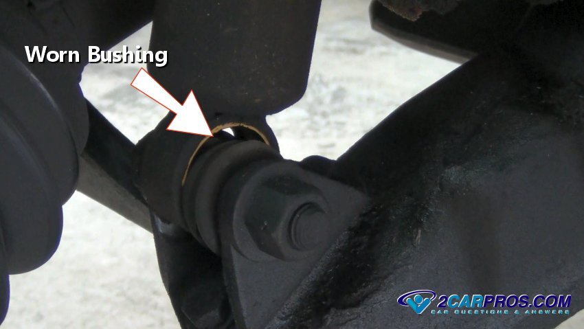

In the image below note the missing bushing at the end of this shock. This will create banging, tapping or rattling sounds when the vehicle is driven down a bumpy road. In this case the shock must be replaced because the bushing is non-serviceable.
worn bushing

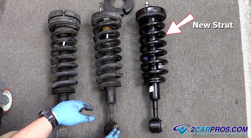

When a strut goes bad it will lose the oil from inside the unit which is detectable on the outside of the strut body allowing the mechanism inside to run dry that can cause bumping or pounding sounds, additionally there is a strut plate located at the top of the shock which is made of rubber that can also fall apart causing the same kinds of noises. The image below shows old struts which are being replaced with a new strut assembly.
new strut

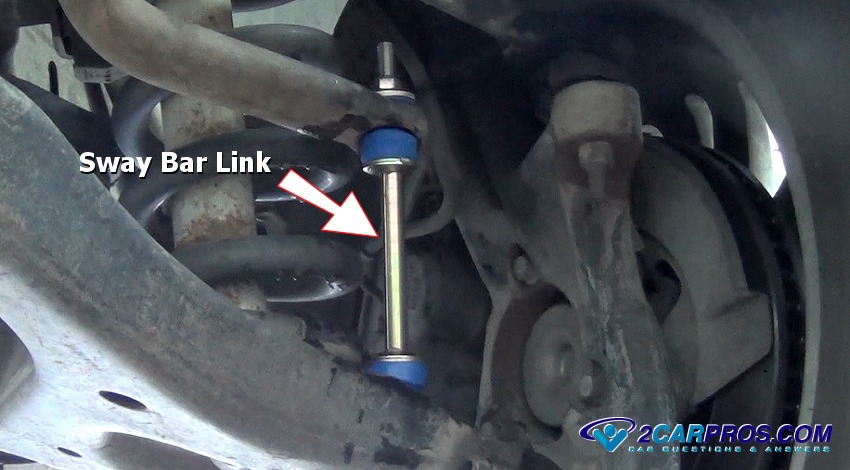

A sway bar is designed to control side roll or lean when driving into a corner and can be fitted to the front or rear of a vehicle. These sway bars are mounted to the frame and connected to the suspension arms using connecting links. If a sway bar mount or the connecting links become worn or loose it can generate a banging, popping or rattling sound. When inspecting for this problem check the mounting bolts and bushings, if the bushing is loose or completely gone the sway bar link needs to be replaced.
sway bar link

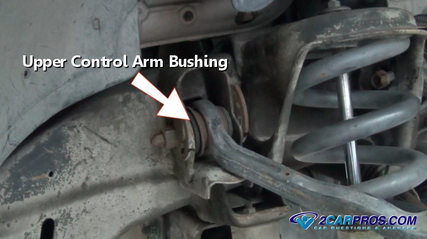

Control arm bushings are designed to allow the suspension arms to pivot near the frame mounts. These bushings are constructed of two metal collars, one large and one small with rubber molded inside. Time and usage cause the rubber inside the bushings to deteriorate allowing the suspension arm to rattle or make creaking noises. To check for this condition use a flashlight to view the upper and lower control arm bushings. If rubber is missing or pushed out they must be replaced, control arm bushings are generally serviced by replacing the complete control arm.
upper control arm bushing

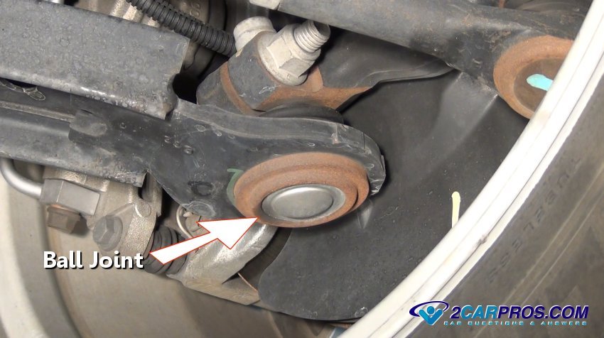

An upper and lower ball joint has two jobs, first it allows the universal movement needed when steering the vehicle, second it allows the movement to the upper and lower control arms when going over bumps in the road. This joint is constructed of a metal base in which the ball rides inside of. Both parts are made of metal and require grease to work freely. These joints are under extreme pressure and can cause suspension noises when they are worn out or need lubrication.
lower ball- joint
