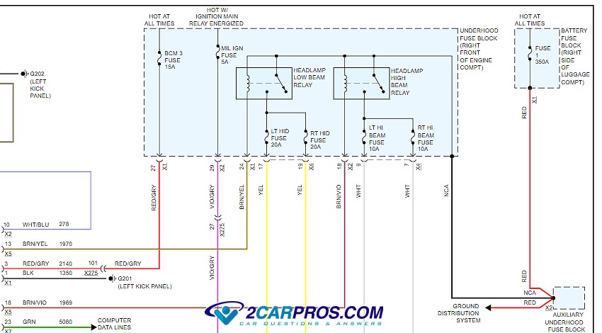

Additionally, there can be several fuses that control the system, to confirm the fuse or fuses in question a wiring diagram can be used to identify said fuses such as in the diagram below. Test and replace any fuse that fails the test (blown or bad connection).

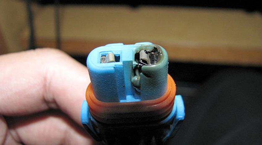

All headlight systems utilize wiring connectors that attach to the headlight bulb or lens bulkhead connector which is made of plastic, within this plastic there are metal electrical terminals that reside inside the connector. Because of the amperage pulled through the circuit these connections can heat up causing resistance and eventually and bad connection, this will happen to the power side of the circuit.
To check for this problem simply remove the connector to inspect for signs of burnt/melted plastic and discolored (dark) terminals, this is easy to see and is common. To quickly fix the problem use an Exacto or other sharp object to clean the electrical contacts on both the headlight bulb and connector. This will work temporally, the correct repair is to replace both the headlight bulb and connector.
