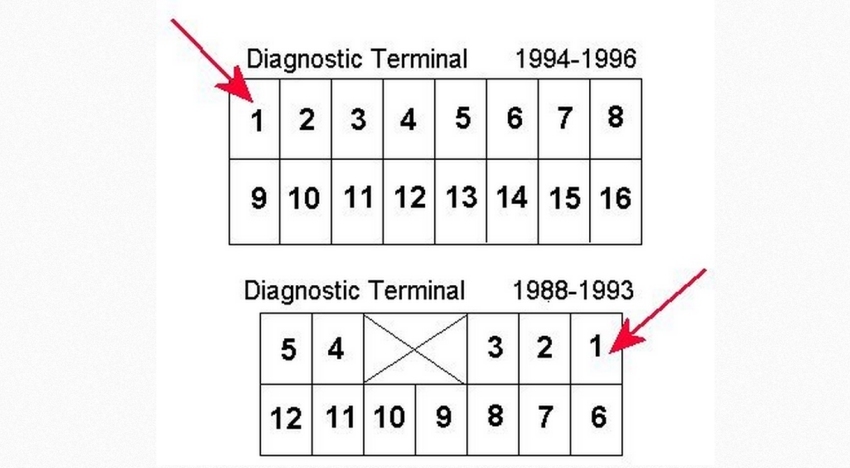

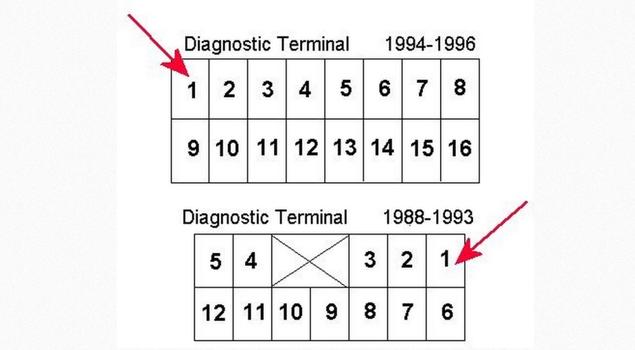

Start by locating the diagnostic connector under the glove box. The Eagle Summit connector will be in the fuse box.
eagle odb1 codes
Step 2
Ground a test light and insert the probe end into the number 1 terminal.
Step 3
Turn the ignition key to the on position and observe the test light. Long blinks represent the first position of the code number while the short blinks represent the second position of the code number. For example; if the light blinks two long times, then blinks four short times the code number is twenty four. Turn the key off and then on again to restart the test.
