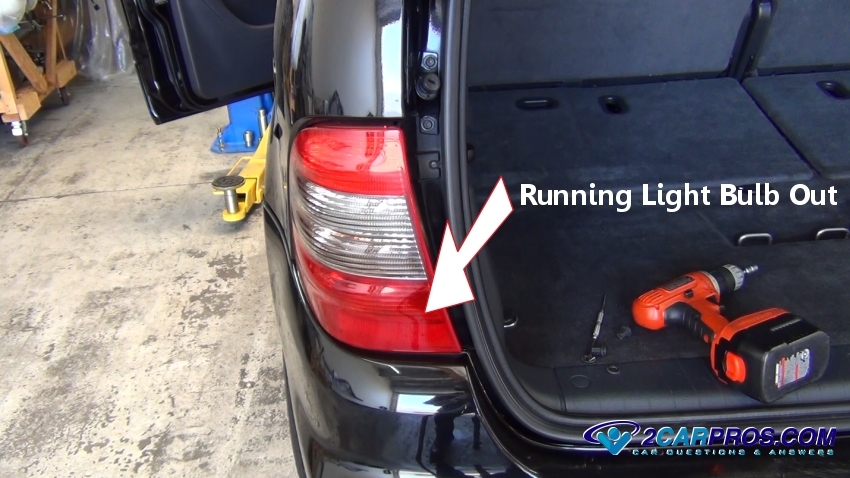

Identify the light or lights that are non operational. If one tail light bulb has failed, the problem is probably the bulb itself or a bad connection, if all lights are non-operational, follow down the guide to Step 5.
tail light out

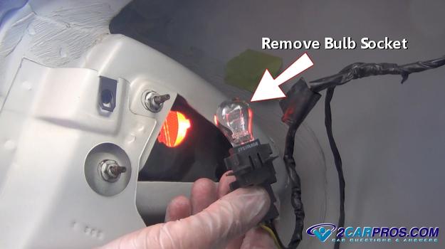

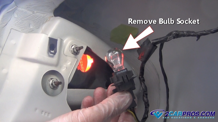

Remove bulb socket to expose the bulb for inspection, gently grasp the bulb and pull or push down and twist counterclockwise to remove, some bulbs are accessible by removing the lens itself while other require the removal of a plastic panel.
remove light bulb socket

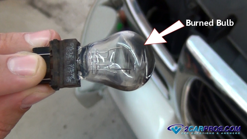

Remove the bulb and inspect, check for any burned color or white with blue smoke inside the bulb which is an indication of failure.
burned bulb

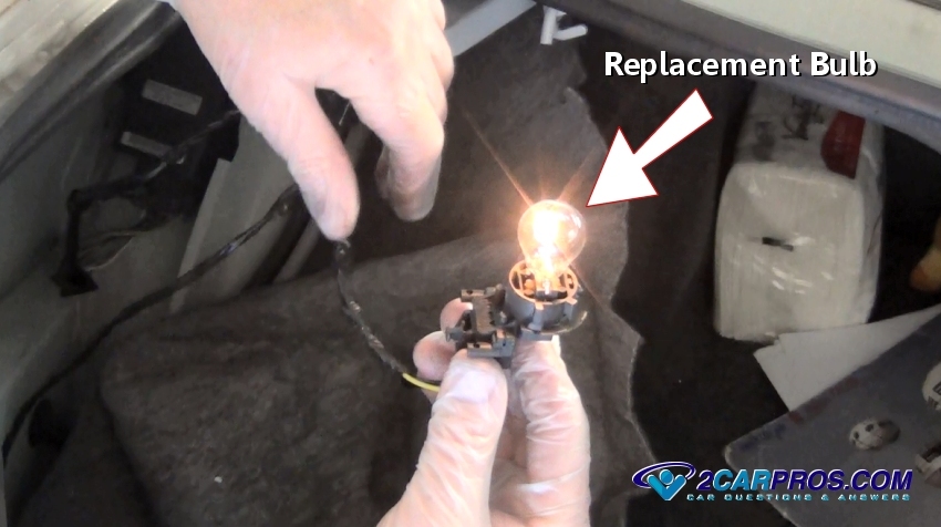

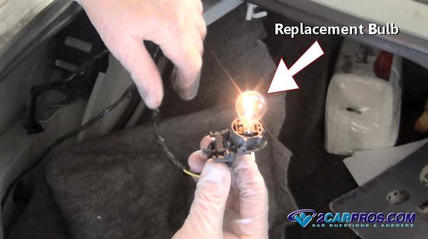

Replace the bulb with new and recheck before re-installation.
replacement bulb

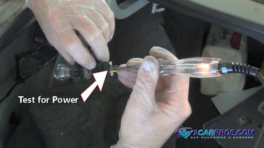

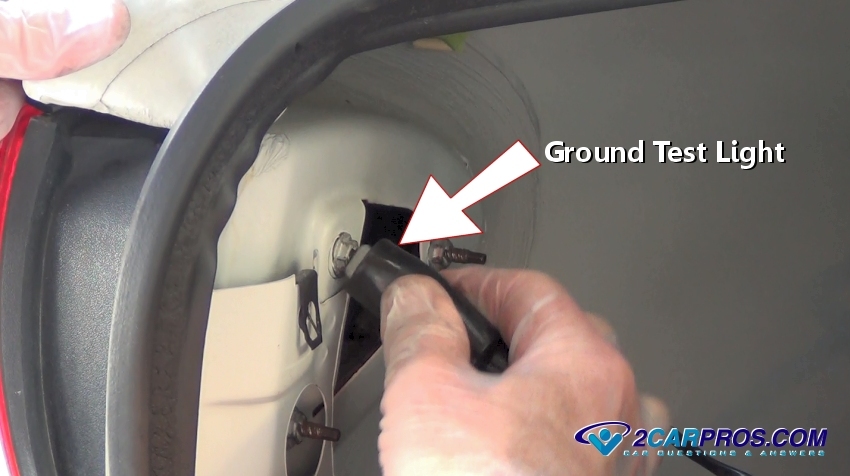

 If a new bulb still doesn't operate, use a grounded testing light to help test power feeds to the bulb.
grounded test light

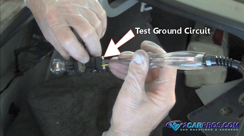

With the bulb removed (optional) and while the running lights are on, use a grounded test light to test the inner contacts of the bulb socket or wire connectors. Be careful not to touch the test light lead to the outer socket ring or to ground for this will cause a short circuit and fuse failure.
test power tail light

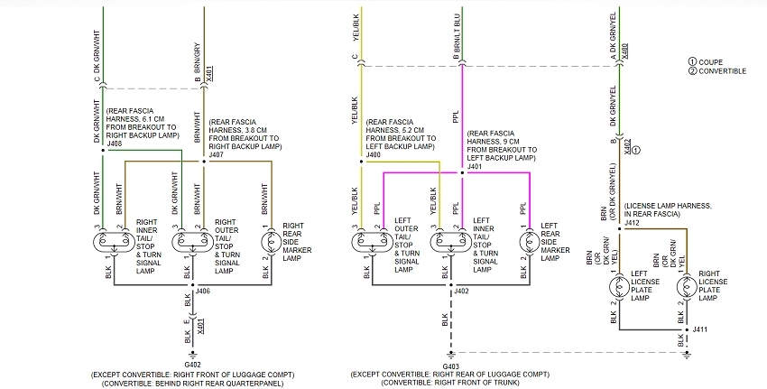

A diagram will facilitate repairs but is not needed for this test. Ask one of our experts to obtain a diagram, its free.
running light diagram

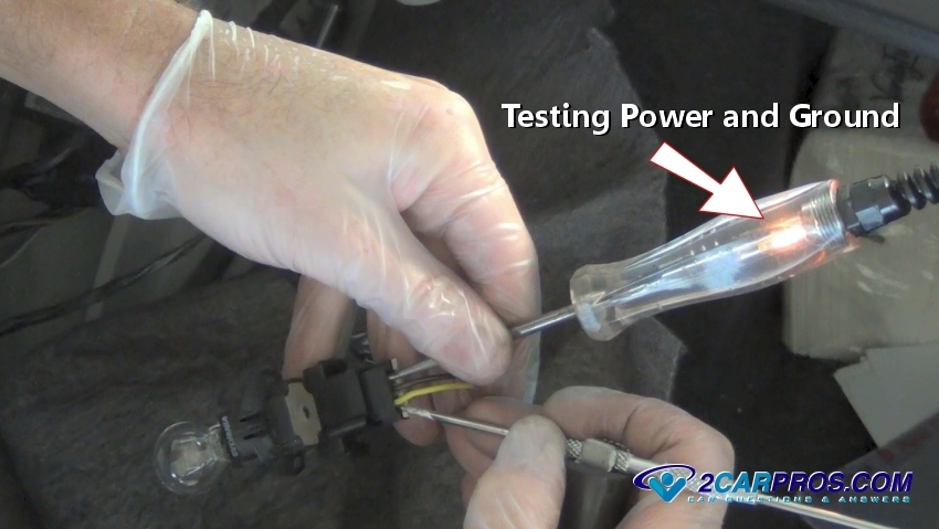

After confirming power is present at the socket, attach a pick or other pointy metal object to the test light clip, insert both probe and pick into the ground and power terminals or wiring, this test confirms power and ground at the socket.
testing light power ground

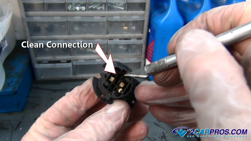

Using an Exacto blade or sandpaper, scrape clean the terminal connections that are inhibiting the electrical flow. Lighting sockets are subject to heat and can melt plastic and cause corrosion which promotes bulb operation failure, in severe cases the socket will need to be replaced.
clean connection light socket

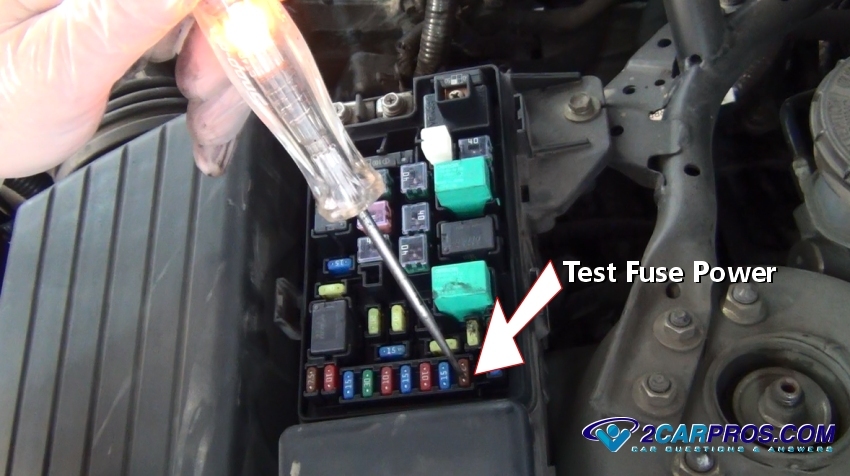

If all running or tail lights are not working, a fuse is used to protect the lighting system from overload and short circuits, anytime more than one light bulb is out, the fuse is the first place to check, these fuses are located in the power distribution center (PDC).

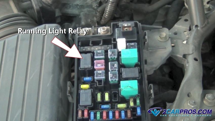

A tail light control relay is used to help shoulder the electrical draw many bulbs can cause on a single circuit, this task is carried out by the BCM (body control module). The headlight/running light switch is used as the trigger circuit which sends a signal to activate the relay. Test the relay, because when this relay fails, it will hinder the operation of the running lights.
running light relay

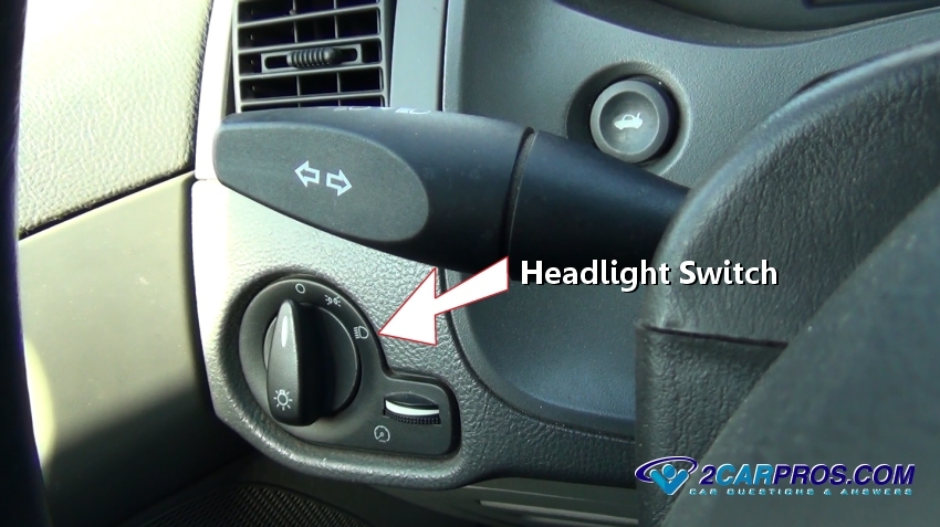

Next, remove the headlight switch to probe harness wires, the test light must be connected to positive power such as the battery which is needed to test ground circuit connections. Observe the test light while operating the switch, the light should follow the switch operation. On older cars, the switch controls headlight and tail light power, instead of grounding BCM triggers. For these systems use a grounded test light and test for twelve volts at the rear of the headlight switch connector (removed) on one or two of the terminals or wires. If no power is confirmed, repair the fuse holder or the power feed (maxifuse - fusible) from the fuse panel to the switch. If power is confirmed at the rear of the switch, turn the switch to the on position and test the remaining terminals (or wires), power should be present at the remaining terminals.
headlight switch
