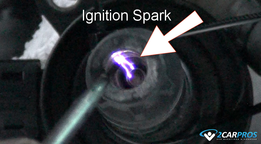

The ignition system must operate for your engine to run. If this system has issues, the engine can stall without warning or refuse to start altogether. In this guide we will go over the popular reasons of the entire ignition system to shut down. If you're having problems with just one cylinder, please use this ignition system testing guide.

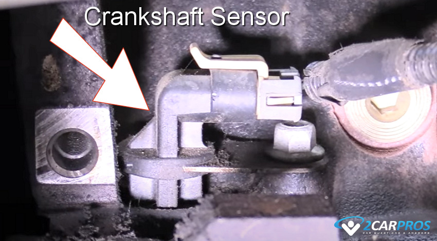

1. Faulty Crankshaft Position Sensor (CKP)
By far, the most popular reason for an engine to lose spark is a crankshaft position sensor failure. This sensor is responsible for sending feedback information to the engine computer which produces a trigger signal to each coil at the correct time which ignites the fuel air mixture. Most of the time when this sensor fails it will not leave a trouble code, the engine computer just assumes there is a mechanical problem which is not rotating the reluctor on the crankshaft.
bad ignition crankshaft position sensor

3. Shorted Ignition Coil
If the fuse is blown chances are you have shorted ignition coil, but even if the fuse is okay this can still be the problem even on multi-coil systems. This is because the short can "shut down" the coil drivers inside the engine computer. Remove the ignition coils and test, begin by set your multimeter to Ohms. Touch the positive (+) and negative (-) terminals of the coil. The resistance should be between 0.4 - 2.0 ohms (varies by manufacturer). If it's out of range or infinite, the coil is bad.
