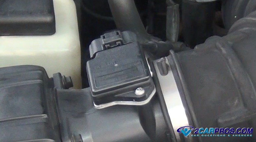

Open the vehicles hood to locate the engine's mass air flow sensor which is located either at the air filter housing or somewhere in the intake tube.

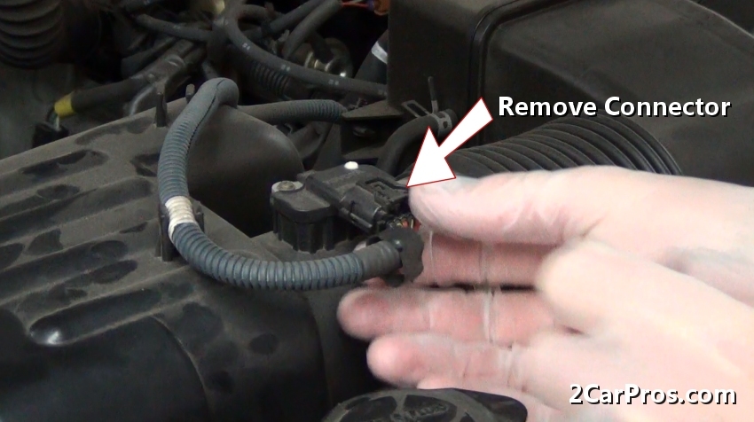

 Release the wiring connector to the sensor by pressing down on the safety and pulling the connector away from the sensor.
remove maf connector

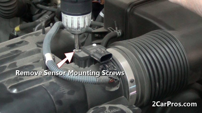

Loosen and remove the mounting screws or clamps.
removing maf mounting screws

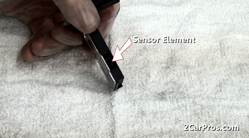

Locate the sensor element
mass air flow element

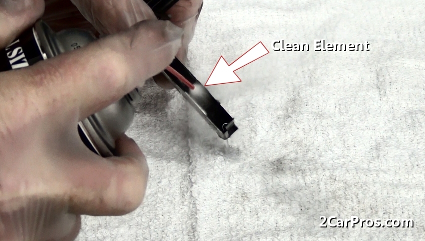

Use MAF cleaner to thoroughly clean the element and allow to dry while using a shop towel to wipe away any remaining residue. (Note: do not touch the element)
cleaning mass air flow element

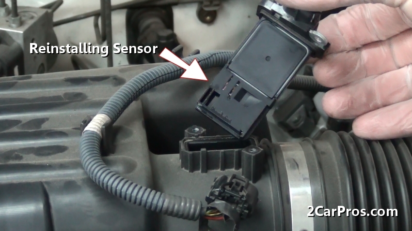

Gently reinstall the sensor back into the air intake tube or air filter housing.
reinstalling mass air flow sensor

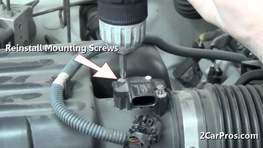

Reinsert mounting screws and tighten to specification (usually hand tight).
installing mass air flow mounting screws

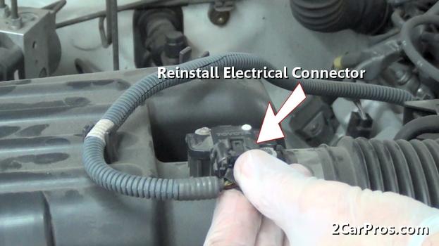

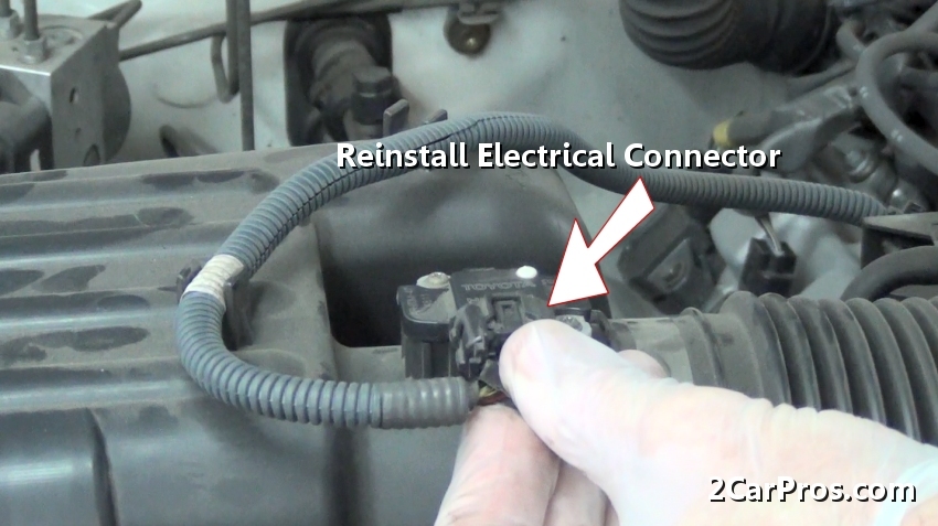

Reinsert the sensor electrical connector to complete the job. Start the engine and allow the computer to recalculate the new feedback data and make necessary adjustments. This service should be performed within an engine tune up.
reconnecting mass air flow electrical connector
