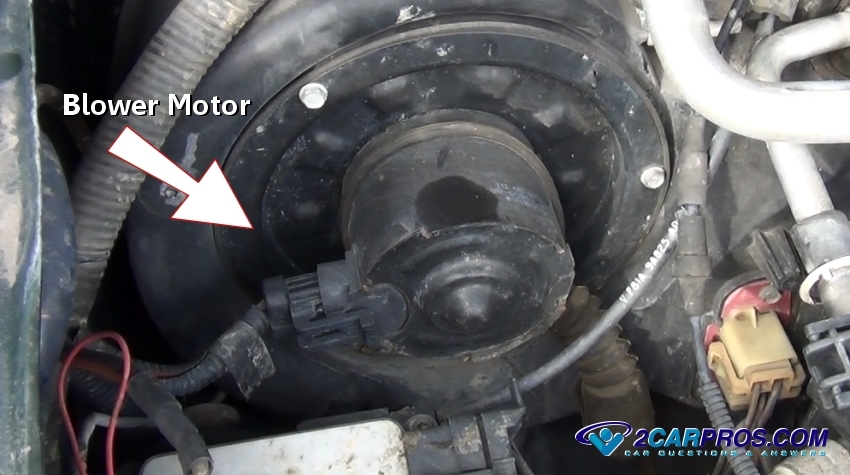

When the HVAC system is on you should be able to hear the blower motor running, this sound should change pitch when adjusting the fan speed. If no sound is heard this means the blower motor is not working, start by testing the fuse, relay, resistor or blower motor itself. If exact blower motor, fuse or relay locations are needed you can ask our experts to supply you with the information needed (free), or consult an online resource such as AllData DIY (pay).

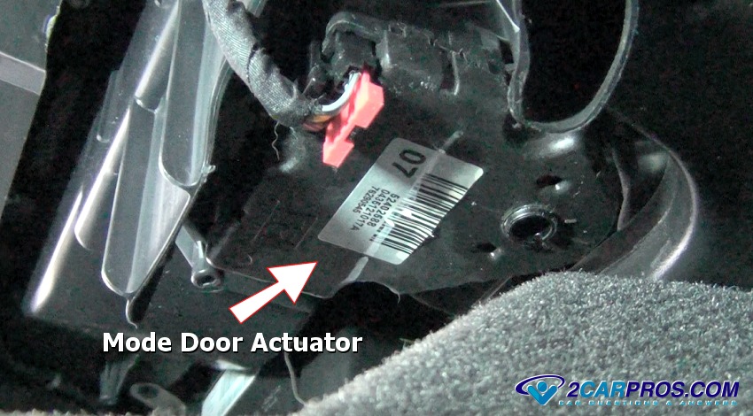

If you can hear the blower fan working but still feel nothing from the vents, or the vents are in the incorrect position this means the mode blend door actuator is not working correctly. This can sometimes be accompanied by a ticking noise which is telling you the gears inside the actuator have failed. The actuator can be found by flowing the noise, if no noise is heard the location is needed, again you can ask one of our experts for help.

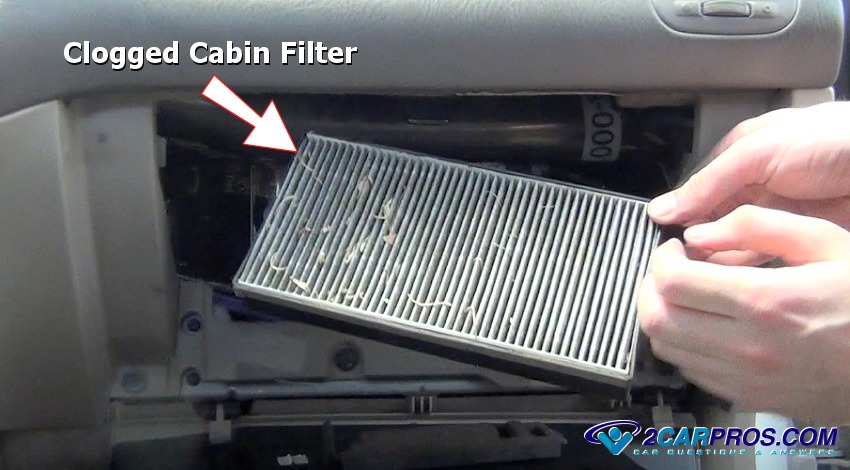

Some vehicles are equipped with a cabin air filter or Hepa filter which is designed to clean the air in the HVAC system prior to exiting the vents. When this filter clogs it hinders or stops the air flow supplied to the vents, to check the cabin filter's condition locate the HVAC housing which can be either beneath the dash or under the hood near the base of the windshield on the passenger side, remove the cabin air filter to inspect and replace as needed. To find out if your vehicle has one of these filters consult your owners manual or ask one of our experts to help.

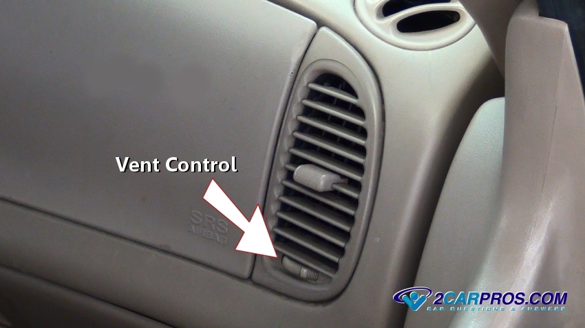

If just one vent is having problems check the flow control door that is located at the vent outlet which is controlled by a thumb wheel that when activated, will open and close the vent air flow door. Work the thumb wheel from side to side while checking the airflow which should stop and start again. Sometimes these doors can get stuck or broken which will block the air flow, in this case the vent will need to be replaced.
