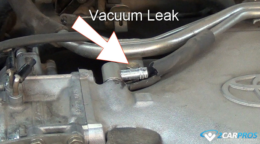

1. Vacuum Leaks: By far the most common cause of low engine idle conditions are intake manifold vacuum leaks. The intake system must be "air tight" for the engine to hold a steady idle, and if there are leaks the computer system cannot compensate for the "non metered" air entering the engine resulting in incorrect air fuel mixtures and low idle.

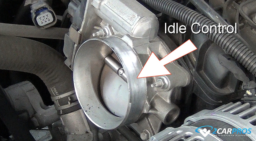

2. Dirty Throttle Body: Due to impurities in the air the engine consumes, deposits accumulate on the throttle body's butterfly valve. This contamination affects the airflow as a restriction lowing the engine idle, in this case the throttle body must be serviced which is part of the normal engine maintenance schedule.

5. Faulty Idle Air Control (IAC) Valve: Older cars, will have a valve the is designated for controlling the air flow exclusively when the engine is at idle, these valves can become dirty due to deposits of the air intake system. As part of normal engine maintenance this air intake valve must be serviced much like the throttle body for it to operate normally.
