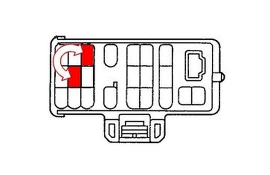

Step 1 - Locate the diagnostic connector (data port connector) under the hood, near the passenger side fender.
Step 2 - Remove the protective identification cap and wipe away excess die-electric grease. Identify the TE1 and TE terminals which are shown under the cover, and by the diagram below.
lexus data connector
Lexus Diagnostic Data Connector TE1 and TE Terminals
Step 3 - Once the terminals have been identified, insert a jumper wire.
