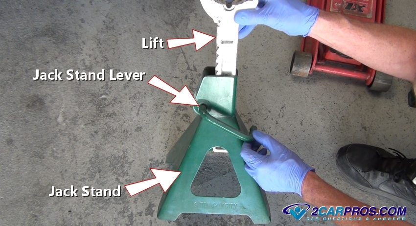

Let’s get started by jacking up and lifting your car the proper way. The first step in this process is to lift the anvil of the jack stand while working the adjustment lever this will show you how they work. Once the desired height is achieved push the lever down to lock the top in place. To re-adjust the top, lift the lever to free up the top and then once again lock it back down. To prevent failure never use old rusted or cracked stands.
jack stand

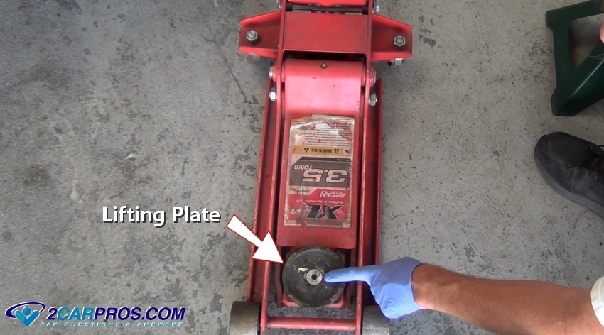

Next, inspect the lifting plate, this is what will be contacting the vehicle to raise it off of the ground so make sure it is free from grease oil and dirt. One important note here is never use a block of wood or any other material between the lifting plate and the vehicle frame, as this object will have a tendency to slip out and could cause problems, metal on metal is the preferred method.
jack lifting plate

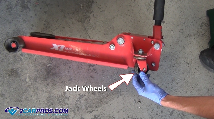

The metal wheels are important and you should make sure they are in good condition because once the vehicle’s weight is on the jack it will have a tendency to roll slightly as the vehicle raises up. If the wheels are stuck use WD40 are other lubricates to loosen them, if the wheels are missing or broken replace the wheels or get a new unit, check all four wheels.
jack wheels

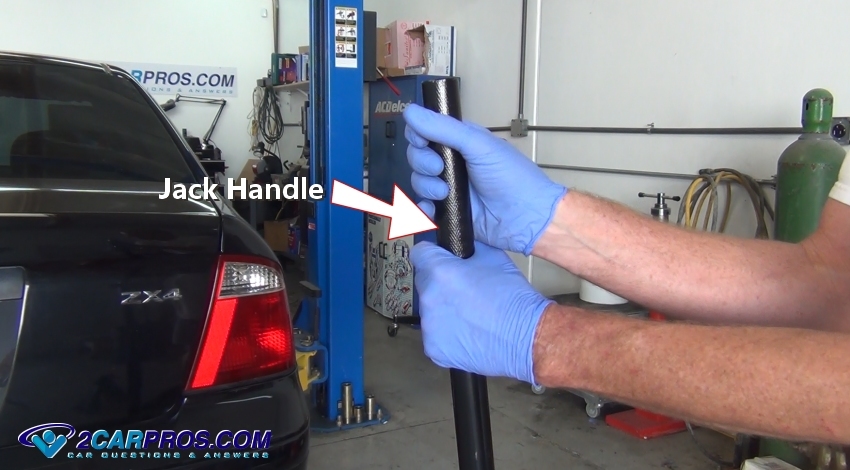

The next piece you need to know about is the handle, this handle controls the up and down movement. To make the jack go up the handle must be turned clockwise to tighten the fluid valve in the internal hydraulic pump. To have the unit go down, loosen the valve by turning the handle counterclockwise. Once you have it positioned under the car I will give you more instructions on the do's and don'ts of the operation, but these are the basics.
jack handle

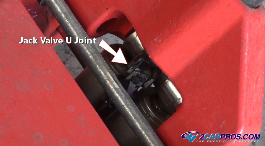

This is the valve U joint, when you turn the handle this joint turns as well which is connected to the handle. Sometimes the handle is not completely engaged so there is no connection between the two. If you have tightened or loosened the handle and nothing has happened, check to make sure this U joint is rotating with the handle, if not, re-secure the handle down into the bulkhead, you may need to loosen the bulkhead/handle set screw. The opposite end of the U joint is connected to the hydraulic pump valve which controls the fluid flow and the up and down movement.
jack valve u joint

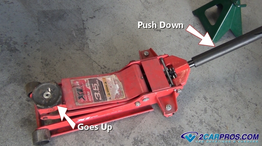

Now that we have a good idea on how it works let's test it. First close the valve by turning the handle clockwise until tight. Next push the handle down repeatedly, this will cause the lifting plate to rise with each pump of the handle. If when the valve is tight and the lifting plate will not rise up while you are pumping then it's either broken or low on hydraulic fluid. To check the fluid level, locate the fluid fill plug (usually at the rear of the hydraulic pump or near the U joint) and remove it, then add hydraulic oil or automatic transmission fluid works well as well. You will need a small funnel or tube to connect to the container to add fluid.

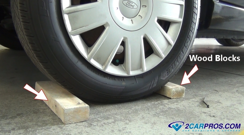

Before you begin raising your vehicle you must install wood blocks to the wheels of the opposite end of the vehicle being lifted. This is because if you raise the vehicle by the wheels that are keeping the vehicle from rolling such as the rear wheels on a rear wheel drive vehicle, the vehicle will want to move on you because the tires that were holding it in place are now off of the ground and the front wheels will let the vehicle roll freely. Pay attention to the drive wheels or the emergency brake wheels to help hold the vehicle in place.
wood blocks tire

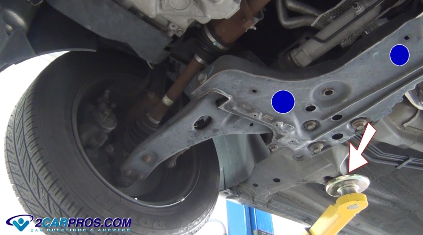

Now you know how the floor jack works and how to block the wheels. It is time to know where to and where not to place the jack stands when holding the vehicle once lifted. In the picture below it shows safe places which are shown by the blue dots and the arrow shown. The left blue dot near the control arm works well when you are just removing one tire, if you are lifting the complete front end of the car the right dot works best. The arrow also works well to raise one side of the vehicle.
safe places to jack the car up from

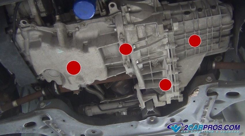

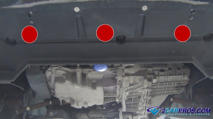

There are a lot of places that you can do damage to your vehicle when jacking it up, be sure you NEVER place the lifting plate on the engine or transmission (red dots) to raise the vehicle. To add to this list: fuel lines, emergency brake cables, CV axles, drive shaft, exhaust system and suspension components such as control arms and sway bars will cause damage.
places you dont want to jack the car up from

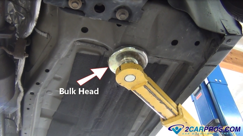

On uni-body vehicles there will be a front frame bulkhead which is the strongest place to lift the vehicle, there is a bulkhead on each side. Some vehicles will have an arrow or markings to indicate where to place the jack. Trucks, SUV's and larger vehicles will have a more pronounced frame which will be easy to see and is where the floor jack’s lifting plate should be placed. It takes a little bit of practice, but once you get the hang of it you will be able to instantly locate these safe spots to place the lifting plate.
jack bulk head placement

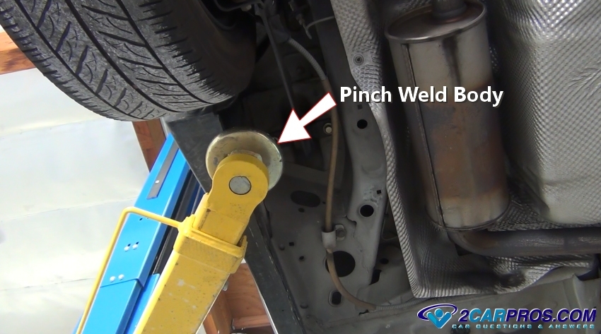

Every vehicle is constructed and welded at the bottom edge which connects the body to the bottom plate of the vehicle. This pinch molding as they call it, is welded together at the factory and provides a great place to lift the vehicle from. Never lift the vehicle from the running boards or side steps on SUV's and trucks.
lift on pinch weld body

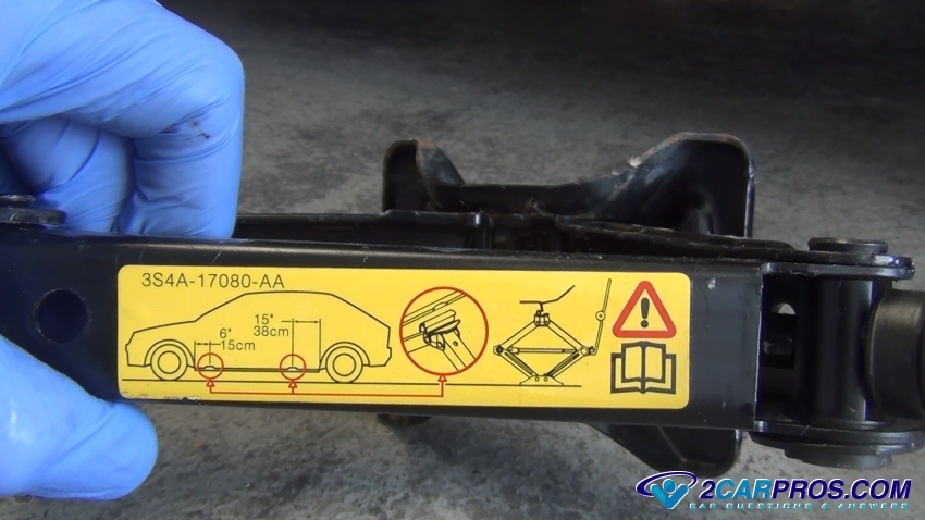

If you are still not sure where to lift the car from, check the diagram on the vehicle’s spare tire jack, or in the owner’s manual which is normally located in the glove box. This will give you specific places to lift the vehicle from.
jack placement instuctions

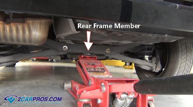

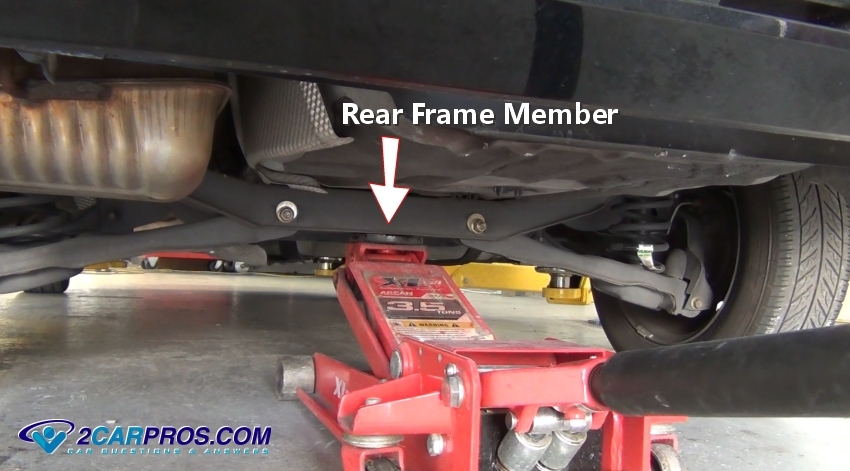

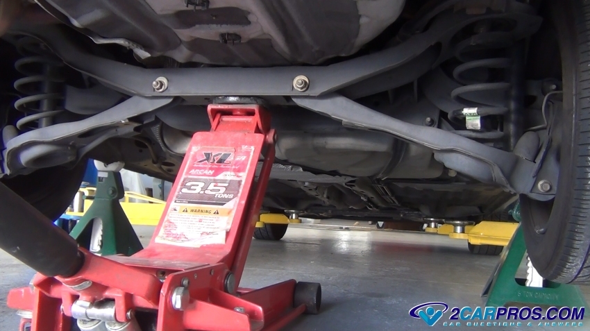

To lift the rear of the vehicle up to work on the rear brakes, shocks, fuel or EVAP system etc., locate the rear frame member for front wheel drive car’s. Position the lifting plate directly under this frame, tighten the handle and start to pump until contact is made, be sure the lifting plate is centered on the frame, this will help it become more secure while lifting. Do not add wood blocks, these can break and split, causing problems, metal on metal is the safest way.
jack up rear frame member

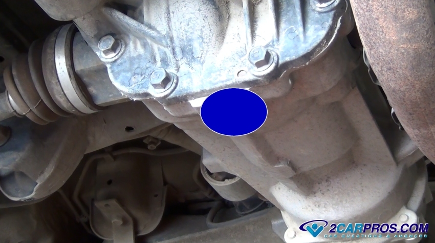

On rear wheel drive vehicles and trucks the center of the differential is the safest place to raise the vehicle from. Center the lifting plate directly under this point to raise the entire rear of the vehicle. This position works on both straight axle and independent rear suspension vehicles.
differential jack lift point

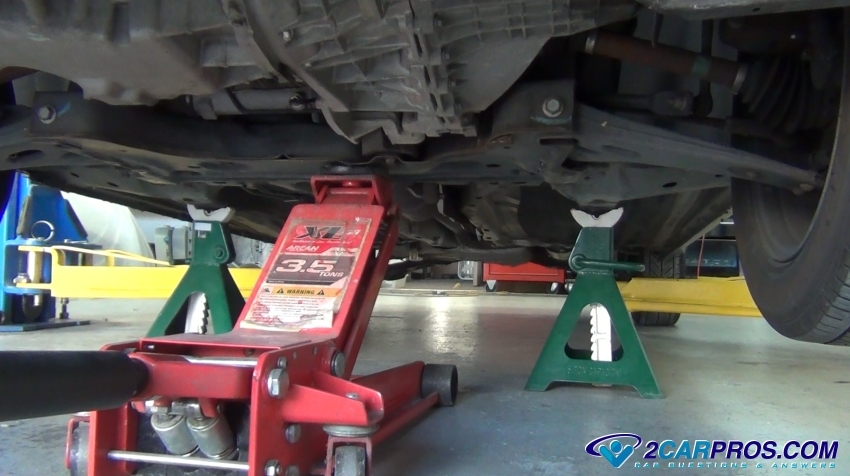

This is how the vehicle should look when properly lifted and secures with jack stands. There is no need to remove the hydraulic jack, you can just leave it there if it’s not in the way while work is being done such as replacing brakes. NEVER GET UNDER A CAR WITHOUT JACK STANDS! A vehicle is very heavy and trusting the floor jack alone is not wise.
rear car lifted with jack secured by jack stands

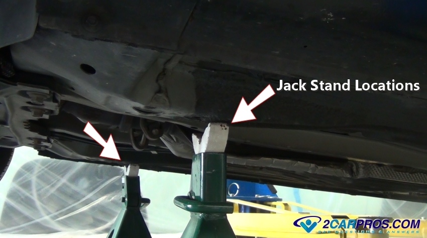

Once the front is lifted, position and adjust the jack stands under the main frame, bulk head or pinch welds of the vehicle. Here’s a great safety tip; when you are working on a job that includes removing the tires, after you have removed them lay them down flat under the vehicle, this will give an added layer of protection against the vehicle falling all the way down to the ground.
jack stand locations

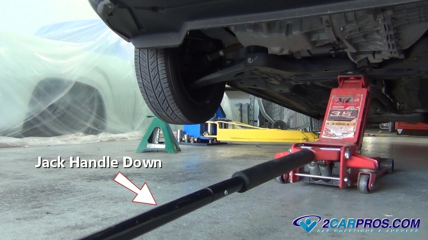

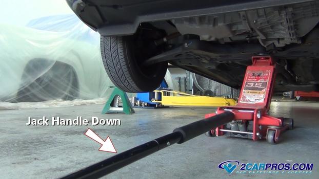

Once the job has been completed it’s time to lower the vehicle down. First raise the vehicle up and off of the stands then remove the stands and slowly lower the handle completely and slowly turn the handle counterclockwise. This can take some practice because if you loosen the handle too quickly the vehicle will drop abruptly; the best practice is to lower the vehicle slowly. The reason for the handle being low is to avoid contact with the vehicle when it’s being lowered down. You are all set better informed about how to raise and lower a vehicle then most, I hope you enjoyed this article and video please visit use anytime we are here to help you fix your car right.
jack handle down
