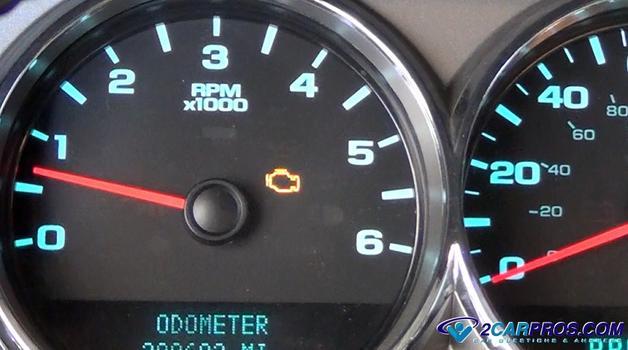

If the warning light comes on there are basically two different scenarios to look for. First, if nothing seems to be wrong with the engine or transmission and the car is driving okay it most likely means a non-invasive sensor has failed or a simple mechanical failure is present such as a small vacuum leak. You can continue driving without additional damage to any components. This is because the computer is equipped with a predetermined value for each sensor which enables the engine to keep running without an issue. The computer will store this problem in the form of a trouble code, this gives you time to get the car to the repair garage or read the codes yourself and perform the repairs.
Not Safe to Drive?
The next set of situations are either right before or just after the check engine light has come on, and you hear or feel something strange in the way the engine or transmission is operating. The first thing to look for is the reading on the engine temperature gauge or if the engine temperature warning light is on, in this case you must pull over in a safe area and shut the car off. This will save the engine from serious internal damage. If you can feel the engine misfiring it can cause the catalytic converter to overheat and melt internally due to the unburnt fuel being processed which will require a catalytic converter replacement. The car's computer also monitors the automatic transmission and can tell if the transmission is slipping. This could be due to a loss of fluid in which case if you continue to drive the transmissions can burn up which would require a full transmission rebuild.
