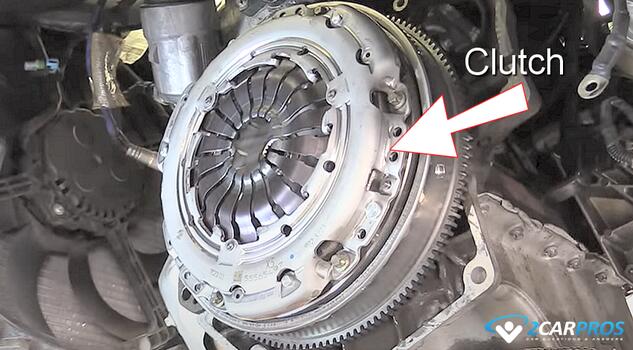

The clutch assembly is mounted to the flywheel, which is located between the engine and transmission. The clutch disc is designed to disengage, and then re-engage power from the engine to the transmission so you can start off, change gears and stop the car without the engine stalling. This guide will take you through the detailed workings of an automotive clutch, explaining each part’s function and how the clutch system operates to engage and disengage power.

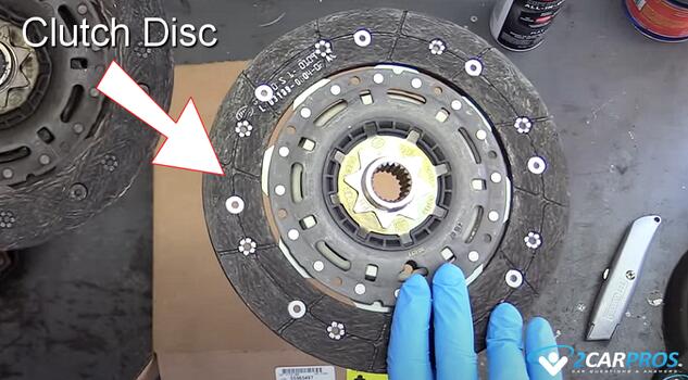

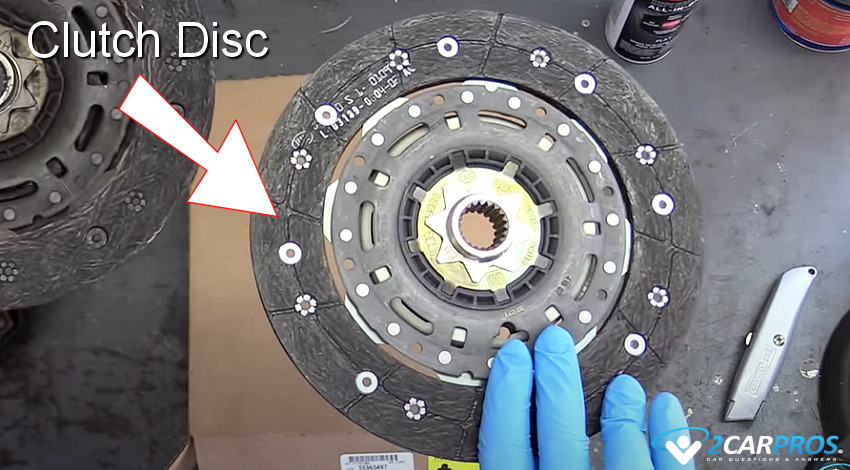

1. Clutch Disc: The clutch disc is fitted between the flywheel, and the pressure plate, which is lined with a metallic/asbestos material much like a brake pad. This lining eventually wears out and the clutch starts to slip, this is why the clutch is normal wear item. When a vehicle is in gear but stopped, the flywheel and pressure plate rotate at engine speed while the clutch disc is not spinning, allowing you to shift gears without grinding. Here is what a typical clutch disc looks like:
automotive standard transmission clutch disc

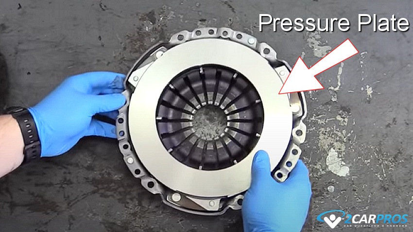

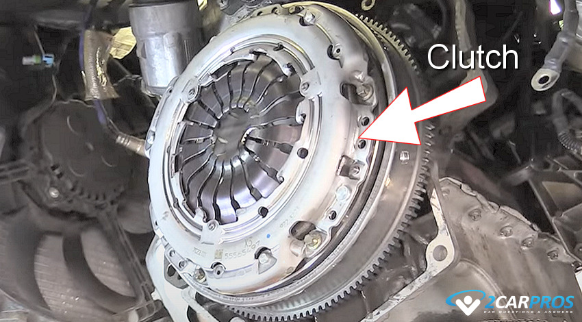

2. Clutch Pressure Plate: Is the other main part of the clutch assembly, which is bolted to the engine flywheel and holds pressure against the clutch disc (engaged) which in-turn transfers engine power to the transmission's input shaft, this is the part where the throwout or release bearing rides on.
automotive standard transmission clutch pressure plate

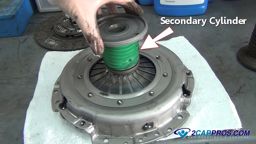

2. Clutch Secondary Cylinder The secondary cylinder can be located in two different positions near the front of the transmission, either it will bolt to the outer part of the transmission bell housing and use a clutch fork to operated the throwout bearing, or it will be integrated into throwout bearing which is mounted to the transmission input shaft bearing retainer, (more popular).
automotive standard transmission secondary cylinder

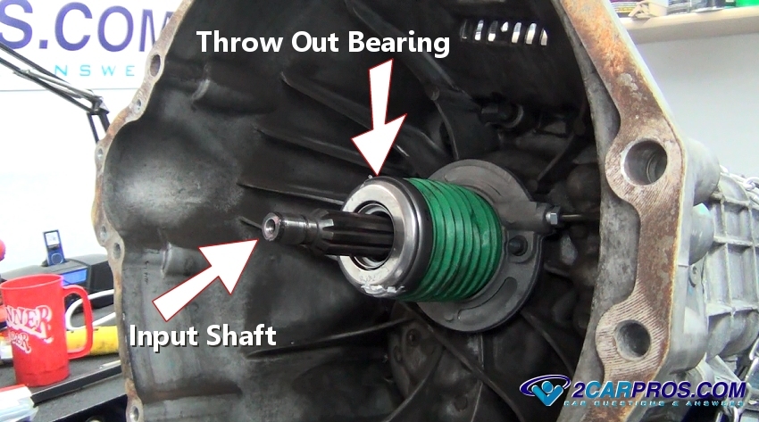

3. Throwout Bearing: This bearing is used to ride against the pressure plate fingers and actuate the clutch assembly. When the secondary cylinder is actuated, it forces the throwout bearing against the pressure plate fingers pushing them inward which releases the clutch disc.
throw out bearing

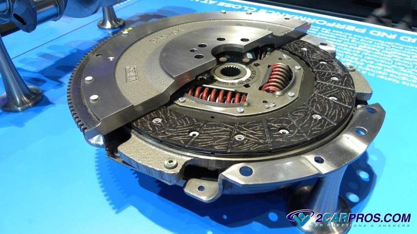

This is a picture of a cutaway so you can see what the clutch assembly looks like all together.
clutch cutaway

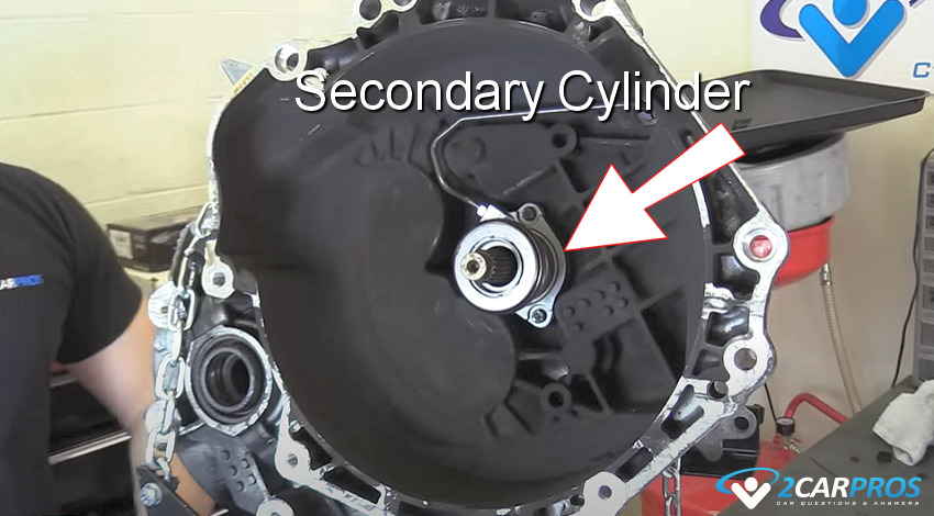

Here is what the throwout bearing position looks like inside the transmission bell housing.
secondary clutch cylinder
