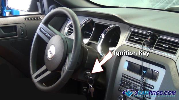

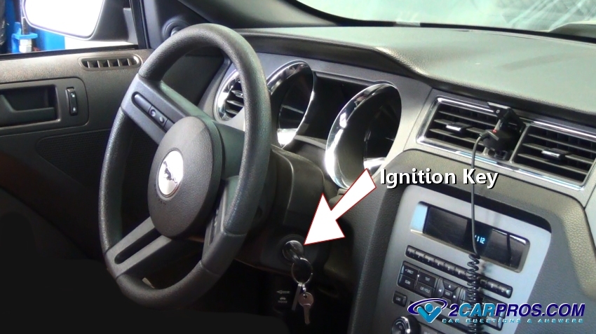

Step 1 - All vehicles have a steering wheel lockout safety device that will not allow the steering wheel to turn when the key is in the "OFF" position.
ignition key

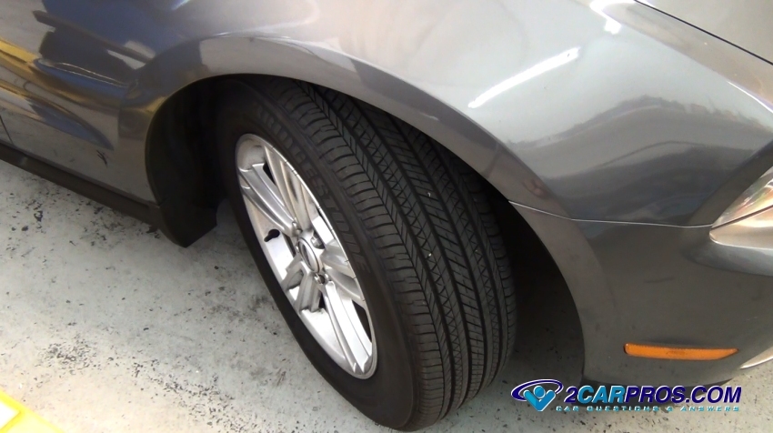

Step 2 - Vehicles equipped with power steering utilize a pump which maintains pressure while the engine is running. If the front wheels are turned when the engine is shut off, the system loses pressure and forces the steering against the lockout pin.
wheels turned

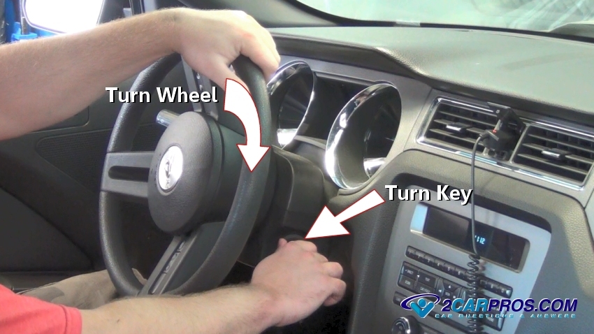

Step 3 - In this case grasp the steering wheel and apply pressure in the same direction as the wheels are turned, the lock pin will be relieved allowing the ignition key to be turned.
turn wheel key

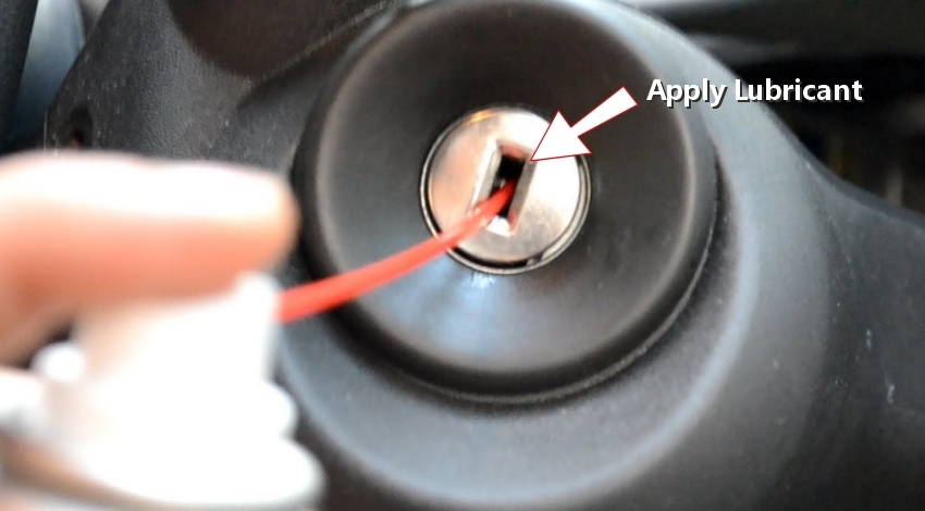

Step 4 - Dirt and debris inside the key lock can cause the tumbler assembly to stick and jam, not allowing one or more of the key followers to operate. To service a key lock tumbler, spray pressurized air along with an aerosol cleaner into the lock assembly, once clean apply a light lubricant like liquid graphite or WD40 this can help the lock tumbler release inside the lock cylinder.
ignition key wont turn

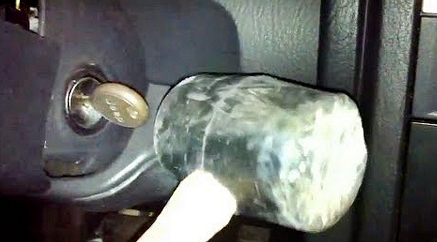

Step 5 - Though is it difficult for us to recommend, but using a mallet and striking the ignition key multiple times can help loosen the tumbler and allow the key to turn. (used caution as not the break the key off in the lock). See The Video
hammer ignition key

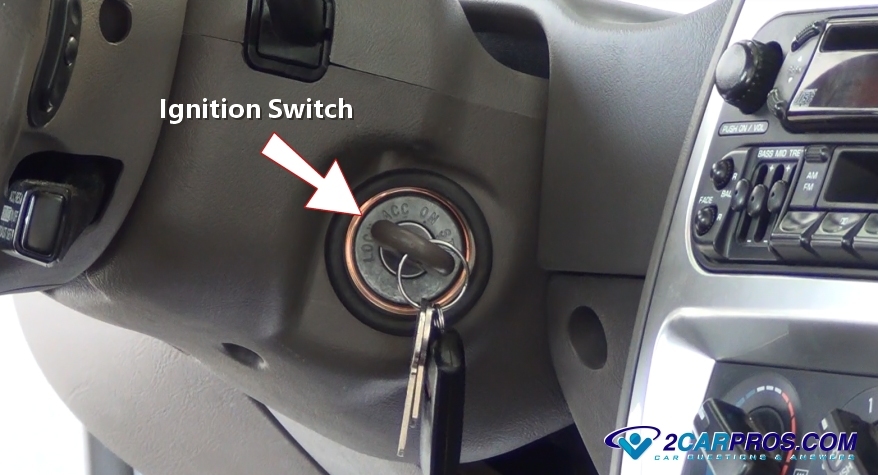

Step 6 - Due to the nature of a lock, internal components can wear causing the lock to stop operating. In this case the ignition lock must be replaced.
ignition switch

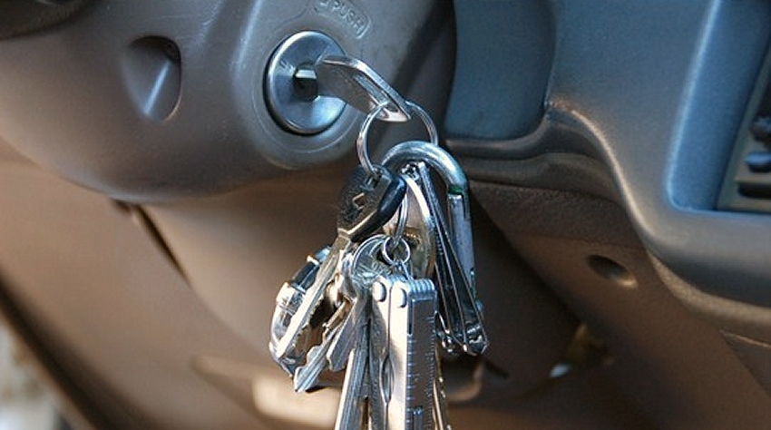

Step 7 - In extreme conditions such as high mileage or a key chain adorned with many ornaments can wear the tumbler which causes the key not to work. If the door key is same as the ignition key, the door tumbler can be removed and a key made if no security chip is installed, (older cars).
weighted key chain

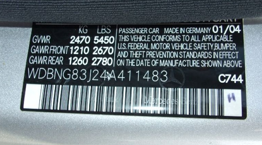

Step 8 - Most worn key problems will need a key ordered from the dealer using the vehicles VIN number.
vin number

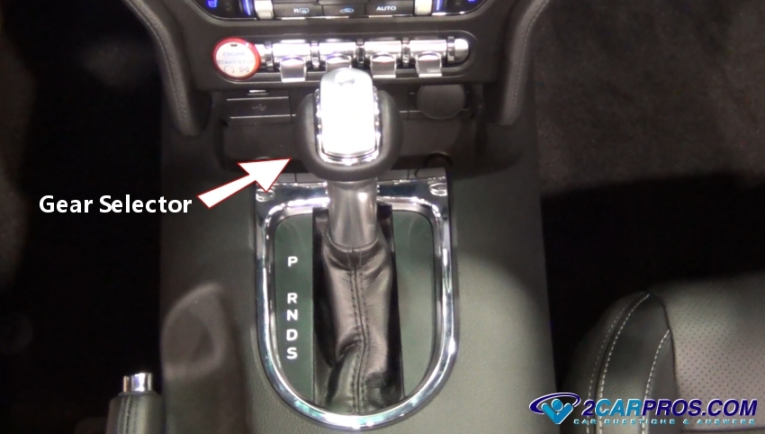

Step 9 - Most vehicles with an automatic transmission utilize an interlock cable that prevents the transmission to be moved from the park position. If the gear shift selector is not completely in park it can cause the ignition switch to jam due to interlock misalignment. To fix simply move the gear shifter from park to drive then back into park again.
gear selector
