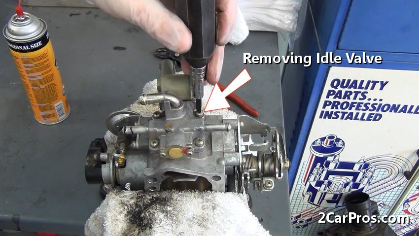

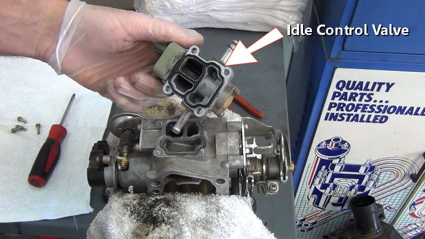

Locate the IAC valve on your engine. If your car does NOT have a throttle cable you do not have an IAC valve, this is the best way to tell what kind of system your car has. For this example we have removed the throttle bore and cleaned it, once completed remove the mounting screws to the idle air control valve. You might need to use a impact screwdriver to get the screws undone.

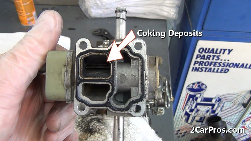

This image shows the coking condition similar to the throttle actuator/bore which causes erratic operation of the valve, stalling and high idle can be the result.

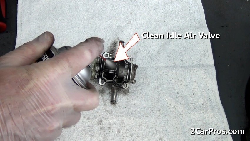

Use carburetor cleaner to spray the valves internal parts using a shop towel to help wipe away deposits (clean the valve thoroughly). This can take some time so you may need to let the valve soak in cleaner depending on the level of coking while other idle air valves need to be replaced due to internal wear.

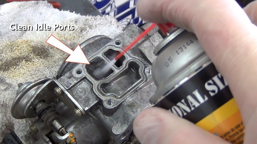

The IAC gathers air from internal ports inside the intake and throttle bore systems. These transfer ports need to be serviced as well when cleaning the IAC motor to help keep the newly cleaned valve working correctly.

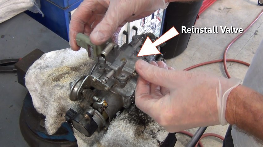

Make sure all gaskets or seals are in good shape to avoid leakage as you reinstall the valve onto the throttle bore housing and reinsert the mounting screws to tighten evenly.
