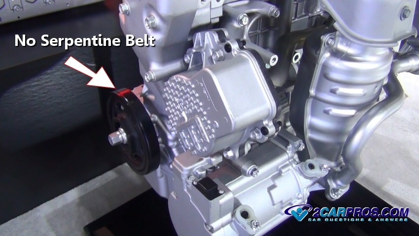

Step 2 - One of the main differences between a conventional engine and a hybrid gasoline engine is the absence of a serpentine belt to drive accessories usually handled by the gasoline engine.
engine no belt
No Serpentine Belt

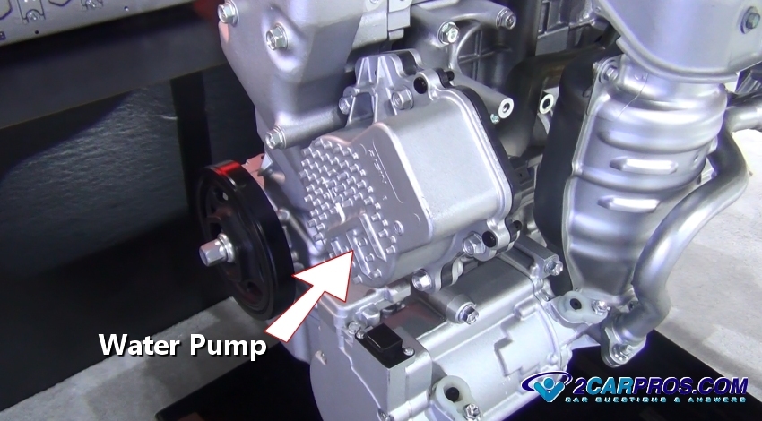

Step 3 - Because the hybrid engine needs coolant to circulate to cool, an electric water pump has been designed to operate on electric power.
electric water pump
Electric Water (Coolant) Pump

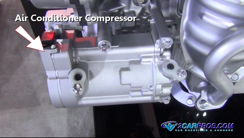

Step 4 - The air conditioner has been traditionally powered by the engine which has been replaced by an electrically driven pump which operates while the gasoline engine is not running.
air conditioner compressor hybrid
Electric Air Conditioner Compressor

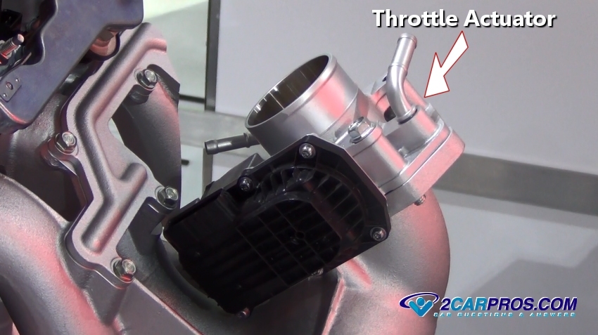

Step 5 - Hybrid engines utilize an electronic throttle control which is controlled by the computer similar to conventional vehicles.
throttle actuator
Throttle Actuator

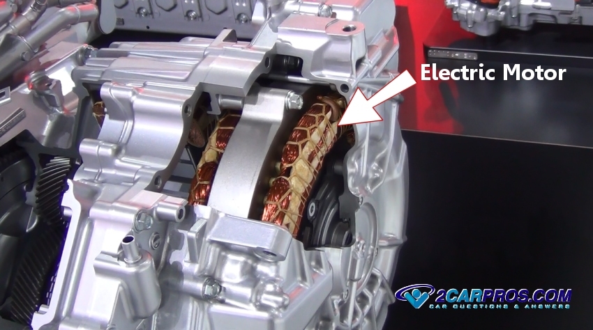

Step 6 - An electric motor intergraded into the transmission serves to propel the vehicle while in electric mode. This motor also acts as the combustion engine starter and charger much like the alternator of a conventional car.
electric motor hybrid
Electric Motor Cutaway
