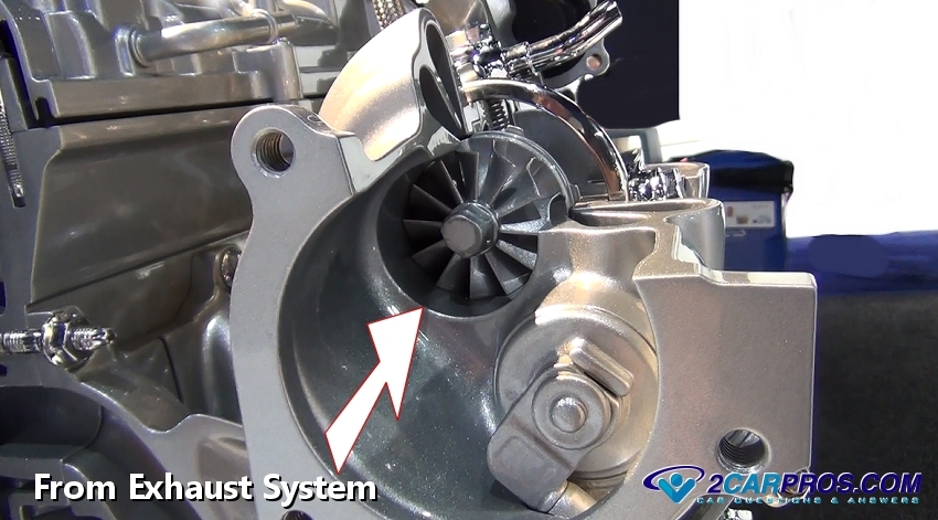

When the engine exhaust valves open red hot fire is released into the exhaust ports where it is collected into the exhaust manifold which is plumed into the exhaust side of the turbo (turbine) which causes the turbine to start spinning, these gases are then released from the turbo and back into the exhaust system, a turbo is generally located close to the engine to maximize performance. As engine RPM increases so does the exhaust system volume, both exhaust and intake turbines spin faster.
exhaust turbo

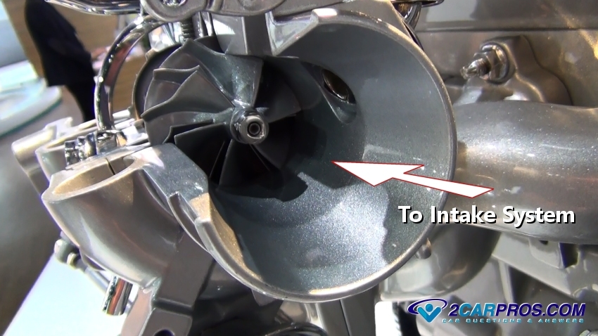

On the opposite side of the turbo there is an intake turbine which is plumbed into the engine's intake system. As the turbine on the intake side of the system spins it creates pressure (pounds of boost) inside the intake manifold which forces more air into the combustion chamber creating more power. An intercooler is mounted by the vehicle's radiator to help cool the intake air once it has been compressed by the turbocharger and before it enters the engine, the cooler the air the more it can be condensed which also produces more power.
turbo intake

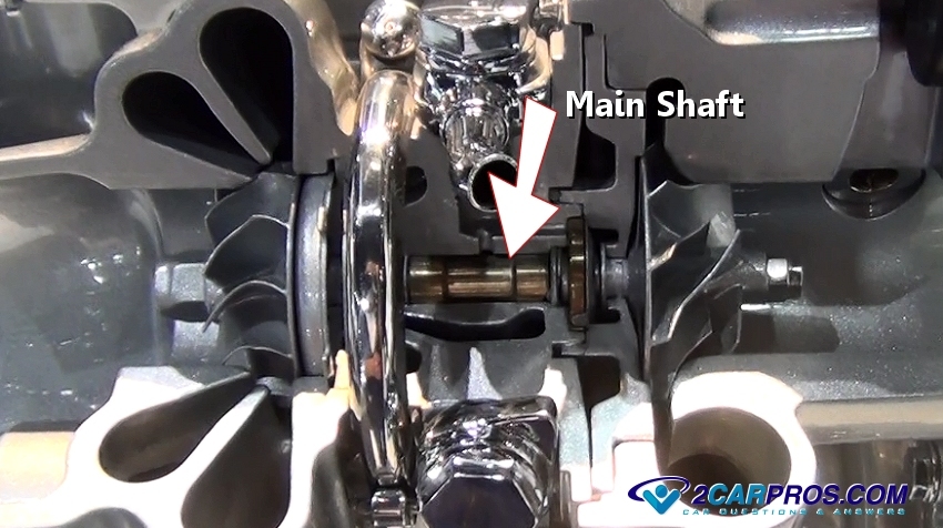

The exhaust and intake turbine fans are supported by a main shaft and two bushings within the turbocharger housing, the shaft is then lubricated using oil supplied by the engine, the oil is controlled using shaft seals to prevent the oil from leaking into the intake or exhaust sides. This is why when a turbo wears out the engine will smoke as the oil is burnt internally.
turbo main shaft

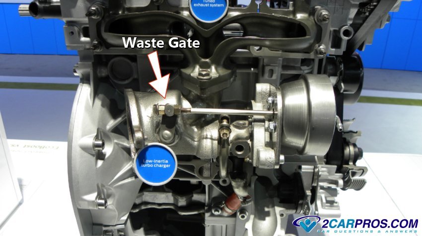

To control intake pressure or boost, a blow off valve or waste gate is used which limits the amount of power the engine outputs. If pressures become too high inside the intake manifold a signal from the computer is given to dump pressure by opening the waste gate which is activated by a vacuum diaphragm controlled by a solenoid connected to intake vacuum.
turbo waste gate
