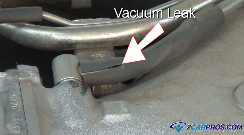

1. Lift the hood and inspect the vacuum hoses (engine off) to look for obvious cracks or breakage, be sure to inspect the PCV, EVAP systems and the vacuum line to the brake booster as well.
broken vacuum line

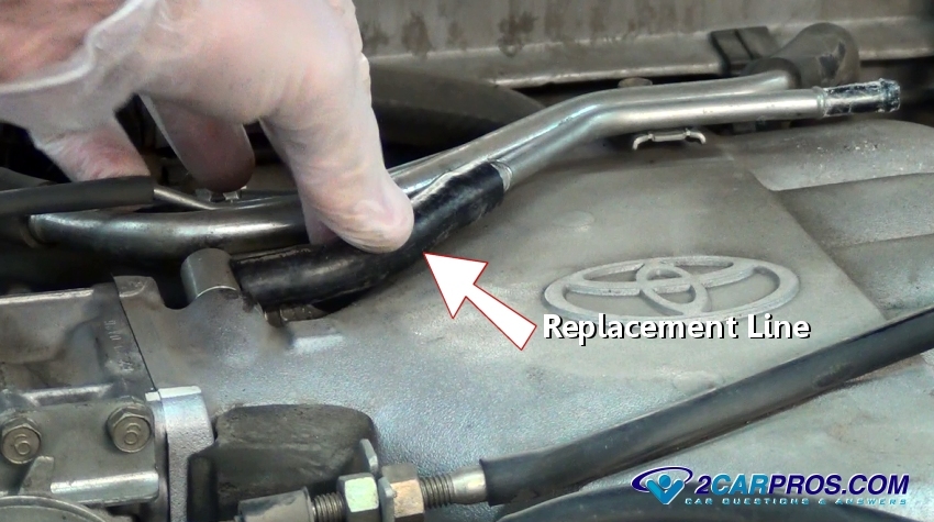

2. If a broken or dilapidated vacuum line is found remove the hose to replace the line with a new hose which you can get at any auto parts store, take the old hose with you to get the correct size.

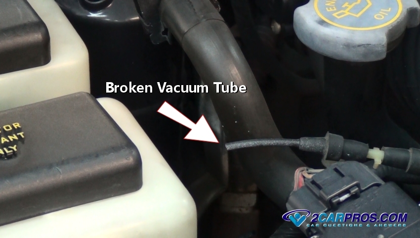

8. Check small vacuum tubes for cracks and broken pieces, these tubes provide vacuum to many accessories such as the heater/air conditioner, leaks under the dashboard or near the heater plenum can also occur.
broken vacuum tube

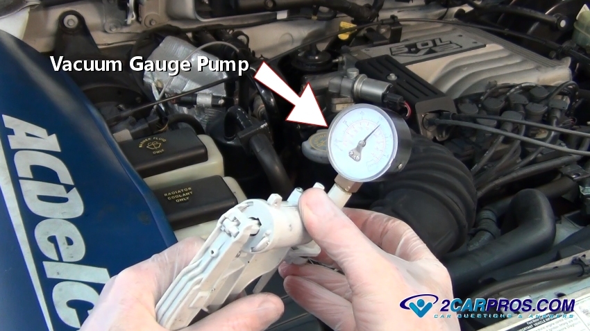

9. A vacuum tester can be used to check items such as a MAP sensor, EGR valve, vacuum canister, brake booster or a HVAC blend door actuator. Disconnect the line from the accessory and connect it to the tester, pump the tester and observe the vacuum, the gauge will raise and should hold steady if the accessory is okay.
vacuum gauge pump
