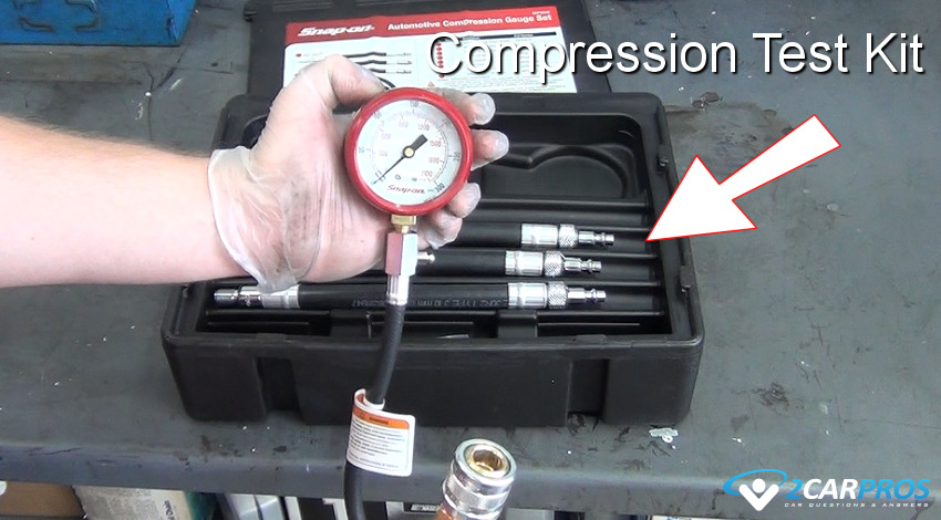

Compression Test Kit
Here is what the typical engine compression gauge test kit will look like:

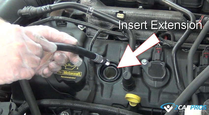

3. Insert Compression Gauge Connector: Select the correct adapter for your compression gauge by comparing the spark plug threads, then gently insert it into the cylinder's spark plug hole. Tighten the hose by hand until the O ring it seals against the cylinder head to ensure an accurate reading.

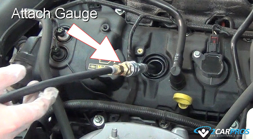

4. Attach Compression Gauge: The gauge will be fitted with a connector that will attach to the compression gauge extension hose, lift the connector ring and push downward onto the hose. You should feel a solid connection between the gauge hose and the extension hose, (Some gauges do not have an extension hose, and will directly inserted into the spark plug hole).

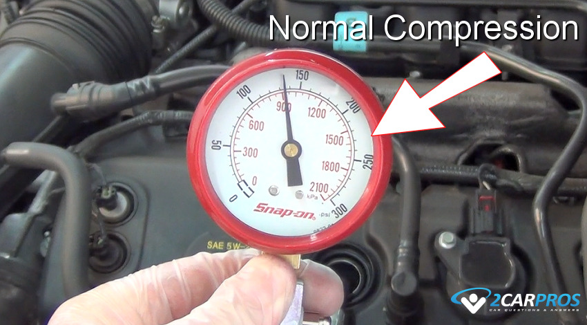

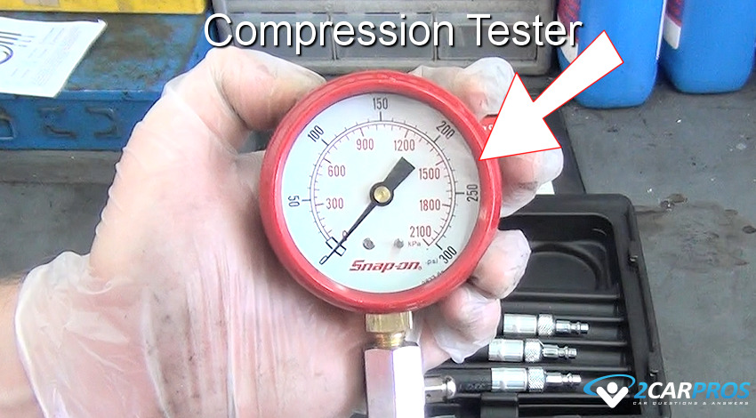

5. Crank the Engine Over: With the compression gauge connected, turn the ignition key (or push button) to crank the engine. Allow it to crank for 4-5 compression strokes (the gauge needle will typically stop moving after a few strokes), note the reading on the gauge. Typical compression readings will be between 125 psi and 160 psi. Write down the reading for the first cylinder, then press the release valve on the compression gauge to clear the pressure. Repeat this process for each cylinder, recording each reading carefully.
