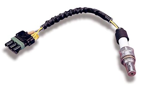

GM Oxygen Sensor
Oxygen Sensor - (appearances will vary)
