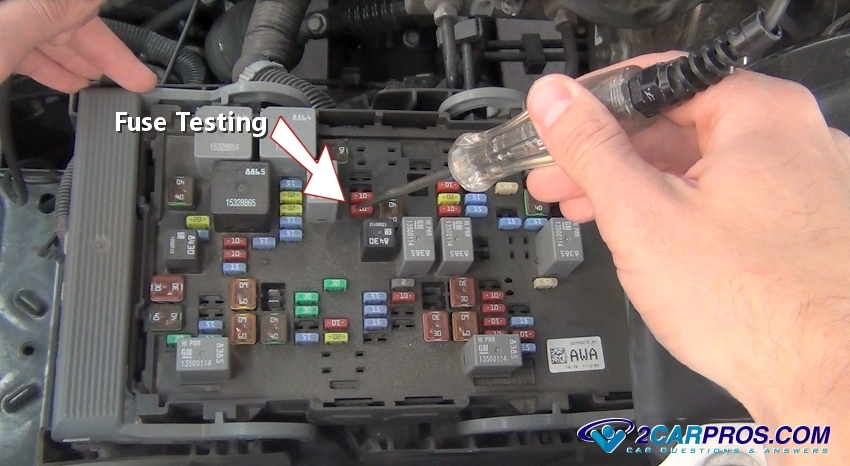

1. The blower motor unitizes power from a fuse or relay in the PDC (power distribution center). With the key in the "ON" position test the blower motor fuse which can be identified by the fuse box cover or in the vehicles owners manual. Visit - Fuse testing If fuses are okay, proceed to next step.

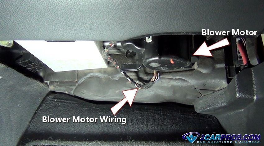

3. Locate the blower fan motor which is usually under the dash or hood on the passengers side.

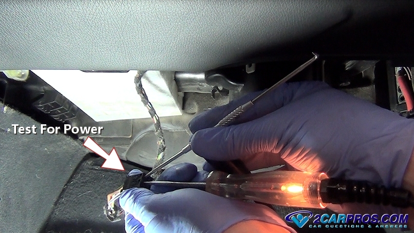

4. Locate and disconnect the blower motor wiring. Using a test light and a sharp metal object such as a hooked scribe to check for power at the connector (large wires). This test confirms power and the ground of the circuit, if the test light illuminates continue to the next step. This test can also be used by piercing the wiring harness as well.
Note: Intermitted power failure from the blower speed switch, fuse holder or climate control relay could be a problem so even though the circuit has power, its best to test the motor itself.
If the test light fails to light up, the ground or power circuit has shorted and a wiring schematic is needed to troubleshoot the problem further. If the blower motor only has one wire use a grounded test light for testing. Some vehicles are equipped with a blower motor relay which should also be checked. Please Visit - Relay Testing

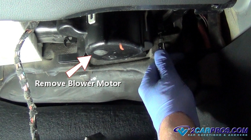

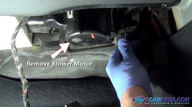

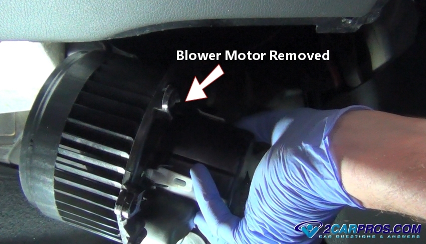

5. Once power and ground have been confirmed, locate and remove the blower motor mounting bolts.
6. Once all mounting bolts have been removed grasp the blower motor and remove it for testing.

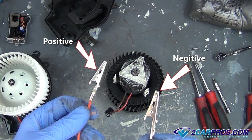

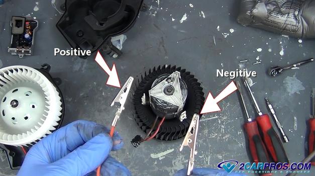

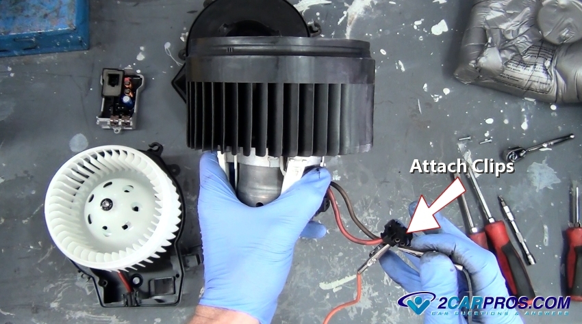

7. Prepare a positive power and negative ground lead from a 12 volt power source (car battery). Use caution as to not the allow the clips to contact each other or sparks (heat) will occur.
8. While grasping the motor firmly, attach the power and negative wiring clips to the blower motor wiring harness. If the blower motor only has a power lead attach the ground wire to the frame of the motor. Once the circuit is completed the motor will spin or will not confirming the blower motor failure. A blower motor typically fails intermittently, if the blower fan is not working and the vehicle hits a bump while driving and the blower starts up again the brushes inside the motor have worn out in most cases. Please Visit: Blower Fan Motor Failure Symptoms
