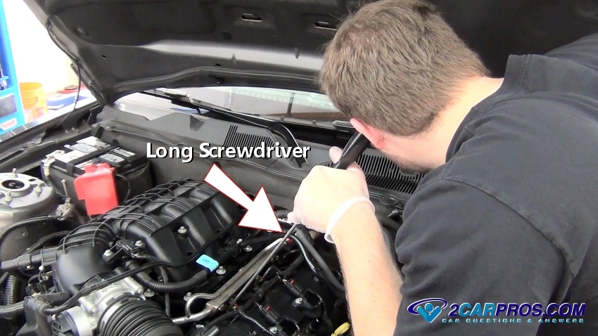

Simple Test
Start the engine and allow it to idle. Using a long metal rod like a screwdriver touch the end of the screwdriver to the injector. Gently lay an ear to the opposite end of the rod or handle to observe an audible clicking sound to confirm the injector is working.
fuel injector listen

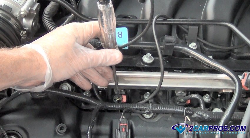

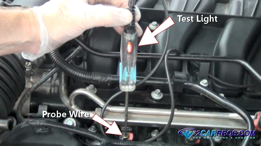

Injector Circuit Power Test
With the key in the on position use a test light or voltmeter connected to the negative side of the battery. Gently probe both sides of the injector wiring connector, one of the wires should react by registering around 12 volts on the meter or illuminating the test light. If neither wire reacts test the fuel injector fuse in the PDC. If the fuse is okay a fuel injection wiring diagram is needed to help trace the wire and repair the connection. Seal test points with a small dab of silicone rubber once testing is complete.
probe injector wire

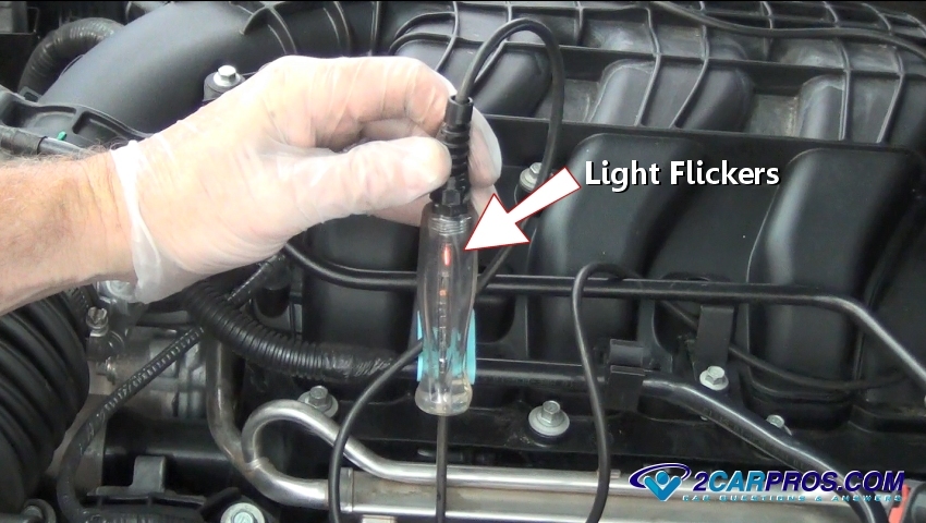

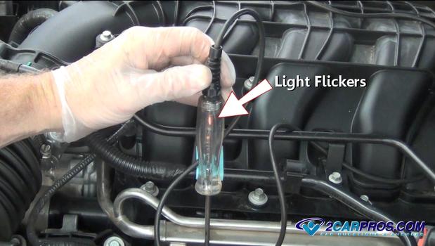

Injector Ground Trigger Test
The PCM closes the injector circuit to trigger the injector operation. For this a test light works best to observe the pulse produced by the PCM. Attach the test light lead to the positive side of the battery and have a helper start or crank the engine. Probe the opposite side of the injector connector from the power circuit, you should observe the test light flicking which will respond to engine RPM/Load. If the engine is running and no pulse is observed suspect a bad wiring connection or a failed PCM injector driver which will warrant a PCM replacement. A shorted injector can hinder the injector driver operation for additional injectors, unplug all injectors and re-test the signal. If pulse returns plug the injectors back in one at a time until the pulse fails then replace the shorted injector. If the engine is not running check the crankshaft angle sensor which the computer uses to open the injectors (Note: A failed crankshaft angle sensor will not set a trouble code in most cases).
test light flash

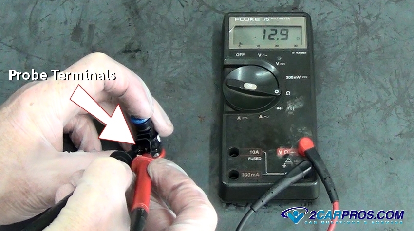

Fuel Injector Winding Test (key off)
Using a voltmeter, adjust the setting to ohms. This test can be performed with the injector installed or uninstalled.
voltmeter ohms

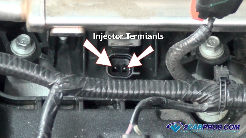

Remove the injector electrical connector
injector connector
This will expose the injector electrical terminals.
injector terminals

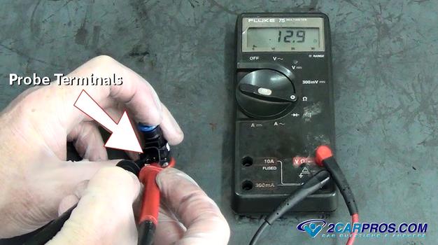

Connect the voltmeter leads to the terminals, the polarity of the leads is irrelevant. This test gives a baseline ohm reading of all injectors, a service manual also has this information. Most injector readings should range between 11 and 14 ohms. Fuel injectors should be tested cold unless otherwise specified, temperature variances will change the readings. If the test shows high resistance or an open circuit the injector needs replacement.
probe injector terminals

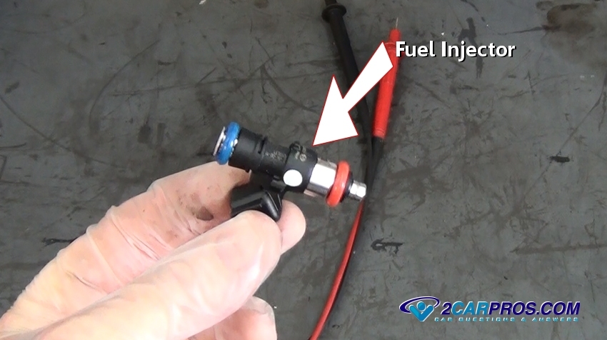

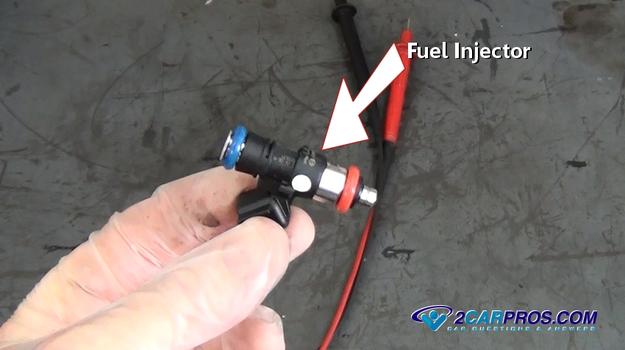

Injector Spray Pattern Test
For this test the injector must be removed. Inspect the injector housing for leaks and electrical connectors for corrosion.
fuel injector
