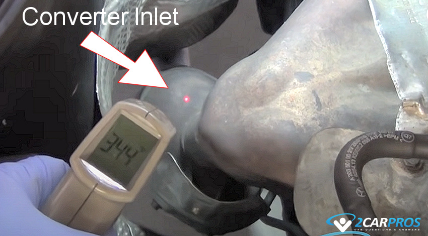

Point an infrared temperature meter at the inlet pipe as it enters the catalytic converter. If the cat is made directly into the exhaust manifold, measure the top of the canister or the upper portion while avoiding the manifold itself and take a temperature reading.
temperature reading catalytic converter inlet

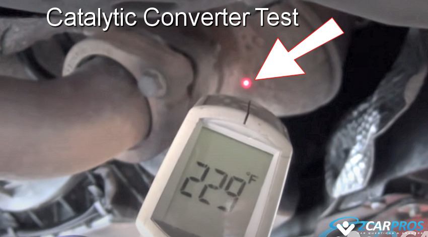

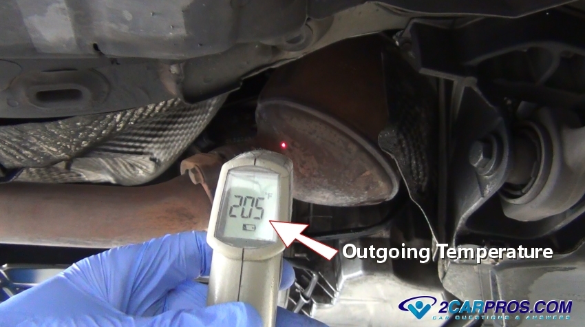

Next, do the same test at the outlet tube of the catalytic converter, the temperature should be hotter by about 20% showing the chemical reaction is working, if the temperature is colder, (as in this example) the cat is bad, (For best results have the engine running).
catalytic converter testing outgoing temperature
