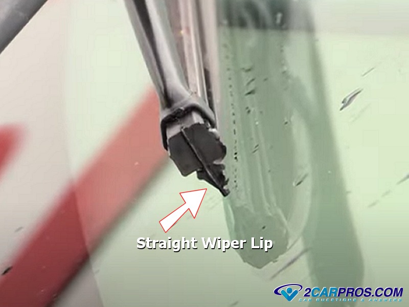

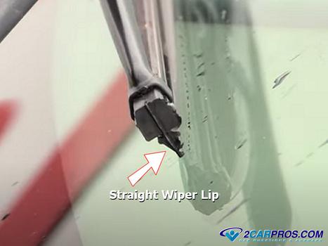

1. When a wiper is working it changes directions, back and forth, the wiper travels up the windshield and then to a stop before it travels back down the windshield face. The blade lip action must change directions as well. If the lip of the wiper stays in one direction you will get that annoying noise and diminished wiping action. While looking at the end of the blade it should be perpendicular to the glass, you can also see the wiper lip position, either straight, flopped right, or flopped left. The example below is straight.
straight wiper blade

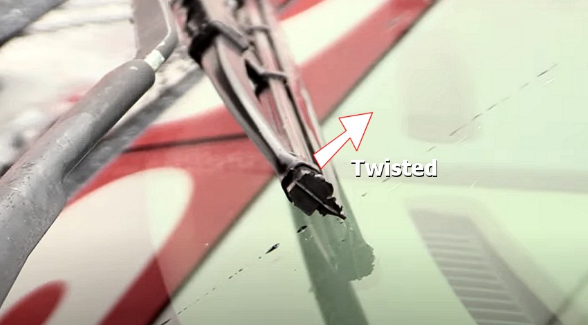

Here is an example of the wiper blade that chatters and skips while traveling upward on the windshield because the wiper lip part of the blade is forced to stay in the wrong direction. You can see the wiper arm is twisted, while looking at its reflection in the glass the entire wiper is twisted upward, this will cause the rubber to catch the glass and skip.
twisted wiper blade

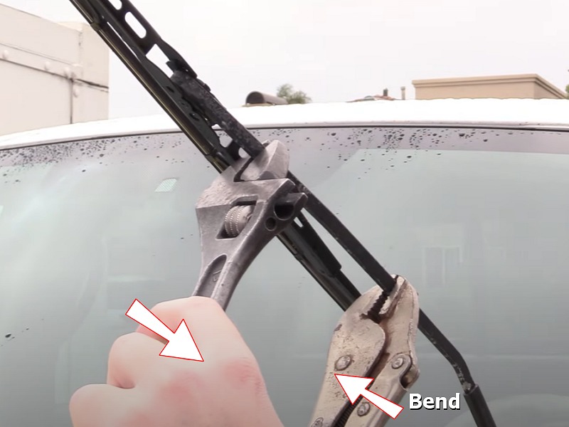

Now for the fix, the wiper arm must be gently bent, using a crescent wrench, pliers or vise grip to bend the arm so it is perpendicular to the windshield. Pro Tip: Anytime you are working with tools around the windshield lay a towel on the glass to avoid chipping or accidently breaking the windshield.
bend wiper arm

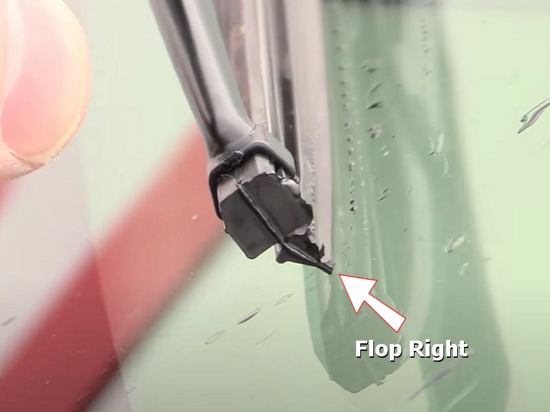

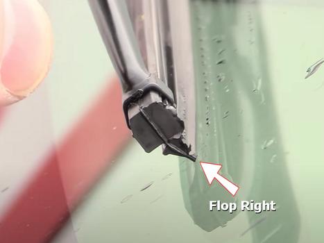

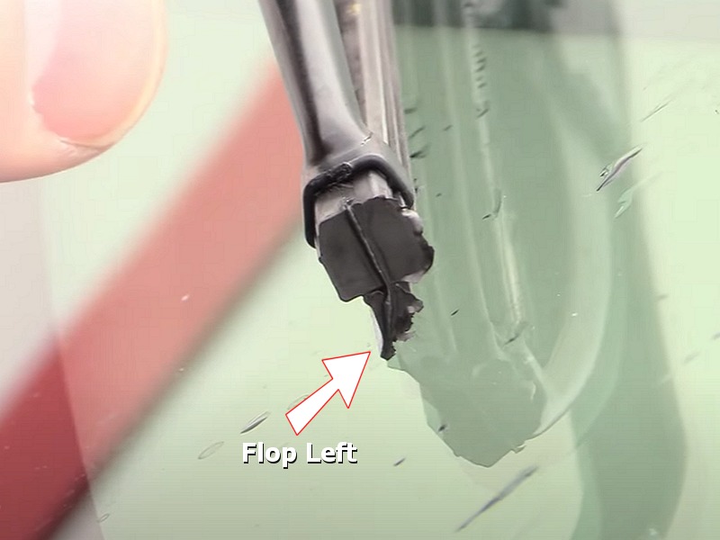

Continue to adjust until the wiper lip can "flop" back and forth easily in both directions, this will solve the problem, the image below is flopped left.
wiper flop left
This wiper lip is flopped right, this back and forth action will help the wiper work correctly and help the wiper last longer.
