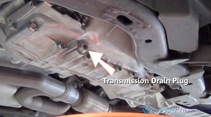

We feature both case and pan style of services in this guide, beginning with the case style. In each instance the vehicle will need to be lifted using a hydraulic jack and stands. Case style transmissions are usually front wheel drive as in the example below, once lifted locate the fluid drain plug.
transmission drain plug automatic

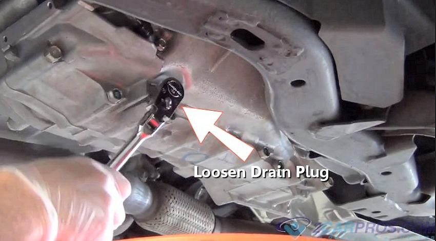

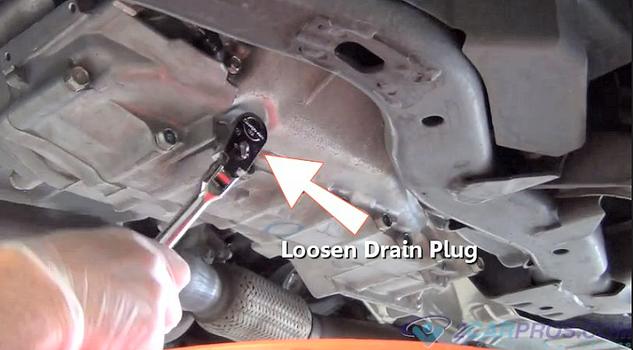

Choose the appropriate tool to remove the drain plug, in this case it is a 3/8 drive, such as a ratchet without the socket attached.
loosen transmission drain plug

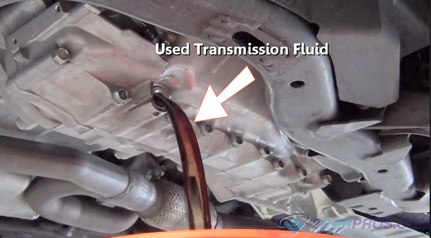

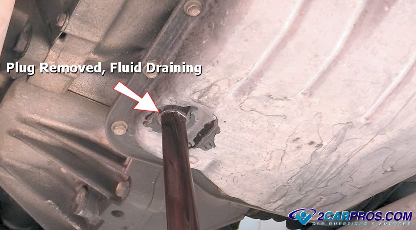

Have a fluid catch basin ready while removing the drain plug, line up the drain hole to receive the fluid and continue to remove the plug, used transmission fluid will begin to pour out.

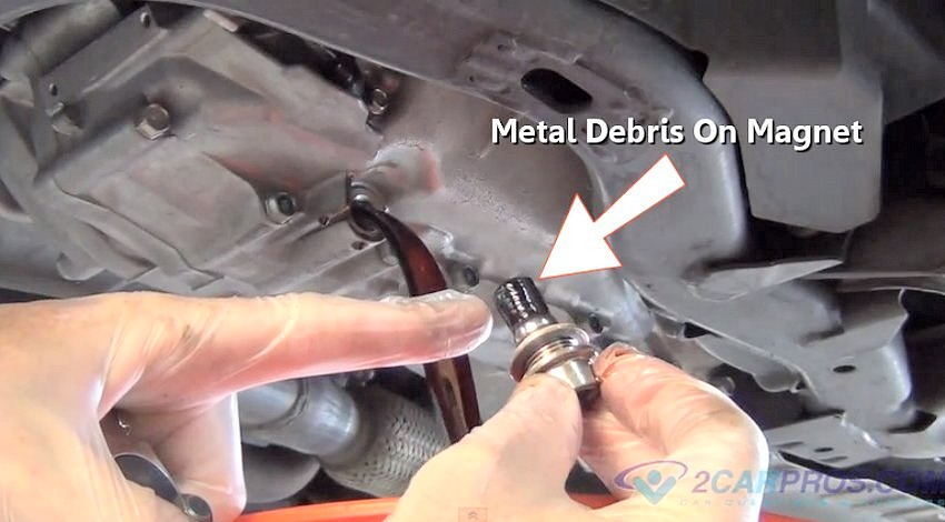

There can be a magnet attached to the drain plug which is used for catching metal debris which is normally created by the operation of the transmission, clean this magnet before reinstalling the plug.

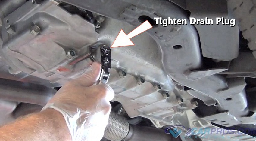

Wait until the fluid is done draining then reinstall the drain plug and tighten to spec, in this case the torque was 14 foot pounds.
tighten automatic transmission drain plug

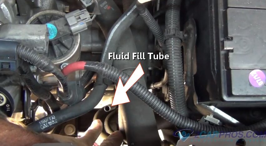

Locate the transmission fluid fill tube which also houses the fluid dipstick. Some transmissions will have a fill plug or port which depends on design which is outlined in this transmission fluid level check guide.

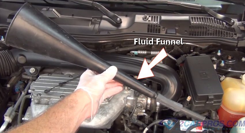

Usually the tube will have a larger diameter to help accept the new fluid, in case case below we had to rig our transmission funnel to work with the smaller tube using a small piece of rubber hose.

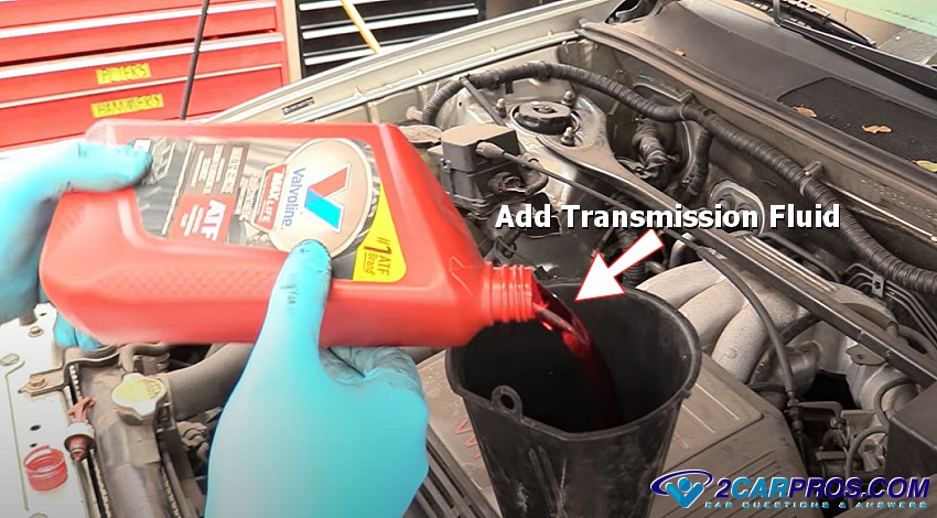

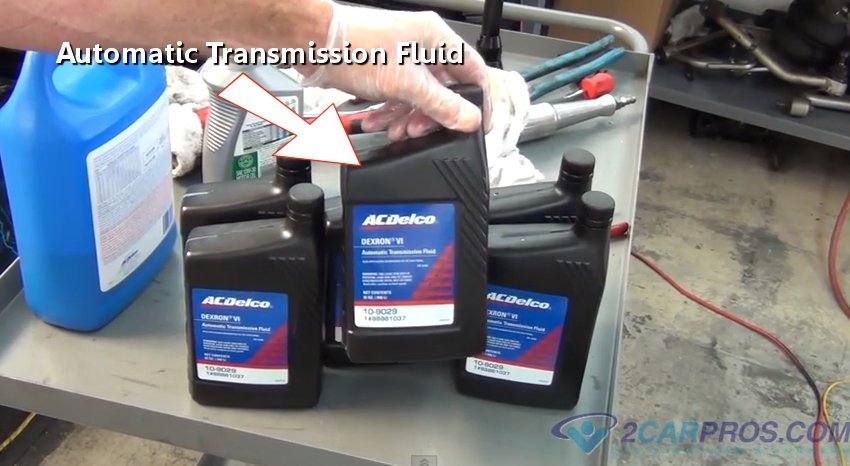

Have your new transmission fluid ready, when refilling, use manufacturer specified fluids or their equivalent in most cases you will need 6 or more quarts.
automatic transmission fluid

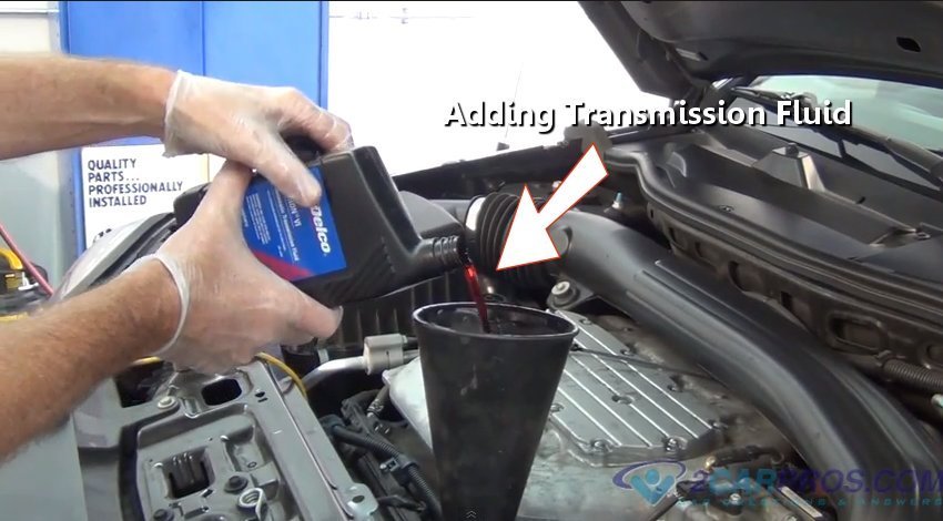

Insert the fluid funnel, by judging the amount of fluid that came out it will give you an idea on how much to pour in, you want to be a little low. We started with four quarts and then started the engine, start checking the fluid level and add fluid until the level is in-between the crosshatches on the fluid dipstick. Allow the engine to warm up and recheck the fluid level, do not overfill the transmission, this could cause the fluid to foam which can cause slippage. Shut off the engine and replace the fluid dipstick, check transmission for leaks and recheck fluid level in a couple of days to be safe.
adding transmission fluid

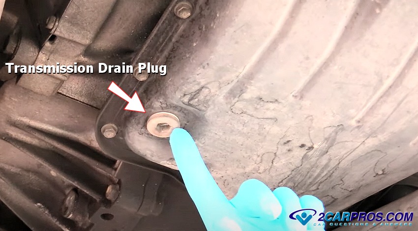

Locate the transmission fluid pan, some pans have a fluid drain plug, insert the correct tool in this case it is a 10mm Allan wrench hex drive and turn counter clockwise, if your does not have a drain plug skip this steps, (fluid will exit the transmission when pan is removed).
Loosen the drain plug until it is easily removed by hand, have a fluid catch basin ready. Carefully continue to remove the plug until the fluid is flowing out, allow to do so until completed.
drain plug draining fluid transmission

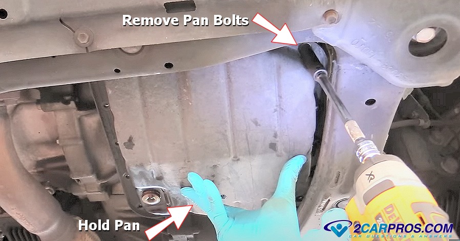

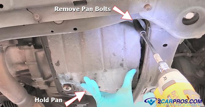

Remove transmission pan mounting bolts and continue to do so until all but two bolts hold the pan in place. If there is no drain plug, now is the time transmission fluid will start to pour out, have a fluid catch basin ready. When all but two bolts remain, place your hand under the transmission pan and remove the remaining bolts, gently lower the pan and empty the remaining fluid.

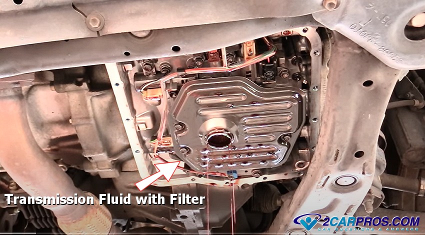

Here is what it looks like with the pan removed, exposing the filter while transmission fluid continues to drain.
trannsmission fliter fluid

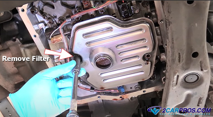

Remove the transmission filter which can be held on by mounting bolts, a clip or an O ring, this varies per manufacturer, in this case there are three 10mm bolts. Be sure to remove the old O ring seal or gasket, a new seal will come with the new filter kit.

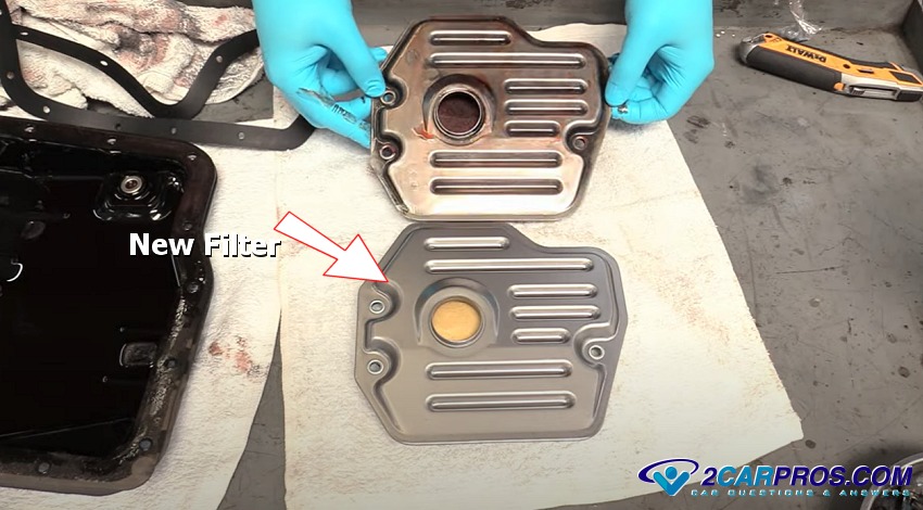

Inspect the transmission filter kit which should include the pan gasket, filter and filter seal or gasket, confirm the parts are correct.
new transmission filter

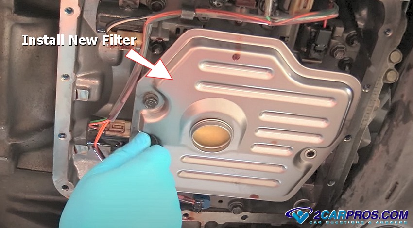

When installing the new filter, clean the seal surface in which the seal will sit against to avoid any leakage, once the new gasket or seal is installed fit the filter into place and reinsert the mounting bolts or clips. Tighten the filter bolts to spec which in this case was 7 foot pounds.
install new transmission filter

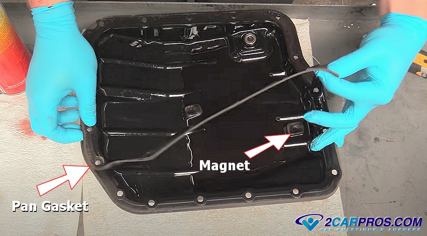

Remove the old transmission pan gasket and clean the pan thoroughly, sometimes there will be a magnet inside the pan designed to capture small metal particles which should be cleaned as well. All transmissions have some metal particles in the pan, but excessive quantities can mean a more serious problem. Install the new pan gasket using contact cement to hold the gasket in place, a thin layer of gasket sealer such as silicone rubber can aid the sealing ability of the gasket, (transmission side).
trannsmission pan gasket

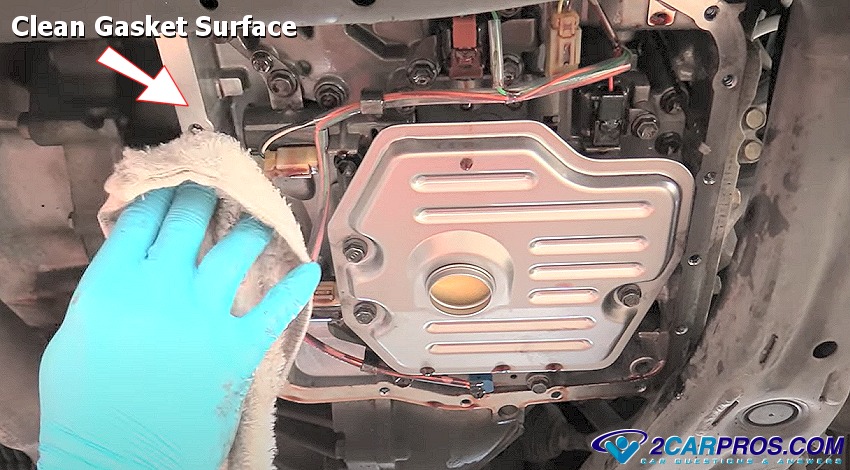

Before reinstalling transmission pan clean the gasket sealing surface with a gasket scraper and shop towel, this enables a secure seal to the new gasket.
clean transmission gasket surface

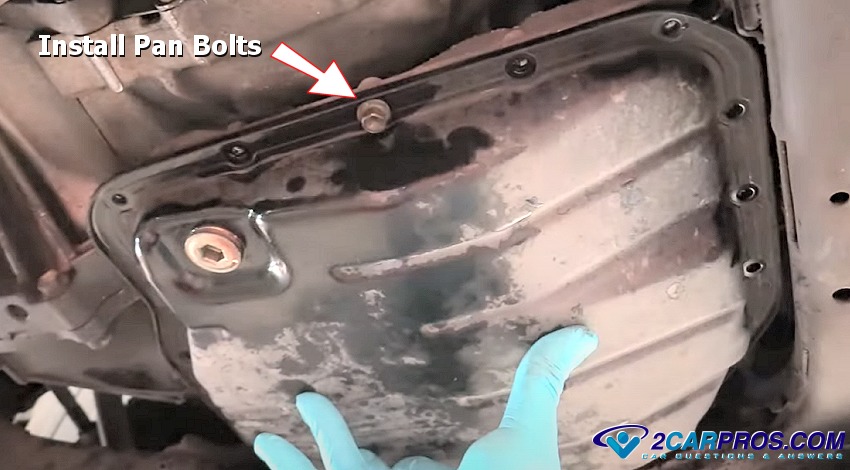

Gently raise the pan up and into place being mindful of the gasket while installing the transmission pan bolts. Insert the bolts by hand, do not tighten until all bolts have been started, tighten to the manufactures torque spec in a star pattern. If no specs can be found wrist tight is a good rule of thumb, do not split the gasket by over tightening the bolts, be sure to recheck the bolts in a few days to retighten as needed.

Locate and remove the transmission fluid dipstick and insert a fluid funnel, start by adding four quarts and then start the engine, start checking the fluid level.
add transmission fluid

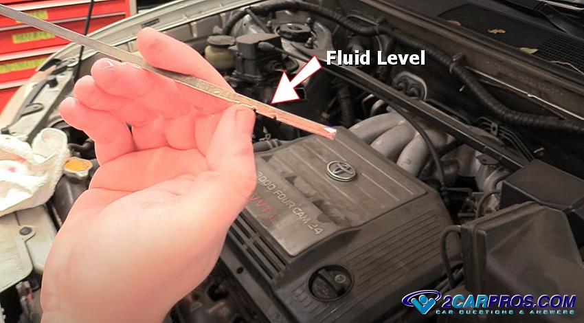

Continue to add fluid while the engine is warming up, it is best to add 1/2 quart at a time, with your foot on the brake move the gear selector through the gear range slowly. Keep wiping off the dipstick as you add, stop adding when the fluid level is in-between the level marks on the dipstick, some transmissions will not have a dipstick in this case please check out this add fluid level guide. Due to the nature of the transmission it's best to check the fluid level in a few days to ensure the correct fluid level.
transmission fluid level dip stick
