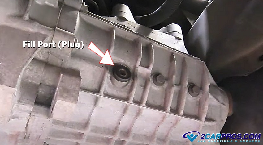

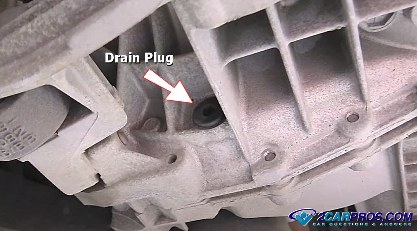

First, we must locate the fill and drain plug which are on the side and near the bottom of the transmission. Most of the time you can locate them by doing a simple inspection, but sometimes car manufacturers can get creative so if you have trouble finding the plugs please ask our experts to help, it's free.
transmission fill plug port
transmission drain plug

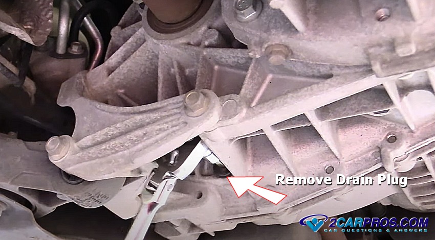

It is a good idea to break loose both the fill plug and drain plug before you begin to make sure you can refill the transmission without an issue. In this example we use a 8mm Allen wrench, have a fluid catch basin ready.
remove transmission drain plug

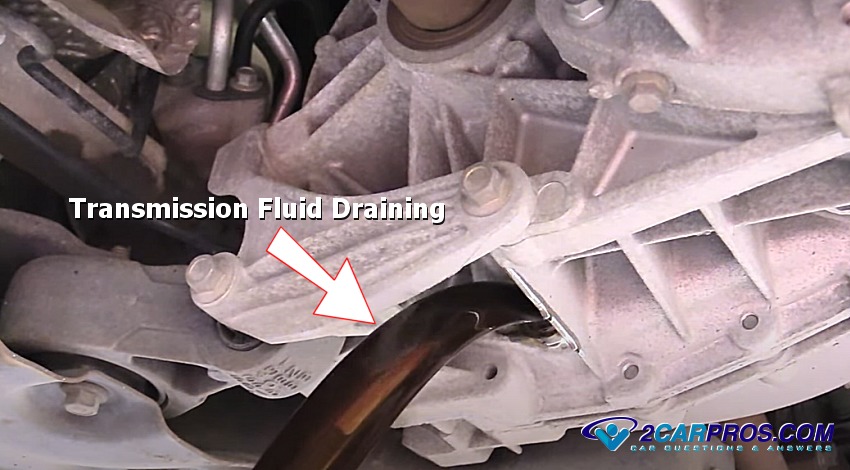

Remove the drain plug completely, transmission fluid will start to flow into the catch basin, allowing it to do so until all the fluid has drained out. Also, it helps to remove the fill plug to improve drainage, inspect the fluid for large metal flakes which can be an indication of the transmission having a problem.
transmission fluid draining

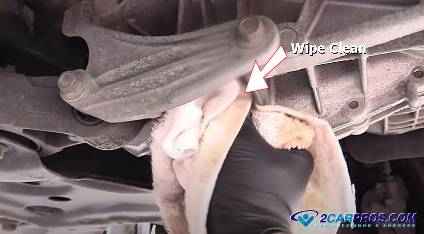

Use a shop towel to clean the drain plug and the mating surface where the drain plug meets the transmission to help ensure a proper seal.
wipe clean drain plug hole

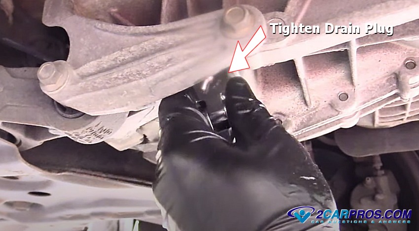

Some drain plugs will have a magnet which also needs to be cleaned. Insert the drain plug and tighten to spec, in this case it is 19 foot pounds of torque.
tighten transmission drain plug

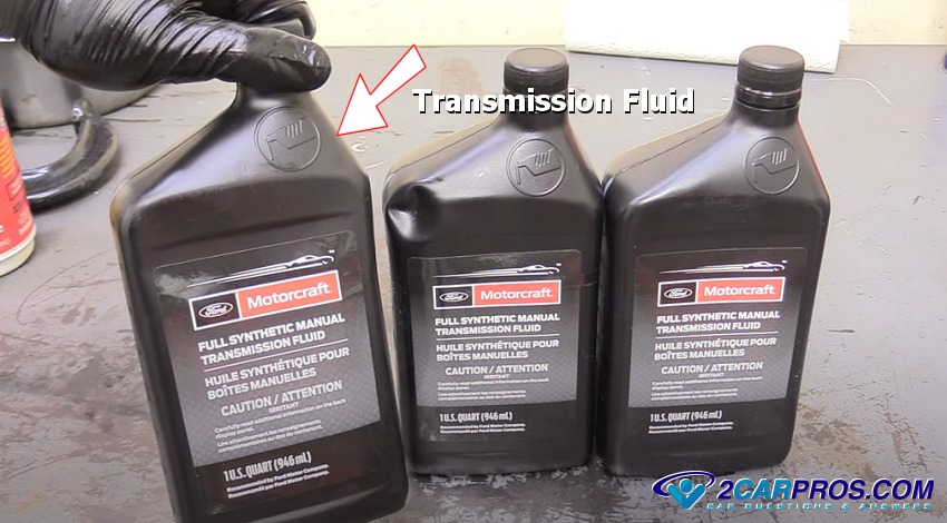

Have the new transmission fluid ready, in this case it is three quarts of Ford Synthetic Fluid for manual transmissions, make sure you have the correct fluid for your car, it matters!
manual transmission fluid

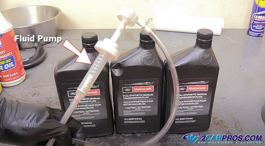

You will need a transmission fluid pump to transfer the fluid from the container into the transmission, these are inexpensive and available on Amazon or the auto parts store.

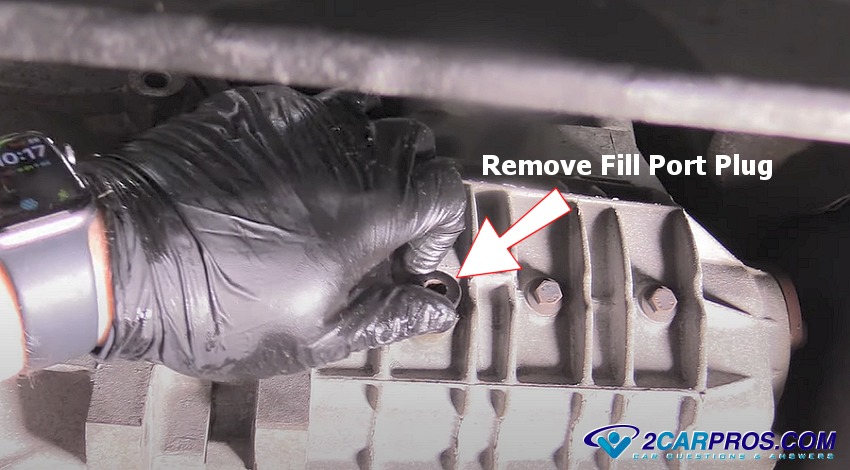

Remove the fill port plug, this is where the fluid will be added to refill the transmission with fluid.
remove fill port plug

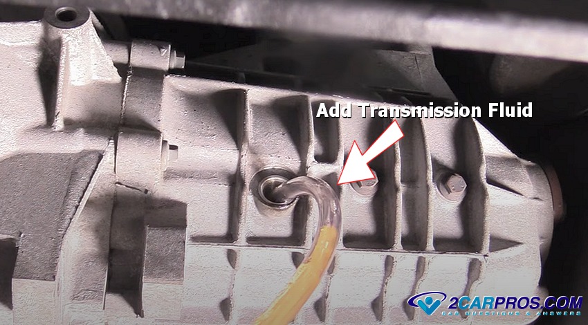

Insert the plastic tube into the fill port, which is attached to the transmission fluid bottle, and begin pumping the fluid into the transmission.
add transmission fluid

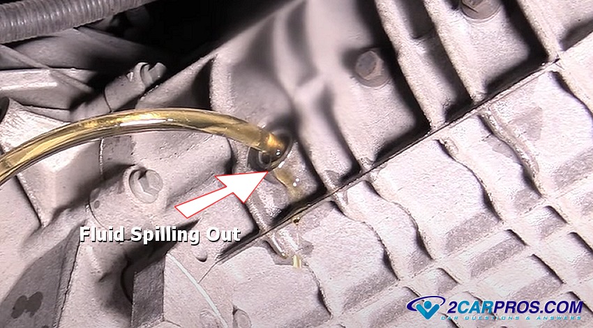

Continue pumping fluid until it starts to overflow from the fill port, this means the transmission is full, remove the fill tube.
transmission fill spilling out

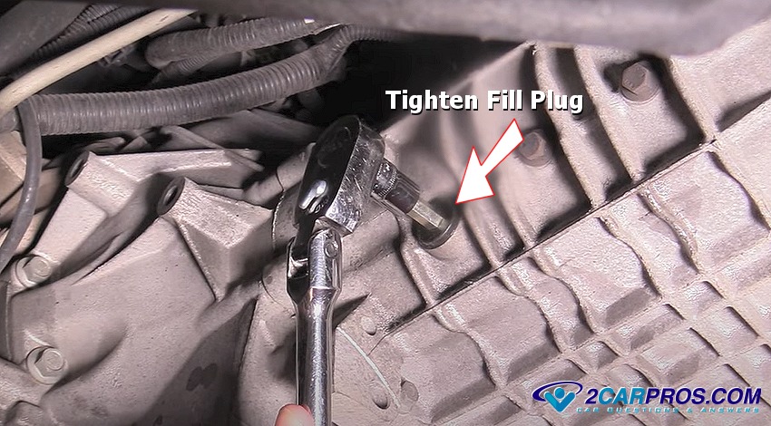

Wipe clean the mating surfaces on the transmission and fill plug and reinstall, tighten to factory spec, again 19 foot pounds of torque and you are all set. It's best to recheck the fill and drain plugs for leakage in a few days.
tighten transmission fill plug
