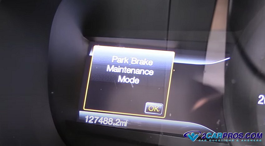

1. On modern combustion fuel, hybrid and electric cars the parking brake will automatically be engaged when the transmission is put into park. To service the rear brake pads, the parking brake system will need to be in "service mode". Each manufacturer has a different procedures for doing this but it is easy to find out and perform in most cases. If you need instructions for this ask our experts which will help you for free.
parking brake maintenance mode light

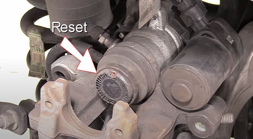

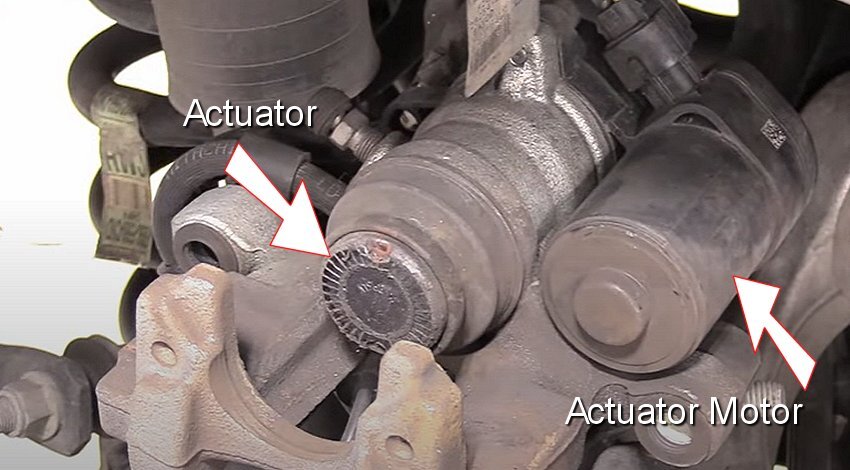

2. After removing the wheel the brake caliper will be exposed, at this point perform a normal rear brake job service but stop at installing the new rear brake pads. Now, you will need to do the brake caliper reset procedure before the rear brake pads are installed. In the image below you can see the actuator itself and the actuator activation motor.
automotive rear brake caliper parking brake actuator

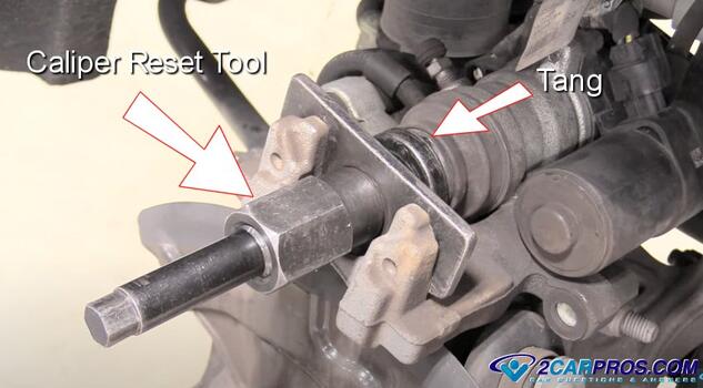

3. You will need to use a caliper reset tool which you can buy from Amazon or you can rent it for free at the local auto parts store. Insert the tool into the brake caliper while carefully aligning the plunger tangs (2) with the reliefs on the caliper piston.
automotive rear brake caliper reset tool

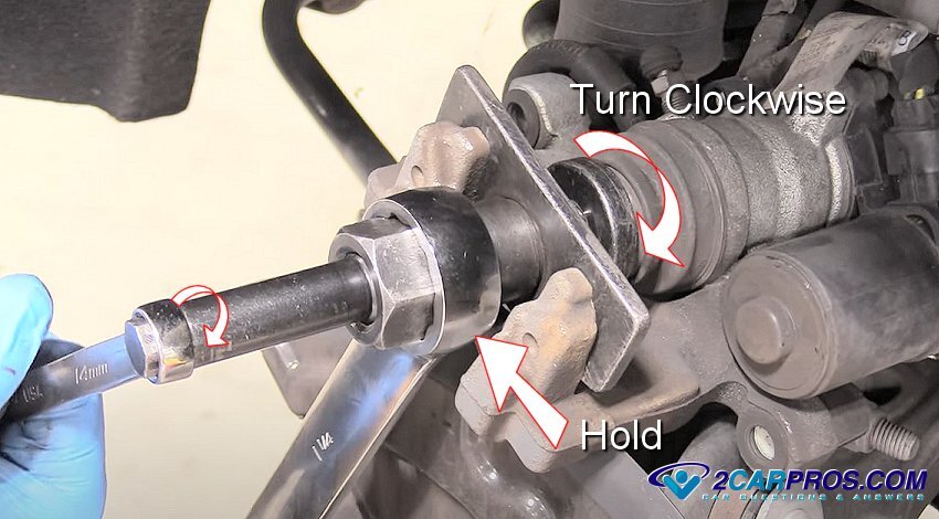

4. While holding the tool in place use two wrenches, one to move the caliper reset tool plunger clockwise and the other larger wrench to hold the tool adjuster sleeve steady. Keep retracting (turning clockwise) the caliper piston until it stops, (do not force the piston).
turn brake caliper tool clockwise

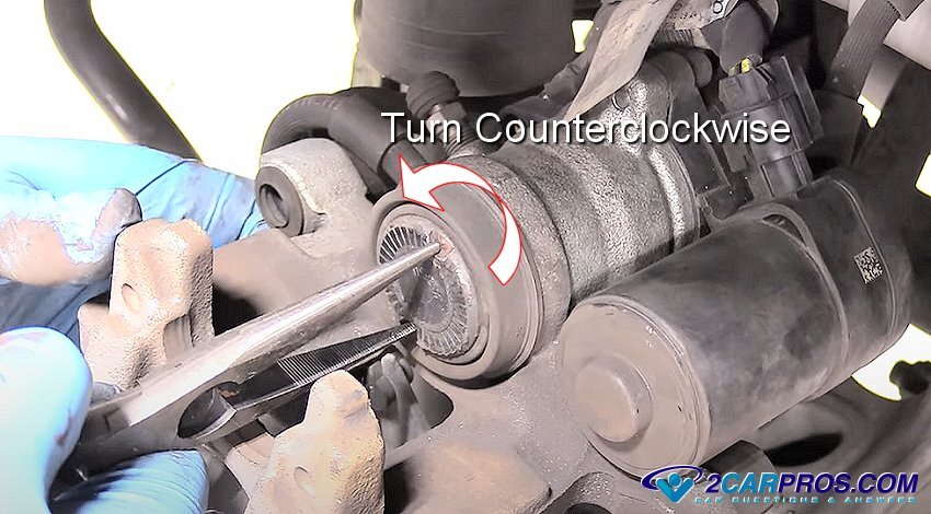

5. Use the caliper tool or needle nose pliers to turn the brake pad alignment groves counterclockwise until they are straight up and down, the rear brake caliper has been successfully reset.
turn brake caliper tool counterclockwise

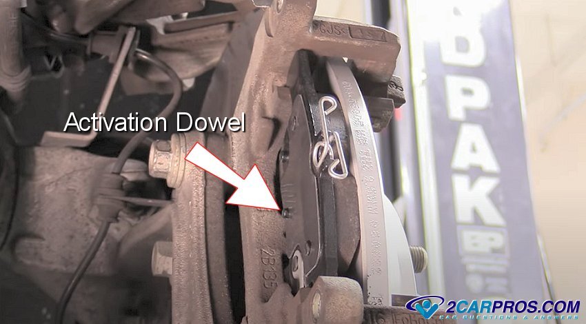

6. When installing the new rear brake pads there will be a activation dowel on the rear of the pad which is what the rear brake caliper piston alignment tangs will fit into. If this is not done correctly you will have a low brake pedal and the parking brake may not work.
rear brake pad activation dowel
