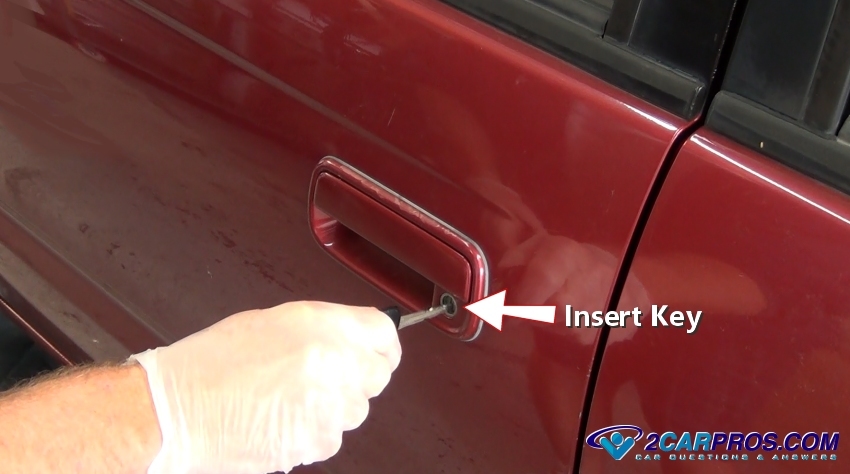

Step 1: Drivers Door Key Reset
Exit the car with all doors closed and the windows rolled up. Also, close and any rear doors such as the trunk, rear hatch and front hood. Lock the car using the drivers side lock and walk away from the car at least ten feet. Wait for fifteen minutes and unlock the door, this should reset the security system.
insert door key

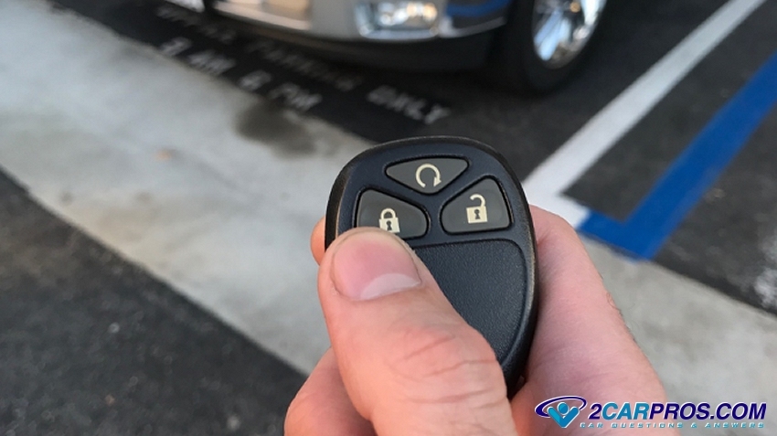

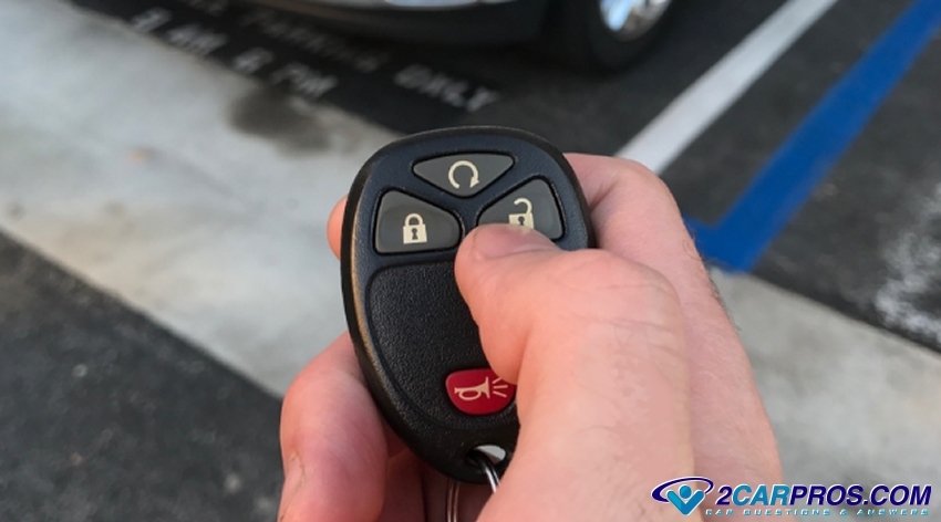

Step 2: Activate the Key Fob

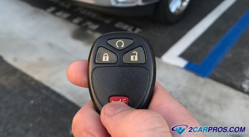

Many manufactures will not allow the car to start when the panic button has been pushed. Hold down the panic button for five seconds to reset the immobilizer.
key fob panic button
Next, push the lock button two times and wait ten feet away from the car for ten minutes.
key fob lock button
Then hit the unlock button on the fob twice this should deactivate the security system which should be accompanied by exterior lights flashing or an audible horn beep.
key fob unlock button

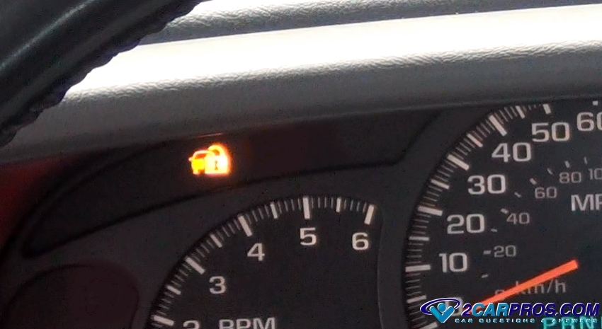

Each of these steps should be followed by the cancellation of the security light. If this light is blinking while you are trying to crank and start the engine the system is not reset.
security warning light

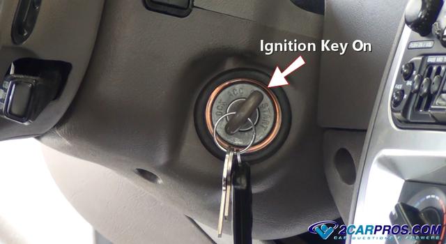

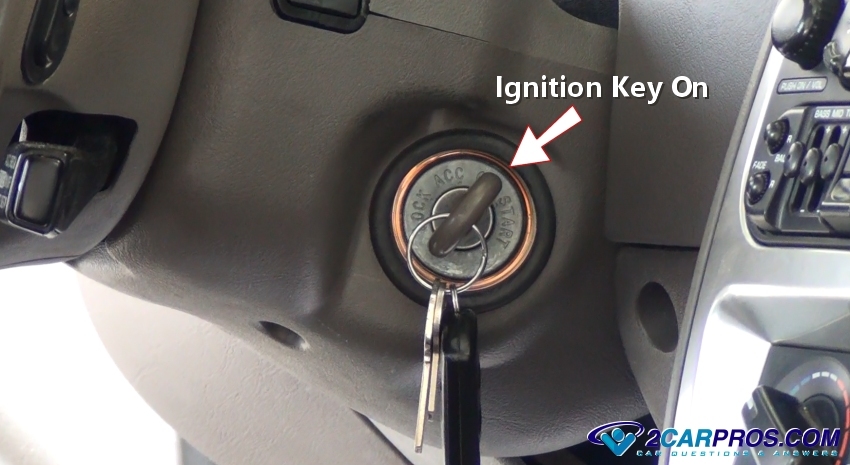

Step 3: Turn the Ignition On
Many immobilizer systems need to see the power utilized from each power input delivered from the ignition switch. Insert the ignition key and turn it to the on position and then attempt to start the engine (crank over), the engine wont start. With the key still in the run position wait 10 minutes and the security light should blink and then go out. Turn the key off and wait 5 seconds. Repeat these steps for a total for 3, 10 minute cycles. The car is now ready to relearn the Passlock code the next time the key is used, any trouble codes will clear after 100 cycles of the key.

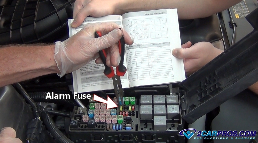

Step 4: Remove the Alarm Fuse
The alarm fuse is located in the fuse panel of most cars. Using the owner's manual remove the fuse which will power down the security system. At this point the car will not start, reinsert the fuse to reactive the system. This is known as a soft reboot of the immobilizer.

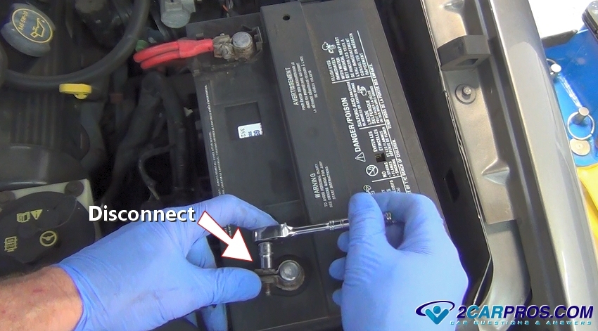

Step 5: Disconnect Battery
Sometimes the anti theft system can out of sync due to a voltage spike or an operational error. Start by removing the battery's negative cable and leave it disconnected for five minutes then reconnect the battery. This will allow the security system to perform a hard reboot and reset the alarm protocol to help the immobilizer start working in the proper sequence.
