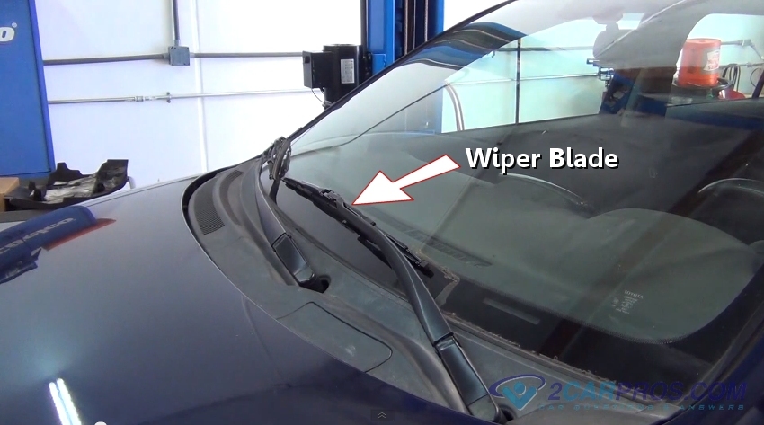

Most wiper blades are exposed when the system is off but some manufacturer designs have the wipers hidden under the cowl or hood of the vehicle. If this is the case, turn the ignition switch on, then turn the wipers on, while the wipers are in the up position shut the key off, this will stop the wipers on the windshield in most cases. If the wipers return to the park position anyway, lift the hood to gain access.

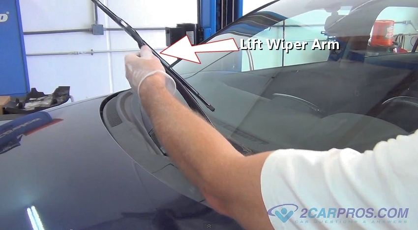

Lift the wiper arm into its service position away from the windshield. Check the clearance between the wiper arm and hood so as to not damage the paint, adjust the position of the arm via the wiper switch to rectify, opening the hood may help as well.

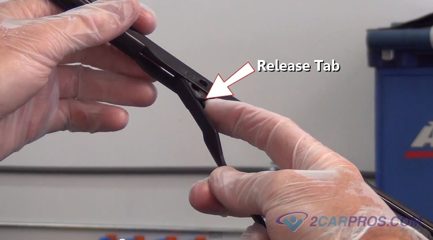

At the wiper arm pivot locate the release tab or collar which is near the top of the wiper arm.
locate wiper release tab
Use a small screwdriver or your finger to release the wiper tab or pull down the collar retainer.
wiper tab released

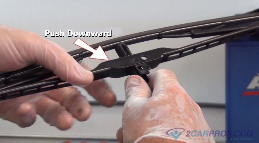

With the tab or collar released, push the wiper arm downward to disconnect the wiper from the arm.
push downward in wiper

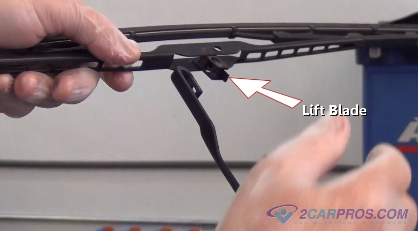

Lift the wiper blade away from the arm to complete the blade removal, (CAUTION: Do not release the wiper arm and allow it to strike the windshield, this could cause the windshield to crack).

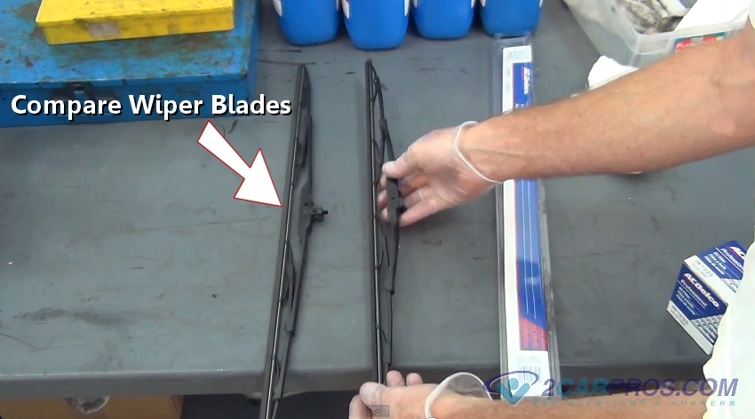

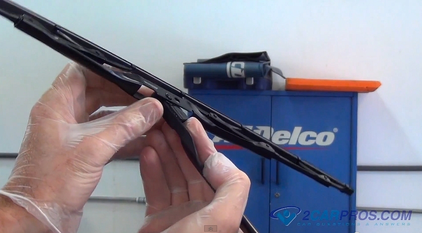

Using the old wiper blade, do a quick comparison of the new replacement wiper, check the length and mounting mechanism. Replacement blades can be universal which will feature several mounting options, be sure to assemble the new blades with the correct attachment adapter.
compare wiper blades

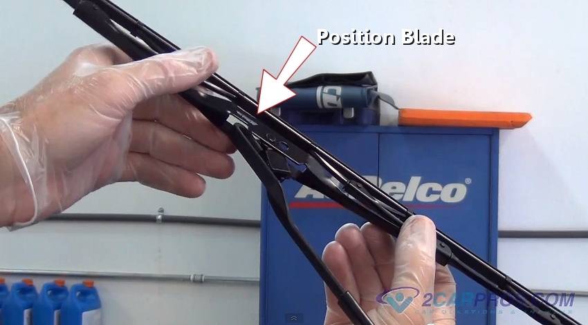

Position the new windshield wiper blade over the arm located near the clasp on the wiper arm.
position wiper

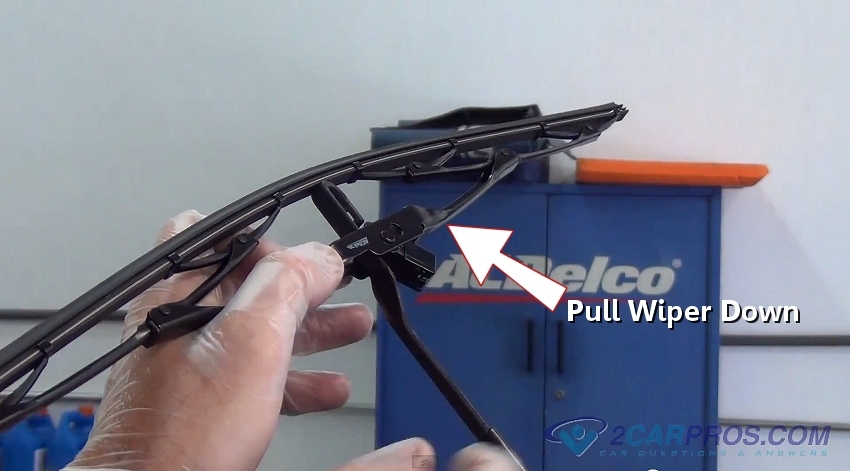

Pull the wiper blade over the wiper arm to align the wiper clasp.
pull wiper into place
Align the wiper clasp with the arm mount and push the wiper into place, this action will be accompanied by a slight click letting you know the wiper is fully installed.
align wiper clasp

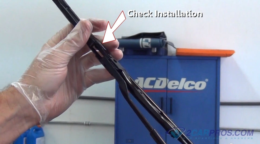

After installation, pull down on the wiper blade to ensure the clasp is holding the blade to the arm and is working correctly, at this point the wiper should pivot freely.
check wiper installation

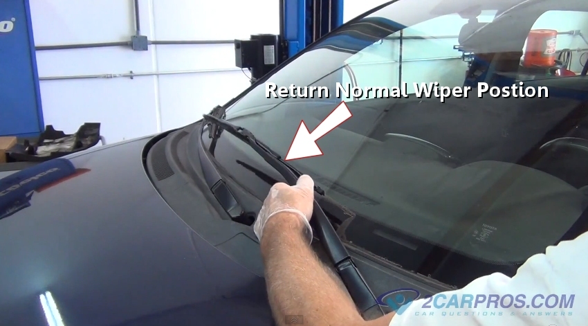

Return the wiper arm to its original position to complete the job. Check additional wipers and replace as needed using the same method as described. Clean the windshield free from dirt before operating the new wiper blades, recheck wiper operation using water on the windshield.
