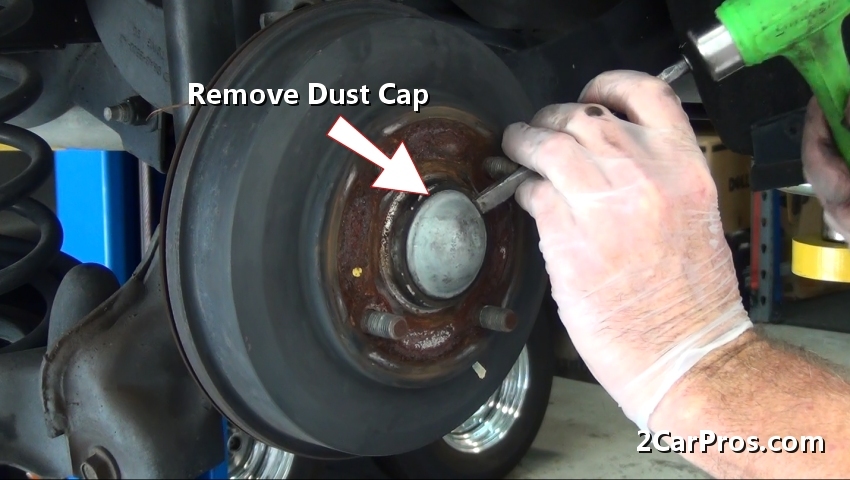

1. Use a small chisel with a hammer to remove the bearing dust cap, on some cars the drum will just slide off or be held on by thin sheet metal clips which will need to be removed.
removing bearing dust cap

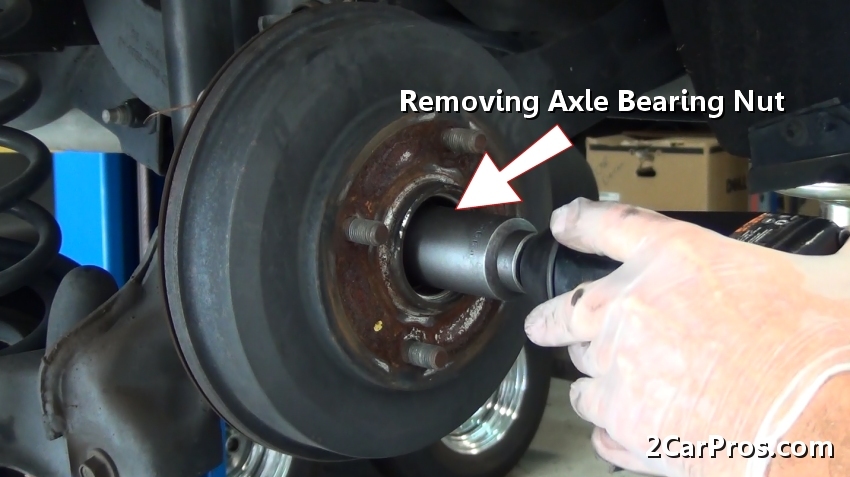

2. Remove the bearing dust cap and the axle bearing retainer nut will be exposed, choose the correct size socket usually 22mm or 24mm and remove the axle bearing retainer nut, this can be done using a breaker bar.
removing axle nut

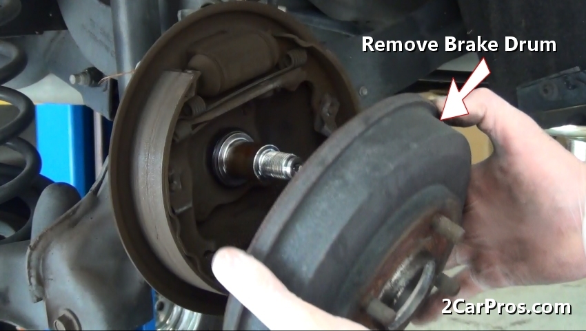

3. Gasp the drum and with a twisting and pulling motion remove it from the car, turning the drum helps release the unit from the axle and the brake shoes. Use this guide if the brake drum is stuck.
remove rear brake drum

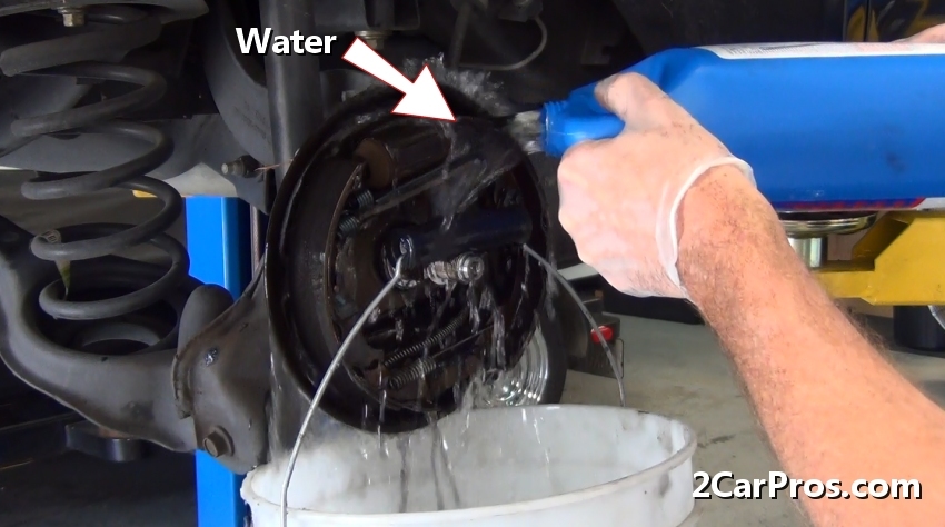

4. Hang a bucket on the axle which will be used as a catch basin, this step will keep the brake dust down to a minimum and make the job cleaner and more enjoyable. Use regular water to rinse away harmful dust particles and allow to dry, wipe away any water from the axle. If you use a garden hose for this step be careful not to blow the brake dust in the air when the pressure from the hose is released. Use the fan feature of the nozzle which will help keep the brake dust down.
rinse brakes

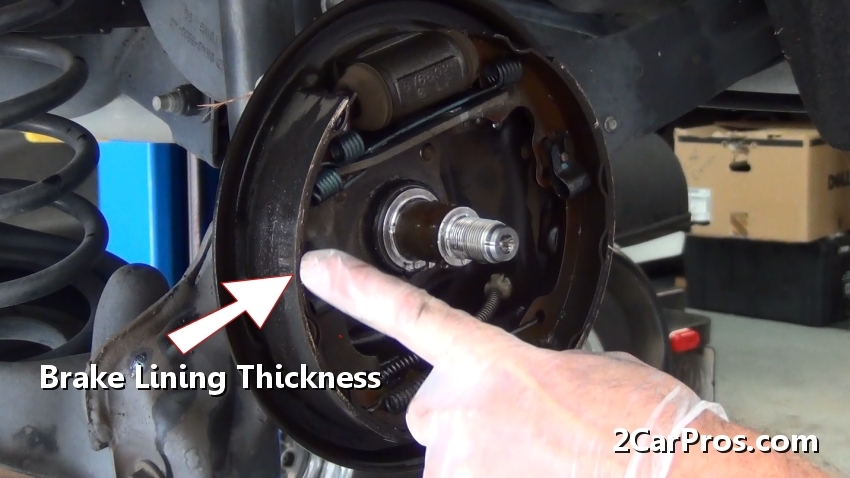

5. Inspect the brake shoe thickness to the new brake shoes. Each shoe can be little different which requires a comparison.
brake shoe lining thickness

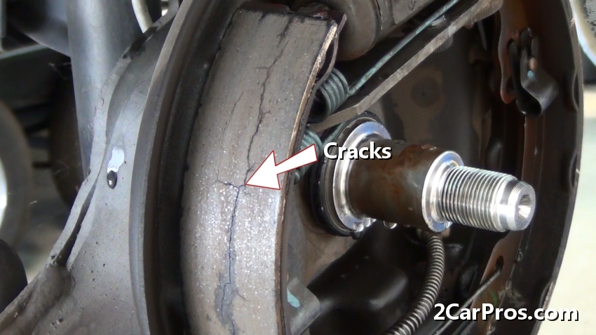

6. When the brake shoes become overheated it can crack the lining of the shoe which requires replacement. When a brake shoe is in this condition a large piece of the lining can come loose and lodge between the shoe and drum causing the wheel to lock up.
brake shoe cracks

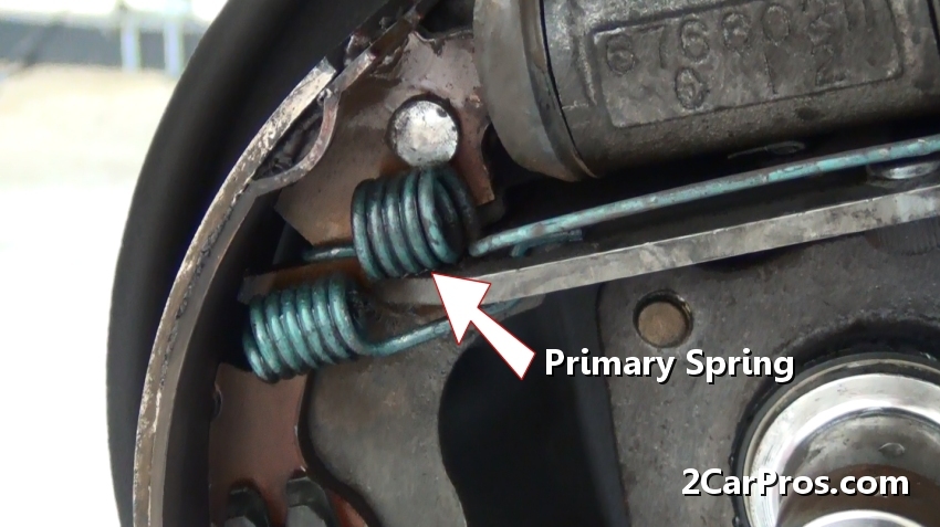

7. Begin the brake shoe removal by identifying the primary brake shoe spring or springs. (Note: Some brake systems utilize two upper springs.) We feature two videos at the bottom of this article which shows different designs of brake shoes please watch them to get an idea of the different kinds available on cars, light trucks and SUV's.
inspect wheel cylinder

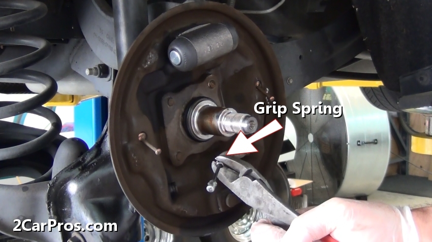

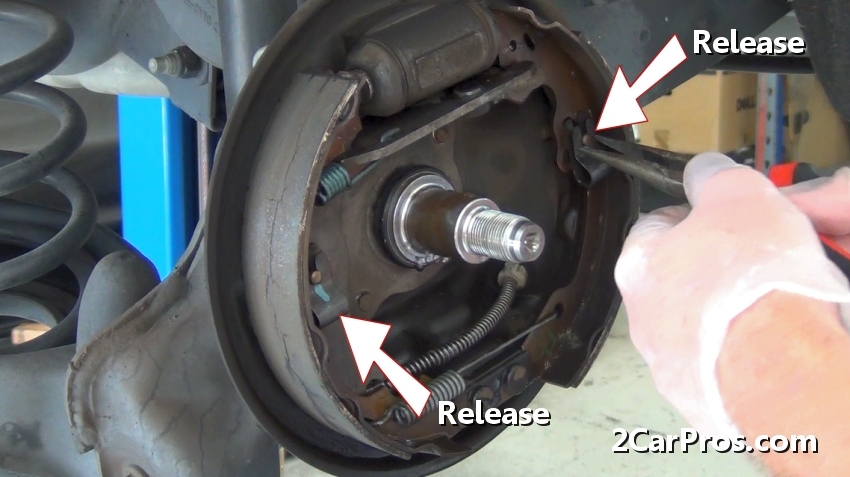

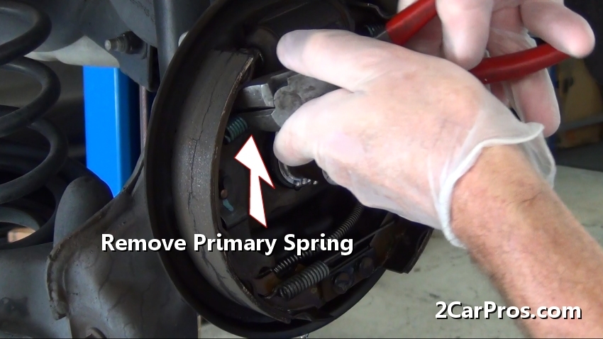

8. Use a pair of needle nose vise grips and grasp the spring and pull it towards the brake shoe until it is released, this can take some doing so hang in there. Once the spring has been released the opposite side will be easily removed.
remove primary spring

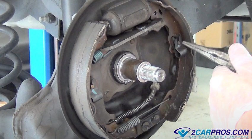

9. Use a pair of needle nose pliers to release the brake shoe hold down clips there will be one on each shoe. On some types of brakes you are want to use a brake shoe removal tool for this.
release brake shoe hold down

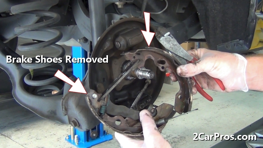

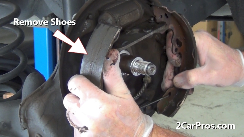

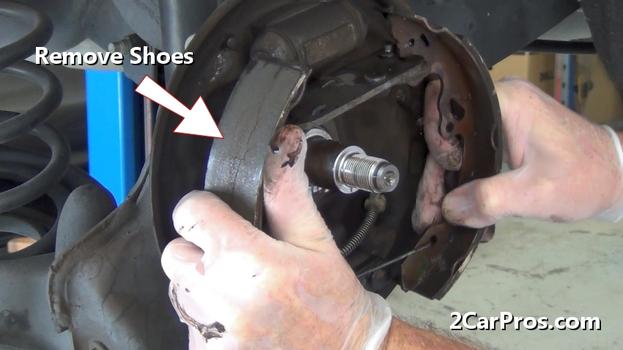

10. After both shoe hold down or anchor clips have been released grasp both brake shoes firmly and pull slightly outward which will allow the shoes to separate from the backing plate and wheel cylinder.
remove brake shoes

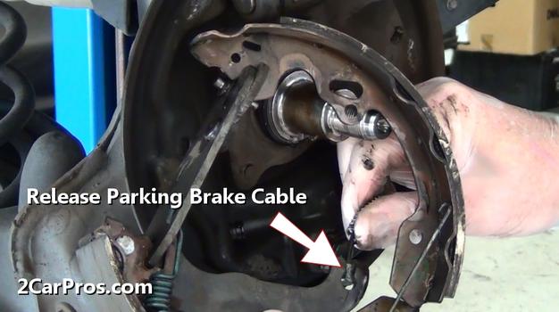

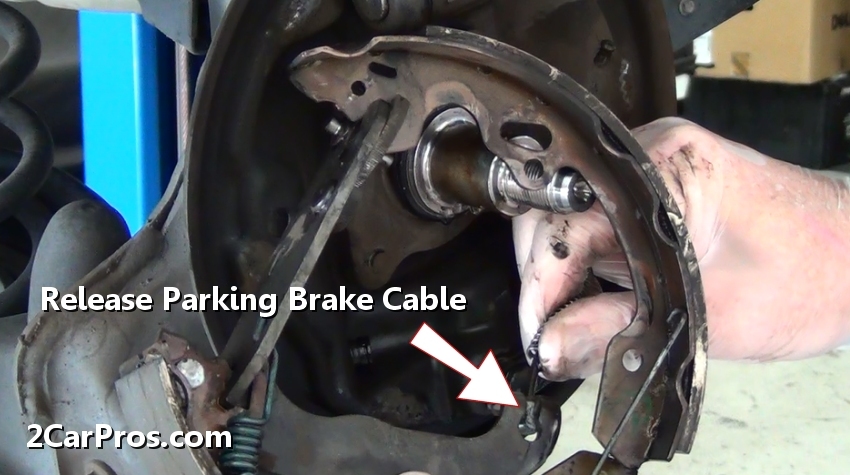

11. Pull the parking brake cable spring downward and release the cable from the parking brake arm.
release parking brake cable

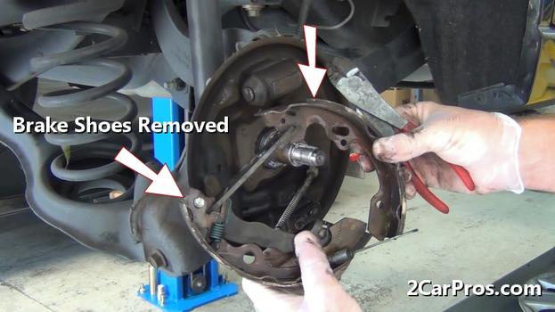

12. The brake shoe set will become free from the backing plate. Hold the shoe set together because it will want to come part.
brake shoes removed

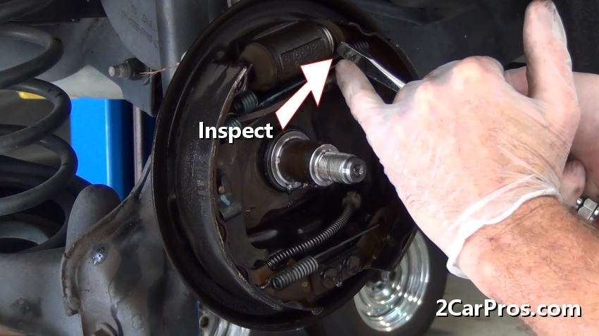

Check the Wheel Cylinder
Once the brake shoes are clear use a flat blade (standard) screwdriver and pull back the rubber cups to check for the presents of brake fluid which is an indication of failure. It is recommended to replace the wheel cylinders every time a brake job is done, but if the car is fairly new you can leave them if they are not leaking. It is also advisable to replace the wheel cylinders as a set (both sides) if one is leaking the other side can’t be far behind.

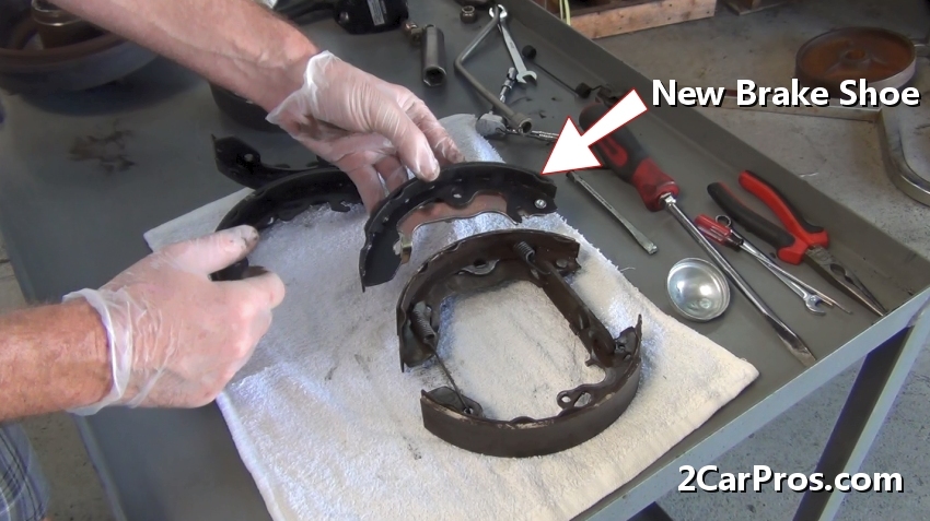

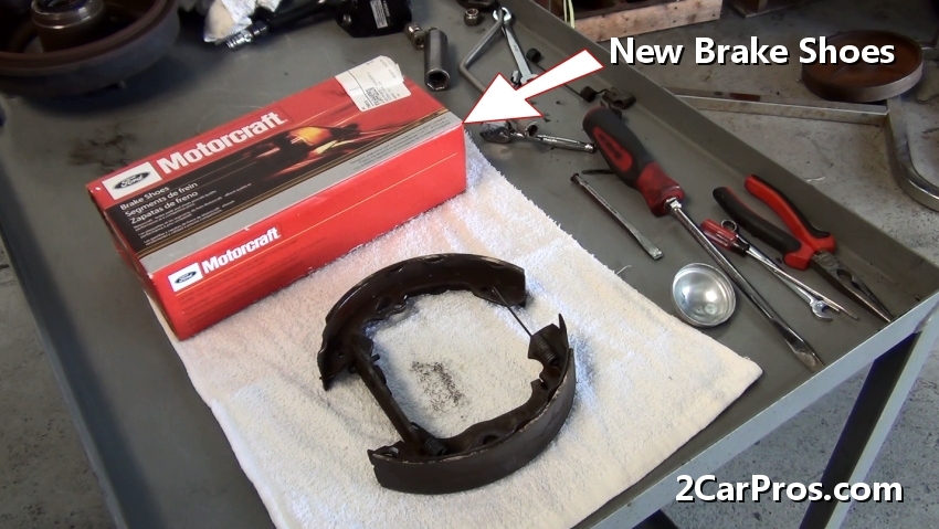

1. Use a medium size flat surface to initiate spring and e-bake lever swap onto the new shoes. Take note how how the springs and shoe are situated. Now would be a good time to snap another picture using your phone. At this point a brake new spring hardware kit (combo kit) can be used if the vehicles brakes have been overheated or the car has more than 80,000 miles on it. Springs can become brittle and lose their strength when they get hot and then cooled.
motorcraft brake shoes
2. Once the new brake shoes have been unboxed match the warn brake shoes to the new brake set. They should be identical in most cases, sometimes the manufacturer will have an update that can make the shoe a little different but no very often.
match brake shoes

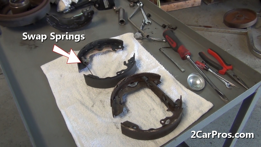

3. Align the new brake shoes with the old set on a flat table or bench and start removing brake springs and swapping them to the new shoe set. Try not to get the linings of the new shoe set dirty or greasy as this can inhibit their braking ability. If dirt or grease does get on the linings try to use a small amount of brake cleaner and shop towel to help remove it.
swap brake springs

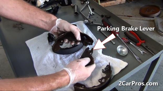

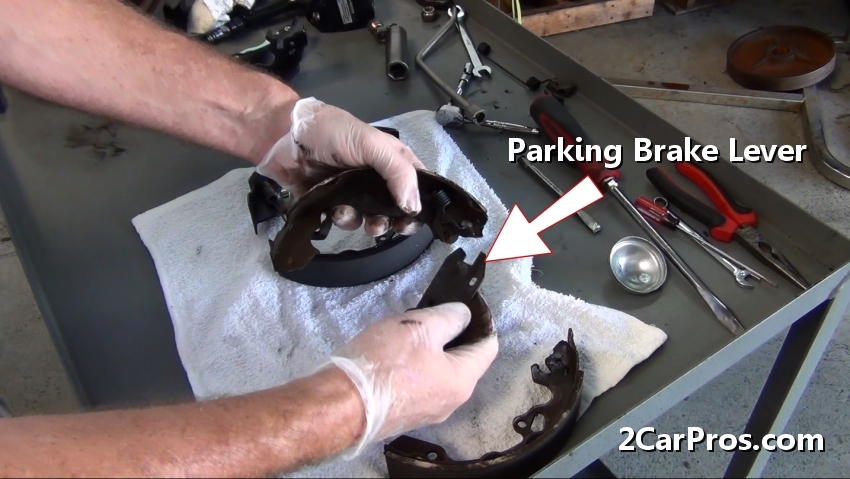

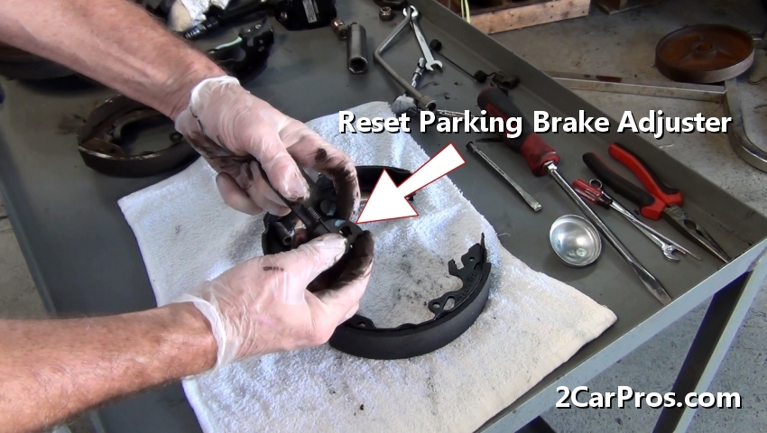

4. Also, remove the parking brake lever and self adjuster from the old shoe set. If the self adjuster is the threaded type disassemble it can clean the threads while adding a small amount of brake lube to help it work more easily and keep from seizing.
parking brake lever

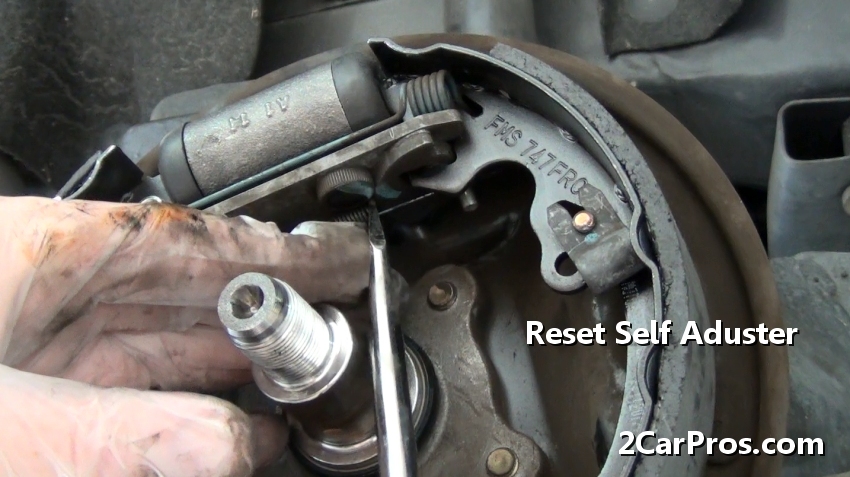

5. Reset the adjuster by pushing the adjuster wheel away from the pin and install it onto the new shoe along with the mounting spring, or twist the threads inward to make the adjuster as short as possible.
reset self adjuster

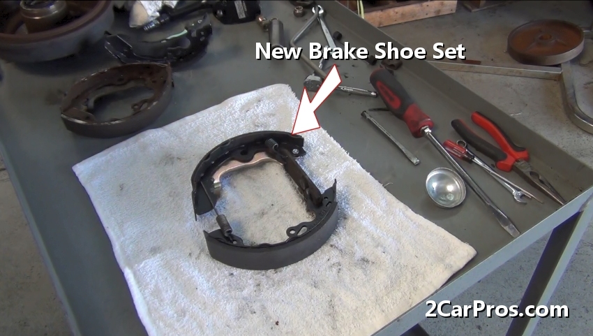

6. Once all necessary brake components have been swapped over the new shoe set is ready for installation.
new brake shoe set

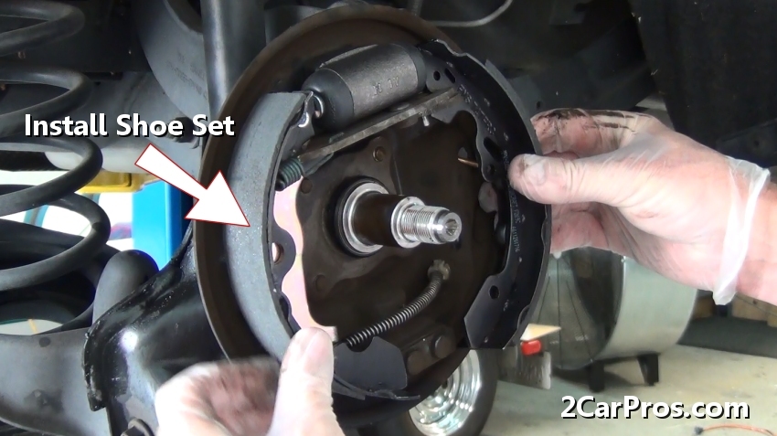

 8. Reposition the shoe set onto the backing plate and over the wheel cylinder while holding the shoes in place, this is where a mechanic can use three hands.
installing brake shoe set

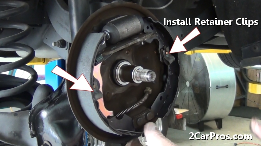

9. While holding the brake shoes in place position and install the brake shoe retainer clips.
install brake shoe retainer clips

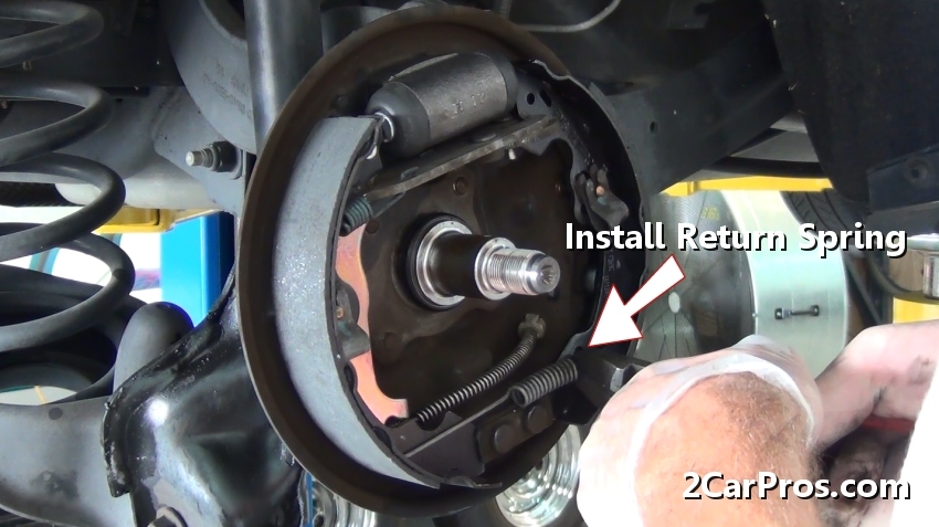

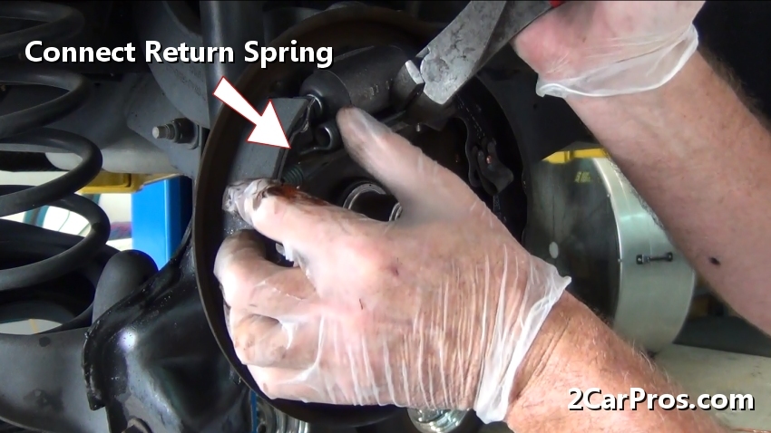

10. Once the retainer clips have been installed reposition and attach the lower brake spring using a pair of needle nose vise grips.
install brake shoe return spring

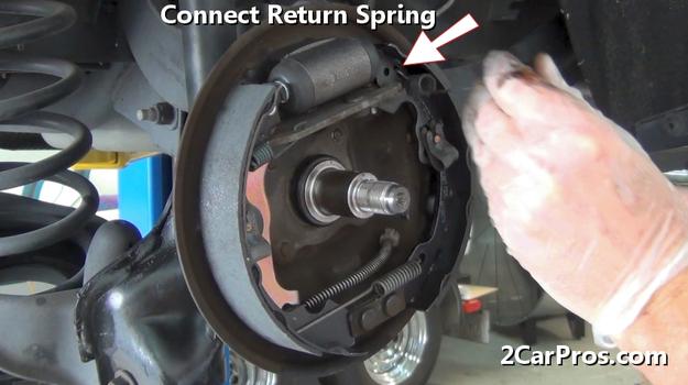

11. To complete the new brake shoe set reinstallation connect one side of the spring to the brake shoe. Attach it to the side that is easiest for you to get leverage on the opposing side.
connect brake shoe return spring
12. Using a pair of needle nose vise grips grasp the spring and pull in toward the secondary shoe, this completes the shoe assembly phase of your repair.
attach brake shoe return spring

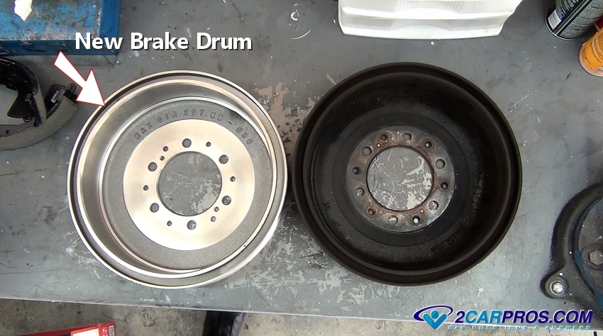

When replacing a brake drum match the new drum to the old one, they should be an identical match. All brake drums have a maximum diameter which is the limit of what it can be re-machined too. The more metal that is removed the less effective the drum will be in removing heat. This excess heat can cause brake fade and will make the drum warp and become out of round. This condition will cause the car to brake unevenly which is unsafe.
new brake drum

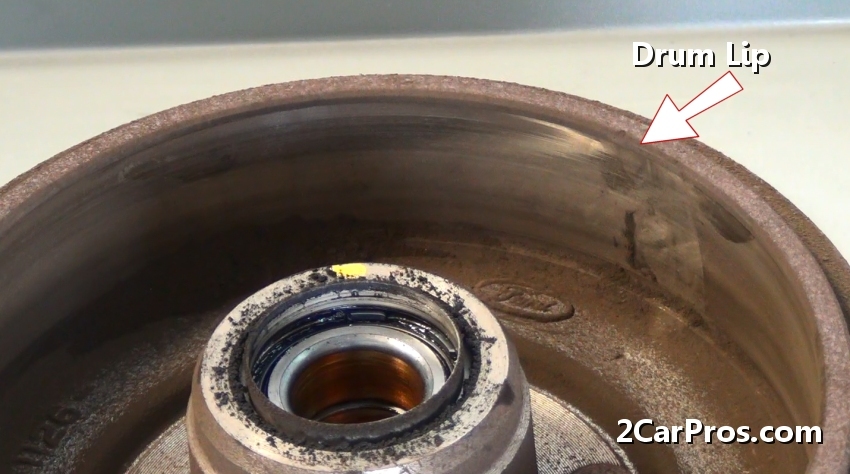

1. Before the brake drum can be reinstalled it must be replaced or re-machined to ensure a square surface for the new shoe to contact when braking. Here is an example of uneven wear (lip) which will affect the braking ability of the new brake shoes which are perfectly flat.
brake drum

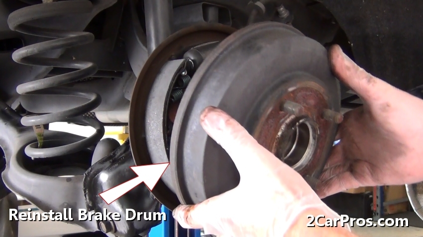

2. Reinstall the re-machined or new brake drum while spinning it, then move the shoe self adjuster outward slightly each time until you hear the shoe gently contact the drum. This process may need to be performed a number of times to fine tune the self adjuster. The drum should spin freely with slight contact with the brake shoes.
reinstall bake drum

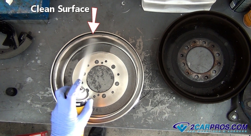

3. Use a clean shop towel and brake or carburetor cleaner to wipe out the drum's shoe surface.
clean brake drum surface

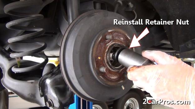

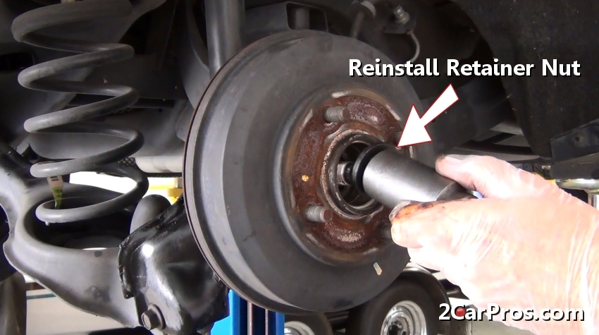

4. Once the drum has been installed insert the drum-bearing retainer nut by hand to avoid cross threading, (Some drum will just slide onto the axle with no nut required).
reinstall brake drum retainer nut

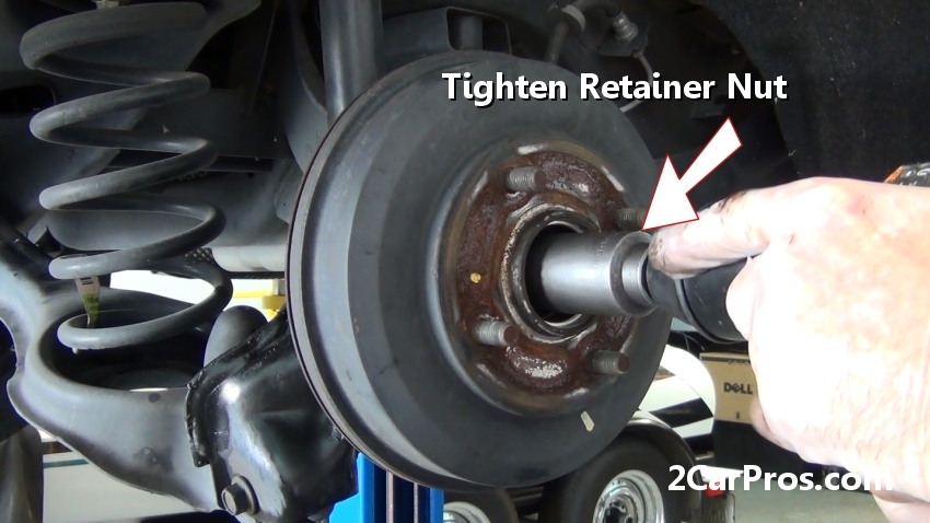

5. After threading the retainer nut onto the axle tighten it to manufacturer's specifications usually between 170 and 240 foot pounds of torque. At this point the brake drum should still spin freely with minimal contact to the brake shoes. If the brake drum does not spin the shoes are too tight and the drum must be removed to readjust the shoes inward.
WARNING: Don't think the shoes will just wear in, this is a mistake because the brake will heat up and expand which will make the problem even worse until the wheel stops turning altogether and locks up.
tighten brake drum retainer nut

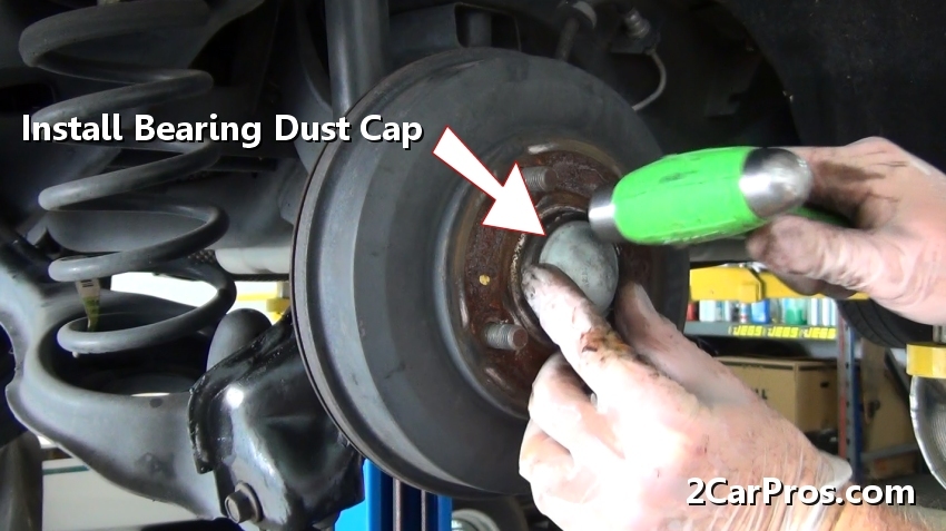

6. Reinsert the bearing dust cap by gently tapping it into place using a hammer. These caps are made of thin sheet metal and can bend and distort if hammered on to hard in which case they will lose their ability to hold onto the drum and must be replaced. Once competed on the both sides follow the guide on how to reinstall the wheel and remove the car from the jack stands.
install bearing dust cap

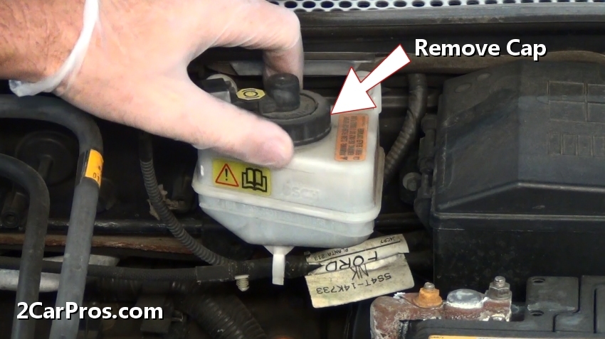

1. Lift the hood of the car and locate the brake master cylinder's fluid reservoir. Clean the top of the brake master cylinder using a shop towel then loosen and remove the lid.
remove master cylinder cap

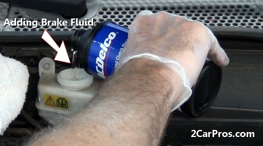

2. If the fluid level is low add brake fluid from a sealed container until the level reaches the fill line.
adding brake fluid

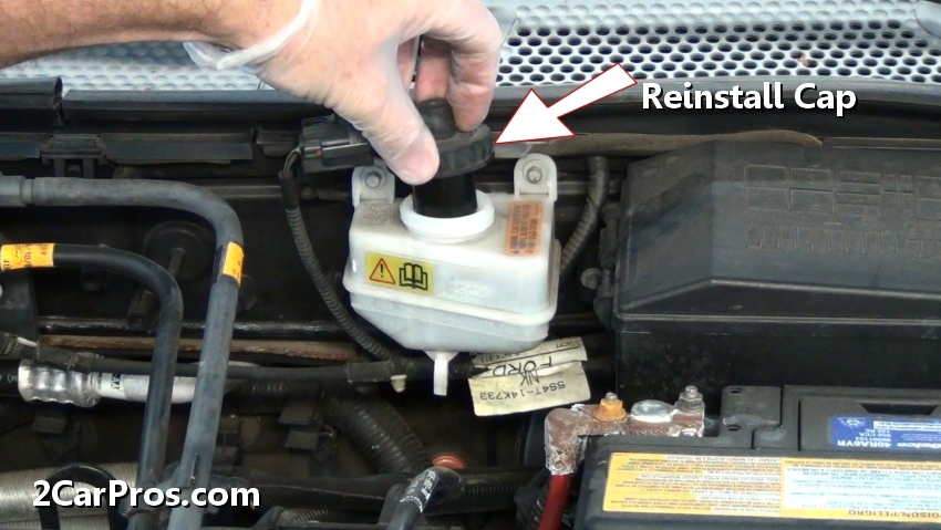

3. Reinstall and tighten the reservoir cap.
reinstall brake master cylinder cap

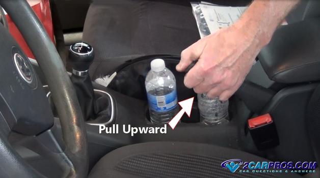

Once both wheels have been completed and the car is back on the ground the brake shoes are ready to be set to the drum, hold the brake pedal down and activate the parking brake lever several times. This operation will give the brake shoes a final adjustment automatically by actuating the brake shoe self adjuster. This will also increase firmness of the brake pedal.
pull parking brake
