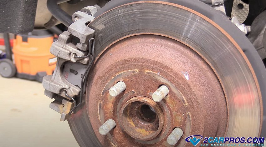

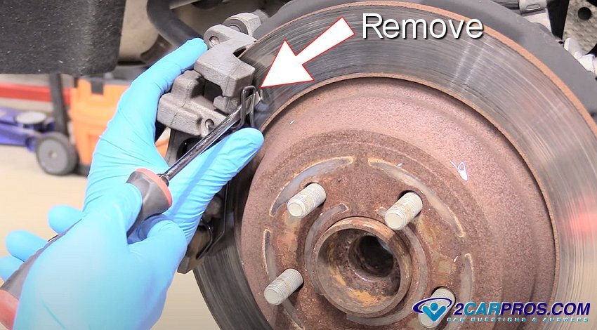

1. Begin removing the rear brake caliper which can sometimes have a retainer clip that can be undone by using a large standard screwdriver.
remove rear brake caliper retainer spring

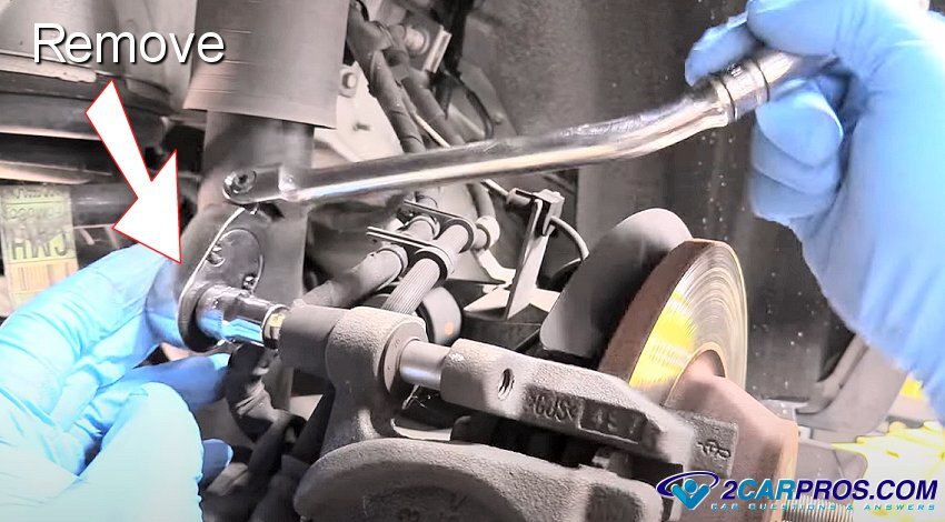

2. From the rear of the caliper remove the brake caliper mounting bolts (2) which might have protective plastic covers, (The bolt size will vary depending and the manufacturer, in this case it is a 10mm Allen).
remove rear brake caliper mounting bolts

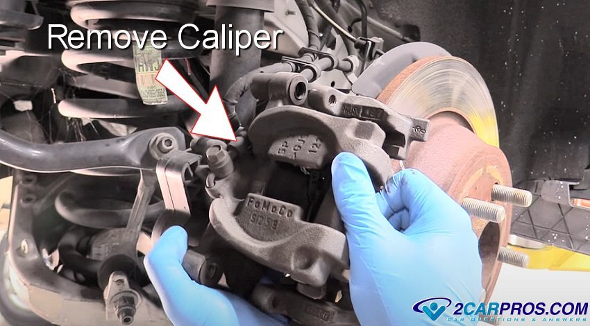

3. Wiggle the brake caliper back and forth to help loosen it from the rear brake rotor. Make sure the mounting bolts are pushed out of the way while lifting the caliper off of the rear brake pad retainer plate. Once loose, support the caliper using zip ties or bailing wire, (Do not allow the caliper to hang by the brake hose).

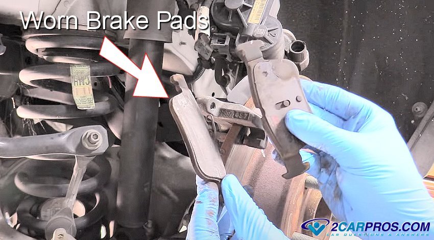

4. The rear brake pads will come off with the caliper or be left sitting in the brake pad retainer bracket, simply remove them for inspection. If you notice that one pad is worn much more that the other then please visit this guide to find out why - Uneven brake pad wear.
worn out rear brake pads

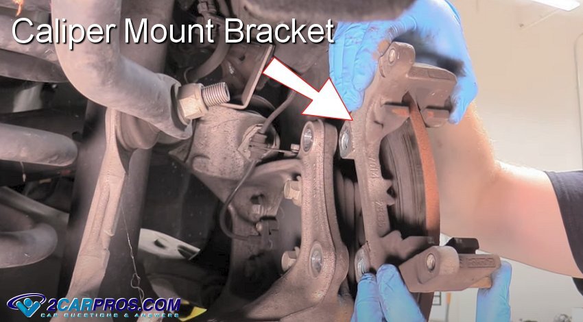

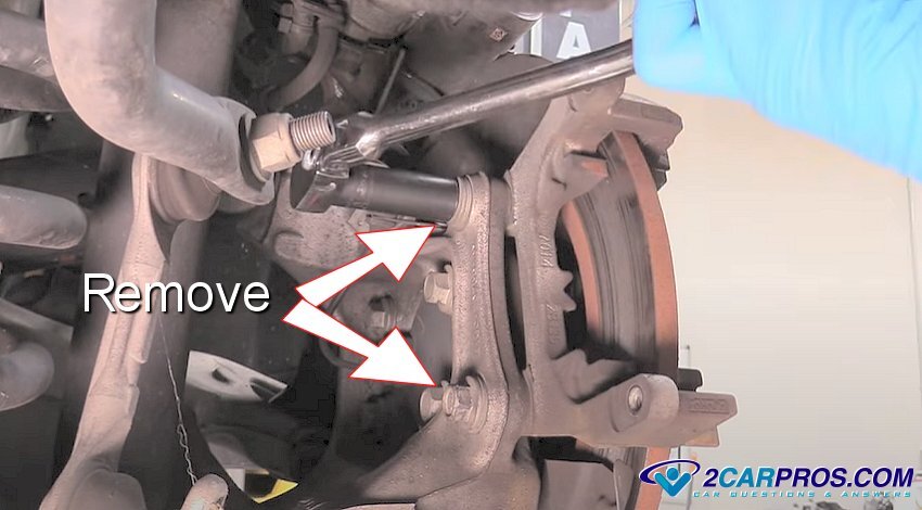

5. To remove the rear brake rotor for replacement loosen the caliper mounting bracket bolts and then remove them, these can be tight so be ready and use high quality tools.
remove brake caliper mounting bracket bolts
6. Grasp the caliper mounting bracket and lift it from the axle. Inspect the caliper slides on the bracket and service the slides by cleaning and adding a small amount of brake grease to lubricate. This guide will go into more detail - Service brake caliper slides.

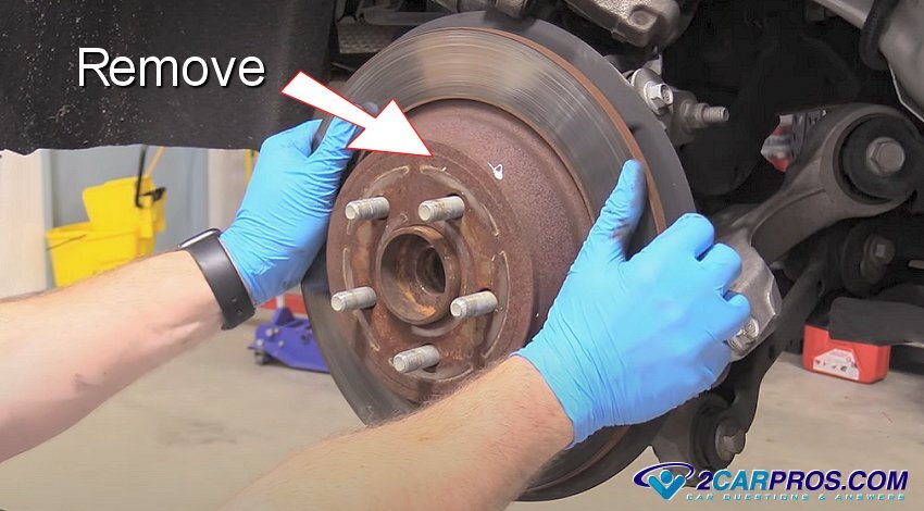

7. Grasp the rotor firmly to remove it from the bearing hub, if the rotor is stuck use a hammer and strike the rotor near the edge of the axle flange, this will force the rotor free., (Do not strike the wheel studs) if the rotor is still stuck please use this guide - Stuck rear brake rotor.
remove rear brake rotor

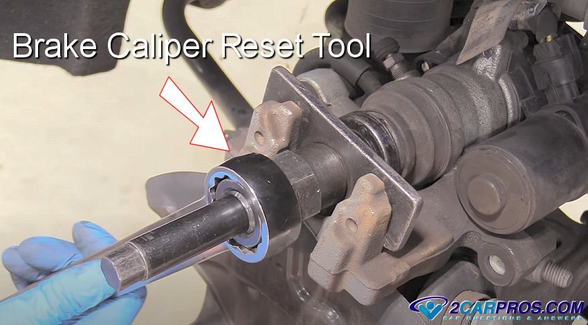

8. If you have the integrated rear caliper parking brake arrangement you will need to use a caliper reset tool which is shown below, this reset tool will help screw the piston back into the caliper, (clockwise). These calipers cannot be compressed with a clamping tool, it can only be retracted by using the reset tool. If you have troubles using this tool please use this complete guide to help you - Rear brake caliper reset tool.
If you have the non-integrated brake caliper, install an old brake pad as a buffer between the tool and the caliper piston(s). Use a large "C" clamp or channel locks to press the caliper piston(s) inward until fully retracted.

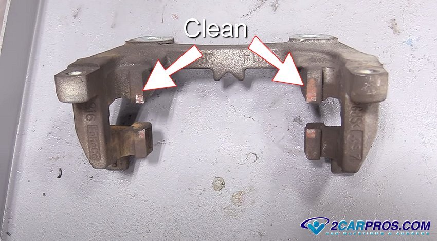

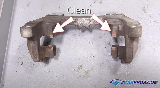

9. On the brake caliper mounting bracket use a wire brush and brake cleaner to wipe away any rust or dirt on the rear brake pad mount surface.
clean-brake-pad-mounts

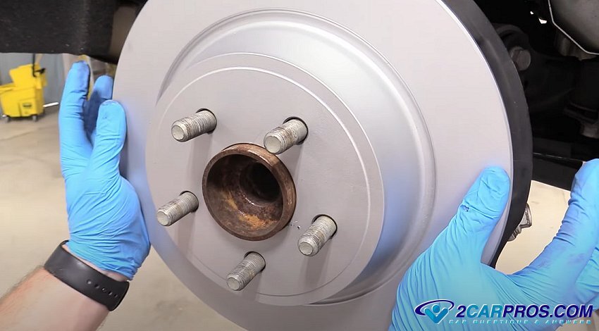

10. Match the old brake rotor to the new one, then clean the brake surfaces using brake cleaner and also clean the bearing hub rotor mounting surface. This will ensure the rotor sits flat on the hub to avoid brake pedal pulsation. Also, reinstall the caliper mounting bracket and torque to the manufactures specifications.
install new rear brake rotor

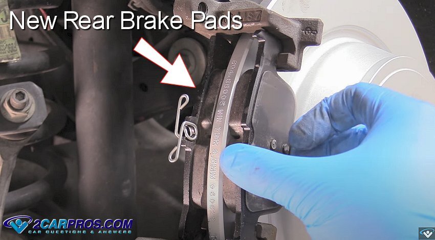

11. Remove the new rear brake pads from the box and match to the worn pads to ensure proper fit. Also, some brake pads are designed to work with retainer clips or slides which will be included with the new brake pads (not shown). Re-install the new rear brake pads as they were removed. Be sure the locating tab on the rear of the inboard brake pad is fitted into the slot of the caliper piston. Note: Do not apply grease to the rear of the brake pads.
install new rear brake pads

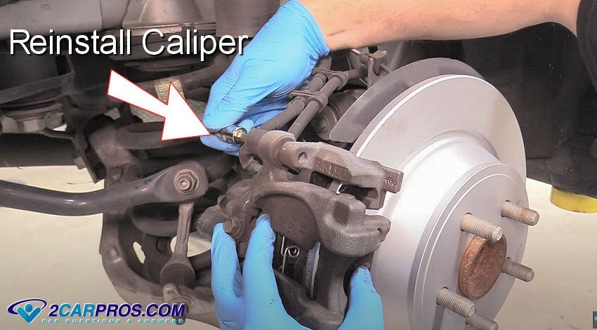

12. Next, install the brake caliper onto the brake pads and caliper mounting bracket while retracting the brake caliper slides. This can take some doing so hang in there, (do not use a hammer to install the caliper to avoid damage). Once the caliper is in place, reinsert the caliper mounting bolts and tighten to factory specifications. Complete the job by duplicating this procedure on the opposite side.
