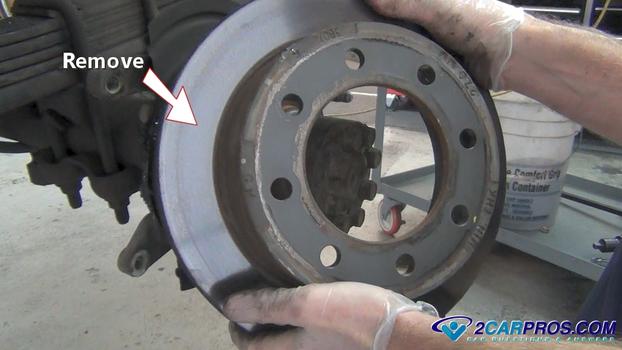

Remove the Bearing Hub

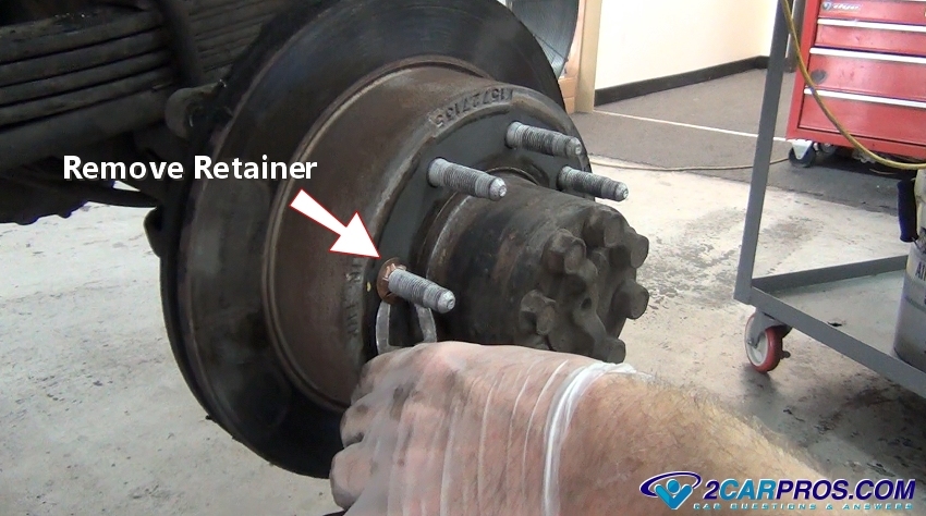

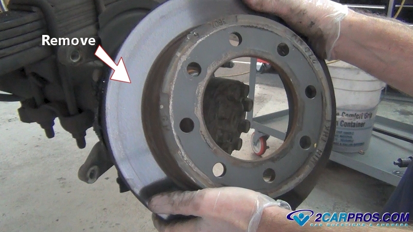

Once the brake caliper, mounting bracket and pads have been removed the brake rotor is next. Some rotors will have this annoying little retainer which is put on during manufacturing to hold the rotor on while the vehicle is moving around in the factory during assembly. This clip can be removed and discarded, use a pair of side cutters (dikes) to get under the clip and with the twisting motion grab the clip to remove.
remove rotor retainer
Sometimes the rotor will be stuck on the bearing hub, use a hammer to "shock" it loose by striking it between the wheel studs being careful not to hit the studs. Grasp the rotor and pull it from the hub.
remove from bearing hub

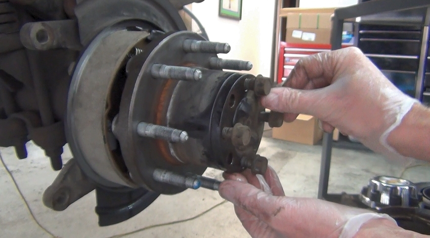

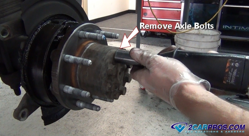

remove axle bolts

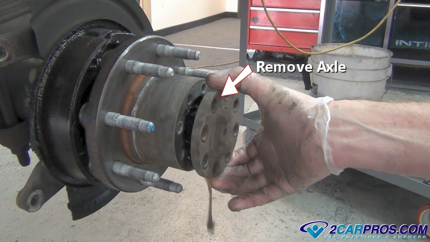

The axle will now be loose, grasp the end and pull outward. This will begin the axle removal, have a fluid catch basin ready because gear oil will leak out.

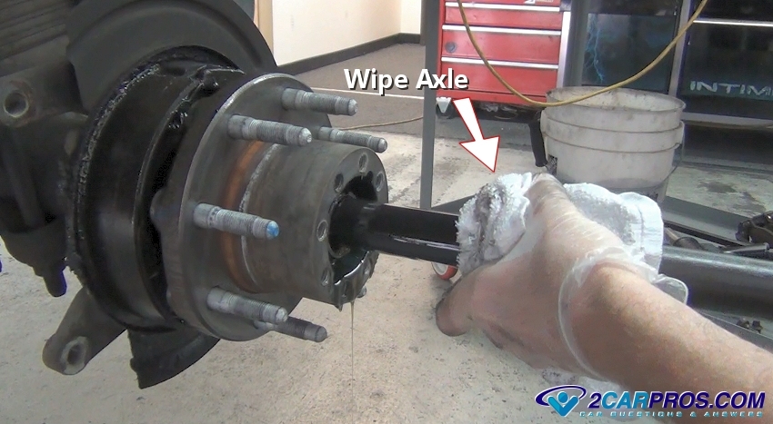

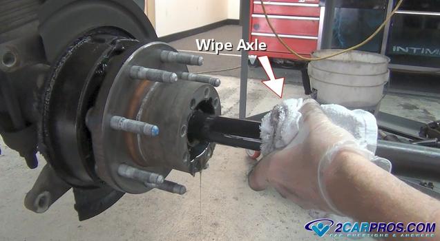

Use a shop towel to rap around the axle and continue to pull it out of the differential. Hold pressure on the towel to wipe the excess gear oil into the fluid catch basin.
wipe axle

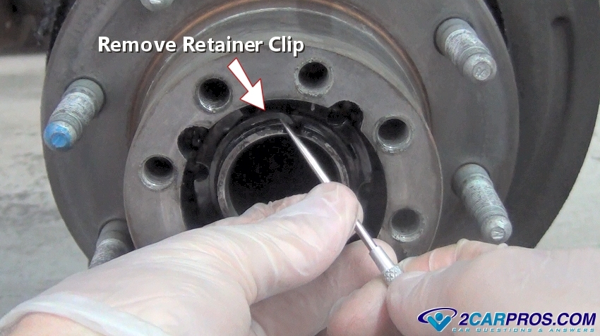

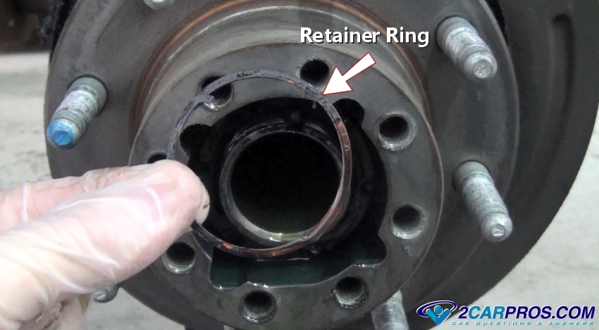

Use a small pick to move the end of the axle nut retainer ring upward. This will allow you to remove the ring while working the retainer ring from the axle tube threads. This ring is made of spring steel so try not to pull on it to hard or it will distort its form and may need to be replaced.
remove axle retainer nut clip
This is what the retainer ring look like when it is fully removed. Wipe this part clean and set it in a plastic container so you do not loose it, there will be more parts to follow.
retainer ring removed

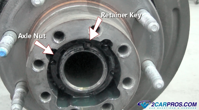

This will expose the retainer key and axle nut. This nut sits on the differential housing loose with the only thing holding it in place is the retainer key. That's why the retainer spring clip is so important to be installed correctly. The key is basically a small square piece of high grade metal the sits in a grove in the axle tube threads in which the axle nut threads onto. You can see the nut has spun a little holding the key from sliding out easily. You can rotate this nut slightly so a small magnet can pull the key outward.

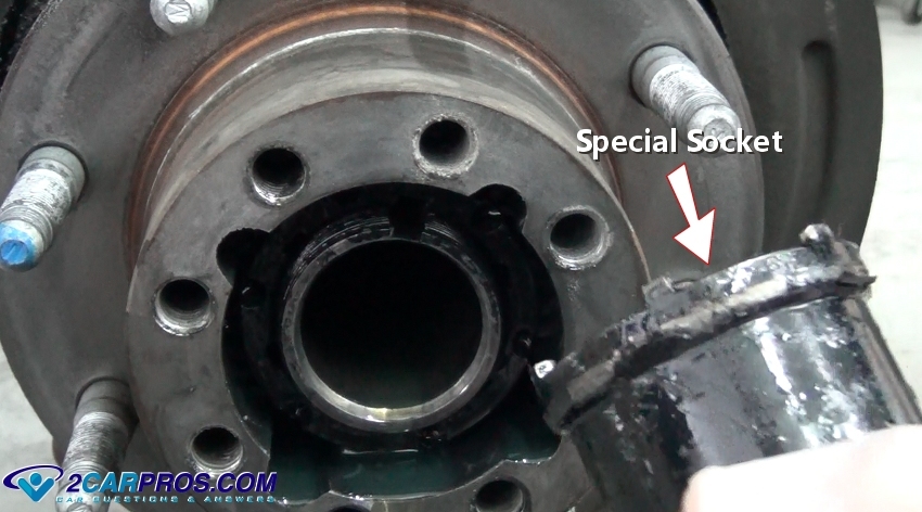

They make a special socket to remove the axle nut but it is not needed even though it makes the removal of the nut easier. Like we said earlier this nut sits loose on the housing threads and can also be removed using the small punch in one of the indentations in the nut.
special axle nut socket

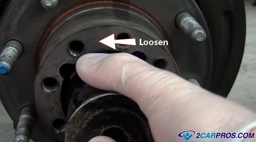

Insert the socket or small punch and start turning the axle nut counterclockwise. You can push the top of the rotor inward which will help take the residual pressure off of the bearing nut and will make it turn even easier. Continue to loosen the nut until fully removed.
loosen axle nut

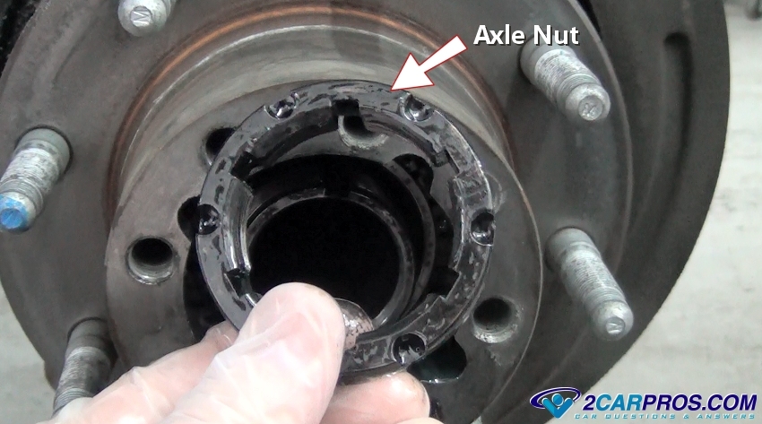

Here is what the axle nut looks like removed for the differential and bearing hub. You can see the symmetrical indentations which are used to remove the nut and the various keyway slots used for the adjustment of the bearing preload.
axle nut

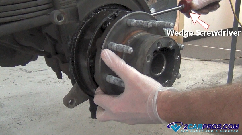

To remove the bearing hub use a large screwdriver or pry bar to "pop" the bearing hub loose. It can be a little stuck because of the oil seal which attached to the hub and the axle tube. Apply pressure to the hub moving it outward while turning the hub slightly.
removing axle bearing hub

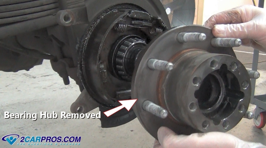

Now the bearing hub will slide off easily. It is heavy though so keep your hands on it so it doesn't fall. A slight amount of gear oil might leak out so have a shop towel ready.
bearing hub removed

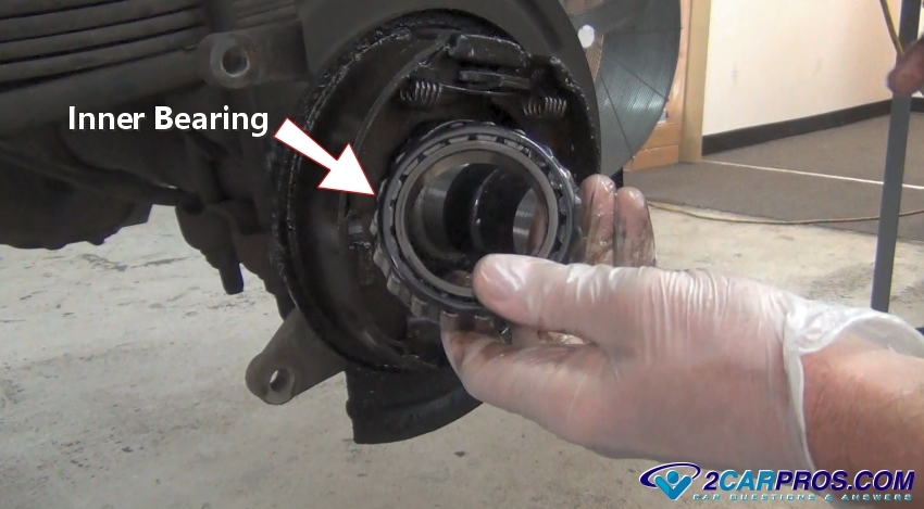

This is what the inner axle bearing looks like when it is removed from the differential housing. This bearing easily slides off of the axle tube and will have gear oil on it.
inner axle bearing

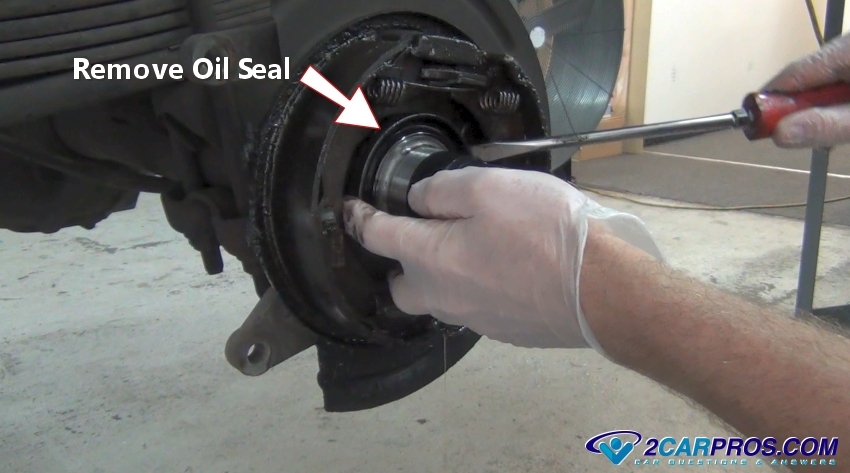

Next, use a large screwdriver or pry bar to force the oil seal from the differential. This seal is wedged between the differential housing and the bearing hub while allowing the hub to turn. This seal is a little different that traditional seals as both upper and lower parts of the seal are stationary wedged onto the bearing hub and axle tube. While the actual seal part is inside the seal assembly itself.
remove oil seal from differential

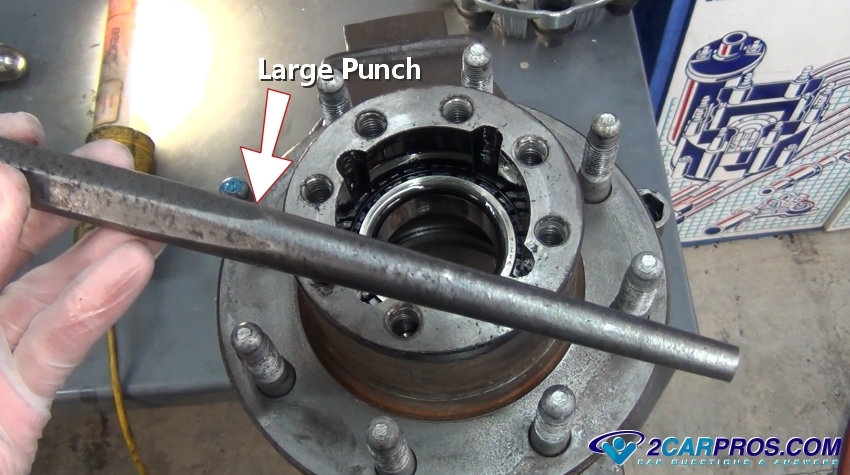

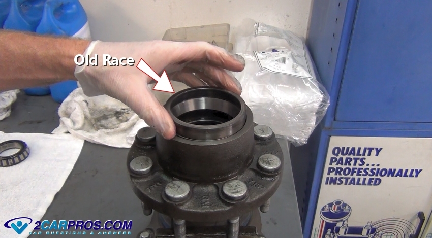

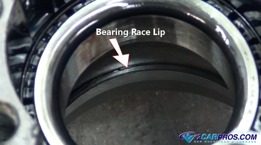

Looking inside the bearing hub you can see the bearing race lip sticking out from the actual hub casting. This is where you will set the large punch against to hammer the race from the hub.
bearing race lip

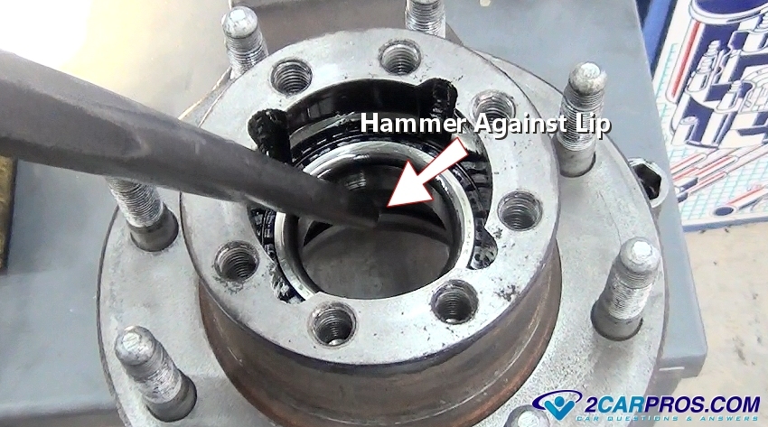

Use a large punch which is show here with a nice square edge at its tip. If the punch tip is rounded use a grinder to flatten the tip before beginning to remove the race. This will help remove the race more efficiently.
large punch
Begin by placing the punch tip against the race lip and begin the removal process by striking the opposite end of the punch with a large hammer. Continue the removal process by working around the race evenly until completely removed. To remove the outer bearing you must remove the snap ring from inside the hub and hammer the bearing out with the race together using a bearing driver tool.
hammer against bearing race lip

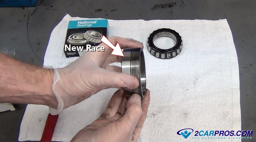

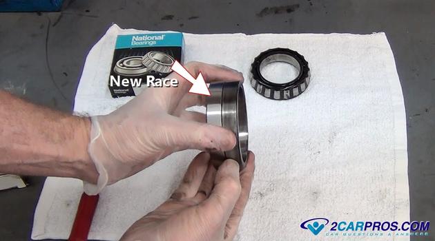

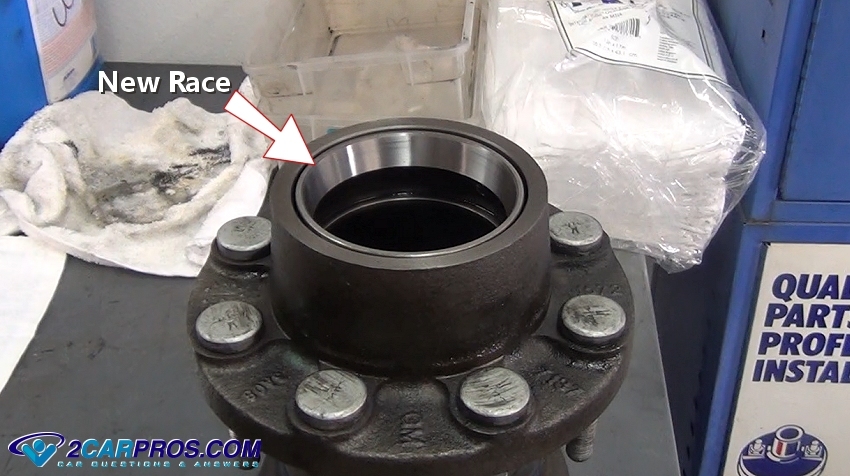

Remove the new replacement race from the box and hold it against the old race to check the outside diameter, they should be the same.
match new bearing race

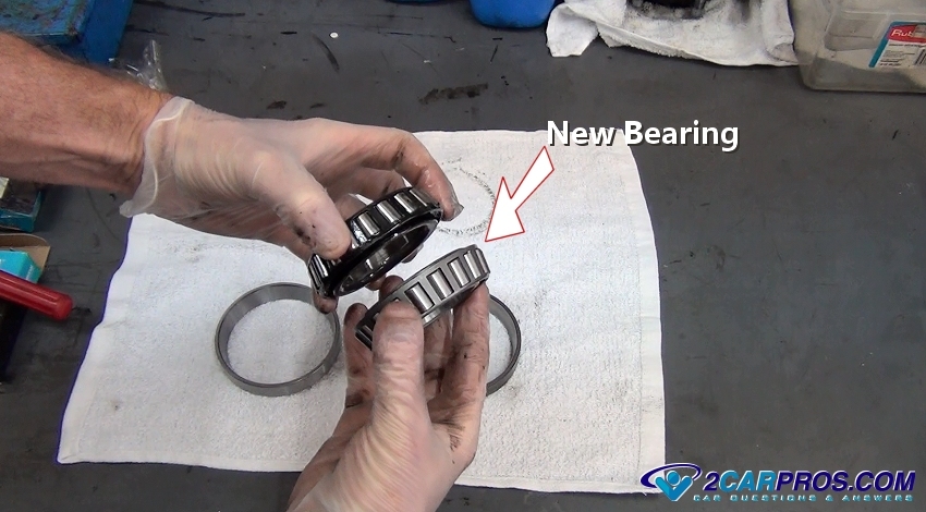

Next, remove the new axle bearing from the box and match it to the old bearing, they also should be identical.
new axle bearing

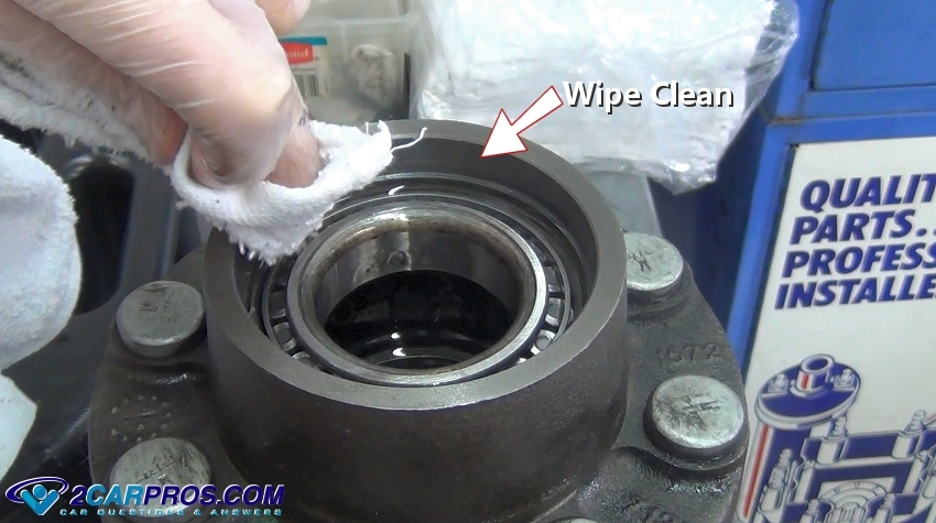

Use a shop towel to wipe clean the bearing mounting surface before installing the race. Get this as clean as possible because you don't want any lubricant between the race and the hub. This can cause the race to lose its press fit in the hub and the hub will need to be replaced.
wipe bearing hub clean

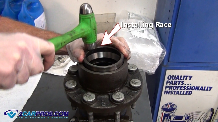

Set the new bearing race squarely into the bearing hub, you want this is flat as possible.
installing new bearing race
Set the old race onto the new race, this will be used to start the new race installation. A bearing installer can be used for this as well but this works pretty well.
set old bearing race onto new bearing race
Use a hammer and work around the race evenly to start the installation. Keep checking the old race and stop be for it gets stuck in the bearing hub. You will finish the installation using the large punch.
installing bearing race

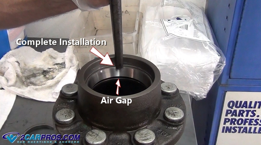

Now, use a large punch to drive the race completely into the bearing hub by circling around the race. You will feel the hammer bounce back once the race is installed completely as the air gap closes. A race driver can also be used for this operation.
complete bearing race installation

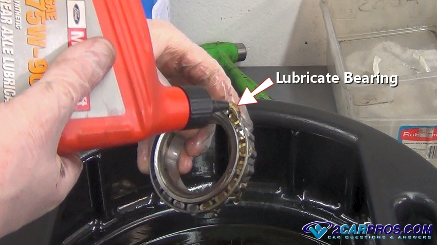

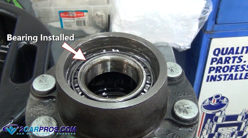

Before installing the bearing into the race bath it in gear oil. This will lubricate the bearing and help avoid premature failure.
lubricate axle bearing
Set the bearing into the race cone side down, then spin the bearing to spread the gear oil around the race.
inner axle bearing installed

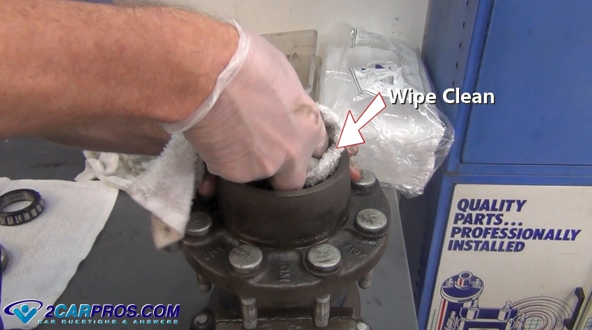

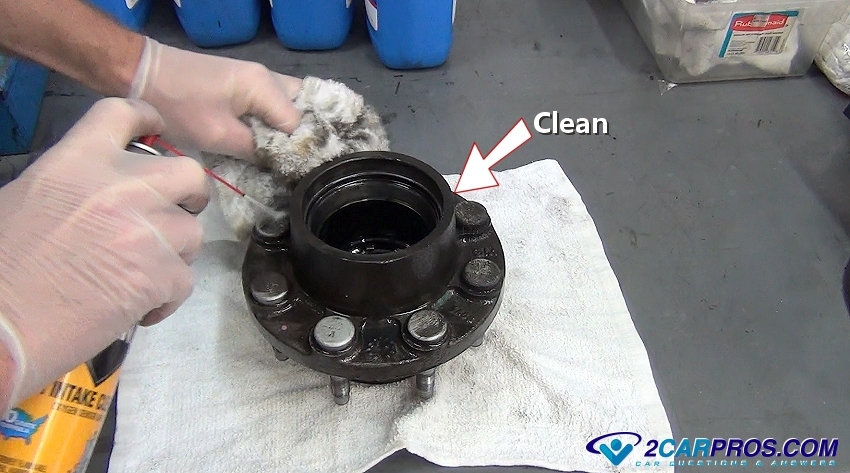

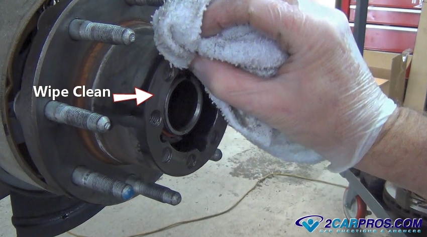

Use a shop towel to wipe clean the bearing hub at the seal surface. Do not install the seal with gear oil present because it will cause the seal to become loose in the hub and leak.
wipe clean bearing hub

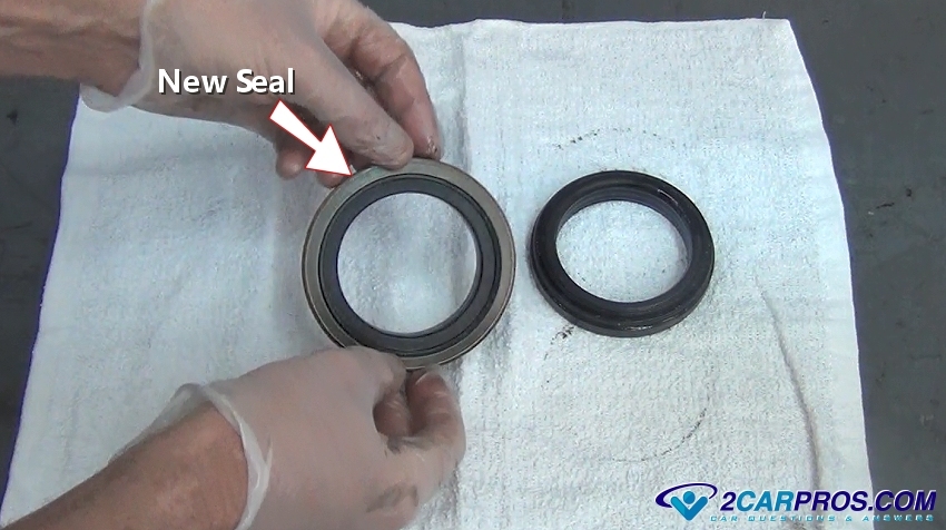

Match the oil seal to the new unit. This particular seal has been redesigned for better performance. The new seal is ready to be installed.

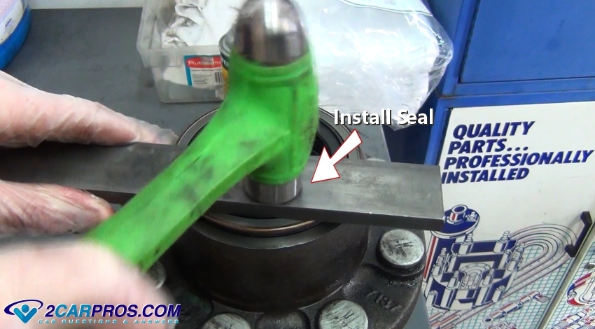

Set the seal flat on the bearing hub while the bearing is in place positioned in the race. Use the seal driver or a flat piece of metal works pretty well. Hammer the seal until flush with the bearing hub.
install seal into bearing hub

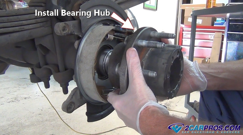

Apply a light coat of gear oil over the differential axle tube surface and then carefully install the bearing hub. Be mindful of the seal as too not allow it to hit the threads while being installed. This can damage to seal and cause a leak. Jog the hub slightly to push the hub completely onto the differential. This will help the tight fit of the bearing to push onto the close clearance of the axle tube.
install bearing hub

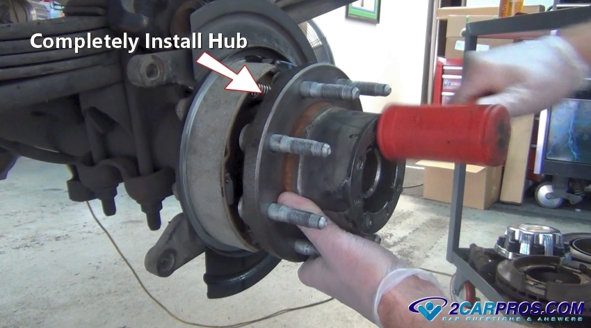

Next, you will need to use a plastic hammer and push the seal onto the axle tube which is a press fit. This will lock the seal in place between the the hub and the axle tube.
completely install hub

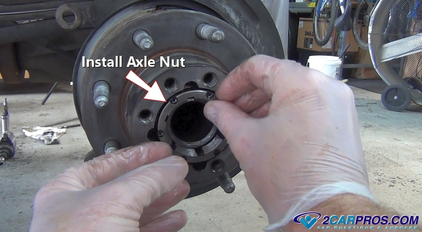

Install the axle tube nut by hand to avoid cross threading by turning it clockwise.
install axle tube nut

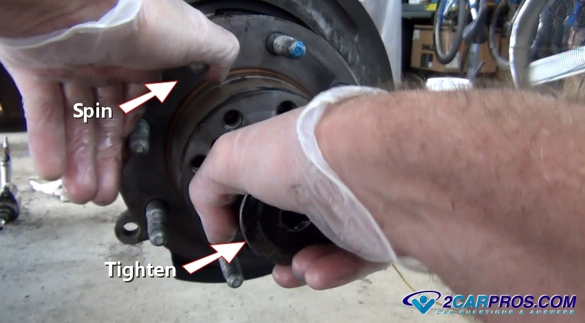

Install Axle Nut and Set Bearing Pre-load

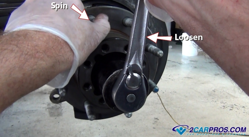

This part is important and must be done correctly or the bearings will fail. While spinning the bearing hub tighten the axle bearing nut by hand to remove the play. You will feel the nut the get tighter as the play is removed, keep spinning the hub while removing all free play from the bearings.
set preload on axle bearing hub
Once you have tightened and removed all of the free play in the bearings, continue turning the hub as you loosen the axle nut about 1/8 of a turn. This looseness is too allow the bearing room to "grow" as they expand with heat. If there is no room, in others word if the bearings have no free play they will self destruct due to heat from expansion once the vehicle is loaded and in motion for any length of time.
setting preload axle bearing

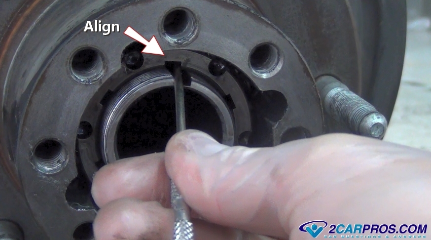

Use a pick or small screwdriver to align the axle nut so the key will be able to be installed. This will move the nut, you will need to make a judgment call on the nut to go slightly tighter or preferably looser.
align axle nut

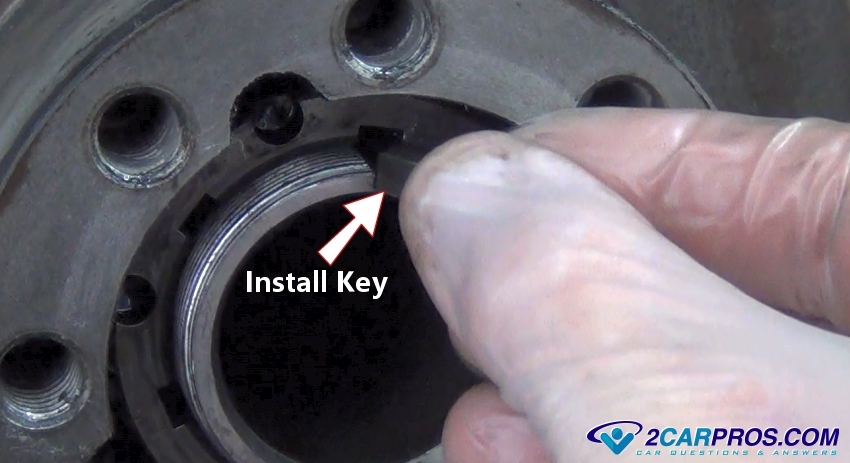

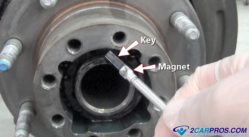

Clean the axle nut key with a shop towel and then slide the key into potion onto the axle tube and under the axle nut.
install axle nut key

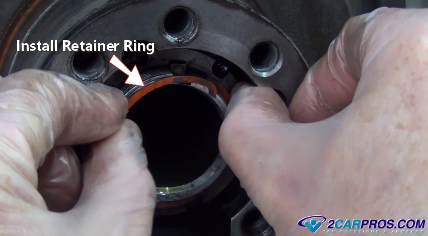

Clean the retainer ring using a shop towel. Start the installation at the side of the ring without the bend. Push it completely flush against the axle nut while working it around onto the axle tube and into the tube threads. The bend is to hold onto the threads of the axle tube. This clip holds the key in place under the axle nut and prevents the nut from unwinding. The axle is ready to be reinstalled.
install axle key retainer ring

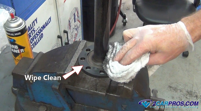

Using a shop towel wipe the axle flange clean using carburetor and brake cleaner. Again this needs to be as clean as possible to avoid leaks once reassembled.
wipe axle flange clean

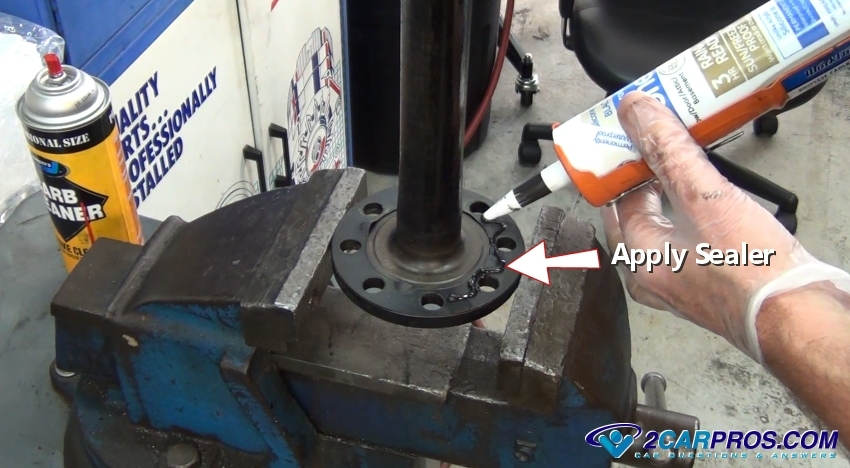

Apply axle sealer to the axle flange. Make sure to go inside the bolt holes while applying to avoid leaks. Spread evenly with you finger until the entire gasket is covered.

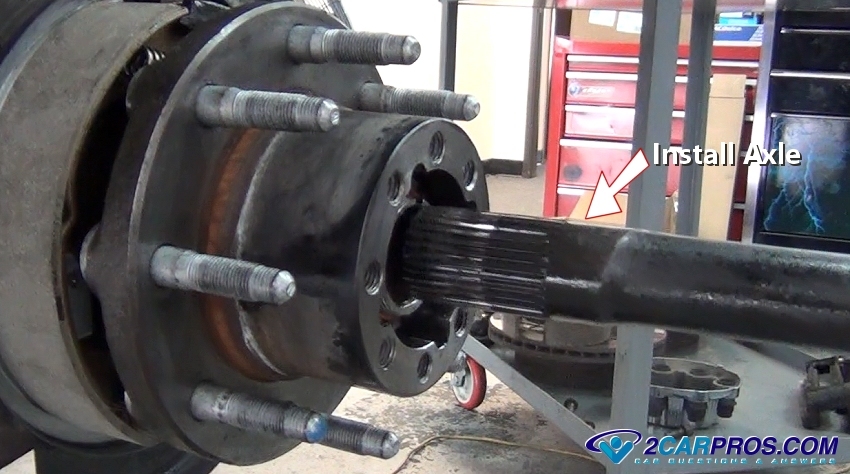

Install the axle into the axle tube of the differential. Be sure the axle does not drip gear oil onto the bearing hub axle flange. You will need to rotate the axle so the splines will insert in to the gear carrier inside the differential. Finish by aligning the bolt holes to the bearing hub.
install axle

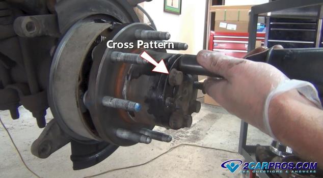

Reinsert all of the axle bolts by hand to avoid cross threading.
installing axle bolts

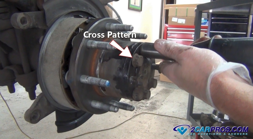

Tighten the axle flange bolts in a cross pattern. Once the wheel is on the ground and after reassemble is complete, toque these bolts to factory specifications which is usually 65 to 75 pounds. Wipe any excess sealer from the bearing hub and axle. Now the brake rotor and the remainder of the brake can be reassembled. If the truck has many miles on it it's a good idea to replace the other side as well. After driving the vehicle for a short time check the hub to make sure it is not leaking.
tighten axle flange bolts
