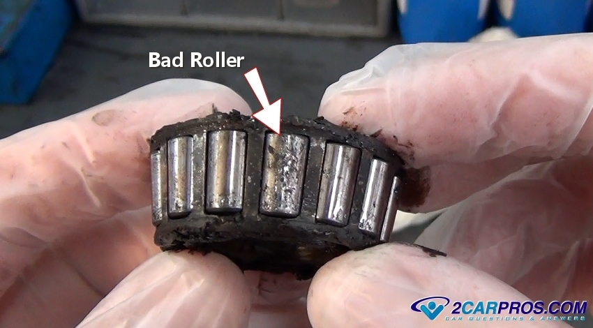

A bearing is made of high grade steel which has a super hard coating over the rollers, inner and outer races. A bearing goes bad when this coating is worn away due to mileage or extreme load which just leaves the normal steel which then degrades and destroys the bearing components. Also, failures can occur when moisture combined with salt from roads penetrate the seal and contaminate the bearing, or over time the grease used to lubricate the bearing can liquefy leaving it dry causing a failure. This is what a failed axle bearing looks like. You can see the roller cage is broken and there are pits on parts of the rollers themselves. Parts of metal get caught up in-between the rollers and the upper and lower bearing race while under high pressure. This creates a grinding action which can be felt while driving the vehicle. These bearings are used in the front hubs and rear axles of all vehicles. Some CV axle bearings are actually two sets of ball bearings put together but fail the same way. Here is a close up of the bad bearing roller.
bad bearing roller

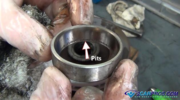

This is what happens to the bearing race once the bearing goes bad. Here is an example of what happens when the metal particles from the bad roller is pressed against the race under high pressure.
bad bearing race

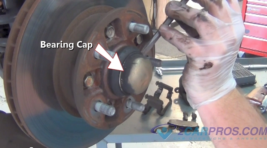

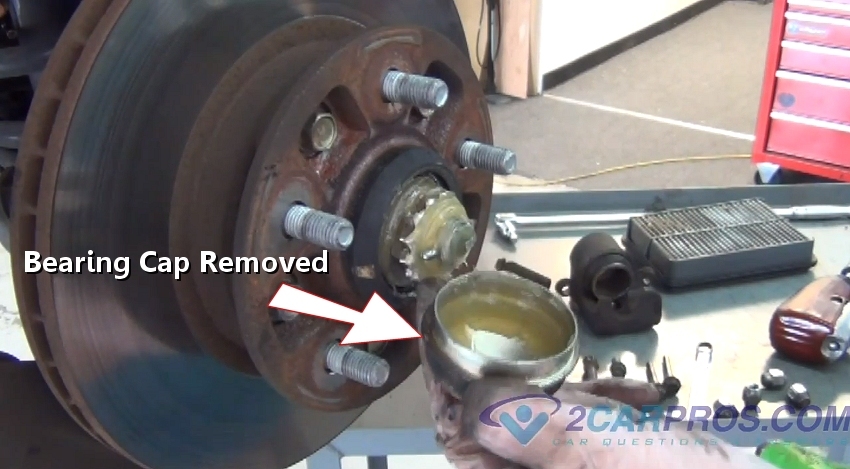

The first part of doing a brake job on a serviceable wheel bearing vehicle is pretty much like one performed on a non serviceable bearing hub style of car. The guide below will show you how to remove the rotor and replace the wheel bearings, also how to repack and the bearings with fresh grease and install a new grease seal. We will start with removing the rotor, please follow the guide below. Place a small chisel between the dust cap and outer bearing boss of the rotor, then use a hammer to knock the bearing dust cap loose from the rotor. You can also use a large pair of channel locks and grasp the cap and rock it back and forth to remove.
Reverse the direction of the chisel to remove the bearing cap completely.
bearing cap

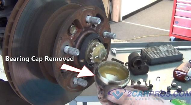

Once the cap has been removed it will expose the outer bearing, retainer, nut or castle nut, and cotter pin. There will be grease present which is used to lubricate the bearings.
bearing cap removed

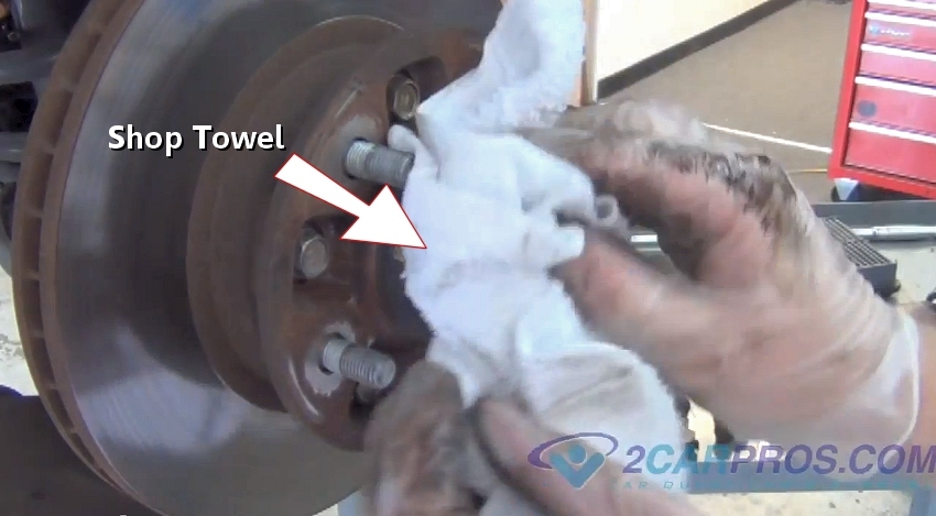

Use a shop towel to clean the cotter pin area free from grease.
clean cotter pin

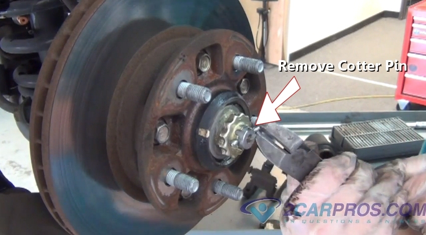

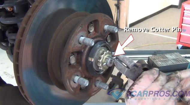

Next, use a pair of dikes to remove the cotter pin from the spindle. This will take a little doing, don't worry about damaging the pin because you will be installing a new one. Use a pair of side cutters (dikes) to help remove the cotter pin which is used to keep the castle nut in place.
remove cotter pin

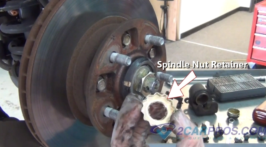

After the cotter pin has been removed, lift off the spindle nut retainer and place it in a container this is so none of following pieces get lost.

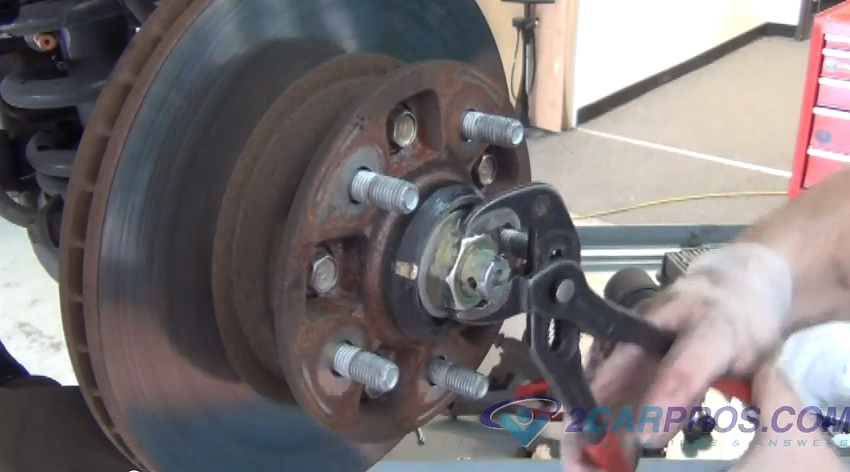

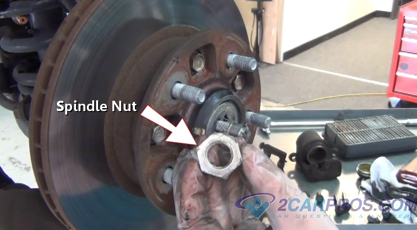

Use a wrench or channel locks to remove the spindle nut, this nut should be loose when removing it because this style of bearing is a non-tension set up and the nut sits loosely on the spindle while the retainer and cotter pin holds it in place.
loosen spindle nut
Once the nut has been fully loosened, lift the nut from the spindle threads and set it to the side for now, you will be using it to remove the inner bearing in a few steps.
spindle nut

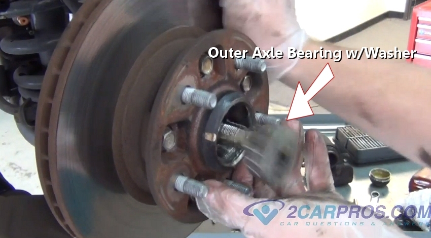

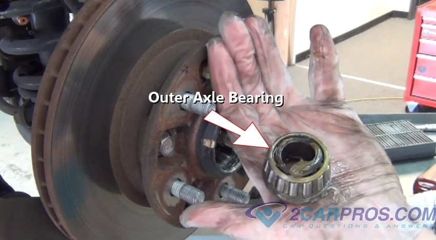

Use one hand and push your palm to one side of the rotor while holding your other hand under the outer bearing. This force will pop the outer axle bearing and washer outward, be ready to catch the bearing.
removing outer axle bearing
After the outer axle bearing has been released, inspect it for metal shavings which indicates the bearing has failed and needs replacement. Sometime they can get caught up in which case you must use a flat blade (standard) screwdriver to help remove the washer.
outer axle bearing

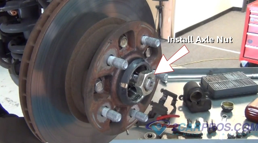

To remove the inner bearing and seal from the rotor hub for service, remount the axle nut onto the spindle, and tighten the nut about four turns.
mount axle nut

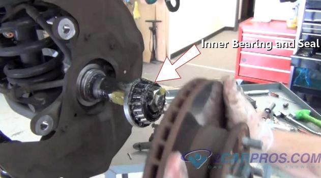

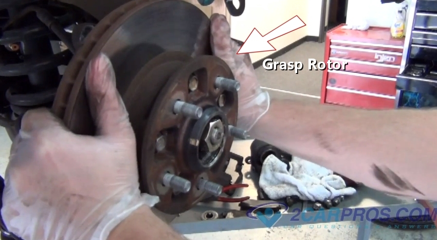

Grasp both sides of the rotor and with a thrusting motion pull outward. This will cause the nut to contact the inner bearing and force it from the hub along with the grease seal. Be careful not to drop the rotor.
grasp rotor

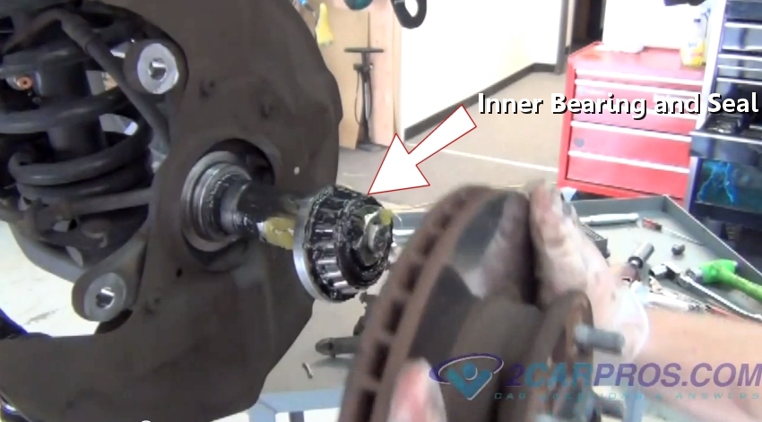

After thrusting the rotor outward, the bearing and grease seal will release and remain on the spindle behind the nut. The bearing will be pulled from the rotor and will be stopped by the spindle nut. This will leave the bearing and seal on the spindle for easy removal.
inner bearing seal

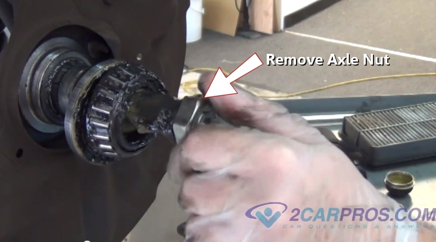

Remove the nut completely to remove the bearing and seal to clean thoroughly.
remove axle nut

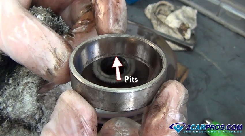

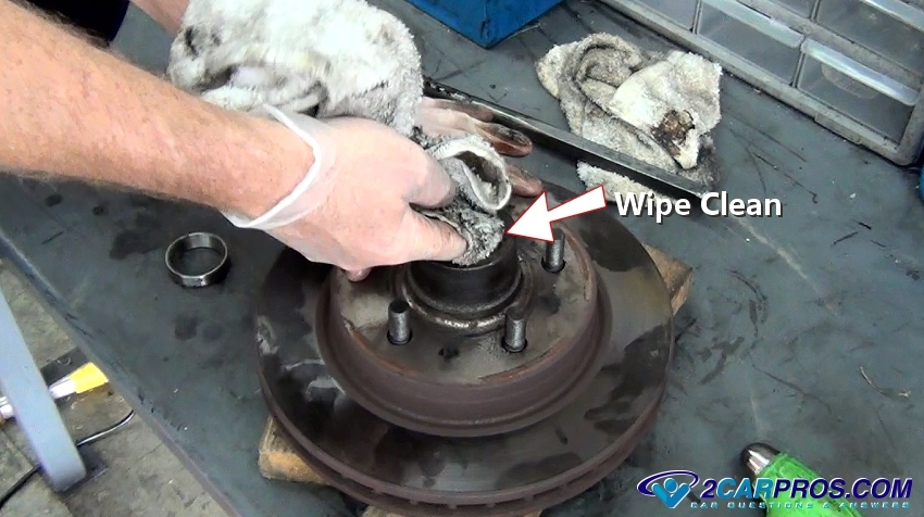

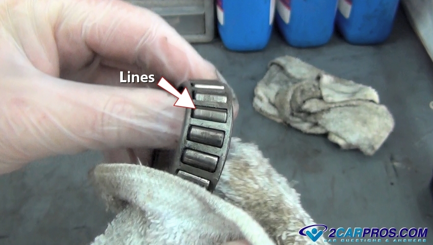

Use a shop towel to wipe the bearings and races clean. Look for a metallic pieces in the towel after cleaning which is an indication for a bad bearing even if you cant see it on any of the rollers. Also lines can be present on the rollers as well. This is a sign of normal wear and may not be an indication of failure.
cleaned axle bearing

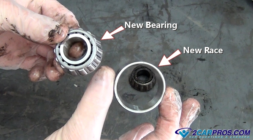

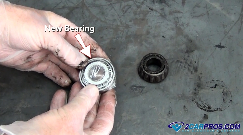

Remove the new bearing from the box. Smaller bearings have their races supplies with the replacement unit while larger bearings must have the races purchased separately. The bearing below has the race included.
new outer axle bearing
These bearings are matched to the race they are supplied with. Use extra care to not mix them up if you are replacing more than one bearing at a time. Match the old bearings to the new bearings to make sure the inner and outer diameters are the same.
new axle bearing and race

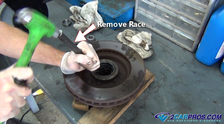

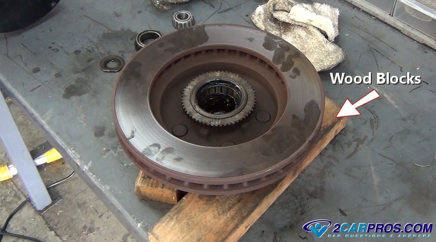

Use wood blocks to prop the rotor hub up from the table or ground to allow clearance for the bearing race to be removed.
wood blocks
Using a large punch with a freshly ground tip that is flat, locate the outer race lip which will stick out inside the rotor hub. Place the punch against the race lip to drive it outward while working around the race in a circular motion. Continue until the race falls from the bottom of the hub.
remove outer bearing race

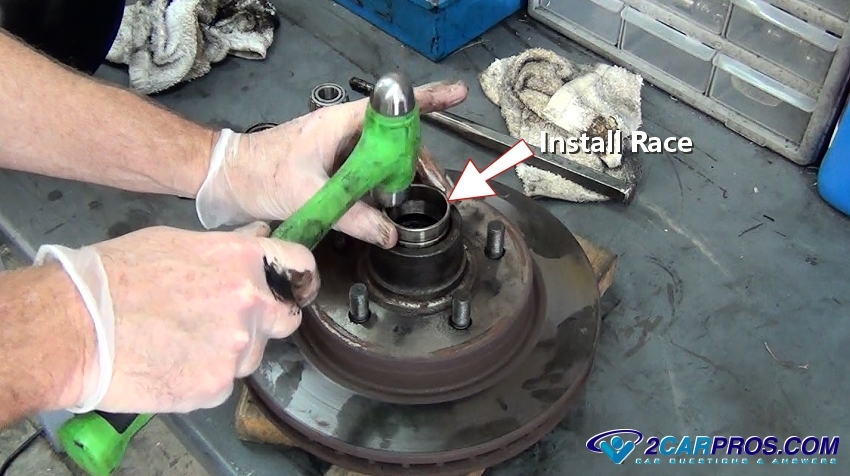

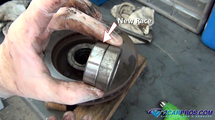

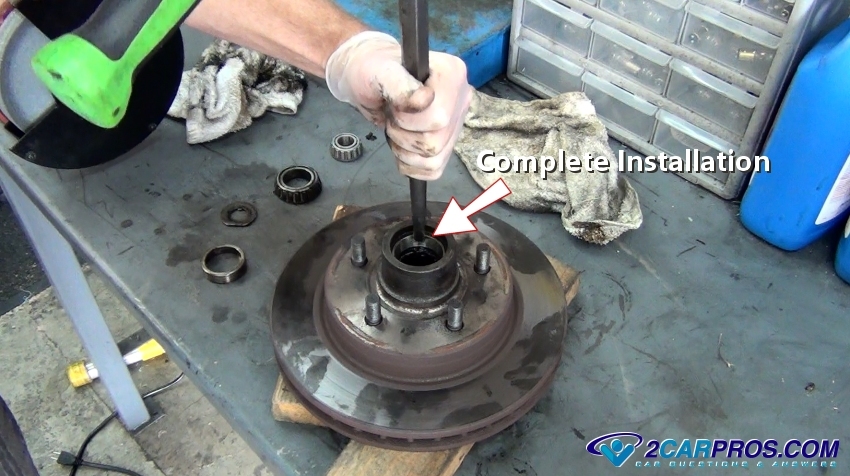

Set the new bearing race cone facing outward squarely into the rotor hub. Next, position the old bearing race on top off the new race. Use a hammer to install the new race into the hub. Once the old race gets close to the bearing hub stop the installation so the old race doesn't get stuck.
install new outer bearing race
Complete the race installation by used the large punch. A race driver can also be used for this as well. The hammer will create a distinct hardened noise once the race is completely in place as the race sits against the hub shoulder.
complete outer race installation
This is what a bearing race driver looks like. Choose the size that just is just a little smaller than the race. Once the new bearing has been installed they must be repacked with new grease and installed before the rotor can be reinserted onto the spindle.

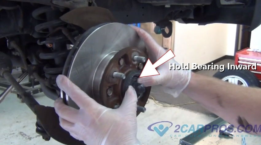

Lift the hub and rotor while using both thumbs to hold the outer bearing in place, slide it back into position. Some resistance may be experienced, a slight jostling may be required. Spin while installing until you feel the bearing and seal set back into place.
installing bearing hub rotor

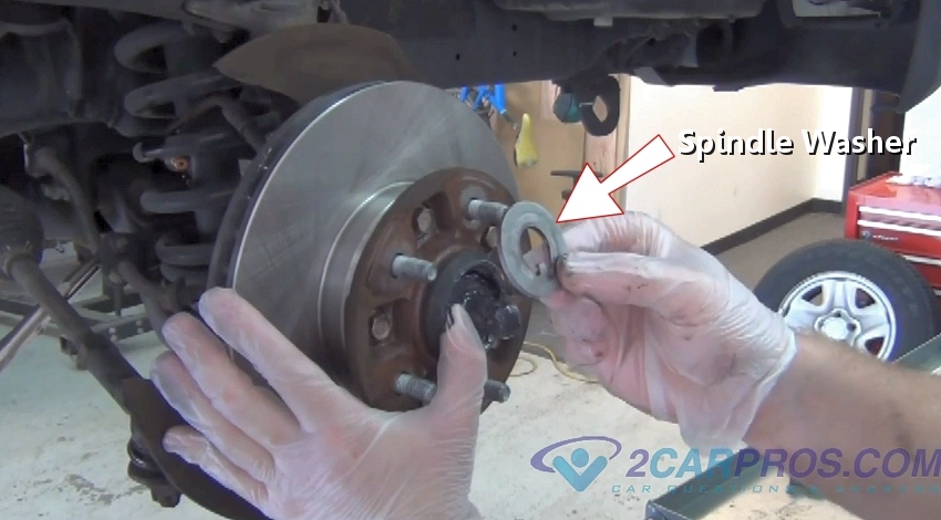

Once the bearing hub rotor assembly is back into place, install the spindle washer which will have a tang on it that matches the groove in the spindle.
spindle washer

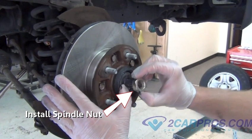

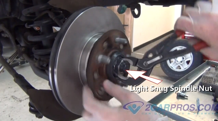

After installing the spindle washer, install the nut and tighten to take away the free play but do not tighten.
install spindle nut
Step 8
Setting the Axle Bearing Preload
This part is important, if not done correctly you can ruin the bearings. Spin the brake rotor several times while tightening the nut just enough to remove the slack, remember this nut is not to be tight, and when set, just a little loose. This action sets the bearing into their races and allows the correct bearing play and preload. The axle nut should end up almost loose, allowing the bearing lash or play to be at the minimum. Do not over tighten, you can see the preload being set on the video in this guide.
light snug spindle nut

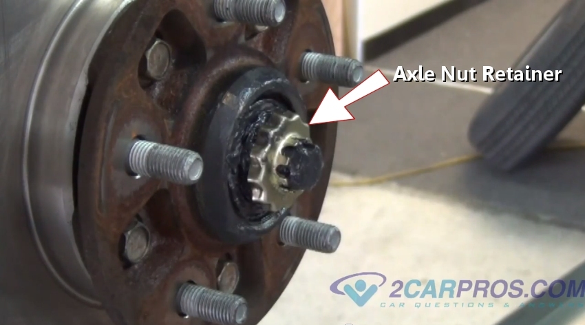

Next, install the axle nut retainer onto the axle nut, align the retainer with the cotter pin hole in the spindle. Some vehicles use a castle nut in which case the nut becomes the retainer as well.
axle nut retainer

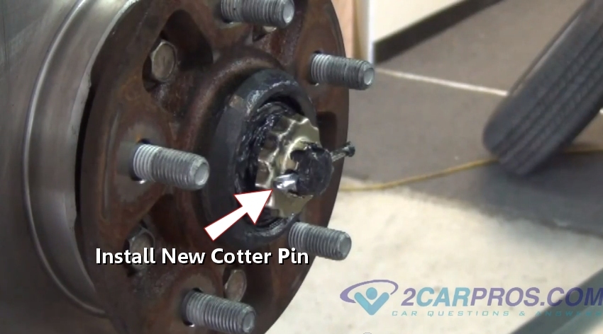

Next, install a new cotter pin and avoid using the old one. Locate the through hole and push the cotter pin into place.
install new cotter pin

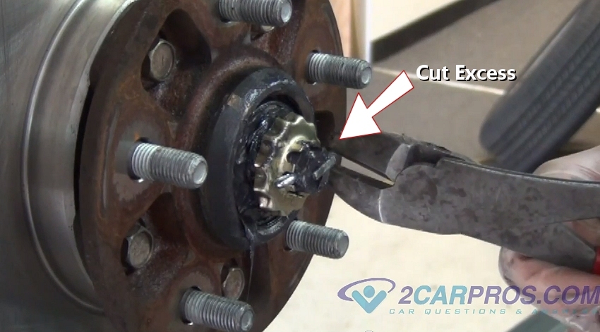

Once the cotter pin is installed, use a pair of dikes to bend the long end of the cotter pin over the spindle, cut off the excess cotter pin material.
cut excess

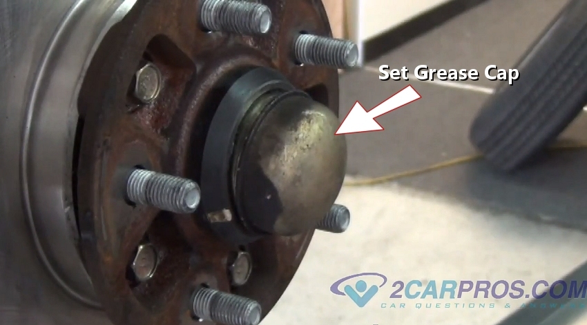

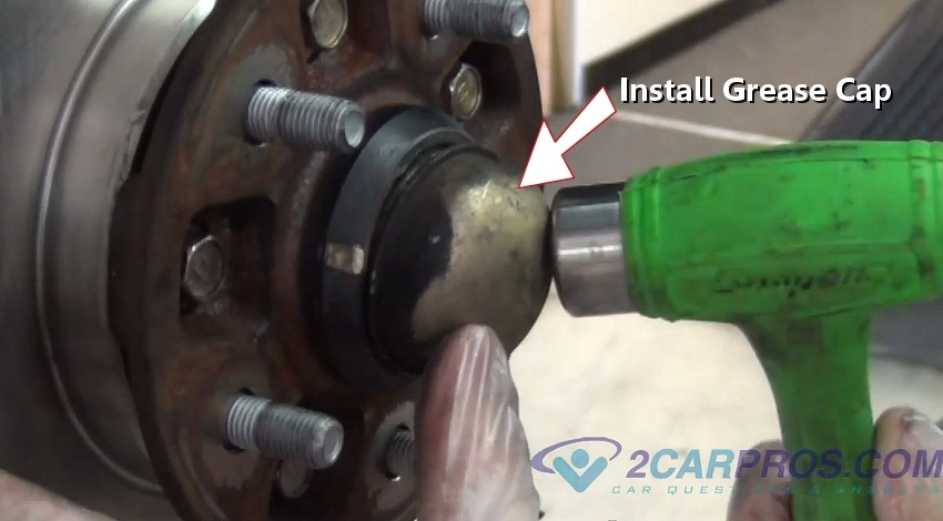

After the cotter pin has been installed, set the grease cap with a gap at the top.
grease cap
Using a hammer, install the grease cap evenly onto the bearing hub, wipe when finished with a shop towel.
install grease cap

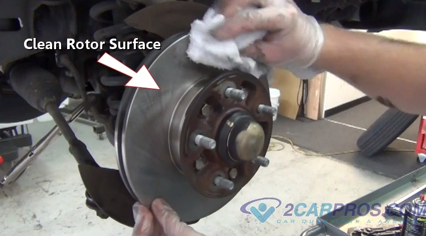

After the cap is installed, use a towel and clean the rotor pad surface and reinstall the caliper, then finish the brake job.
clean rotor surface
