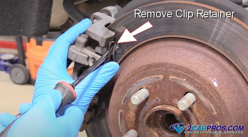

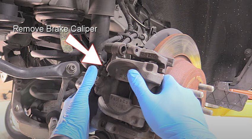

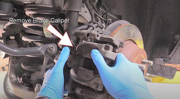

1. To begin, remove the brake caliper by undoing the brake caliper mounting clips and bolts, then rock the caliper back and forth to loosen it from the brake rotor.
remove brake caliper retainer clip

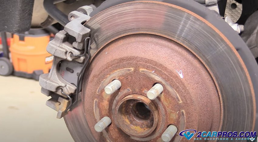

2. Grasp the brake caliper and lift it from the caliper mount and set it off to the side, do not allow the brake caliper to hang from the brake hose, most mechanics will use zip ties to secure the caliper.
lift brake caliper from brake rotor

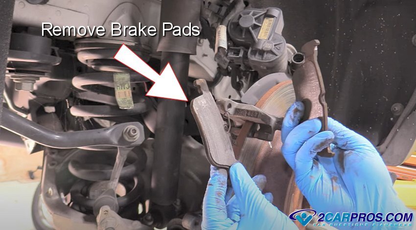

3. Remove the brake pads from the caliper mounting bracket and discard. At this point you are going to want to use new brake pads to compliment the new brake rotor. It is recommended you do not reinstall used brake pads.

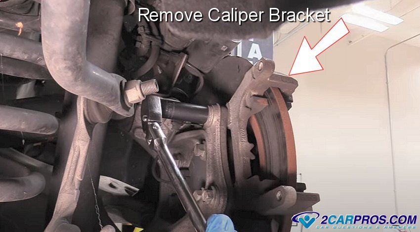

4. On some cars the brake rotor will be able to be removed at the this point, but most will require you to remove the caliper mounting bracket which will be held on by two bolts from behind.

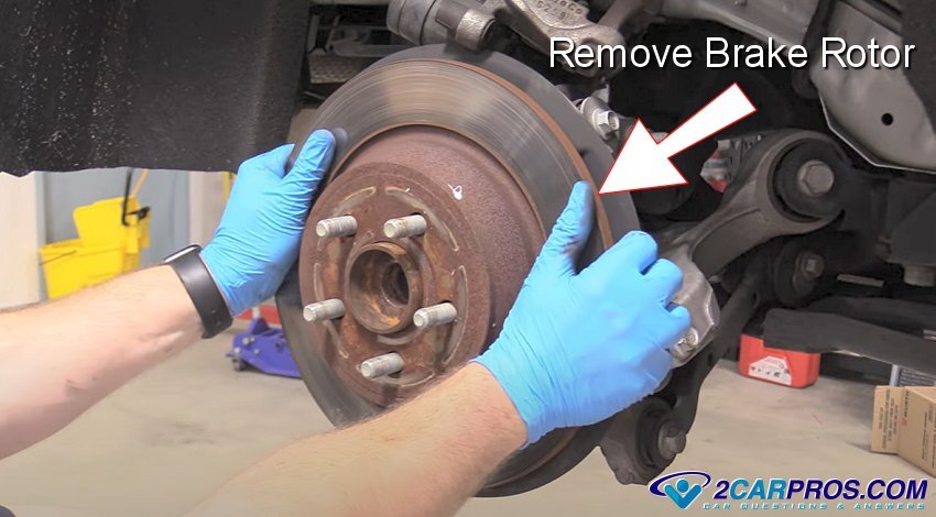

5. Now the brake rotor is ready to be removed, grasp the rotor on either side to pull toward you, be sure not to drop the rotor. In some cases the brake rotor will be stuck on the axle flange or bearing hub, please follow this guide to help fix this issue: Brake Rotor Stuck

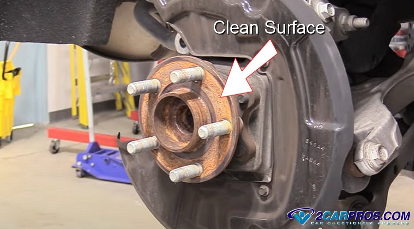

6. This will expose the brake rotor machined mounting surface which must be cleaned thoroughly by using a wire brush and brake cleaner. This will allow the new brake rotor to be "square" on the axle flange or bearing hub.

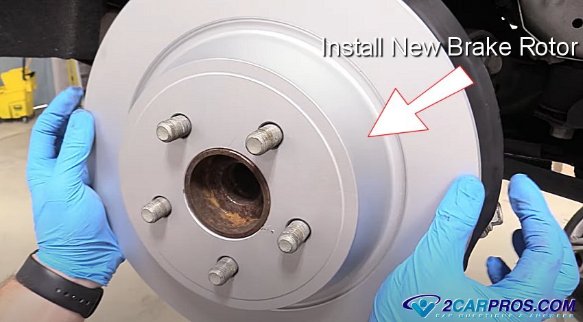

7. Match the old brake rotor to the new replacement brake rotor by checking the diameter and thickness, they should match identically. Carefully slide the new brake rotor over the wheel studs and onto the flange surface and reassembly in the reverse order. Be sure to pump the brake pedal slowly until normal brake pressure has returned and you are all set.
install new brake system brake rotor
