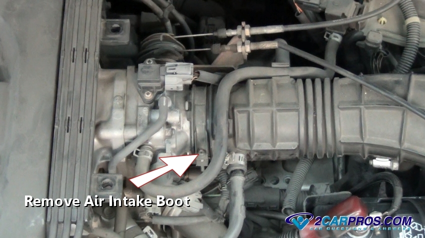

Step 1 - Locate and remove the air intake bore which is attached to the throttle bore and is usually done be loosening the mounting clamp. (Note: some idle air control motors can be replaced without removing the throttle bore.)
remove air intake boot

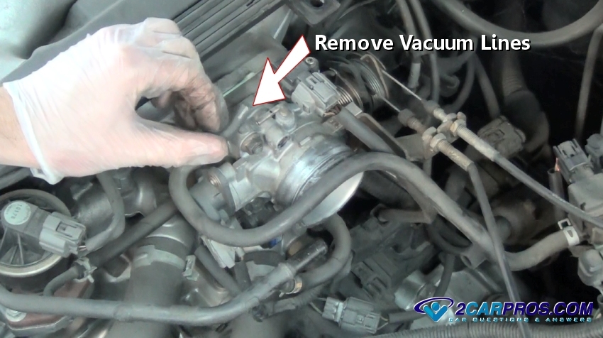

Step 2 - Once the air intake has been removed proceed in removing all vacuum lines from the throttle bore. TIP: Snap a quick pic from your phone to avoid confusion in reassembly.
remove vacuum line

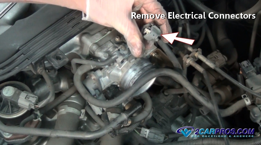

Step 3 - After vacuum lines have been removed, locate and disconnect the sensor and idle air control electrical connectors. Be gentle with these connectors because they can be brittle due to under hood conditions.
remove electrical connectors

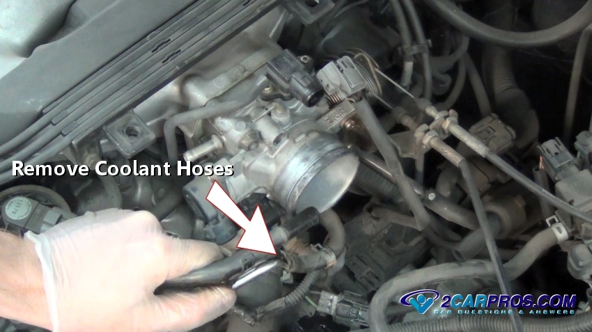

Step 4 - Next, slowly remove the radiator cap to relieve system pressure, then locate and remove all coolant hoses connected to the throttle body.
remove coolant hoses

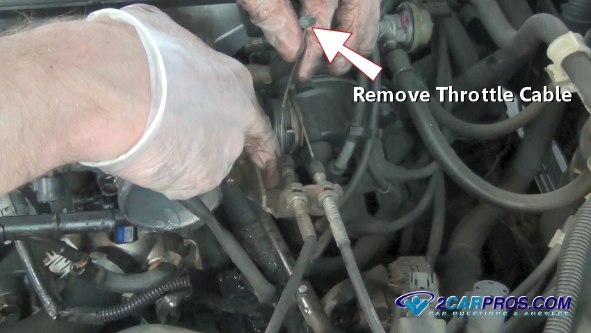

Step 5 - Then, remove both the throttle and cruise control cables from the throttle body.
remove throttle cable

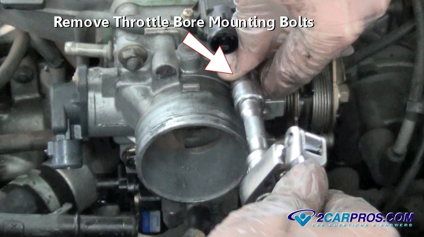

Step 6 - Once all coolant, vacuum hose and electrical connectors have been removed, remove the throttle bore mounting bolts.
removing throttle bore mounting bolts

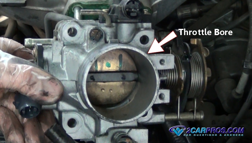

Step 7 - After removing all throttle bore bolts, gently pry the bore loose from the intake manifold. The idle air control valve is attached (bolted) at the bottom of the bore.
throttle bore

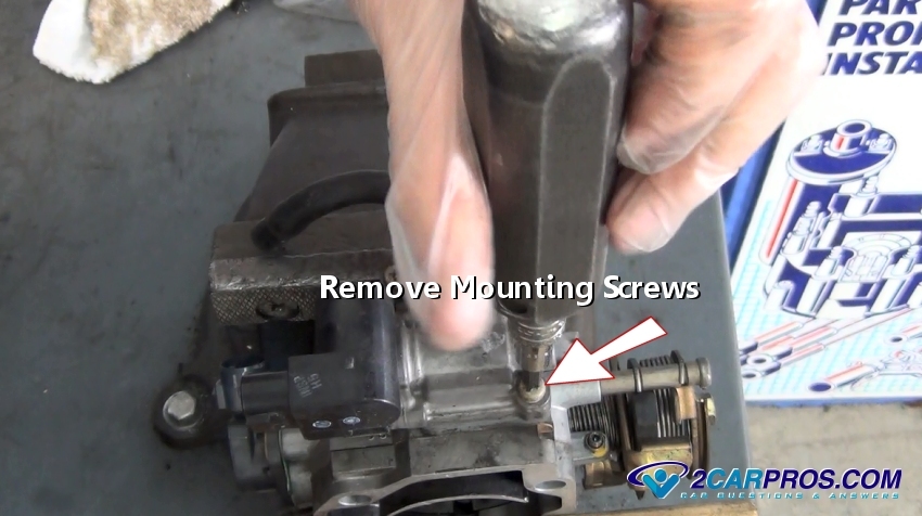

Step 9 - Using an impact screw driver to remove the idle air control valve mounting screws.
removing idle control valve mounting screws

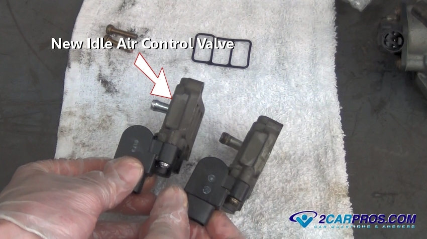

Step 10 - After the screws have been removed, gently pry the idle air control valve off of the throttle bore, be sure to remove the gasket as well, match up the old valve to the new unit.
new idle air control valve

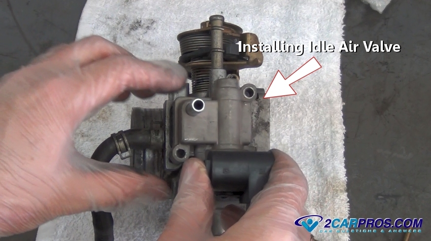

Step 11 - Using a shop towel and carburetor cleaner wipe all gasket surfaces clean to ensure a proper seal. Then, install the new idle air valve to the throttle bore, reinstall and tighten the mounting screws.
installing new idle control valve

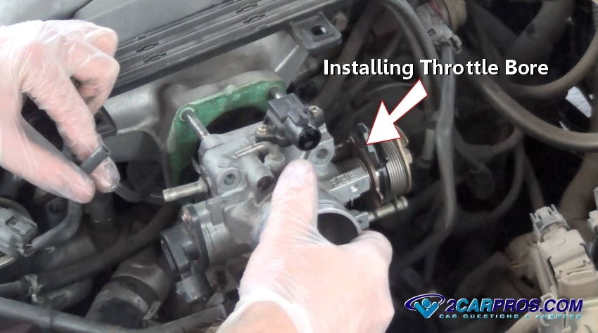

Step 12 - Next, gently reinstall the throttle bore making sure the gasket surface is clean, keep hoses and wiring clear from the mounting surface.
installing throttle bore

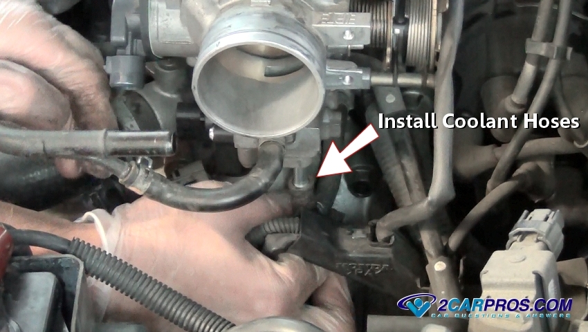

Step 13 - After reinstalling the throttle bore and tightening the mounting bolts evenly, reattach the coolant hoses with clamps.
reinstall coolant hoses

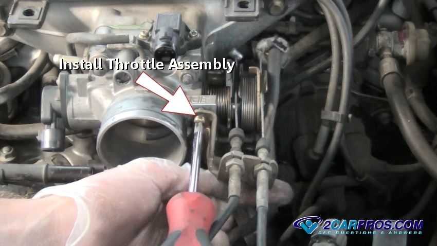

Step 14 - Once coolant line are connected, reattach the throttle cable assembly by installing and tightening the mounting screws.
install throttle cable

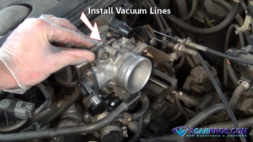

Step 15 - Next, Reattach all vacuum lines to the throttle bore.
install vacuum lines

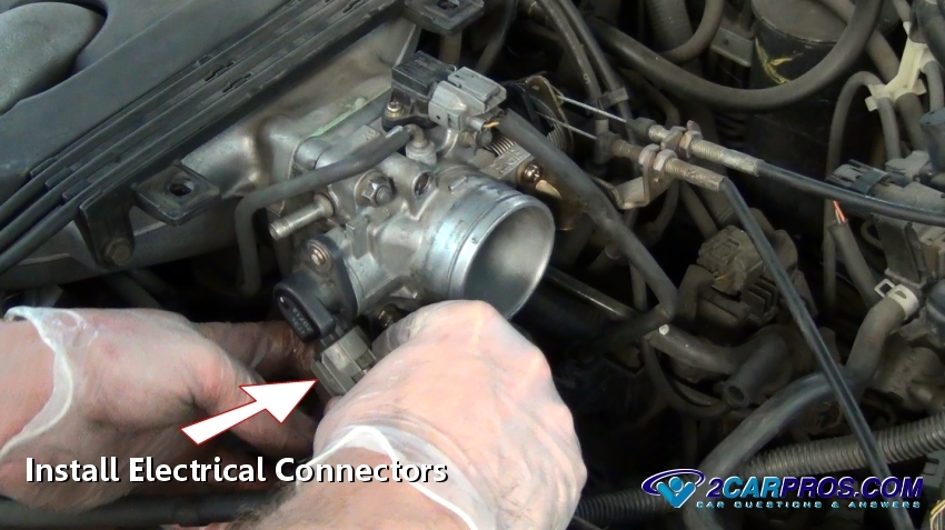

Step 16 - Then, reinstall all electrical connectors to the throttle bore and idle air control motor.
reinstall electrical connectors

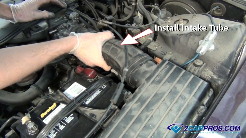

Step 17 - After installing all vacuum, coolant and electrical components position the air intake tube for reinstallation.
install intake tube

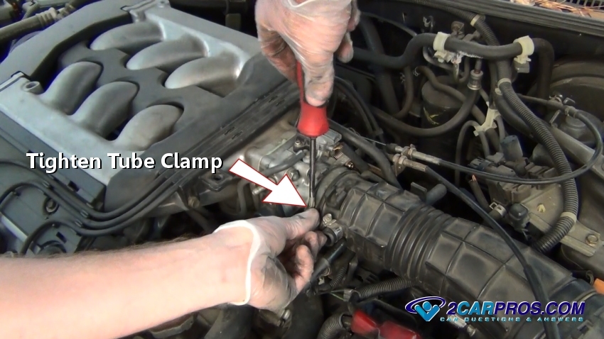

Step 18 - Reinstall vacuum and transfer hoses to the intake tube, then tighten the mounting clamp.
tighten air intake tube

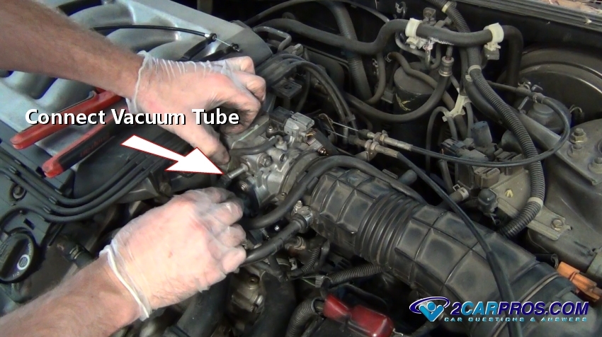

Step 19 - Once the air intake tube has been reinstalled, continue to install the remaining vacuum lines.
connect vacuum line
