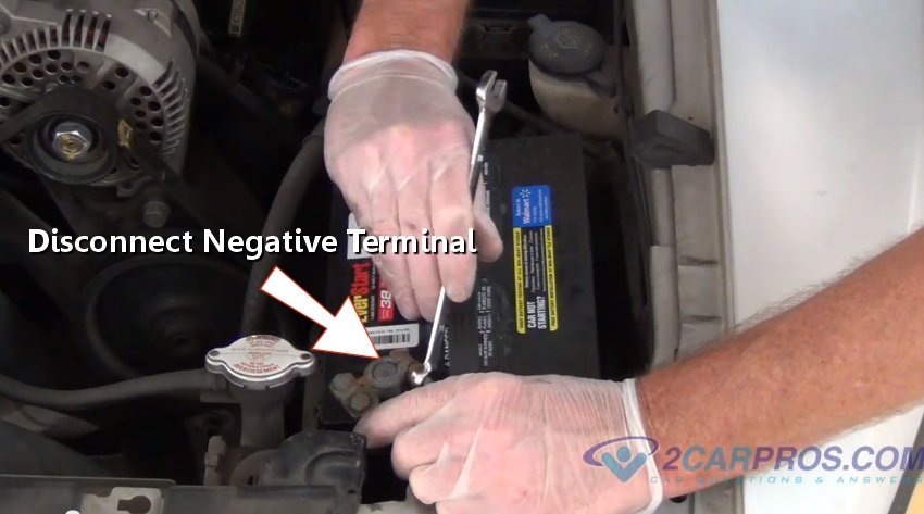

Since you will be working with fuel usual fire precautions are necessary. It's also a good idea to wear protective gloves and eyewear. Begin with the vehicle safety raised in the air enough to access the fuel tank if no service port is available, use jack stands for additional safety. Disconnect the battery.

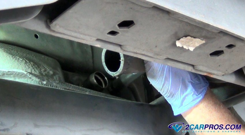

Remove the gas cap and insert a hard plastic line into the filler neck or remove the filler neck from the fuel tank to draw the fuel out. Once the gas starts flowing keep the fuel container below the level of the tank and have additional containers ready. The video below shows a good method for removing fuel from the tank. Do not remove the tank unless empty or close to empty. A full gas tank is heavy and can cause injury.
Locate and remove gas tank filler neck mounting bolts or remove the filler tube from the tank. This will aid the fuel removal especially if you had problems accessing through the filler neck.

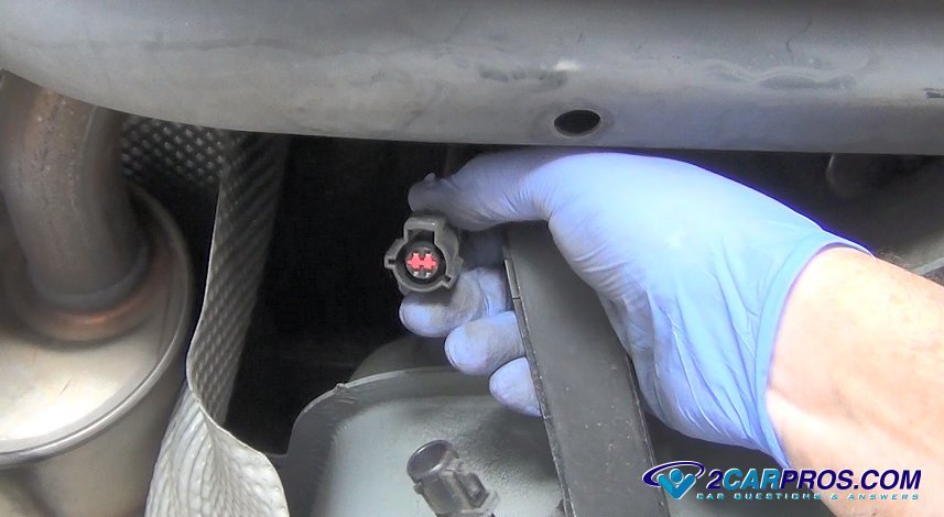

Located the electrical connector for the fuel pump and fuel level sender which will be in the same wiring harness. If access if difficult or you can't see them wait until the tank is lowered slightly to undo the connector. Inspect electrical connector for burns or heated spots and replace if damaged. A burned connector can cause a pump to fail intermittently.

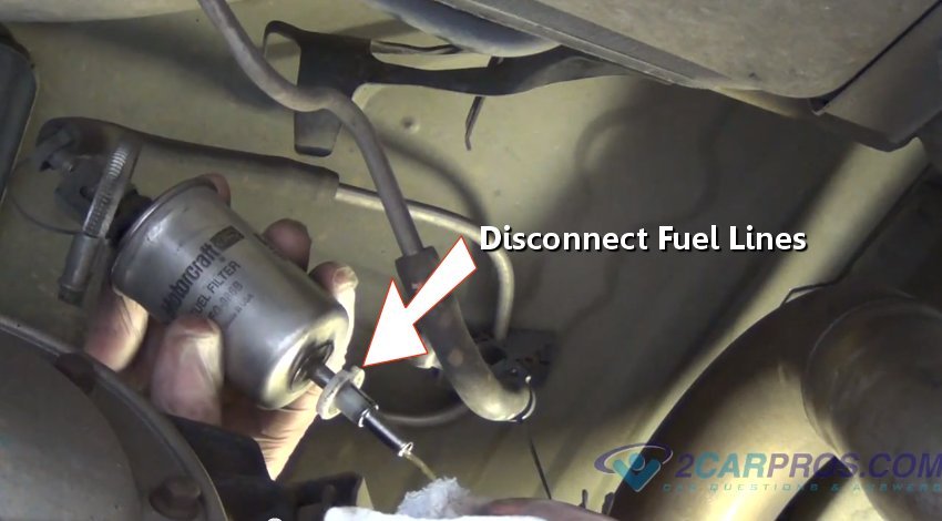

Disconnect fuel line using a fuel line removal tool. Fuel will leak at this point so be ready with a fluid catch basin.

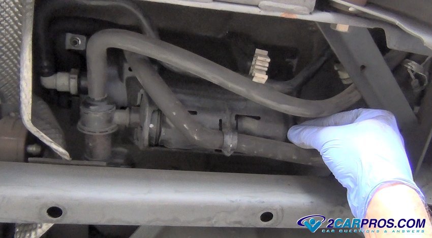

There will be fuel vapor lines as part of the EVAP system these will need to be removed or disconnected.
vapor hose

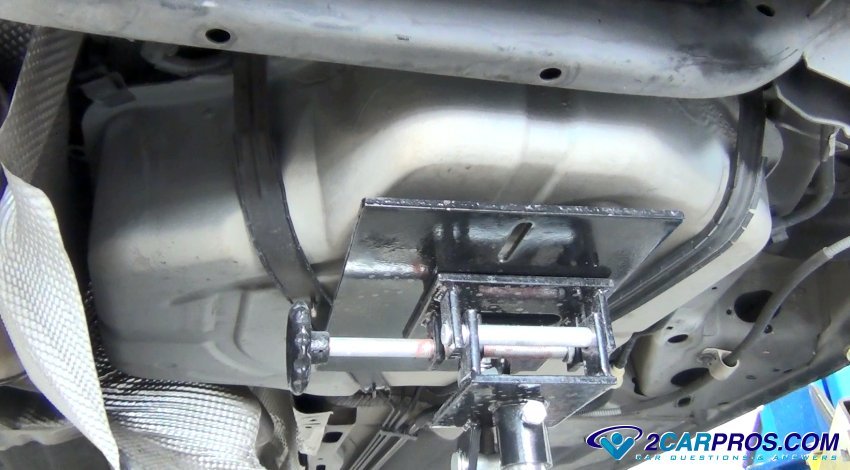

Double check to make sure all visible hoses and electrical connectors are disconnected. Now the tank will need to be supported by a jack or blocks of wood. A fuel tank empty weighs between 20 to 30 pounds.
fuel tank support

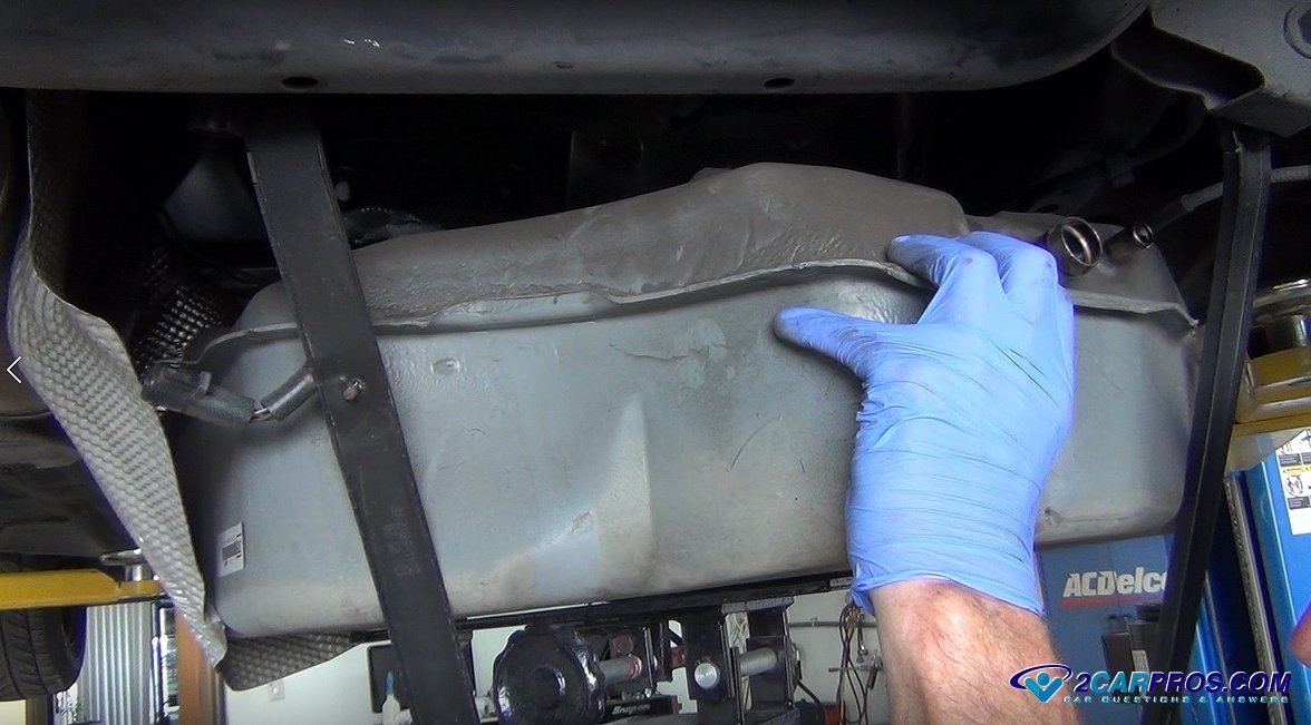

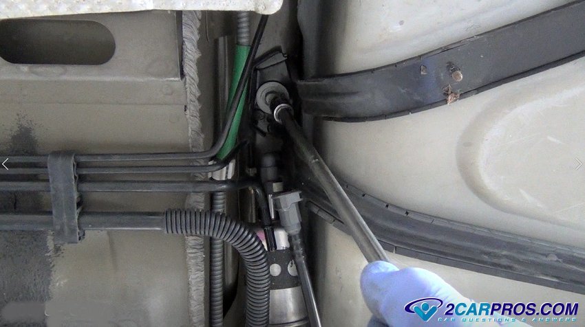

Locate and release tank holder supports, there are two in most cases. Remove the mounting bolts at this point the tank will become loose but may not come out.
fuel tank strap removal
Lower the tank and release top mounted fuel lines or electrical connectors if any. Continue to remove the tank.
lower fuel tank

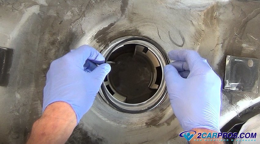

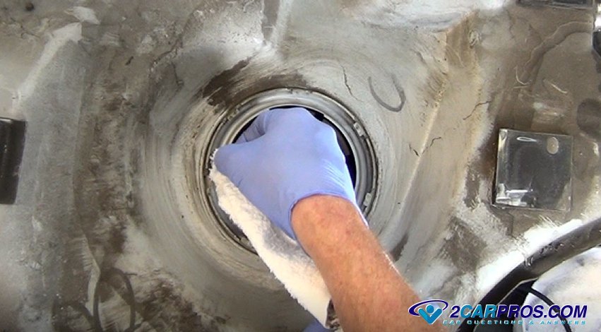

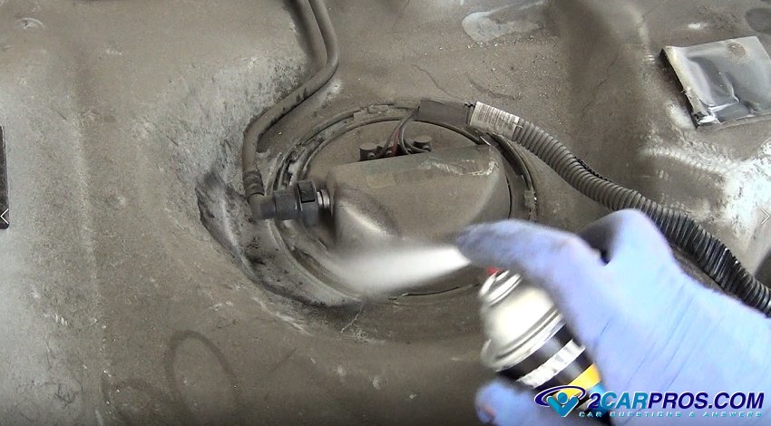

Remove the tank, this will expose the fuel pump retainer ring. Use an aerosol cleaner to remove dirt and debris from the area. This will keep the inside of the fuel tank clean when performing the repair.
clean retainer ring

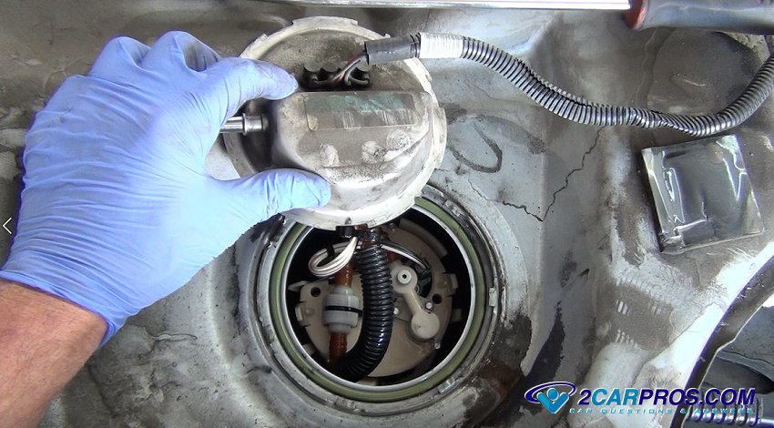

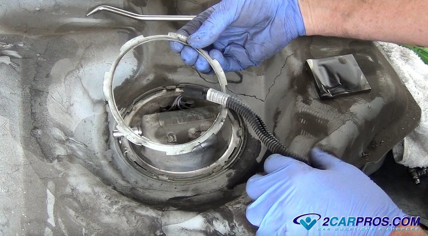

Remove fuel pump mounting bolts or retainer ring to access the fuel pump module and remove the unit. Use a hammer and punch to remove the ring counterclockwise.

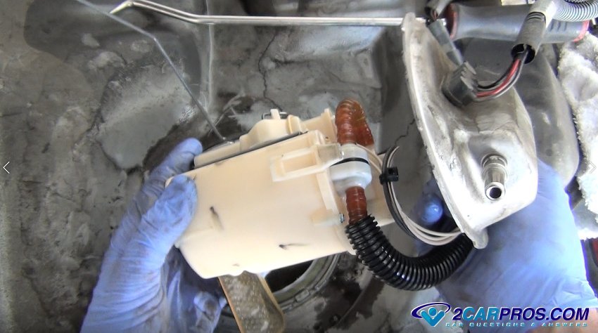

Remove the fuel pump which will be attached to the mounting plate or positioned down inside the tank held by plastic retainer clips.
remove fuel pump

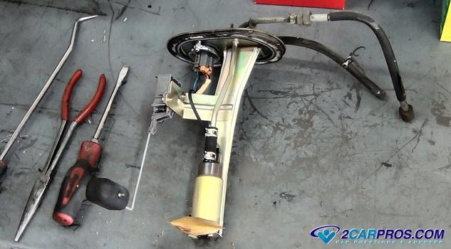

Here is a typical fuel pump removed from the fuel tank.
old fuel pump

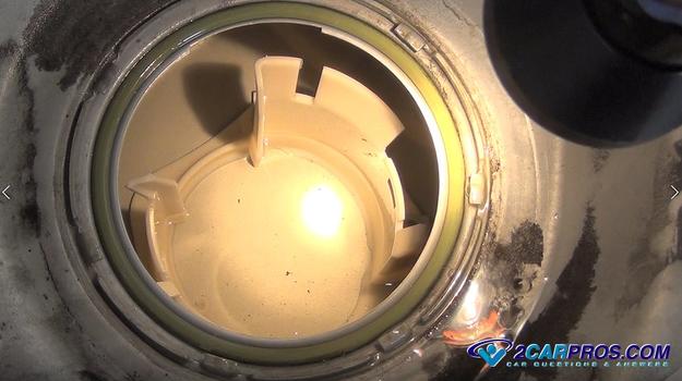

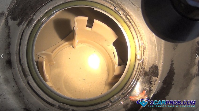

Before installing the new fuel pump use a flashlight to inspect the fuel inside the tank and for excessive contaminates. It's normal to have some dirt and foreign objects but excess partials or bad/rotten fuel will cause the new pump to go out.
gas tank inside

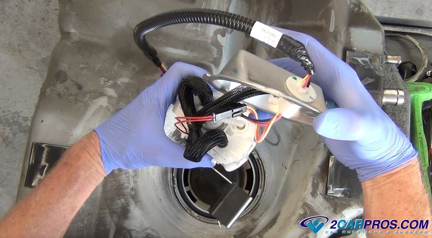

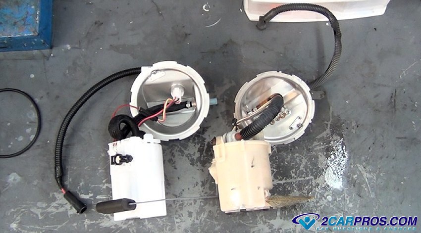

Match the old pump to the new unit, sometimes they can look a little different as updates are rolled. Install the gas level float arm and a new primary fuel filter (strainer on pump).
new fuel pump
Clean mounting and seal surfaces using a shop towel and carburetor cleaner, this will ensure a proper seal.
clean seal
