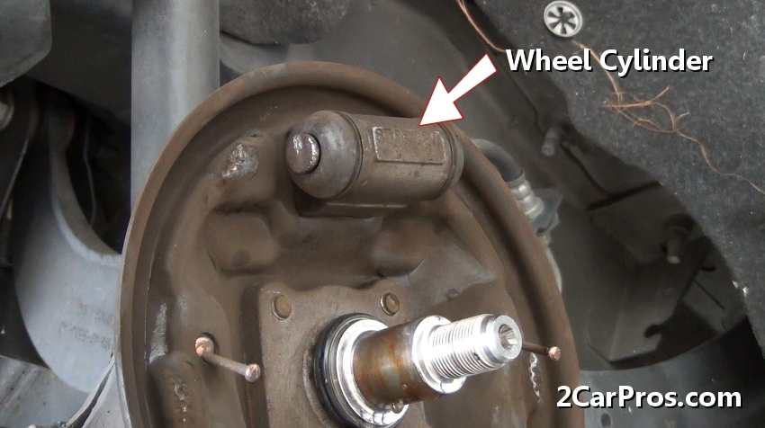

When a wheel cylinder is being replaced it is normal for the rear brake shoes to be replaced as well. Brake shoes contain asbestos so avoid using compressed air to clean, we use water from a hose which helps contain dust partials while washing brake dust away, spray the drum and components, allow it to dry before beginning. Wear a dust mask and gloves to help eliminate harmful contaminants. In the example below the brake shoes have already been removed. This is what the wheel cylinder looks like when it is ready to be replaced.
wheel cylinder

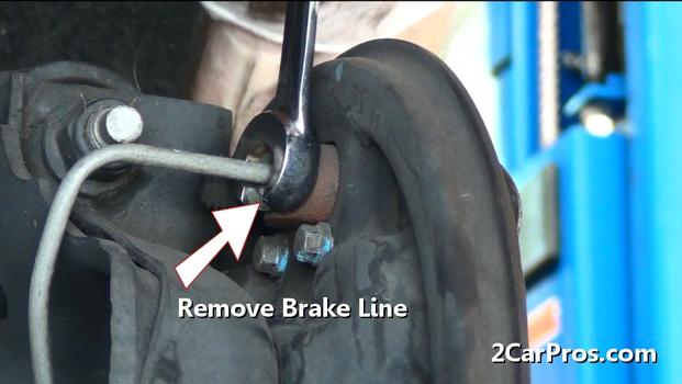

The first step is to loosen the brake line from the wheel cylinder, using a line wrench will help you avoid rounding the brake line fitting, center the wrench on the fitting completely before applying pressure. Once loosened, brake fluid will start to drip out so have a shop towel ready.
remove brake line

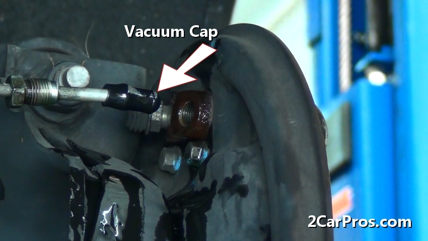

Quickly use a vacuum cap to stop the brake fluid from flowing once the line is completely removed. This is necessary to stop the brake fluid from leaking so as to not empty the brake master cylinder, if this does occur the brake master will need to be bled.
vacuum cap

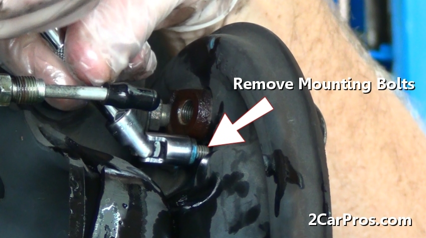

Use a wrench or socket to remove the wheel cylinder mounting bolts (2), in this case the bolt size is 8mm, rarely wheel cylinders are held in place by a snap ring.
remove wheel cylinder mounting bolts

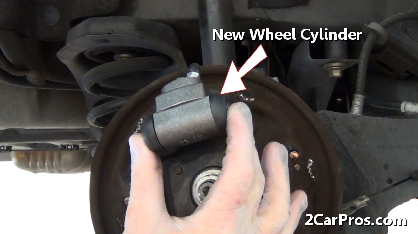

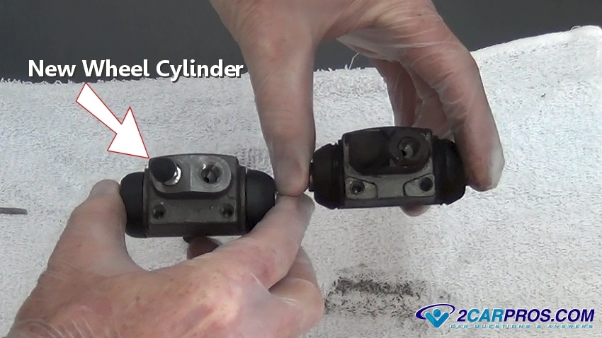

Remove the new wheel cylinder from its box to match up to the old wheel cylinder to the new unit, they should match identically.
new wheel cylinder

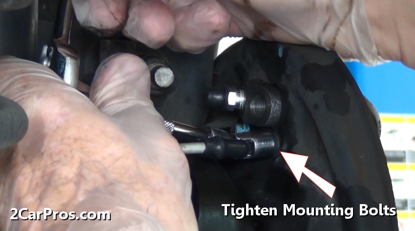

Use a wrench or ratchet to tighten the wheel cylinder mounting bolts. The torque setting for these particular bolts is 9 foot pounds.
tighten wheel cylinder mounting bolts

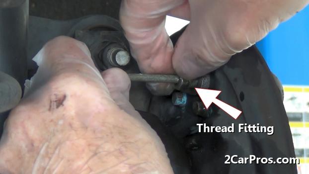

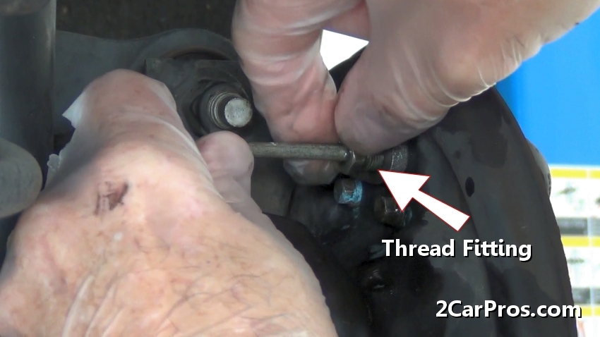

Remove the dust cap which was installed by the manufacturer to protect the fitting threads, the brake line must be straight into the wheel cylinder before the fitting will thread in. Hand thread the brake line fitting into the cylinder to prevent cross threading.
thread wheel cylinder fitting

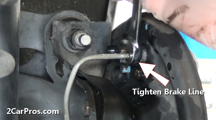

Use a line wrench to tighten the brake line. There is no torque tightening setting for this, so a medium snug will work, do not over tighten.
tighten brake line

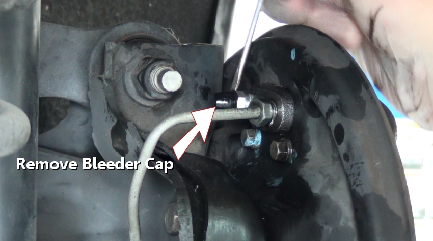

After the brake shoes and drum have been reinstalled use a small screwdriver to remove the bleeder cap. This job is typically performed during a rear brake job, we have broken out the wheel cylinder replacement to help simplify the repair. Before the wheel cylinder can operate correctly the brake system will need to be bled. After the job is complete, recheck the wheel cylinder for leaks.
remove bleeder cap
