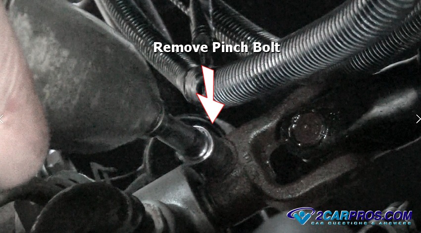

To begin, wear safety eyewear and gloves, remove the negative side of the battery to cut power to the vehicle, then raise the vehicle using a jack and stands, also remove the front wheels to help gain access which will make the job easier. Remove the pinch bolt to the input shaft of the steering box, the input shaft is connected to the steering column and steering wheel.
remove pinch bolt

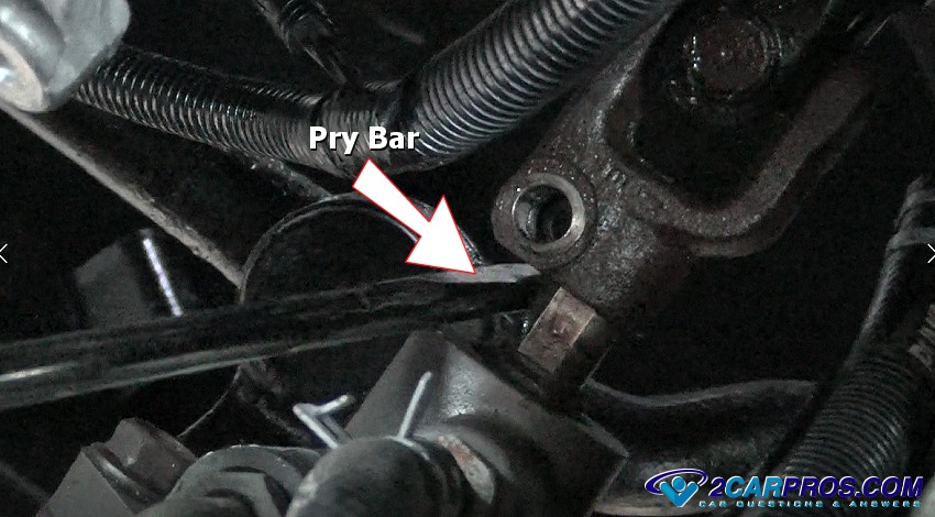

Use a pry bar to work the input coupler off of the steering box. Once the coupler is free from the box, do not turn the input shaft from the steering column because it can damage the spiral or clock spring which is located inside the column near the steering wheel. The input shaft can only go one way so there is no need to mark the orientation of the shaft.
pry bar removal

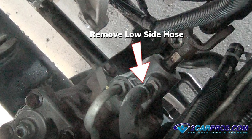

Remove the low side fluid hose using a clamp tool or pliers.
remove low side hose

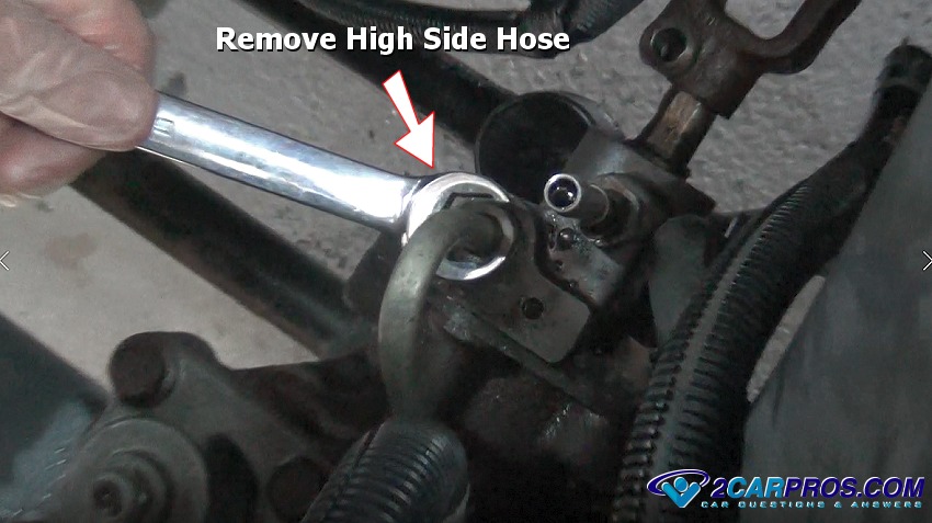

Using a line wrench remove the high side pressure hose from the steering box.
remove high side hose

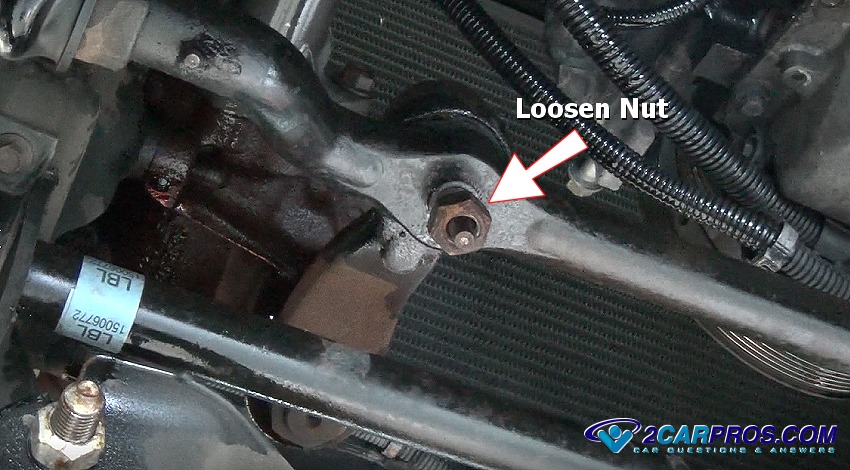

There are two ways to go when removing the pitman arm from the steering box, you can remove the center link bolt and undo the taper fit, or remove the arm from the box directly which we will show in the proceeding steps.
loosen cetner link nut

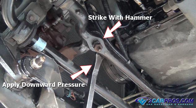

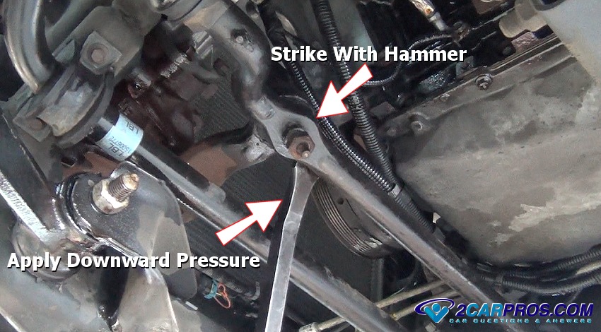

Use a pry bar to apply downward pressure to the center link while shocking the taper fit loose by striking the center link bulkhead with a hammer.
release cetner link taper

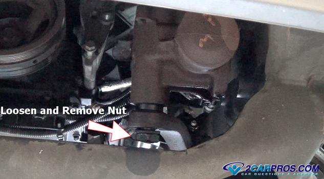

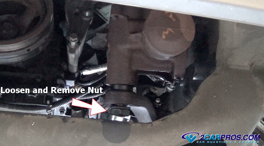

Loosen and remove the steering box main shaft nut which holds on the pitman arm. This nut is tight so a large breaker bar or impact gun will be needed.
remove pitman arm nut

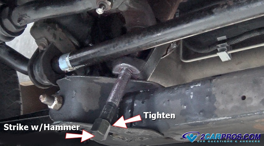

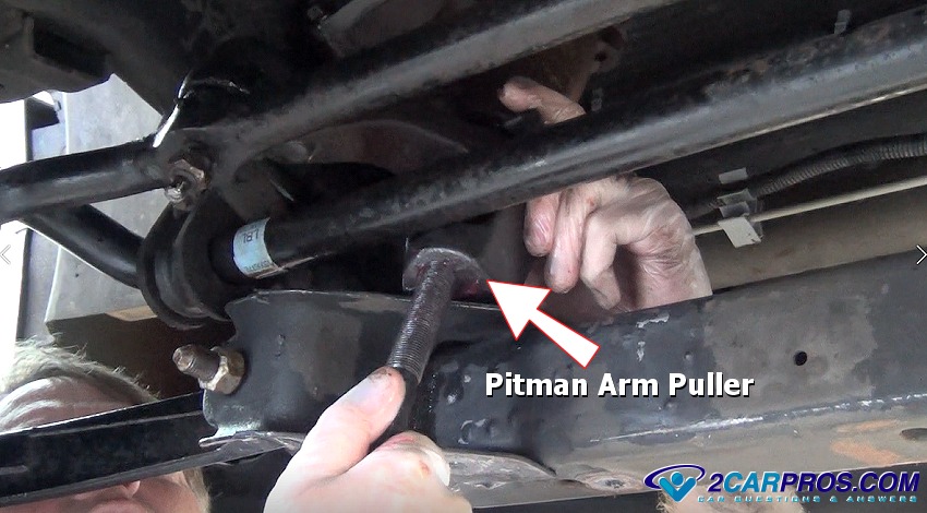

Here we have fitted the pitman arm puller onto the steering box, you may need to loosen the steering box mounting bolts to allow clearance for the puller.
pitman arm puller

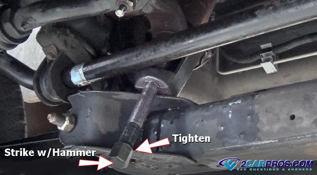

Tighten the pulley into place, strike the end of the puller screw to help shock the taper spline loose, make sure the screw of the puller is well greased.
strike puller hammer

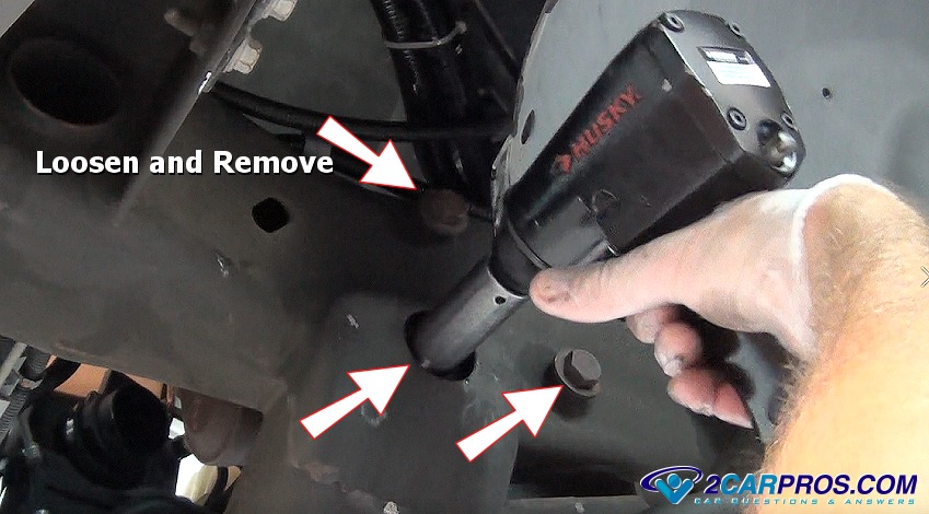

Remove the steering box mounting bolts while hanging onto the box to keep it steady and not allowing it to fall.
remove steering box mounting bolts

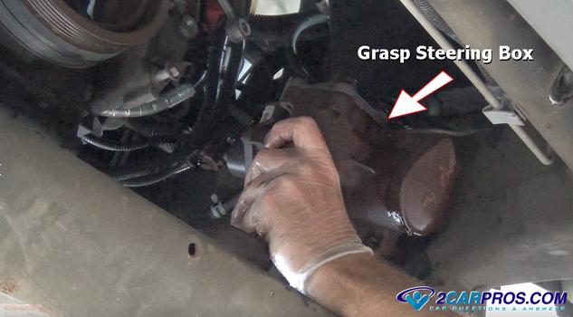

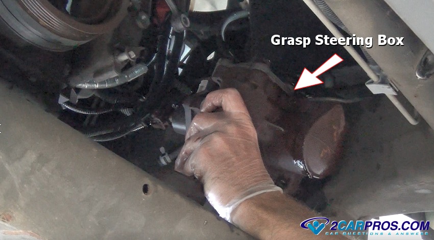

While firmly grasping the steering box carefully lower the steering box from the vehicle, it is heavy.
grasp steering box

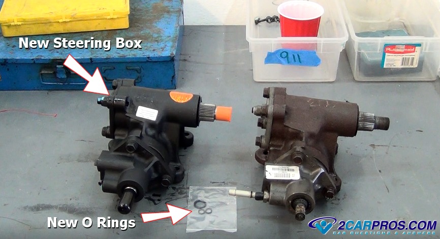

Match the old steering box to the new unit to ensure a proper installation, also use new O ring seals to prevent leakage. Reassemble by reversing these steps while tightening the mounting bolts and pitman arm nut to spec and refill with fluid. If you need the correct torque specs please ask one of our experts (free). When you first start the engine the power steering fluid level will drop, stop the engine and refill. Restart the engine and gently move the steering wheel back and forth to further alleviate air from the system, recheck the fluid level in a few days.
new steering box
