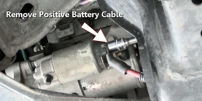

You must disconnect the negative side of the battery while making sure the cable end is clear of the battery terminal to avoid an accidental connection, also raise the car on jack stands to gain access to the starter motor. If you are having troubles locating the starter, or need specific instructions for your car please ask one of your experts, it is free. The image below shows the starter motor and the removal of the positive battery cable as well using a 13mm socket.
remove positive battery cable from starter

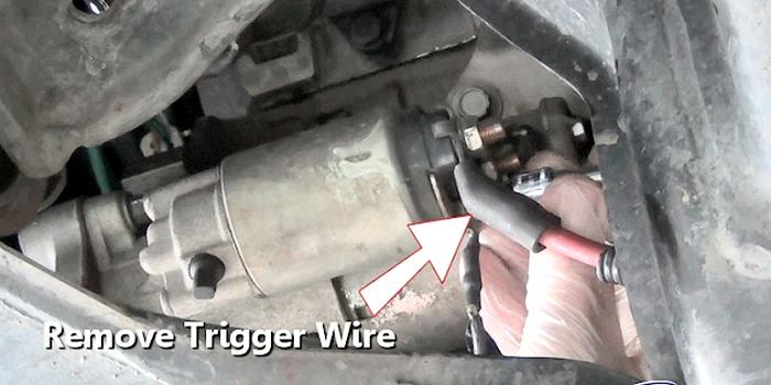

It's a little difficult to see but here we are using a 8mm socket to remove the starter trigger wire from the rear of the starter solenoid, note the position of the wires on the solenoid or take a picture with your phone to avoid confusion of its location.
remove trigger wire from starter

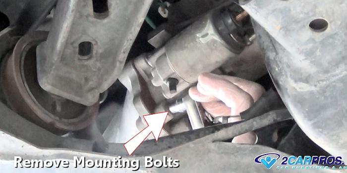

Using a flashlight, locate the starter mounting bolts, the upper bolt may be slightly hidden, also there may be two or three bolts. Use a 13mm wrench or socket to remove them, (sizes may vary).
remove starter mounting bolts

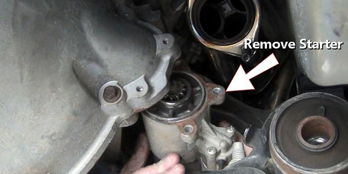

Now, the starter will become free from the bell housing or block, it weighs a few pounds so grasp the starter firmly and remove it from the engine bay area, again use a flashlight to inspect the flywheel or flex plate gear teeth condition. If wear is excessive the flywheel/flex plate will need to be replaced.

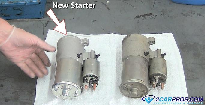

Match the old starter to the new unit to ensure a proper installation, count the teeth on the pinion gear and note the location of the mount bolts, they should be the same on both.

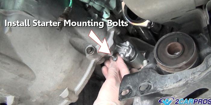

Gently install the new starter motor and insert one of the mounting bolts by hand to hold the starter motor in-place while you reinstall the remainder of the mounting bolts.

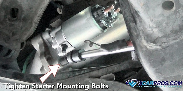

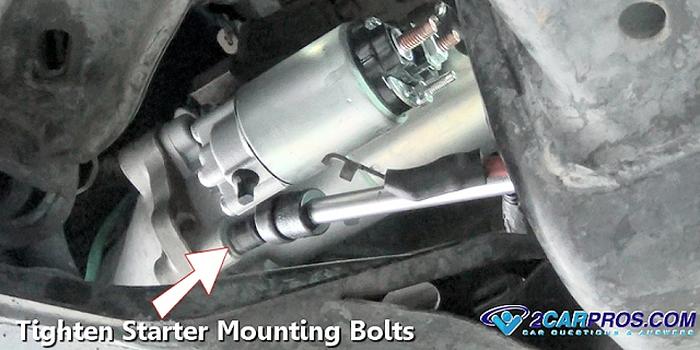

Use a socket and extension to tighten the bolts to the correct specification, which in this case is 28 foot pounds of torque, tighten evenly.

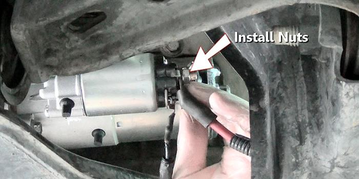

Reconnect the positive battery cable and starter trigger wire onto the solenoid and tighten the mounting nuts. Be careful when tightening these nuts because the solenoid is made of composite plastic and it can break if over-tightened. Before lowering the car, double check all wiring connections to ensure there is no contact to ground (engine block, frame, etc.). When reconnecting the negative battery cable, quickly (lightly) touch and release the cable to the battery terminal, this quick test checks for a short circuit, a light (little) spark is normal, a large zap means there is a problem with the starter wiring installation.
