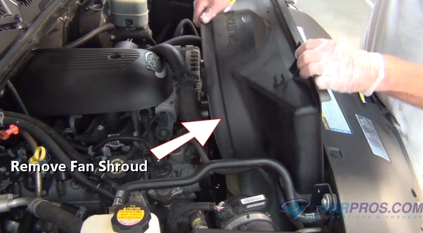

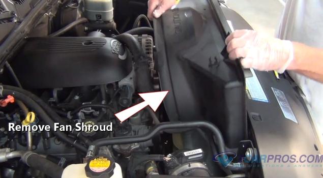

Start with protective eyewear and gloves, raise the car and support it on jack stands if needed. Also, disconnect the negative side of the battery to avoid electrical issues when doing the job. Remove any accessories to gain access like: air intake tube, fan shroud, alternator etc.
remove fan shroud

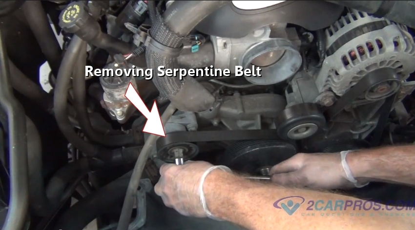

Remove the serpentine belt from the engine to allow the pump to turn freely so you can access the pump mounting bolts to remove the pump, check the belt for cracks and replace if necessary.

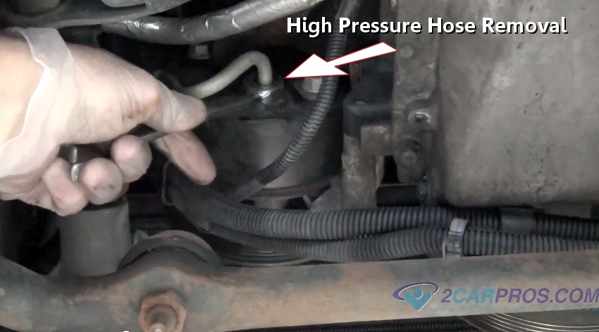

Use a line wrench to loosen and remove the high pressure line, once loose fluid will start to drip out so have a fluid catch basin ready.
high pressure hose removal

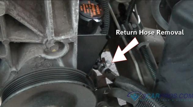

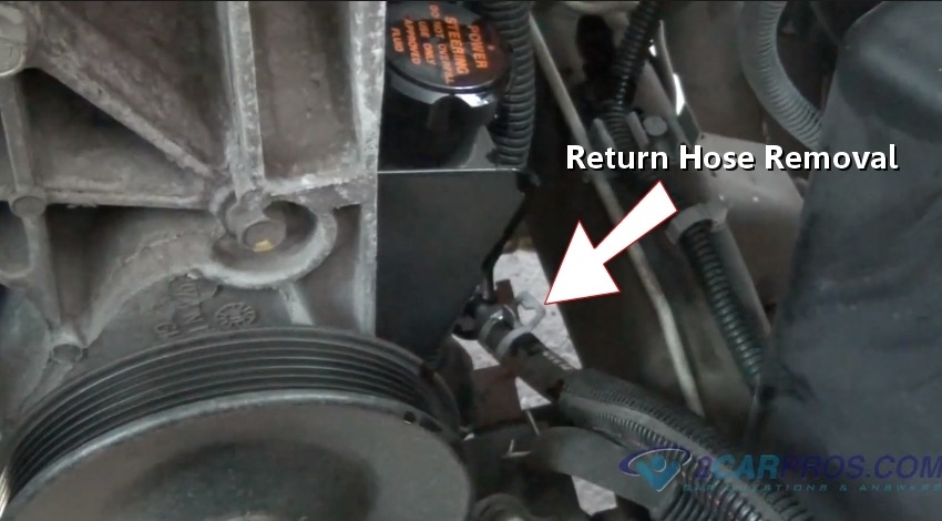

Use a pair of pliers or channel locks to remove the clamp from the low pressure hose. Then twist the hose to break it loose and remove the hose from the pump.
return hose removal

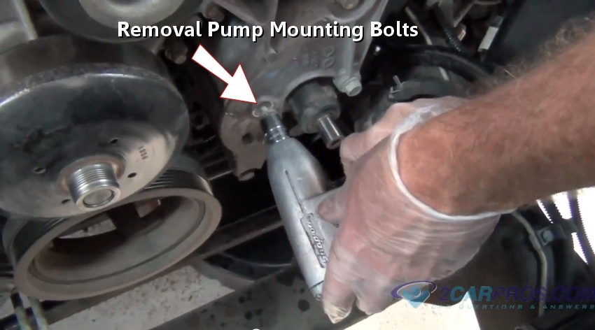

Loosen and remove all pump housing mounting bolts including rear mounted bolts. At this point, the pump can be removed.

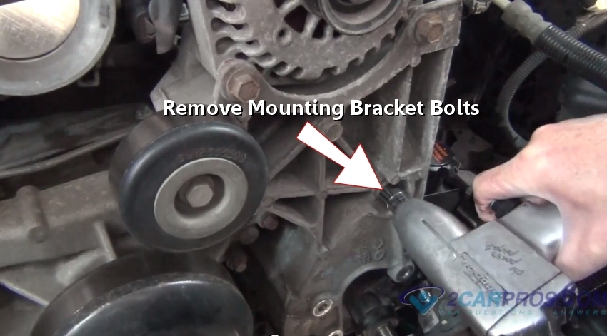

On some models, the main mounting bracket will need to be loosened to finish removing the pump assembly from the engine bay.
remove mounting bracket bolts

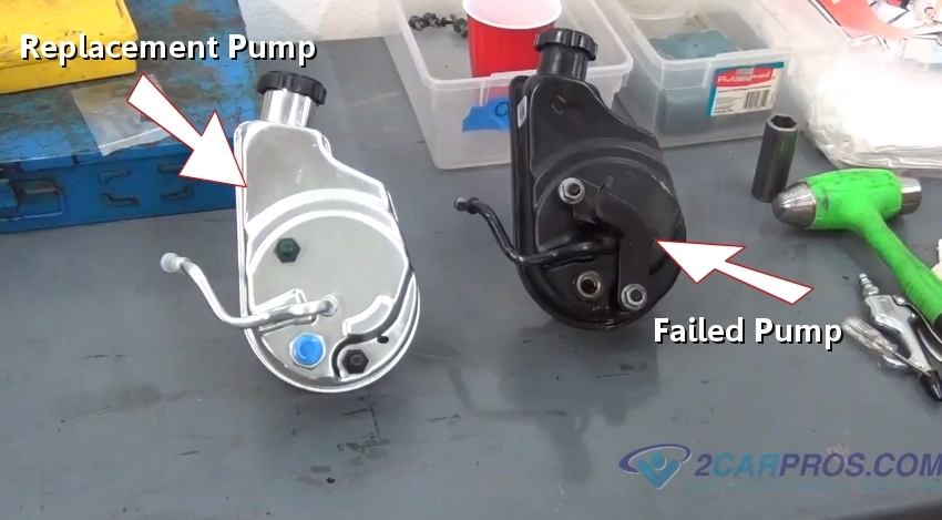

Here are the new and old steering pumps, match the failed pump against the replacement pump and transfer any mounting brackets.
replacement pump

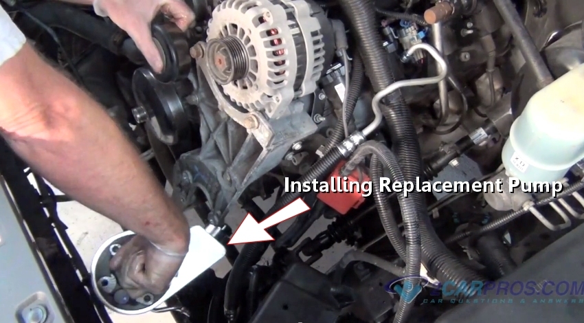

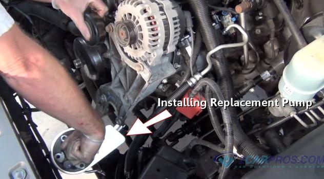

Position the new steering pump for installation.
installing replacement pump

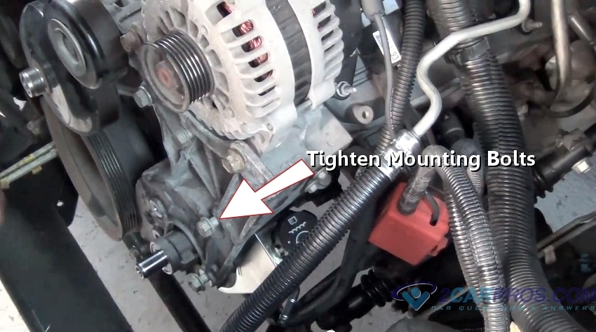

Install and tighten the steering pump and mounting bolts and bracket bolts, including any rear facing bolts.
tighten power steering pump bolts

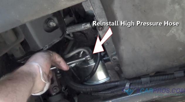

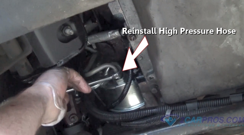

Inspect the sealing O ring on the high pressure hose and replace it if damaged, then install and tighten the high pressure side hose into the pump, also attach the low side hose.
reinstalling high pressure hose

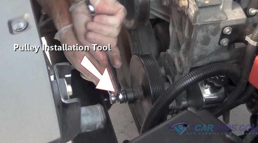

When reinstalling the pulley onto the pump shaft, it helps to warm the pulley either in the sun or in an oven to expand the metal. Use the pulley installing tool to push the pulley back onto the pump main shaft. Do not add grease to the shaft, this can allow the pulley to slip and come off. Never use a hammer to install or remove pulley or you will damage the pump or pulley.
using pulley installation tool

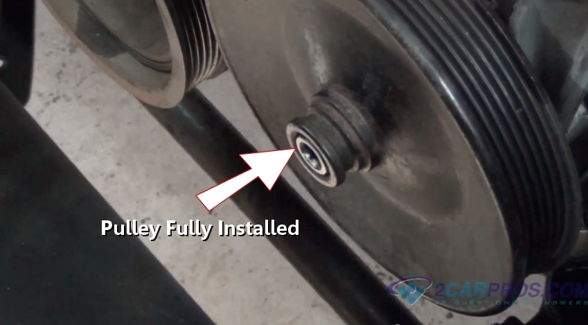

Continue to install the power steering pulley until the pulley is flush with the end of the output shaft and reinstall the serpentine belt and all accessories needed to gain access to the pump.

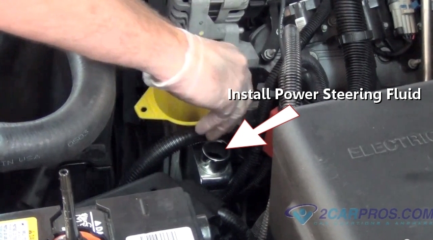

Double check all previous steps to ensure a proper installation, then remove the pump reservoir cap and refill with power steering fluid.
refilling power steering fluid
Add fluid to the full line level on the indicator, re-install the cap. Next, start the engine and turn the steering wheel about a quarter turn in either direction to help purge the air from the system, the pump may sound a little noisy at first which is normal. Shut the engine off and recheck the fluid level, recheck the level again in a few days and you are all set.
