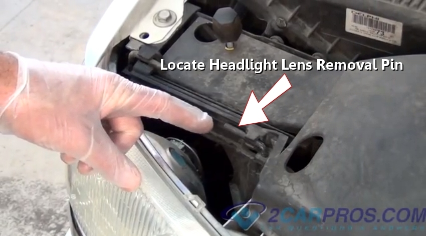

Locate the release pin or screws which mounts the headlight lens. Pull forward and upward on the pin to release, or remove mounting screws or clips.

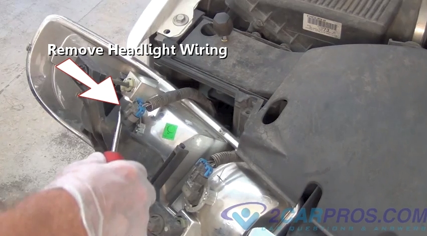

Grasp the lens firmly to avoid dropping the unit. Use a standard screwdriver to release the wiring connector. Check the connector for melted plastic which is a sign the connection has overheated in which case the connector will need to be replaced. Also if corrosion is present it will hinder the voltage/amperage supply to the new headlight bulb producing a dim or light operation failure.

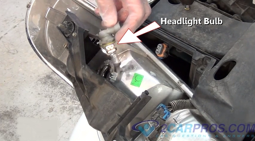

Grasp the headlight bulb and turn counterclockwise, or undo mounting clip or screws to remove the bulb from the housing. Some bulbs can be removed with the wiring harness attached.
old headlight bulb
Match the old bulb to the new unit confirming the electrical connector configuration along with the mounting plate of the bulb. Clean the headlight lens free from debris to help maintain the seal of the bulb to the lens, this will help keep moisture out. There is an alignment notch or tab that must be recognized when reinstalling the new bulb. If the bulb is installed incorrectly the light beam will be off (high, low, left or right). Reconnect the electrical connector ensuing an audible click which confirms the connection of the connector while sealing the bulb from moisture. Reassemble the lens or any other obstructions to complete the job. Turn the headlight on to check your work, observe the newly replaced headlight bulb to ensure proper operation.
