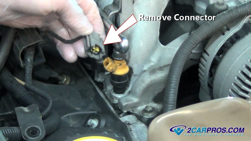

Begin by removing the electrical connector from the fuel injector, some connectors have a safety clip that needs to be released as well.
remove electricall connector

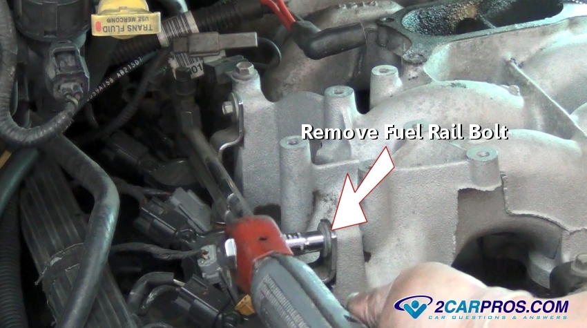

Remove the mounting bolts located on each corner of the fuel rail, these locations can vary. This will enable the fuel rail to be loosened and allow the fuel injector to be removed.
remove fuel rail bolts

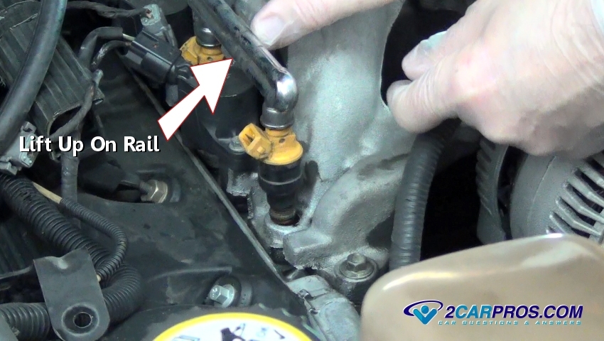

Proceed in gently lifting the fuel rail from the intake manifold, this will pop the rail loose. (Note: Sometimes it will be necessary to remove the fuel supply and return lines from the rail, its best to leave these connected to avoid fuel contamination when possible.)
lift up on rail

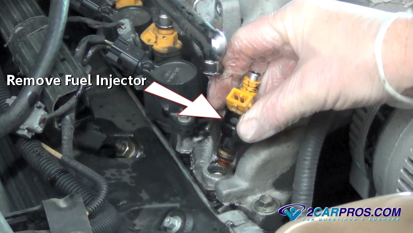

Apply pressure downward to the fuel injector from the rail, this will release the injector from the O ring seal located on either end of the injector. (Note: Some injectors are held in by a retainer clip that must be removed.)
remove fuel injector

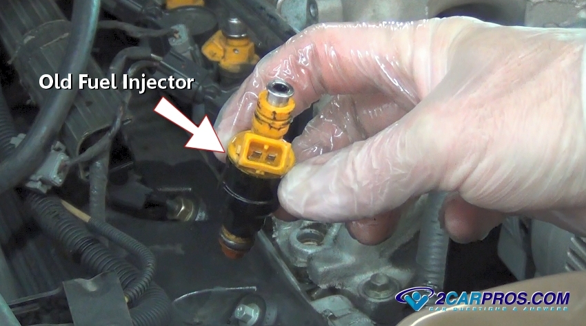

Inspect the old fuel injector and account for both sealing O rings as they can get stuck in the rail or down inside the intake manifold.
leaking fuel injector

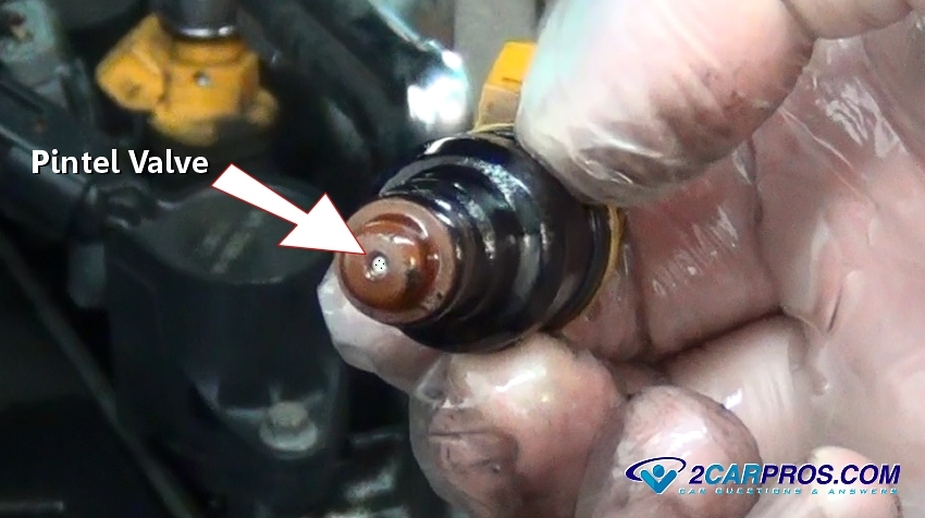

The pintel valve located at the end of the injector is where the fuel exits the injector and enters the engine, its common for these valves to plug and stop working (small holes.)
pintel valve injector

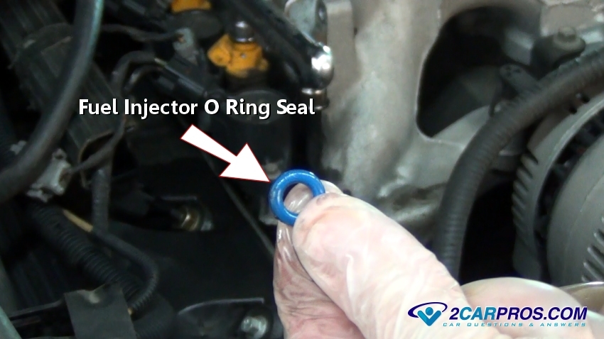

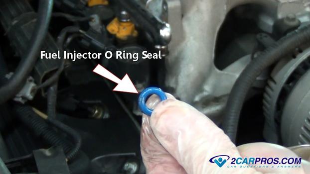

An injector O ring seal is used at either end of the injector and should be replaced when installing a new injector.
fuel injector o ring seal

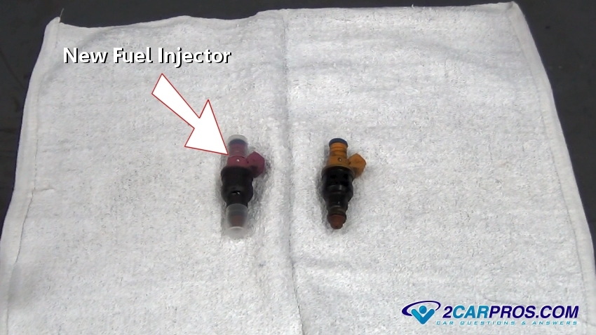

The old fuel injector should match the new unit, remove the dust caps from either end and ensure new O ring seals are installed.
new fuel injector

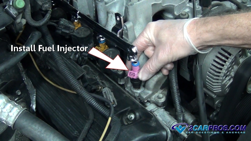

Gently install the new injector being mindful of the O ring seals. (Note: Use lubricant on O ring seals when installing injector.)

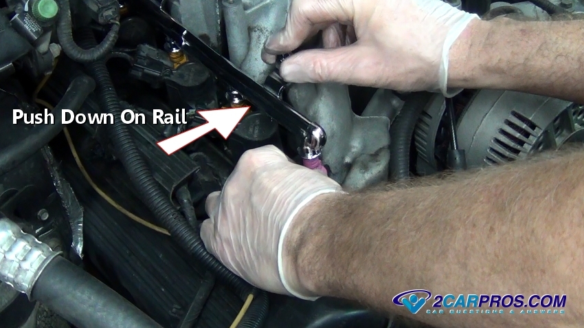

Gently push down on the rail while aligning the remaining injectors.
push down on rail

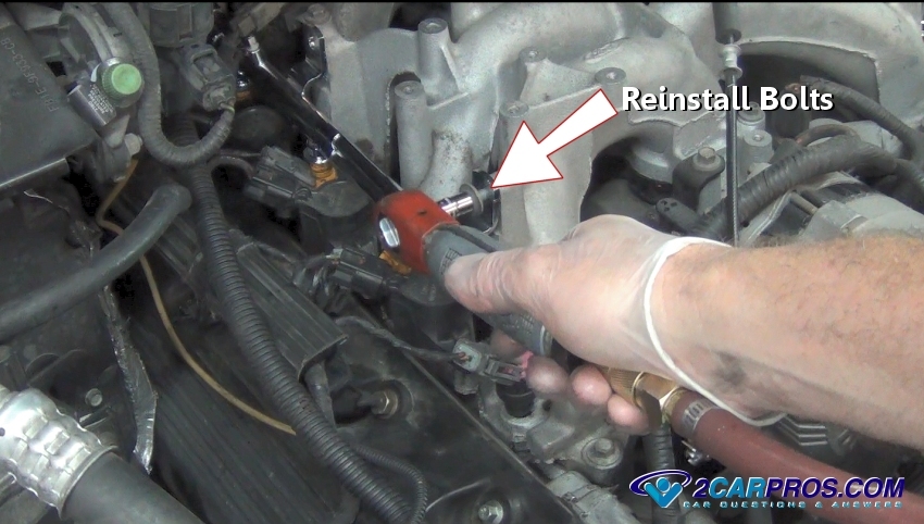

Reinstall rail mounting bolts and tighten.
reinstall rail mounting bolts

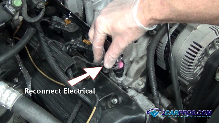

Reconnect the electrical connector to the fuel injector. Once the job is complete inspect the fuel rail for leaks after the engine has been started and ran.
reconnect electrical fuel injector
