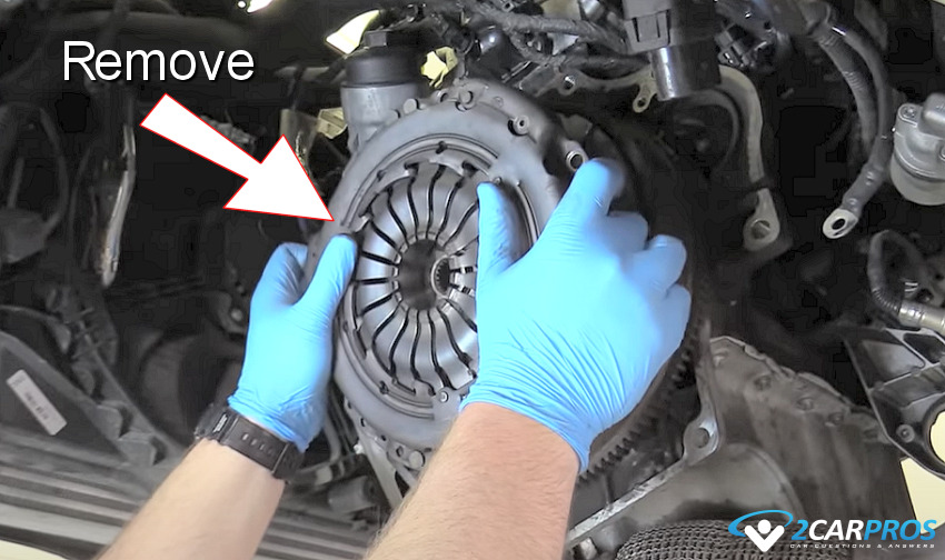

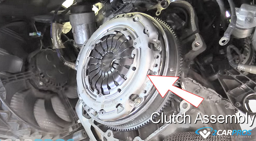

1. Remove the Clutch Pressure Plate: The picture below shows what it looks like once the transmission has been removed, which exposes the clutch assembly that is mounted onto the flywheel at the rear of the engine. Again, this part deals with asbestos so an air mask is recommended. Begin by loosening the bolts evenly and in a start pattern. The pressure plate will be held onto the flywheel by 10mm 12mm, or 13mm bolts in most cases.
When you start to undo the bolts, the flywheel will want to move and turn the engine over, so you will need to break the bolts loose by applying leverage inward or outward from the flywheel, an electric impact gun also works well for this, or you can hold the front of the crankshaft balancer bolt.
Do not remove all of the bolts at once because the pressure plate traps the clutch disc, which can be heavy and can fall causing an injury. As the last bolts are undone, have an extra hand to control both the pressure plate and disc. The pressure plate will start to move outward from the flywheel as the bolts are undone.
remove clutch pressure plate and clutch disc

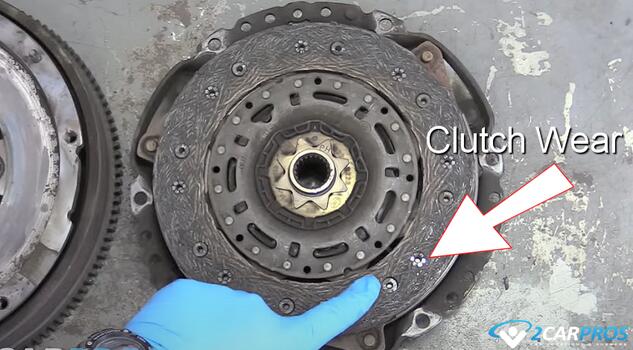

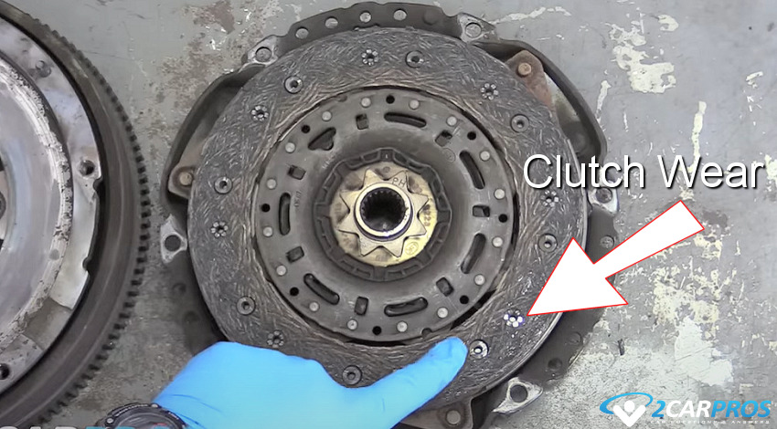

2. Inspect Clutch Wear: The clutch disc is the part that wears down much like a brake pad, in fact the clutch disc has brake pad material on either side of it which is held on by rivets. When this lining wears it allows the rivets to contact the flywheel or pressure plate which causes the clutch to slip.
automotive clutch disc wear

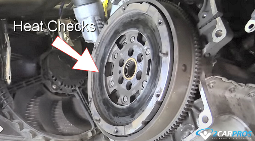

3. Resurface/Replace Flywheel: You are looking for extreme flywheel heat checks, hot spots and cracks which are a sign the clutch was slipping for a long period of time and will warrant the flywheel's replacement. Some flywheels can be re-machined if the heat damage is not too bad, if this step is skipped when the new clutch is installed you will have a good chance that it will chatter and the job will need to be redone.

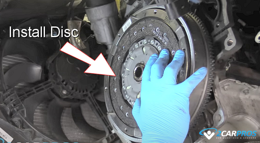

1. Install the New Clutch: This part is very important! The clutch disc can go onto the pressure plate in either direction, but only one direction is correct. The part of the disc that is protruding outward must go toward the pressure plate/transmission or the clutch will not release.
install automotive clutch disc

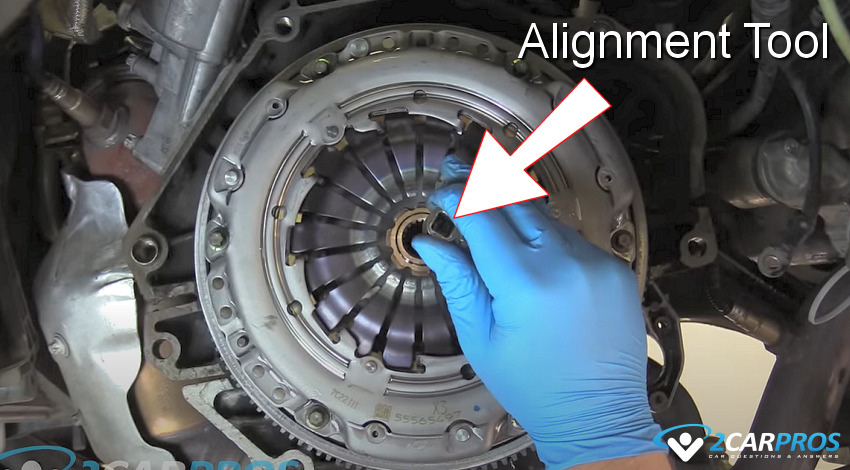

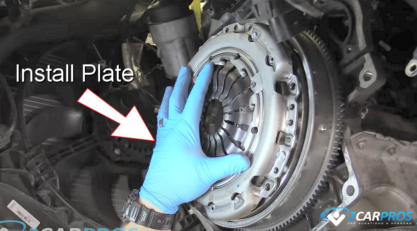

2. Install Clutch Pressure Plate: Gently install the new pressure plate onto the flywheel alignment dowels while holding the disc in place and start the bolts by hand, but do not tighten. This is so you can insert the clutch alignment tool included in the clutch kit. This is needed to line up the clutch disc to the pilot bearing so the transmission can be easily reinstalled.
install clutch pressure plate
3. Clutch Alignment Tool:  Insert the clutch alignment tool, slightly tighten the pressure plate bolts further to hold the disc in place and move the tool in a circular motion. It will give some resistance in all directions and you want to find a good center point. This means the disc is in the middle of the pressure plate.
insert clutch disc alignment tool
