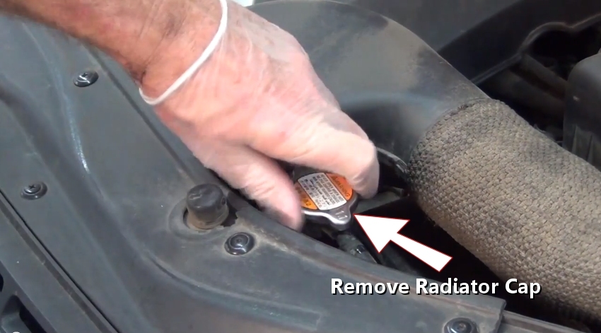

With the engine cold (only) locate and remove the radiator cap, a small amount of pressure maybe released when loosened.
remove radiator cap

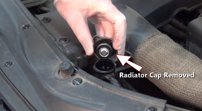

Once the cap has been turned counter clockwise while pushing downward, lift the cap from the radiator.
radiator cap removed

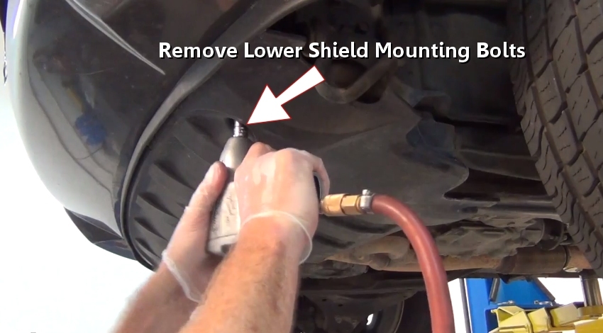

Remove lower shield mounting bolts while removing shielding. This will allow access the bottom of the radiator.
remove lower shield mounting bolts

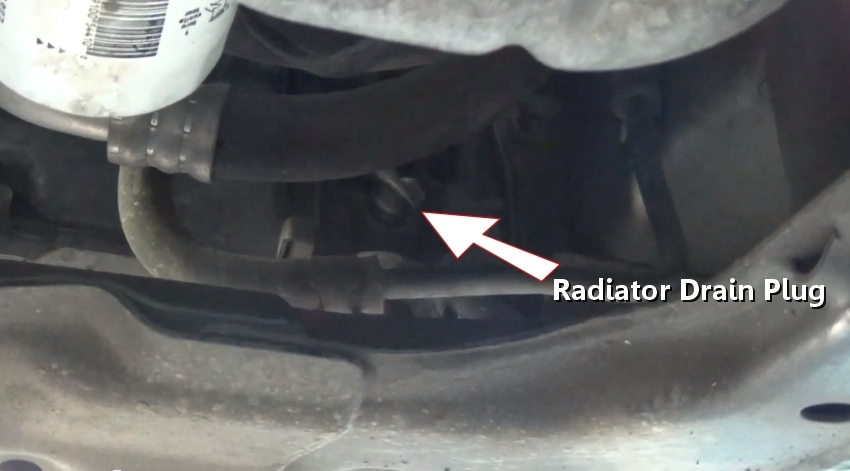

After removing the lower shielding, locate the radiator drain plug and start to loosen.
loosen radiator drain plug

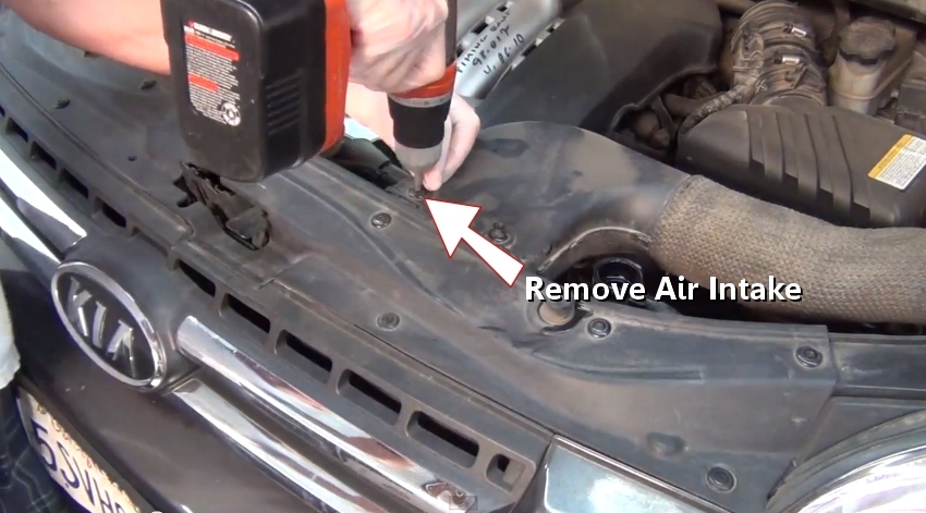

Remove the mounting bolts or clips holding the air intake and the plastic fascia over the radiator and lift the cover from the engine bay. Also move the air intake away from the work area.
remove air intake

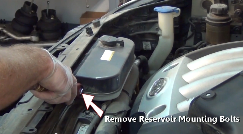

Locate and remove coolant reservoir mounting bolts.
remove reservoir mounting bolts

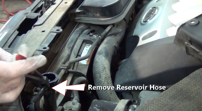

Remove the coolant overflow tube from the radiator neck. This hose can become stuck so a twist could be necessary. Once free, remove the coolant reservoir from the engine bay.
remove overflow hose

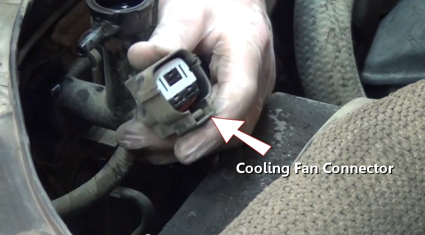

Locate and disconnect the cooling fan electrical connector.
disconnect fan connector

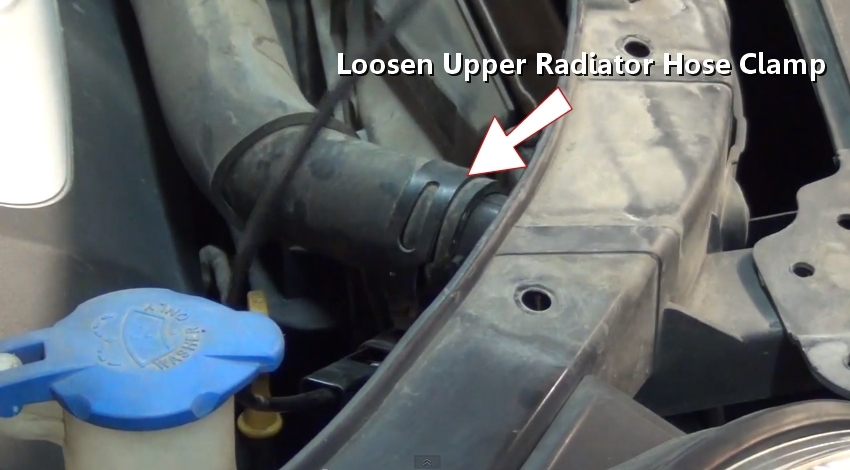

Using a hose clamp removal tool or channel locks loosen the upper radiator hose clamp.
loosen upper radiator hose clamp

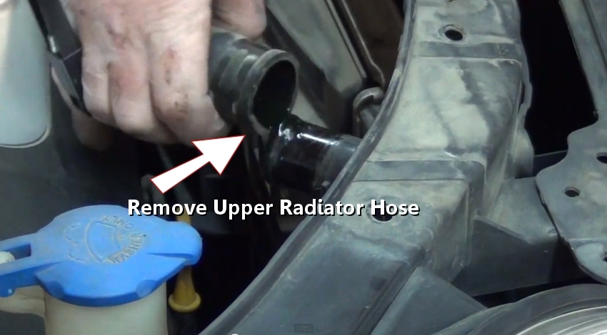

Grasp the upper hose and twist to remove.
remove upper radiator hose

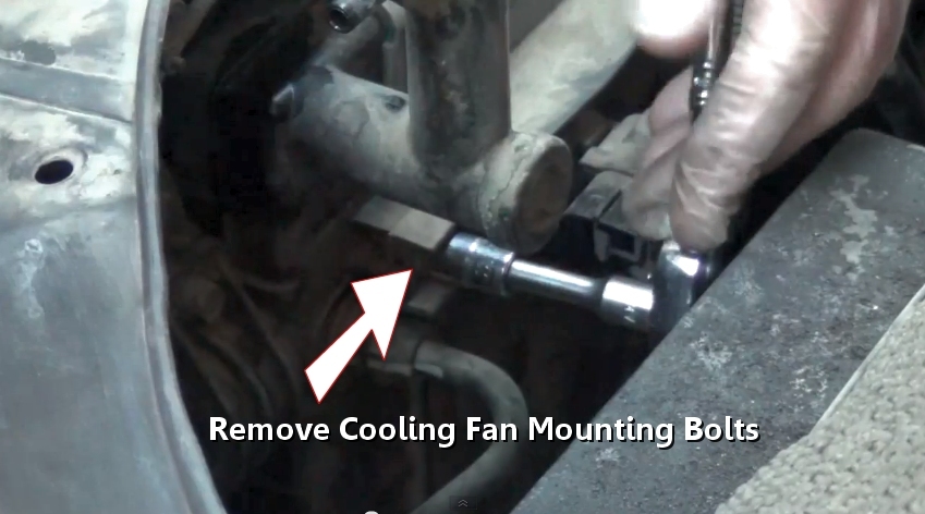

Next, remove all cooling fan mounting bolts.
remove cooling fan mounting bolts

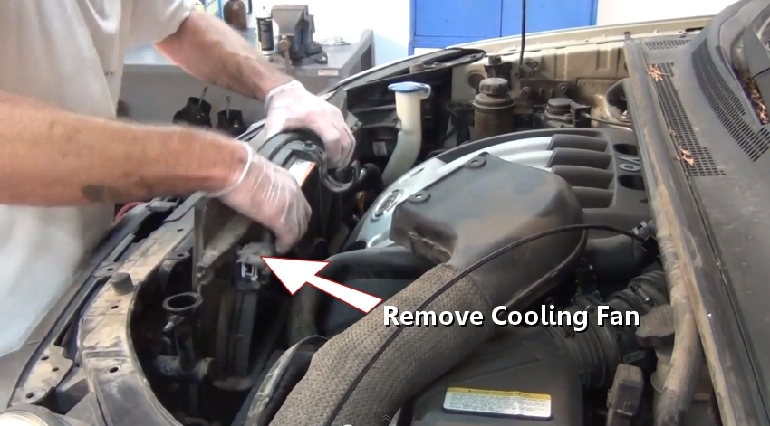

After the cooling fan mounting bolts have been removed, gently lift out the fan and housing, sometimes the cooling fan will need to be removed with the radiator.
remove cooling fans

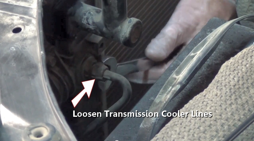

Using a wrench loosen and remove the automatic transmission cooler lines from the radiator, there should be two of them, this is for automatic transmission cars only.
loosen transmission cooler line

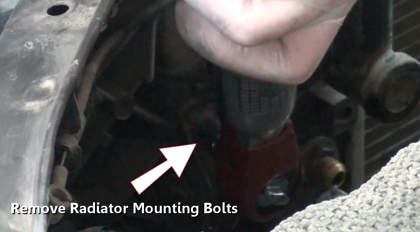

Once the transmission lines have been removed, locate the radiator mounting bolts and remove.
remove radiator mounting bolts

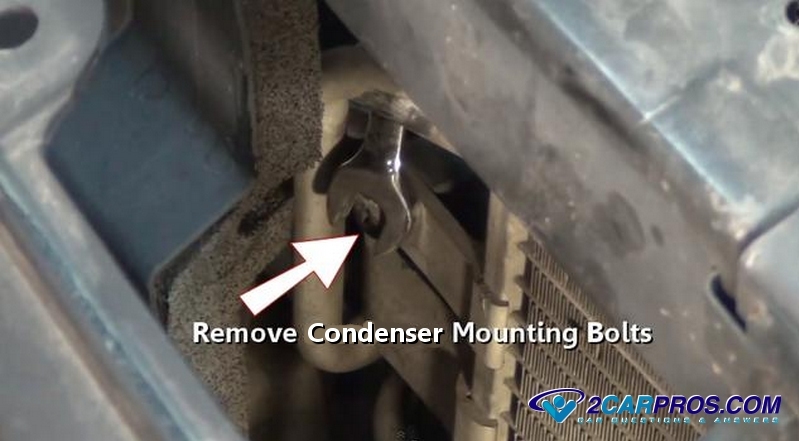

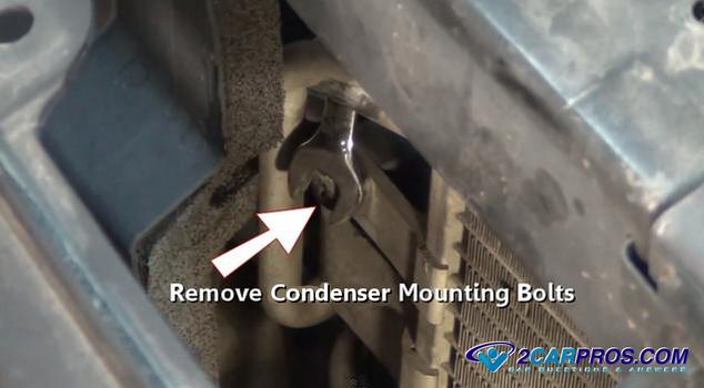

After the radiator mounting bolts have been removed, move the radiator forward to remove the air conditioner condenser from the radiator. This condenser will remain in the engine bay so vacuum down and recharge is not necessary. Some condensers are held independently of the radiator in which case you can skip this step.
remove condenser mounting bolts

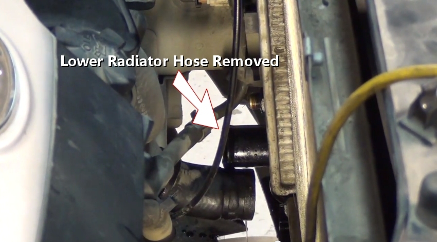

Using a hose clamp removal tool or channel locks loosen and remove the lower radiator hose. A small amount of coolant might leak from the hose, be ready with a fluid catch basin.
lower radiator hose removed

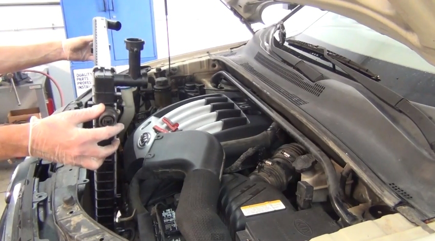

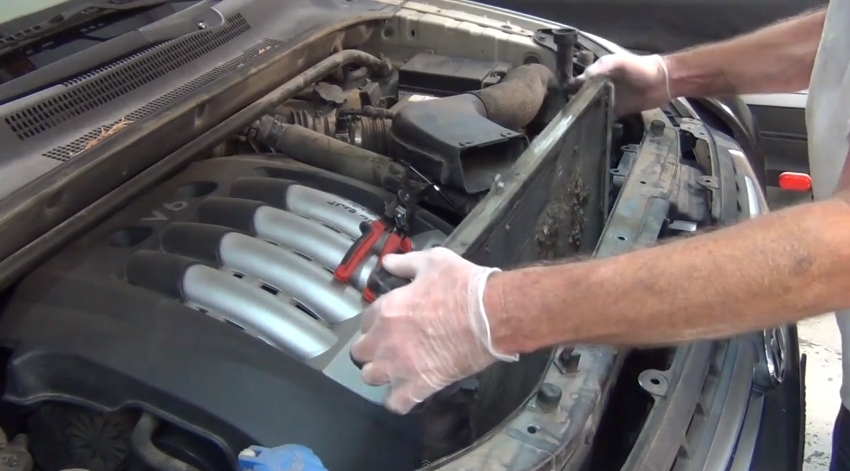

Double check all hoses, mounting bolts and clips have been removed, gently lift the radiator from the engine bay.
removing radiator

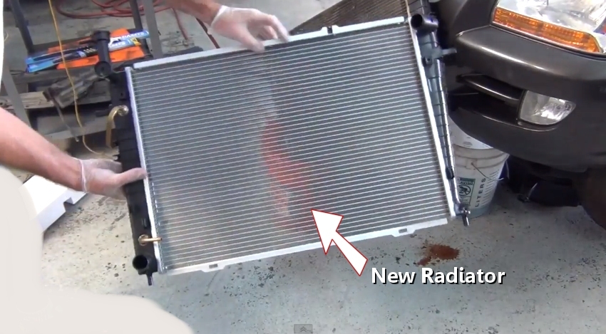

Once the old radiator has been removed, un-box the new radiator and match it up to the old radiator. Look for mounting clips. mounts and transmission lines that might need to be transferred over.
new radiator

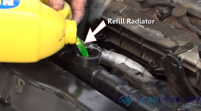

Once these steps have been completed, reverse the order to reinstall the new radiator. Refill the system with coolant and start the engine, allow the engine to warm up completely while adding coolant until the thermostat opens.
refill radiator coolant

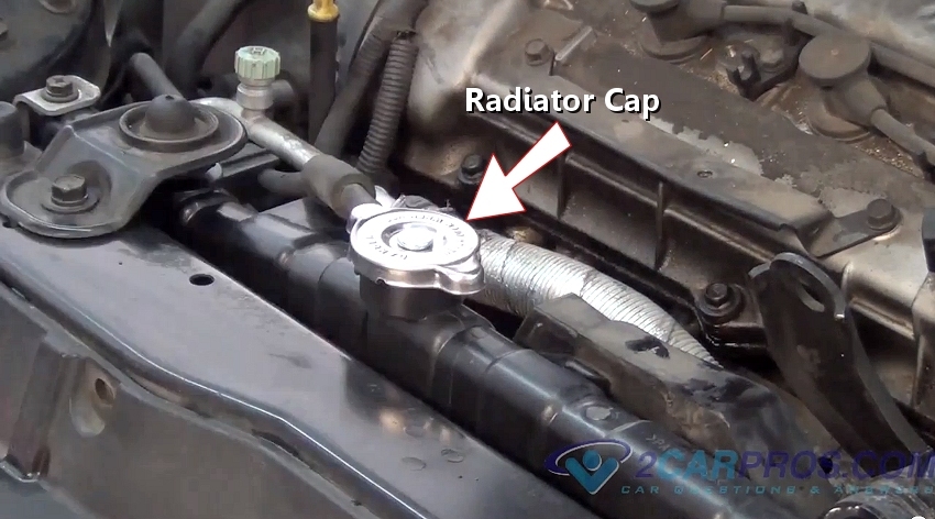

Reinstall the radiator cap by pushing down and turning it clockwise until tight, also check the coolant reservoir fluid level. After installing the radiator cap, recheck the system for leaks, also recheck  the coolant reservoir after a couple of days of operation. Once driving the vehicle, check the temperature gauge for overheating.
radiator cap
