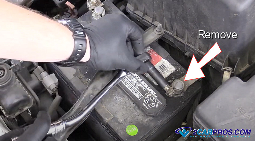

2. Use an 8mm or 10mm wrench to loosen the bolt for the negative cable end, this cable will be black or have (-) sign near it, you might need to give a twisting motion to help remove the cable. Be careful not to touch the wrench to the positive side of the battery to avoid a short circuit. Always undo the negative side first because the positive side is more prone to shorting to ground via any metal in the area. Push the cable away to avoid accidently reconnection back onto the terminal.

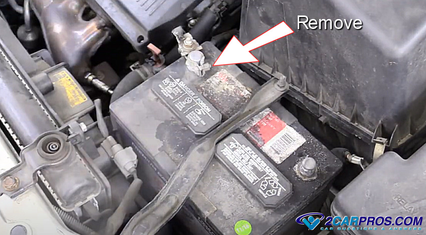

3. Undo the positive side cable, this will normally be a red color and identified by a (+) sign near the terminal connection and may have a red plastic cover over it. Use a wrench or ratchet to loosen the cable end, at this point there is no chance of creating a short circuit because the circuit is no longer live with the disconnection of the negative cable.

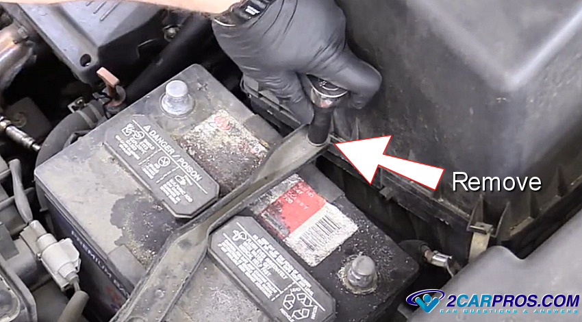

4. Some manufacturers have a battery cover which now can be removed once the cables have been disconnected. This will also allow you to gain access to the battery hold down bolt. This cover should be cleaned before re-installation with water and soap to remove any acid residue that might be present. Locate the hold down bolt or J bolt nuts which are either at the top or bottom of the battery mounting box.
If the hold down is at the bottom it with only require one bolt to be removed, while a J bolt style of mount will require two nuts to be removed. On a bottom bolt style of mount use a long extension and ratchet to help in the removal. These bolt sizes include 8mm and 10mm. There will be a plastic wedge piece that will also need to be removed as well.
remove battery hold down strap

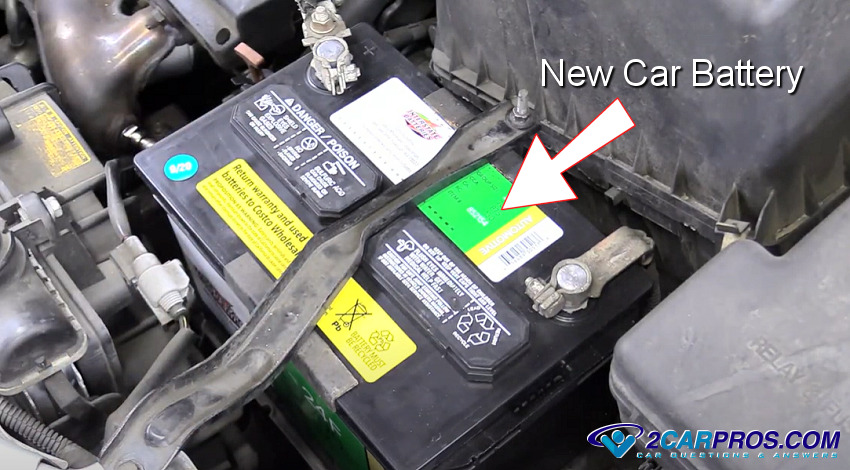

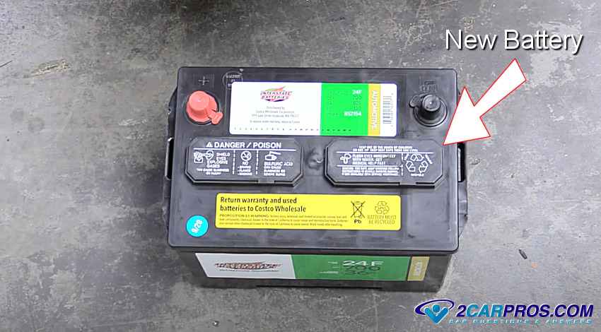

1. Now that the old unit has been removed, compare it to the new battery while checking the size, negative and positive terminal orientation, cold cranking and reserve amps which should meet or exceed the old battery.
new car 12 volt battery

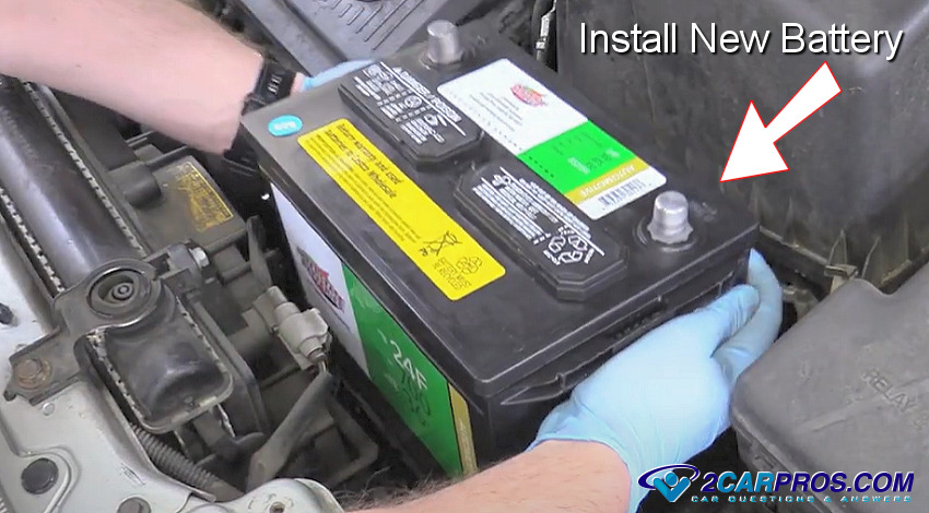

2. While firmly holding the new battery, gently lower it into position. Be mindful of the terminal orientation so the electrical cables will attach to the corresponding positive and negative cable. Once the new unit is in place, wiggle it to ensure it's down into the box mount.

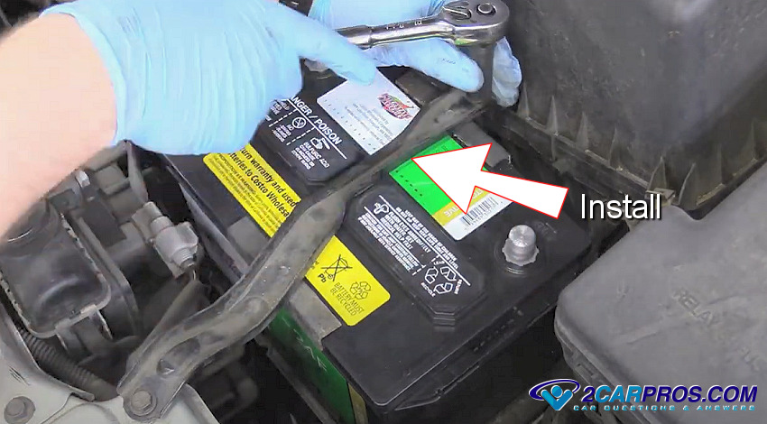

3. Then lower the mount wedge, or battery hold down bracket and J bolts into place and secure the battery, these bolts only need to be wrist tight. At this point you should see and feel the battery get tight within the battery box. Wash these parts with soap and water to remove corrosion before reinstalling them.

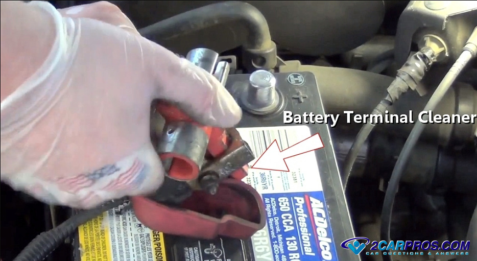

5. Use a battery terminal cleaning tool with a twisting motion which will create a fresh metal surface within the cable end and aid the transfer of voltage to the car. Take note: This cleaner has a taper fit and will only work correctly in one direction. Complete this operation by cleaning both negative and positive cable ends, a small wire brush will work for this as well.

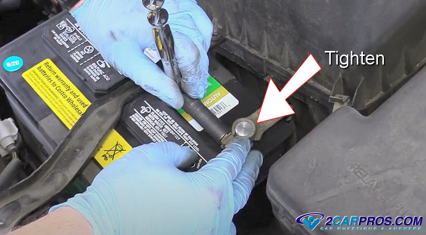

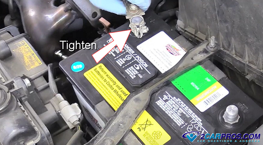

6. Install the positive cable first, tighten the nut while holding the end downward on the terminal to help the connection, to ensure a proper installation wiggle the cable end slightly. Once tight reinstall the positive cable protective cover which helps prevent accidental short circuits when working inside the engine bay. Do not reverse polarity, (attach the positive cable to the negative side of the battery, or the negative cable to the positive side). This will cause major electrical problems such as shorting out the alternator, main computer or other controllers inside the vehicle.
tighten positive battery cable
7. Finally, install the negative cable end onto the battery terminal and tighten while holding downward. Check the cable end for tightness by giving it a twisting motion. Wipe away any dirt or metal shavings from the cable end cleaner and double check your work and you are all set!
