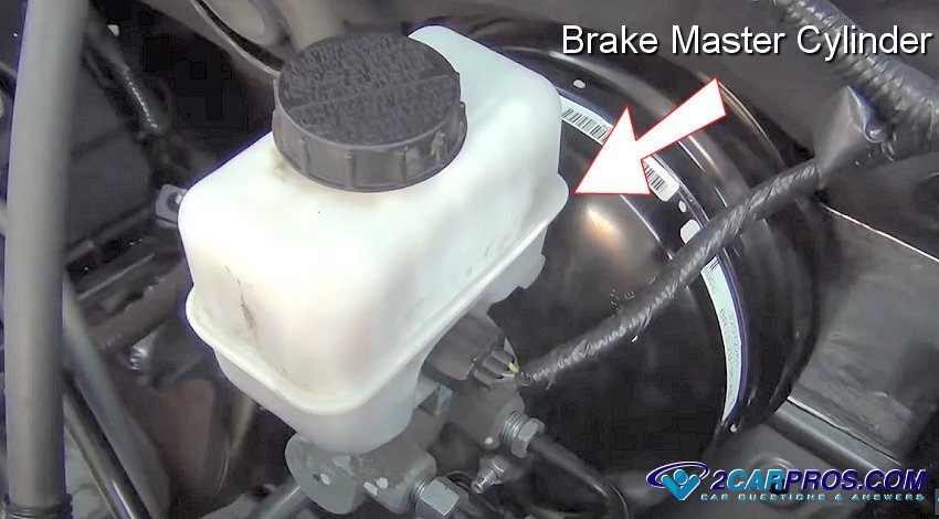

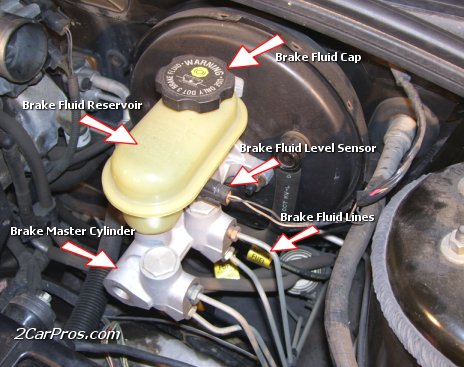

1. Raise the hood to identify the master cylinder location which is usually near the fire wall on the driver's side. There will be two or four brake lines connected the main body of the master and a small wiring connector attached to the brake fluid reservoir.
Brake Master Cylinder

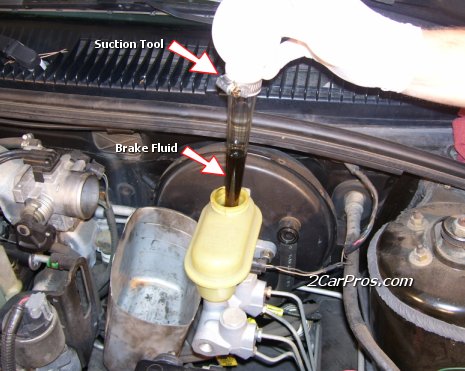

2. Before removing the brake master cylinder you will want to remove as much of the old brake fluid as possible to avoid spillage during the removal. Begin by removing fluid reservoir cap and insert a turkey baster to remove the fluid and then reinstall the cap.

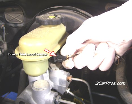

3. Release the safety clip of the electrical connector and gently pull it from the brake fluid level sensor in the reservoir.

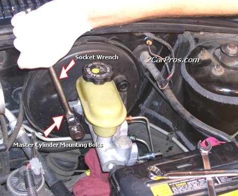

5. Once all of the lines have been removed use a wrench or socket to loosen and remove the master cylinder mounting bolts from the brake booster. These nut sizes are usually 14mm or 15mm.  After all mounting bolts are removed push the master forward and then lift it off the mounting studs and then out of the engine compartment. Have a shop towel ready for the removal to avoid dripping brake fluid from potentially getting on the car's paint.

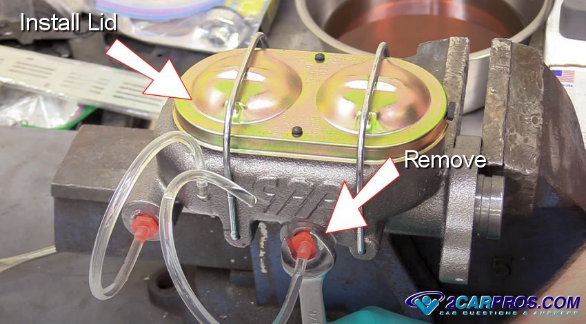

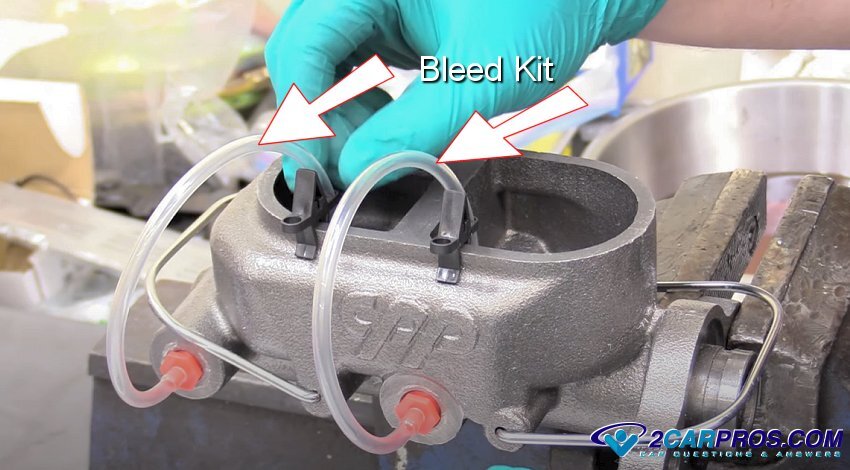

1. Hold the master cylinder in a vise so it doesn't move. Then remove the fluid lid of the reservoir and remove the dust caps that cover the line ports of the master. Then install the master cylinder bleeder kit which is two or four plastic fittings and rubber/plastic hoses which will be connected to the fittings and then routed back into the fluid reservoir. Make sure the lines are far enough into the reservoir as to not suck in air.
automotive brake master cylinder bleed kit

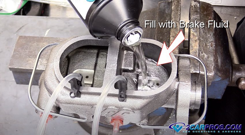

2. Make sure the brake bleed tubes are down inside the fluid reservoir and fill the brake master with brake fluid to just under the full line. The idea is you don't want these tubes to suck air in when working the master cylinder's plunger.
brake fluid fill brake master cylinder

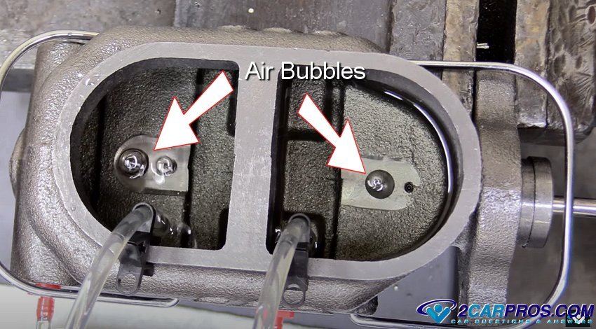

3. Use a large Phillips screw driver and place it at the rear of the master and into the plunger and slowly start pushing the plunger into the master, air bubbles will begin to come out of the plastic lines inside the reservoir as you press inward. Once the plunger has bottomed out, release the screwdriver (slowly) which will draw fluid into the master, you should be able to watch the brake fluid level go down in the reservoir. Continue this operation until no air bubbles are present, refill the reservoir as needed to retain the fluid level. Do not allow the plastic bleed lines to suck in air.

4. Once completed remove the bleeder kit and reinstall the reservoir cap, a small amount of fluid will start to leak out. Use a shop towel to help guard against paint damage as you reinstall the brake master back into the car.

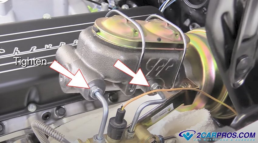

5. Slide the master back over the brake booster studs and reinstall the mounting nuts finger tight. While the master is still a little loose reinstall the brake lines, this will help in the line installation. Use a regular wrench to snug up the lines to stop the master from leaking additional fluid. Never allow the brake fluid to drain completely out of the master. If the fluid runs completely out of the master it will need to be re-bled.
6. Once the mounting bolts have been fully tightened use a line wrench to put the final tighten on the brake lines. The torque spec on the master cylinder's mounting bolts is usually between 24 and 32 foot pounds. Reconnect the fluid level sensor and refill the master cylinder with fluid and reinstall the cap. Once the job is complete bleed the remainder of the brake system to remove any air from the system. Carefully pay attention to the brake pedal feel and stopping power. If everything is in order, the replacement is complete. Never drive a car that does not have good brake pedal pressure.
