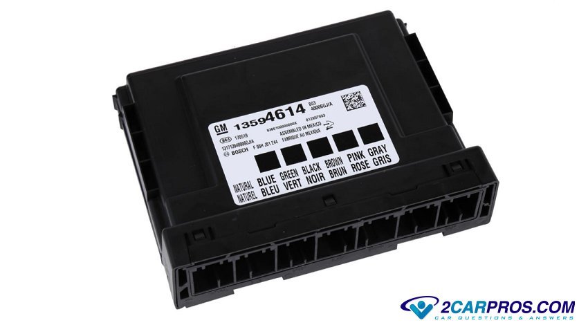

 An automotive BCM (body control module) is designed to control and monitor various systems much like a typical PCM (power-train control mode). The BCM can be thought as a support computer for everything not power-train related such as the seat controls and memory, seat belt warning, vehicle security systems (including key fob operation), interior and exterior lighting, windshield wiper systems, headlight and DRL controls, rear window defroster, dashboard lighting, trunk, lift back, automatic sliding door controls, window controls, cruise control and gear shift interlock systems.
 The BCM also shares data within the CAN (controller area network) to additional systems such as the climate control (HVAC), traction control, PCM (powertrain control module), ABS (anti lock brake system), SRS (safety restraint system) and instrument cluster. We use the term BCM but it is also known as a GEM (generic electronic module), FCM (Front control module) depending on the manufacturer.

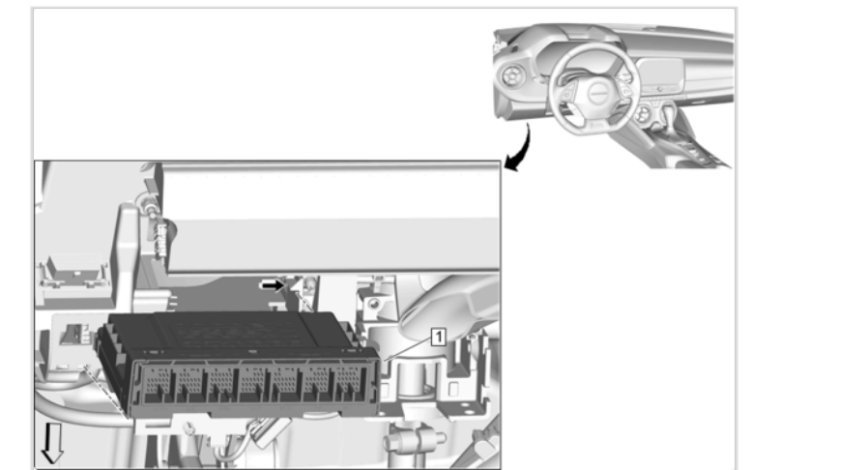

2. Locate the BCM in your particular vehicle which will be under the dashboard or near the center console in most cases. Using plastic trim removal tools, carefully pry off the dashboard panels surrounding the BCM. Be gentle to avoid damaging the clips or the dashboard itself. If you have trouble finding the BCM in your vehicle please consult one of our technicians for assistance.

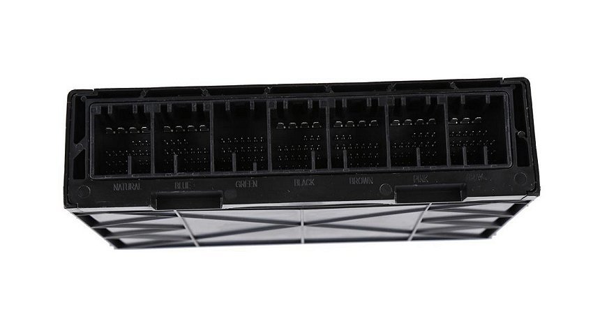

3. Disconnect the 12 volt battery by removing the negative battery cable and allow the vehicle to sit for more than 15 minutes. Use a flashlight if necessary to get a clear view of the BCM and its mounting points to remove the fasteners. Press and release safety clips for the electrical connectors to gently wiggle them from the BCM, these connectors can only be inserted one way so don't worry about getting them mixed up. Also, check for overheated or corrosion damage to the electrical terminals which must be repaired before replacement.

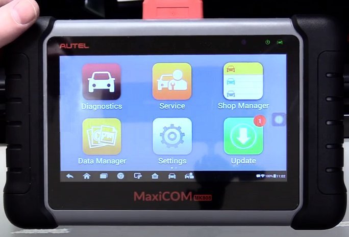

One thing to note is that the BCM is coded (programmed) to your particular car which must be transferred to the replacement unit. This is done in one of two ways, either you can use a scanner capable of reprogramming which must be done before the unit is removed, or you can get a rebuilt BCM which will arrive pre-programmed from the rebuilder which is done by using the car's VIN number.
